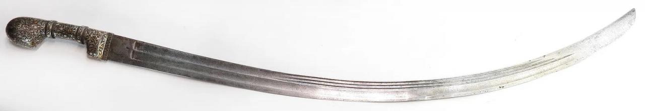

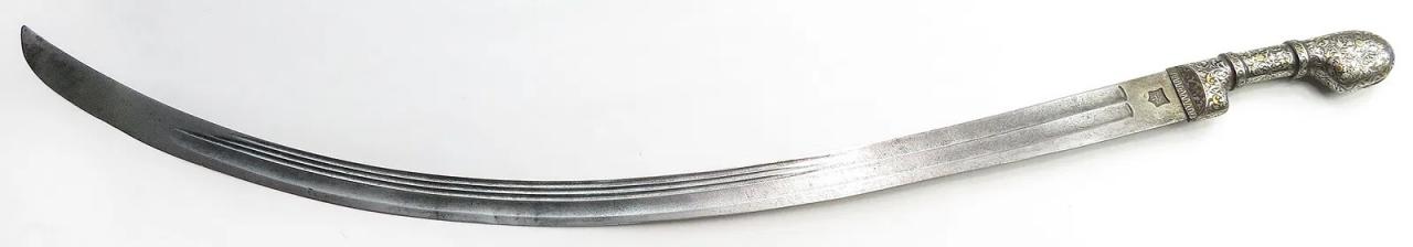

Hello fellow collectors,

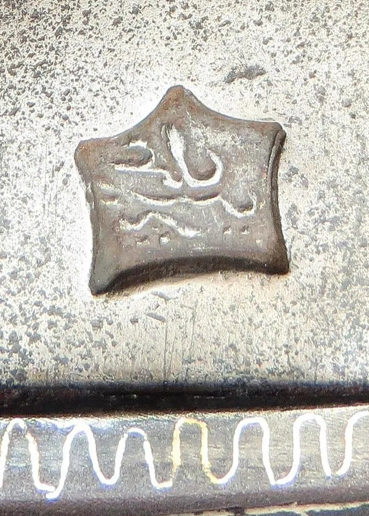

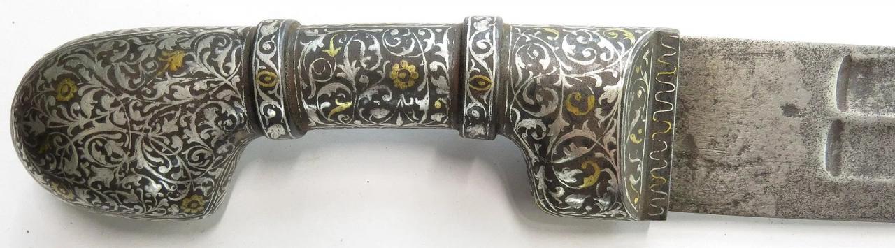

I had this Shashka for a while now. It's pretty big! Over 40 inches! But it's light. The owner must have been a big guy! Did some research on it and pretty much understand the sun and the moon/stars/sun symbolism and the use of European/German/Hungarian blades in the Caucasus. I do have a more difficult time reading the Persian or Arabic makers marks on the blades! If anyone can assist with translation that be great! I know it is probably the maker's name. But if the blade is European manufacture why did the bladesmith from the Caucasus put his marking/stamp on the blade (or maybe he just did the hilt, which most likely he did do! And that's why the mark). A while back someone suggested the translation is: WORK OF GHASI BABR(?). The blade is somewhat worn and has pitting but apparently, it's very well made because it gives out this loud ringing sound when I flick it:-) No scabbard, unfortunately:-(

JackBrown, you have a remarkable collection. Unfortunately members with interest and knowledge in Caucasian weapons have left this forum. I suggest you to pose your questions in the facebook group "Historical arms of Caucasus", whose administrator is Serge Talantoff. They have members who are able to translate inscriptions and marks.
Old 19th April 2026, 05:05 PM   #4
Posts: 10,842
Indeed Jack you have some nice items, especially the shashka, which is of course a full size fighting example, and of the form perpetuated into 20th century following Daghestani and Chechen style. As these are of course almost typically fashioned after these styles and often using old European blades, it is difficult to accurately assess them, especially from photos.
However, while as noted, most everyone who had serious authority in these have gone to other venues, aside from an occasional note. While I'm no authority (by far!) I still find these fascinating, and as often (as now) my resources on these are not at hand, by using the SEARCH feature old discussions with pertinent information can be found with great discussions now archived here.
While the 'experts' are no longer around, their words and expertise still are, in the archived discussions found using key words on SEARCH. I hope you are still here, but wanted to add this for readers who still might visit this.
As far as I can see, this example shashka likely is from Tiflis (formerly Tblisi) where many of these traditionally fashioned weapons were assembled by the many artisans there.

Most likely Daghestan/Kubachi region but might be Tiflis. It's difficult to authenticate it. But the blade is most likely European even tough Caucasian masters also copied the moon face/stars/sun face, and animals like wolves symbols from German sword makers

Originally Posted by Tim Simmons View Post
Could it be central Asian like Kazakhstan?
I don't believe so. I saw several examples of Central Asian/Uzbek/Afghan shashka type swords. They do look quite different (hilts and blades, symbology on the blade is definitely different). I tend to think the place of origin is Dagestan or Georgia. Most probably N. Caucasus
