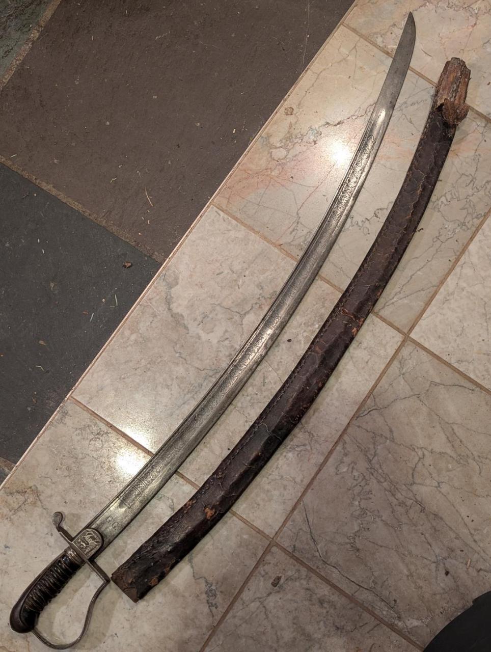

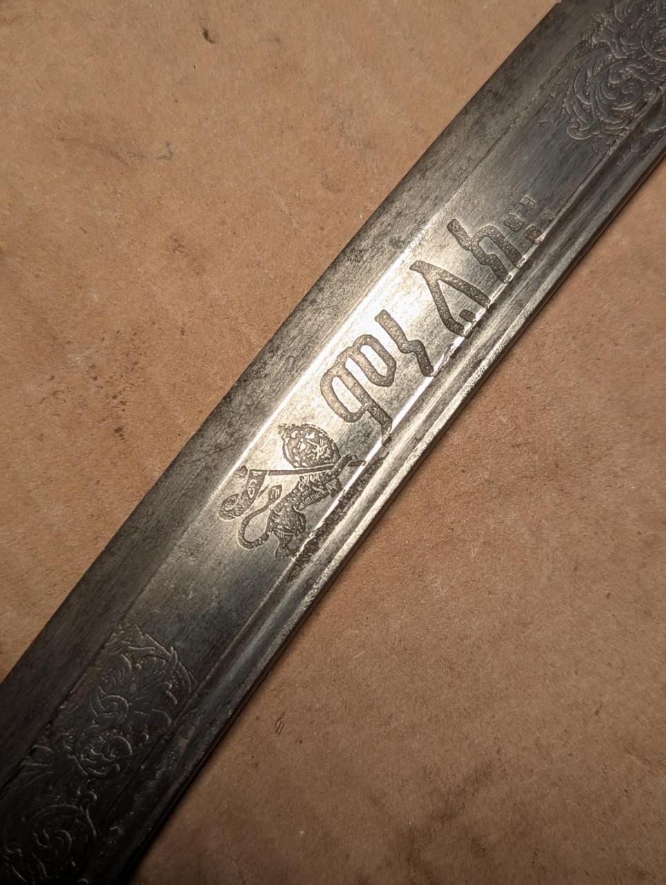

Hi everyone, As soon as I saw the "concurring lion of Judea" I knew this was Ethiopian. But it also has the name of Menilek II, a pivotal historical figure in African history. My question is who made this sword? I GG a German maker?
Thank you in advance.

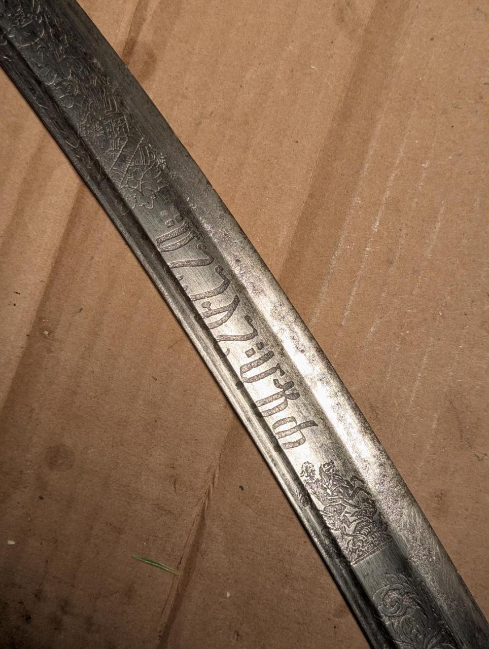

Additional images:

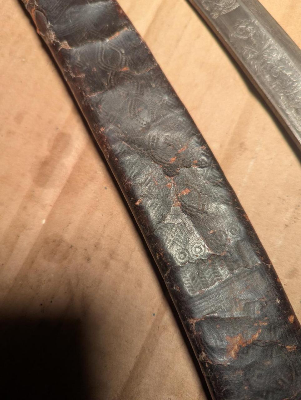

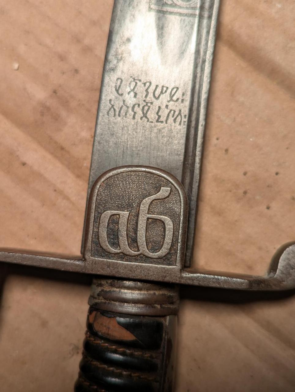

The other side of the blade and some of the leather work on the scabbard...

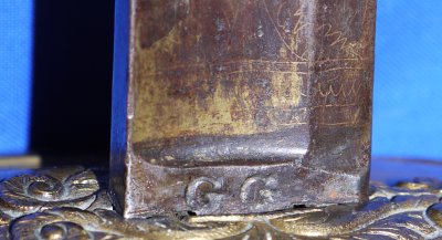

I've seen similar GG markings on British swords, like the 1786 spadroon below.

My understanding of the GG mark is that it stands for Gesetzlich Geschutzt, very loosely translates into "patented". So yes, it does signify a German made blade, but does not belong to any maker in particular. Nice sword!
Old Yesterday, 09:12 PM   #6
Posts: 9,699
Yes, GG means "gesetzlich geschützt"! And it's also correct that it doesn't belong to a special maker. And yes, German, most probably Solingen.

This stamp indicates that the company has received a patent for the production of this type of product.

Does this also apply to the British sword above, i.e. does this one happen to have a German made blade?
Old Today, 06:34 AM   #9
Posts: 9,699
Hi Nathan,
I guess it's like that! But I am far away from being an expert for European blades!
