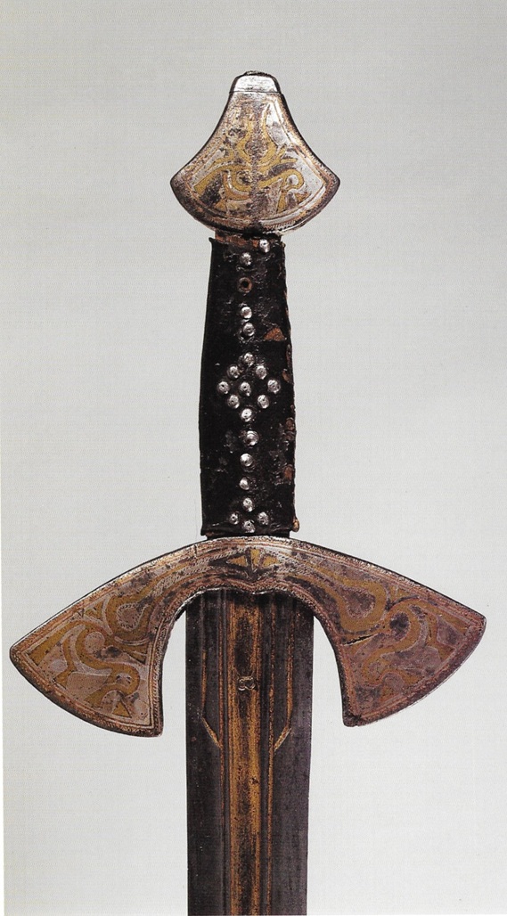

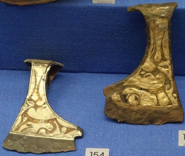

That one has been on the auction circuit for a while - the claimed origin has changed apparently. I do not think it is genuine, but it purports to be a distinctive Baltic type of hilt, from the area of Lithuania and Prussia. Several are decorated in a very particular style, as on this example in the Bargello Museum. (Note that here the Baltic hilt components have been combined with a much later blade.) The same style can be seen on a number of rare axe-heads. Vytautas Kazakevicius' book IX-XIII a. Baltų Kalavijai has more information about these swords, which he calls the Desiukiskes type, after one of the find-places.

I do not think so, but it does have an English summary, is one of the standard reference books for swords of that region, and was, at least formerly, available in pdf online.
