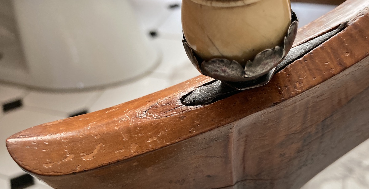

Rob, before you start doing something, could you please post a picture of mouth of the sheath, blade sitting in it?
You have here a Malay hilt and Pendokok, and Malay sheath. Even if the sheath was not made for this blade, I wouldn't shorten it.
There are a lot of sheaths ruined by collectors, who think sheath should match the length of blade, and blade shouldn't be visible when sitting in sheath.

Here are the pictures of the blade seated in the throat. As you can see, the aring side is an exact fit but there is a lot of room in front of the blade on the dagu side. Ordinarily, I wouldn’t be too bothered by the ganja sitting slightly proud of the wranka but in this case, the width of the of the blade just below the tang is slightly wider than the throat. This has made that area a pivot point so that the blade rocks back and forth like a teeter totter when seated. I think that widening that area by 1/64” (.0396875 mm) or less will allow the blade to seat solidly in the sheath. A light pass or two on each side of the throat with a fine cut riffler file should do the trick. I have enough woodworking experience to be confidant about doing this properly. Unfortunately, I don’t think there is anything to be done about the gap in front of the blade on the dagu side.

There is no question that the sheath is not original to the blade and In my previous post I had mentioned the possibility that the hilt and selut weren’t either. Of course, you are far more knowledgeable about keris than I am but it’s funny how different people see things. To me, the hilt and selut look a tad too large for the blade but just right for the sheath. That’s not to say that the hilt wouldn’t still look good in the sheath if it were a bit larger but, as it stands, it’s a pretty whacking big chunk of ivory already.
A. G. Maisey,
I am following your recommendations exactly. As I mentioned in my last post, I have already widened the sheath throat (at best 1/64” on each side) so the blade seats fully without wobbling and aring side fits well. It took at most 30 minutes work making flight passes with a fine cut riffler and checking the blade for fit between strokes.
I have cut the wooden plug for the dagu side and it fits well. Now comes the really hairy part, matching the color of the plug to the sheath. This will probably take about a week as I test various agents on pieces of scrap wood and wait for them to dry fully.
The buntut has been covered with a rather opaque stain. I have examined the chip with a magnifying glass and it appears for all the world to be some sort of poplar. The bottom of the buntut (where the stain is less opaque) shows a figure like poplar also. Ideally, I would like to fit a wood piece to fill the chip but that looks like it might be tough to do. I’ll give it a shot but, if I fail, plastic wood will work.

A chip such as the one to the buntut of your keris could most certainly be easily repaired, but my choice would be to leave as is and to make it look like old damage.
If I felt compelled to repair that little chip, I would square the irregular surface of the chip to permit a tight, straight-line joint. Then paper off the entire buntut & hit it with black japan spirit based stain. I would use tinted 5 minute Araldite as the adhesive, make the patch oversize reshape and paper back. Araldite can be tinted with artists powder colour. I would not use plastic wood. Ever.
