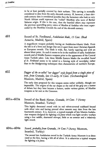

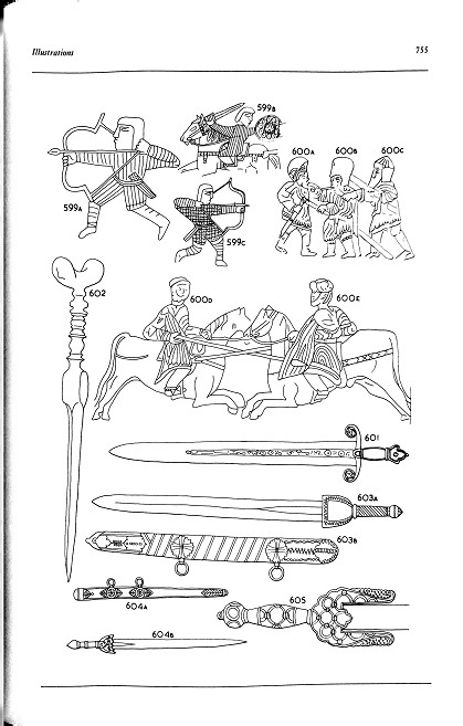

As far as comparison to Nasrid (jinete) forms, the only thing close is the sword of St.Ferdinand of 13th c. which has a pommel which is somewhat trilobate in what has been termed a maple leaf shape. (see attached, #601).
