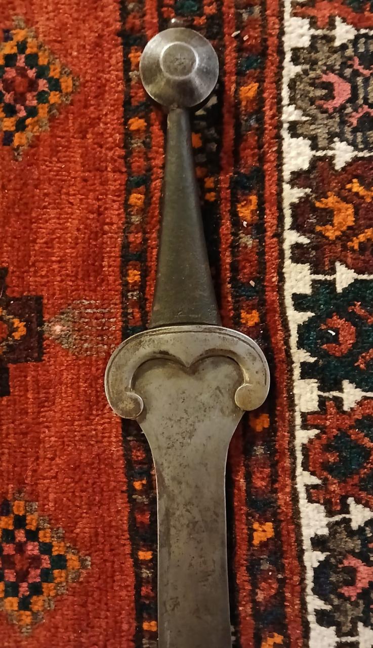

Hello thank you,
I tried , now I hope it will be ok.
Sword is a mix of medieval pommel and hilt with a celtic ? ?
guard and blade

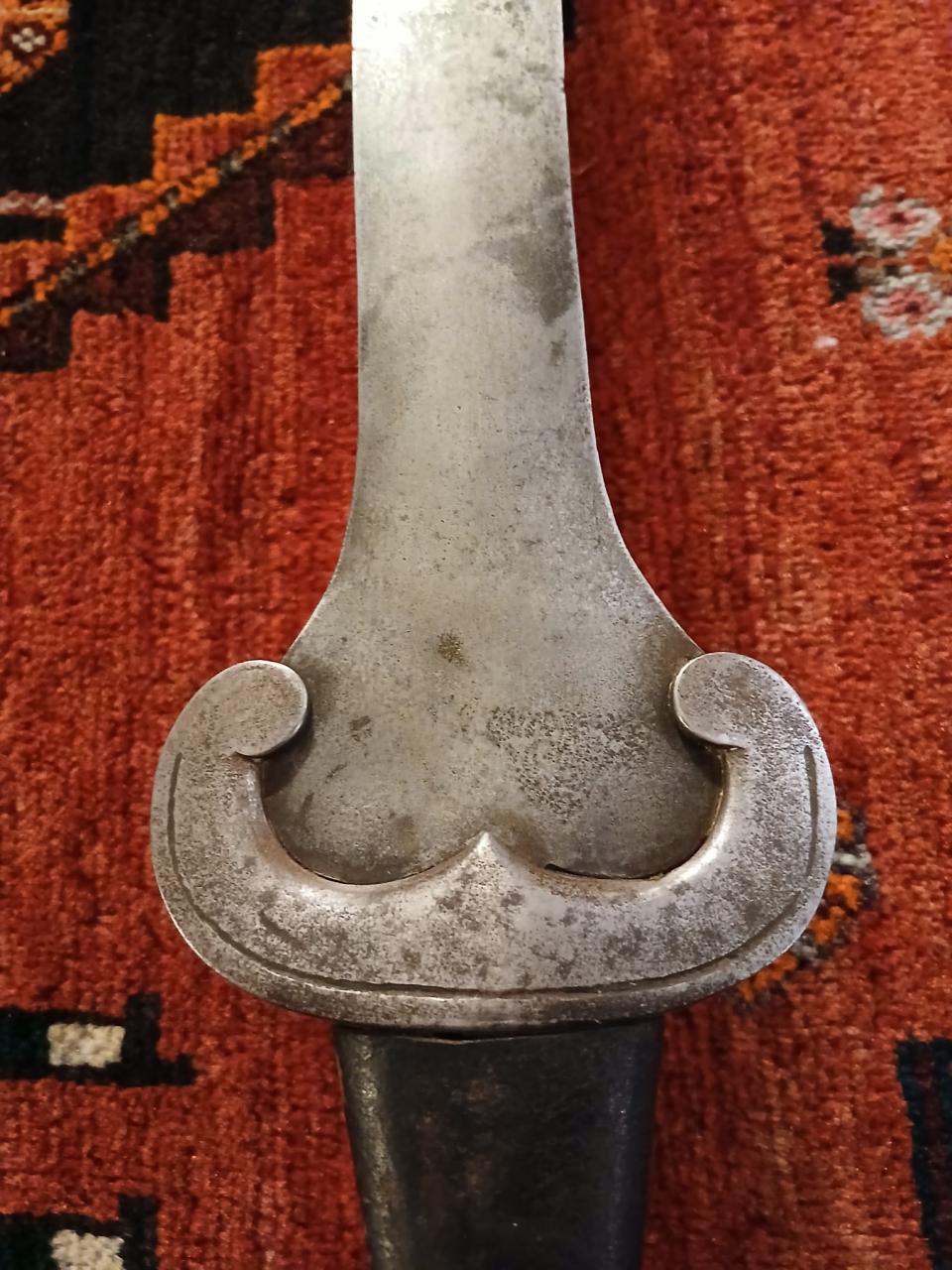

Hello, OK thank you !
I put other pictures with more light,
The blade is really thin , sharp at edges and 3-4mm at the middle
With no visible central ridge
Thank you

Thank you all members for the messages,
I will look for old European Italian swords .
It is a large sword, I would have mentioned that.
The total length is 97,5cm/ 38,38 inches
Weight is 1,4 kg / 3.09 pounds
Balance of the blade is 16cm away from the guard.
Largest part of the blade is 6,5cm large/ 2,56 inches and really thin ,
a little larger in the middle as I already said
It don't look like a deco piece ,
the blade is really really sharp all around the sword ; except the 5-6 first centimeters near the guard.
For a movie, I don't think it will be the best .
Almonzo is offline   Reply With Quote

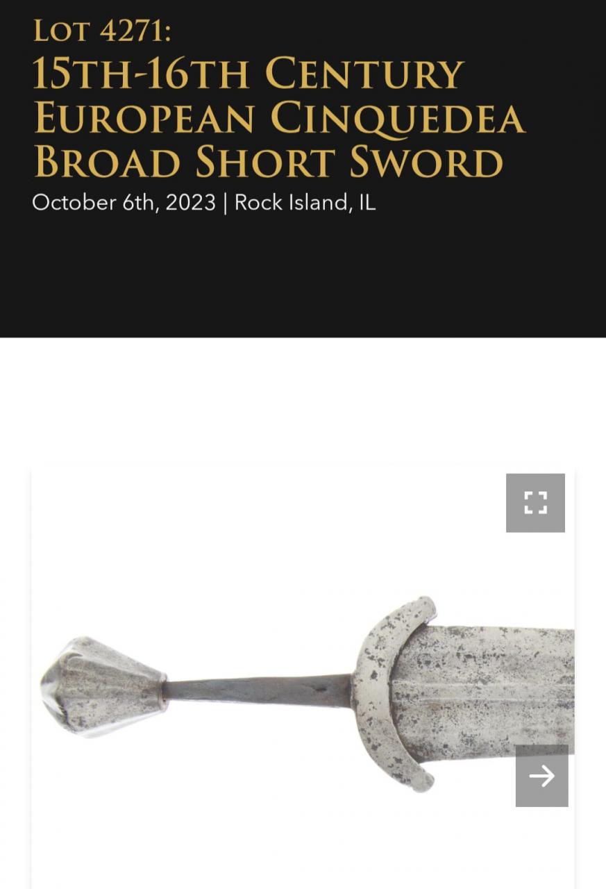

I forgot to write that when I received the sword
It was very rusty and I cleaned it with a lot of baking soda.
I wanted it shiny but maybe it is too much and help to make it seems too "clean'/fake
I found , thank you ,
this 16th large cinquedea sword who don't looks older, guard is +/- look like
The pommel is as unusual as my wheel medieval pommel.
Maybe this one is recent too ?

On the pommel I thought there was a cross but it is not,
maybe just a big scratch because it was under rust and still is visible.
The grip can be ok because when we grab the hilt and twirl or spin the sword,
The hand is "blocked"by the pommel who stabilise and make the movement easier

It may be a composite of original parts, but I think it is 19th c or later, perhaps in emulation of bronze age celtic swords.
Curious to hear what the museum has to say, though.

Alternatively it could the insperation for the Conan sword.

I am not a swordsman but I think that for protection we need a shield as in the illustrations
of these large small swords without guards.
Better use a gauntlet too
If handling the handle in defence position with two hands,
it makes a small guard and the shape of the end of the blade must deflect a little an attack.
Do viking swords with small guards and japanese katanas offer a better hand protection ?
