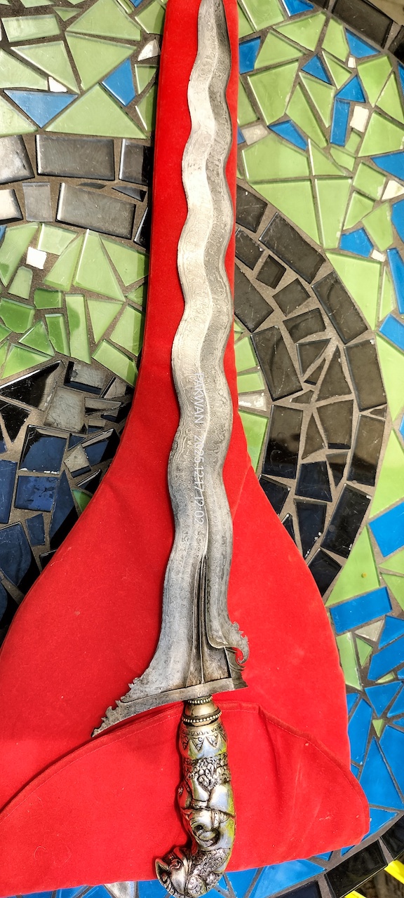

Old 24th December 2025, 10:06 PM   #106
Amuk Murugul
Amuk Murugul's Avatar
Join Date: Feb 2007
Posts: 484
Hullo everybody!
Another photo drop to celebrate the season.
Name: Dang Poe Awang
Desc: Keris Tarahan PAKWAN.
Char: tjainjoesoe, oepih, pondoh
Blade: LxOALxWxT= 37x43x6.3x1.4cm.
Wt: 143g.
Handle: Dark silver jaksa moerali
Sheath: Wood tanggalan w/ dark silver repoussé o/sheath.
