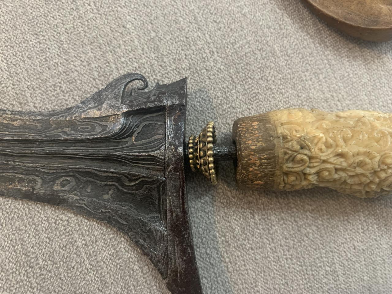

Pedaringan Kebak is a sub-type of wos wutah, it is an individual opinion in respect of whether or not the amount of the core covered by the pamor motif is sufficient for that pamor motif to be named as pedaringan kebak, naming it as this doesn't really change anything, it is stiil wos wutah.

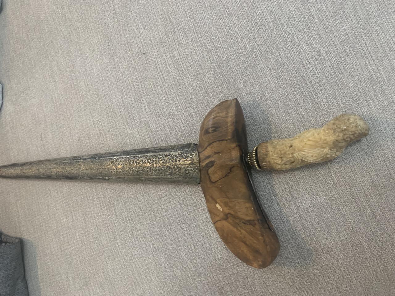

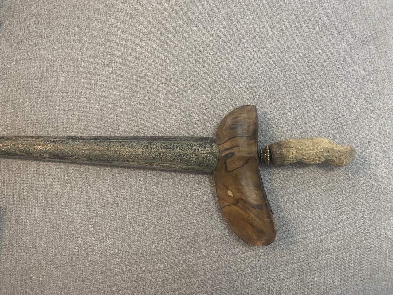

However, in order to determine whether a wos wutah pamor can get the extra little lift of "pedaringan kebak" we need to clearly see the full blade, both sides.
Take the photos in open shade, use a small aperture, ie, larger F stop, probably something of F11 or above. Most phones take pretty bad photos, newer , expensive ones are not bad, but what most people have just don't cut it for halfway decent keris photos.
