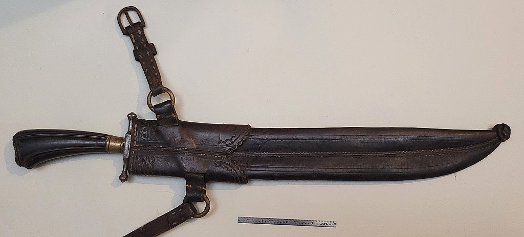

Question Knife with a Spanish Influence?
I acquired this knife in 1973 in a general antiques shop in Laguna Beach, California for $75, described on the receipt as a "Spanish knife" and presented, if I recall correctly, as a relic of Old California. The blade is 13½ inches long. The grip is well carved dark horn with a brass ferrule and figural cap. The sheath is not original to this knife, as the knife only fits in backwards and opposite to the implied geometry of the sheath mouth. I solicit your opinions on where and when it is actually from.

As always repurposed and ersatz alterations are hard to peg, and often reliable provenance are the best ways to try to estimate. The hilt, and guard seem like earlier hunting hangers around mid 18th c. and for that matter the remains of forte motif seem to suggest same.
What seems to suggest the Spanish influence is the slight uptick in the clipped type point, often derisively termed the 'frog sticker' by frontiersmen in the 19th c. ..a feature often seen on espada anchas of Mexican period post 1821.
The face on the pommel cap suggests probably British or possibly German hilt.
Lots of unique shops in Labeena Gooch (as we called it in the day) and one of my first 'Spanish colonial' swords was an old dragoon sword, in a boutique window, but festooned with costume jewelry necklaces. As I looked at it, with the blade and 'Spanish motto" ...draw me not without reason...... I was horrified at the disgrace. I bought it for a paltry sum from the owner who saw only a dark old sword, rather than the blade of honor of a now long gone caballero.

Hi Lee,
The sheath is northern Philippine without doubt (Vasayan IIRC). If you are interested, I can post examples in my collection. I see nothing about the dagger itself that is inconsistent with the same area. This would also account for the "Spanish attribution. What is also interesting is the clip point. Since the blade appears to pre-date WWII, this is further evidence that the Philippine Bowie existed as a type before the war and wasn't just created as a souvenir created for US servicemen.

Hi Rob and Lee,
Interesting knife, Lee. I agree that there is a Spanish flavor to it. The short brass cross-guard with terminal balls plus a horn hilt is very consistent with a Spanish origin.
The sheath is reminiscent of Philippine models. However, the decoration at the throat of the sheath does not look Filipino to me. Rob has suggested a northern Luzon origin, and I think he is referring to Ilokano sheaths that are often black. But this is not an Ilokano sheath--the style is wrong IMHO. I think the motifs on th sheath and the treatment of the sheath's tip are more likely Mexican colonial in style. The fact that the knife does not fit the sheath makes the sheath somewhat moot, and perhaps culturally unrelated to the knife.
"Spanish colonial" seems a good designation for the knife.

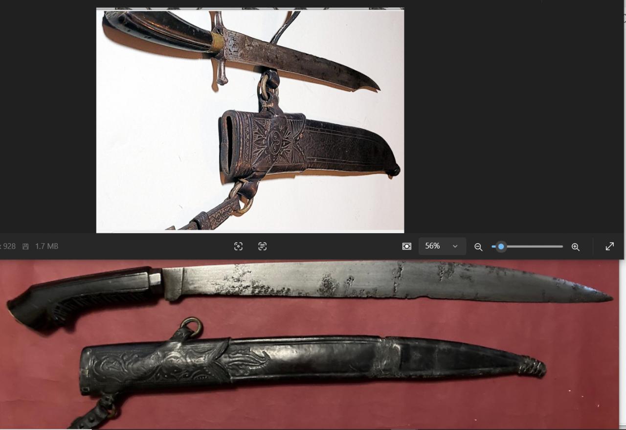

Ian,
Here are examples of this type of sheath from my collection. All the blades are plainly from the Philippines. In the cases where the entire sheath is present, the blades fit the sheaths. The fragmentary sheaths fit the area of the blade by the hilt.
All examples have a leather throat reinforcement with a scalloped bottom and, in all cases, the reinforcement is pierced on the sides to accept a diagonally transverse belt. Even in instances where the belt is missing, this piercing is evident.
I know that blades that have lost their original sheaths are frequently paired with improper replacements but, with this number of examples, I think it is safe to conclude that these sheaths were part of Philippine material culture. Whether they were adopted from Spanish designs, I can’t say.
Sincerely,
RobT

Rob, no question that the sheath of the original post resembles sheaths from Luzon. However, the resemblance is not entirely convincing for me. In particular, the decorative area showing a face and radiating rays is atypical of Filipino work IMHO. The attachment with an angled strip across the sheath and two rings to attach a belt is an arrangement seen on knives from Laguna and other areas in Luzon, as you have shown with those examples.
Since the sheath does not fit the knife in the usual fashion, then I think we need to discard the sheath when identifying the knife's origin.

Ian,
A sun with a face and eight rays was on the flag of the Philippine resistance against the Spanish (and later the US). I count eight rays on the sun on the sheath (three on the top, three on the bottom, one fat one at 9 o’clock and another fat one [partially obscured] at 3 o’clock). The rays at 3 and 9 o’clock are short by necessity and I believe that they are fat to give them prominence. If the sheath was decorated during the Philippine resistance period, it is quite old and quite a find.
Regardless of area of origin, my point in my initial response was that the sheath is from the Philippines. That being said, I wouldn’t be too quick to discard the notion that the knife is also. As I said in my initial response, I don’t see anything about the knife itself (design, construction, materials) that would rule it out as having been made in the Philippines. It easily could have been made for a Filipino who wanted a Spanish style knife or it could have been made for a Spaniard living in the Philippines. An old leather sheath can shrink enough so that the blade it was made for no longer fits. Other plausible explanations: Somebody in the Philippines had a knife and and a sheath that fit together well enough (albeit backwards) for carry. Somebody in the Philippines had a knife for sale and paired it with a sheath to make it more marketable (as is done all the time by sellers in the US).

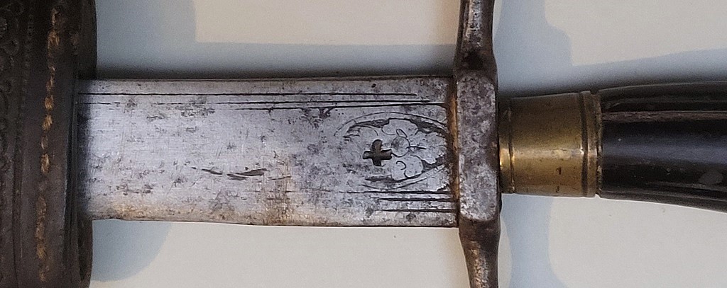

Thank you gentlemen for your comments and insights. Though the knife and the sheath clearly did not start together, both show some age and neither shows evidence of meddling that I can discern aside from evidence of many rehonings.
Here attached are two additional views that I neglected to include in the original post.

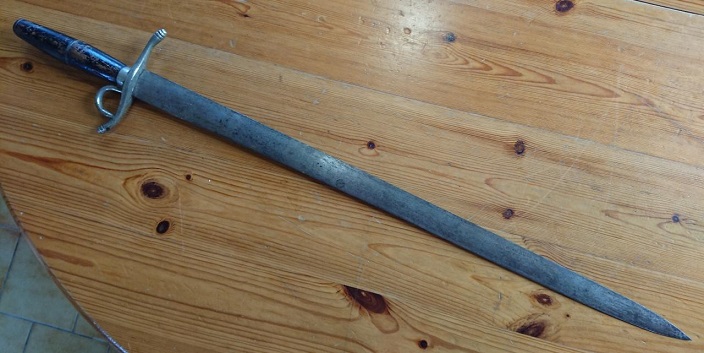

Hi,
An 18thC French hunting sword of mine, the hilt form would suggest a common lineage.
Norman.

Below is a picture of the sheath and knife oriented as they would be looking down if belted to the wearer's left side. With the decorated face out, the distal curve of the sheath is reversed compared with all of Rob's examples. The knife is lying as it would go into the sheath and the end is what governs the only way it can go. The narrow (edge) side of the mouth is to the front when strapped on to the left, but the one-sided taper of the end is reversed. In the end, this sheath appears to have been made wrong. The strap worn at its maximum buckled length accommodates a 38 inch girth.
A bladesmith friend of mine with Mexican heritage considered the leatherwork to be consistent with Mexican work in several details, but Rob's several examples strongly argue for a Philippine origin. My friend showed me a Tarahumara (a northern Mexican people) utility knife from the late 20th century and I include another image below as the clip point is similar.

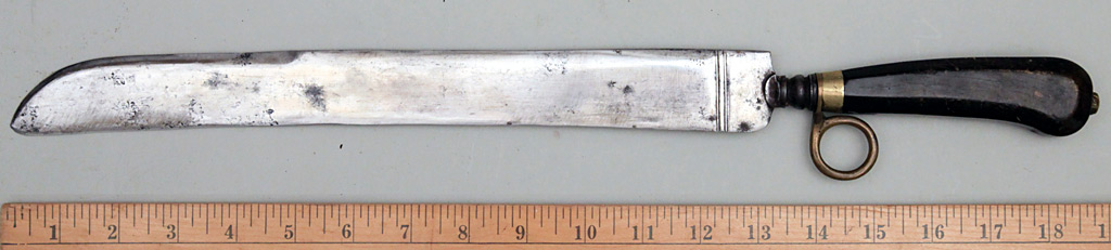

I will entirely agree that the strapping on my sheath is designed for left side carry and right side cross draw. Maybe it may actually have been used with the knife in the past as the knife is narrow enough to be inserted, but, as noted, the mouth is quite wide compared with this blade.
Below is an image from Lew's estate sale of a knife of unknown origin with the cutting edge on the slightly concave long edge that would likely better fill this sheath and in the right direction for left carry, right draw.
My knife is unusual and good observations have been made above. I guess the question is whether it is something left over from Spanish colonial times or totally unrelated.

Hi Lee,
Lew's knife is consistent with a Spanish colonial origin also. The ring for the first finger is found on espada ancha and occasional knives of Latin America.

Well noted Ian, these 'finger ring' types of edged weapon are (according to Levine '85) dirks from Central America. Not sure of the scope of examples with this distinctive feature, but the scope of diffusion throughout Spanish colonies is almost immeasurable. The Spanish main extended from the Caribbean, Gulf colonies, Mexican coastal ports and extended to the Spanish Philippines, and weapons of all forms were aboard the vessels that plied these vast trade networks for centuries.
