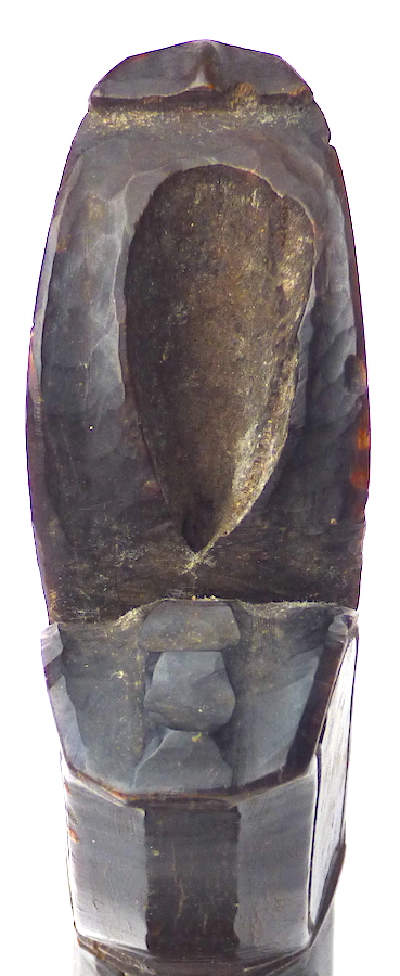

Hi Ian,
Yes, your sword shows clearly signs of use, can you show us a pic from inside the makara mouth? (see pic.)
It's not easy to classify a semarang from Halmahera, like you can see by the given threads and the there shown examples these swords show differences in blade profile as well by the handle design. So to be 100% sure would be dubious. Since mine are collected on Halmahera by myself and family members I am sure that my ones semarangs.
And yes, my wife is born on Halmahera, Galea, asli orang Halmahera so to speak.

Hi Detlef,
This is the best I could get with indoor lighting. If you need better shots I will try tomorrow in daylight.
Regards, Ian

Hi Ian,
My educated guess would be that you have there a semarang from Halmahera with some unusual features.

P.S. Another shot of inside the mouth. On closer inspection, I believe that the hilt is actually wooden.

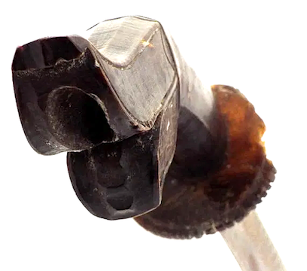

Thank you Ian! Are you really sure that the handle is from wood? On all your pictures I get the impression that the handle and as well the small guard are from horn, i. e. water buffalo horn. Have you tried the hot needle test? I would do it to be sure.

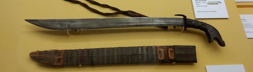

Another possibility, Ian, might be Mandaya.
Old 19th November 2025, 07:33 PM   #10
Hi Jose,
Very good possible, would explain the blade decoration. But the only similar handle by a Mandaya sword I found is the one in the picture attached.
