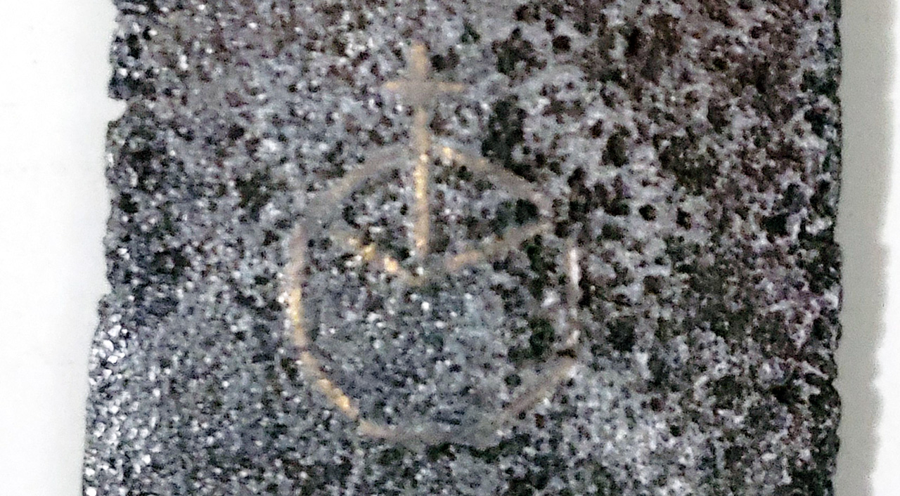

Hi Lee, super interesting! Could you please tell me more about the technique used and what all the numbers mean?
The first sword looks good and authentic in the photo, in my humble opinion. What were your concerns there?

The numbers on the 'maps' are the points where a reading was taken. I was using an Olympus Vanta handheld XRF device, so the 'points' measured are of about a quarter of an inch in diameter or so. This instrument will download a file of the device's interpretation that may be imported into a spreadsheet for manipulation (as well as the raw spectra data, should one have the skill to interpret that) and I can then note functional location and features and sort the array of readings by that, as the numbers label the lines in the spreadsheet.
It gets overwhelming quickly and the interpretations presented in this thread are merely "was gold detected - yes (a gold dot on the spot) or no. As I prepared this reply I returned to the spreadsheet to get the composition of the latten (medieval brass) of the inlay and then I noted that lead accompanied the gold where it was found. (Fortunately, the Internet led me to an academic paper explaining how this could improve adhesion of the gilding.) By the way, should you be curious, the latten was 65% copper, 34% zinc and 1% lead, rounding to the nearest percent. I will explain more about my methodology when I present my upcoming thread on elements associated with iron inlays and pattern-welding.
My concerns for authenticity arose from 1) I bought this sword in the late 1980s at a gun show in the US admittedly from a British dealer that I had dealt with previously and 2) a few bladesmiths of my acquaintance had expressed concern about what they felt was a lack of robustness of the tang.

That crowned orb is very similar to those found on German export blades, but I don't know by how much this predates the C16th and C17th.
