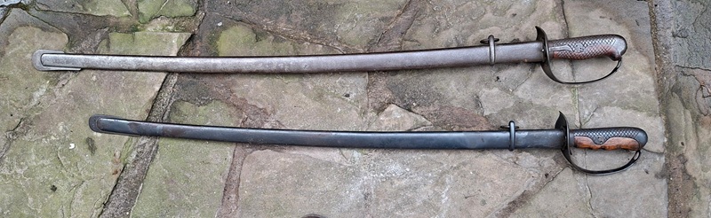

I have been dipping my toe into the world of military swords. Rather new to me. This change is due to the fact that ethno weapons have become ridculously expensive. There was a time when militaria dealers let ethno stuff go at reasonable prices as they knew little about them. Not the case now even though largely they still know little about them. The ethno dealers have gone mad in my oppinion. The value for money for some military sword in the UK has amazed me, so I now have a small collection. One is unlikly to find a sleeper in military swords.
What I would like to know ; is there acode of conduct , for want of better words , about cleaning or even polishing military swords? which would have been kept clean in the days of use. Here are two Japanese swords common items. The baldes are fine but what about the scabbards? The infantry one has chrome plating tanished blue black, should I clean them? what with? what metal polish is used? Thanks in advance.

For me re: cleaning etc........one word most important....restraint!
I think just stablilizing any corrosion or damage, but leaving patination etc in place is best. Overcleaning or any notable cleaning is often seen as diminishing the collectible integrity of the weapon IMO.

Probably chrome polish as used from automotive stores. Chrome is a quite modern category so I dont think that would be impairing if applied.

I'm a true novice also to swords and edged weapons. Personally I'm taking the approach that everything gets a light surface cleaning with Ballistol on a sponge or microfiber cloth and then any active rust and heavy tarnish removed (or lightly brightened) with some Autosol on a soft toothbrush or microfiber, which is a light polish, very light abrasive. That seems to get the light surface dirt and active surface rust off but I leave any thing deep or aged patina on it as-is. I dont go deep and don't heavily polish. Another hit of Ballistol for protection then hit and wipe with a light coat of Renaissance wax to finish. Hope that is ok but experts please let me know if anything I should be aware of? At some point it becomes an "it is what it is" approach and acceptance...is this like the Seven Stages of Sword grief maybe? Cheers!

The longer sword is an older cavalry sword, with the other infantry nco.

Spot on Murph! Stabilize, get rid of active rust, but KEEP patination! I always think of it as 'history incarnate' ! guess its the historian in me. I personally love leaving the 'dark warriors' as they are.
