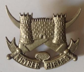

As noted, the Scots were well present in India, and the basket hilt form present in many circumstances, particularly militarily of course. One instance of profound influence has always come to mind was to the north in the latter 19th century.
In research years ago on one of the paramilitary levees in Afghan regions, The Khyber Rifles, I was surprised with some of the photos I received from sources.
In Afghanistan the British military influence was notable, especially from the Scottish regiments, and Afghan forces adopted elements of their uniforms and weaponry. There are images of the Highland kilt and other uniform items.
