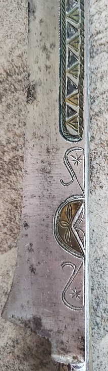

While I cannot claim any expertise on these weapons, I had a keen interest in the Kabyle 'flyssa' many years ago. These swords of course have distinct character and seem to have a range in sizes, but the curious indiscernible 'zoomorphic' (?) hilt, guardless, and the typical Byzantine oriented and linear fibula designs overall are consistent.

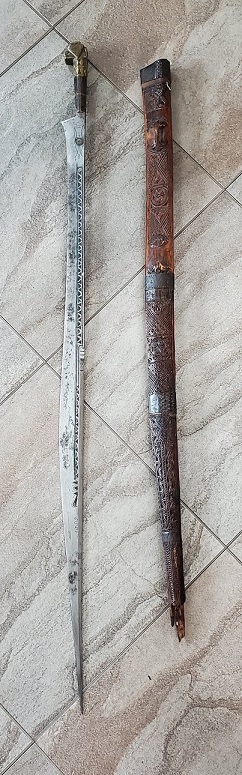

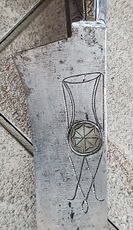

The example I have (attached) is characteristic, and the extremely long and quite heavy blade is in my opinion very poorly balanced in accord with the small brass guardless hilt. The hilt and blade designs are basically of the same style as traditional examples, however there is an unusual device which I think is a drum. These kinds of personalized elements seem to reflect what I have been told on the flyssa...it was a key object in a young mans rite of passage into manhood. Each reflected this personalized character in some manner.
With that, and in accord with notes in this discussion on whether weapons were for use or decoration...., I have never seen any satisfactory evidence or accounts of the flyssa used in battle. There are images of Kabyle warriors holding them along with guns in posed positions, but I have never heard anything on how these weapons could be used.
I would be grateful for any substantiated evidence that the flyssa itself was EVER used in battle.

Kabyle flyssa traditional form three pics, the typical apotropaic linear fibula motof; the individual design (drum?)

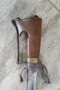

The Moroccan sa'if (nimcha) far right, note hilt design in vogue for centuries (Buttin, 1933, notes many examples shown as 17thc)
