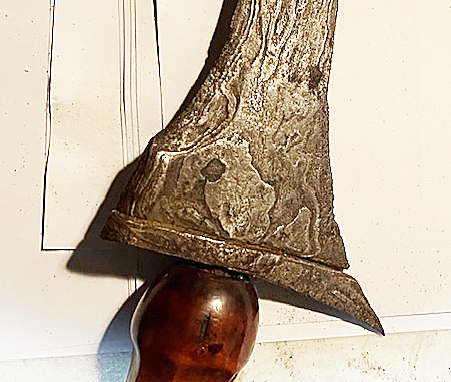

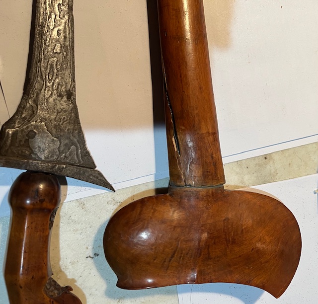

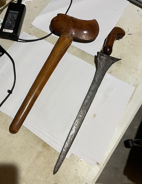

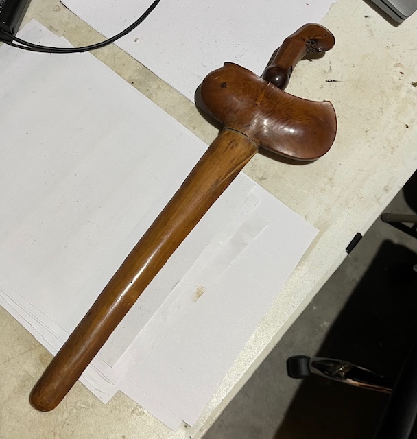

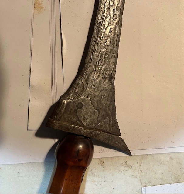

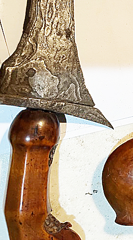

I tend to agree with Rasdan on the blade origin. Certainly not Sumatran. Blade is most likely 19th century. It is difficult to know if the wrongko is original to the blade based upon your photos. How well does the blade fit into the sheath? I would think it is unlikely that the hilt is original to this keris since this is a Surakarta form of planar hilt that would not be a natural fit for it.
You can find both new and used mendhaks fairly easily in places like eBay. And yes, the hilt should be turned 180º for a proper orientation.
