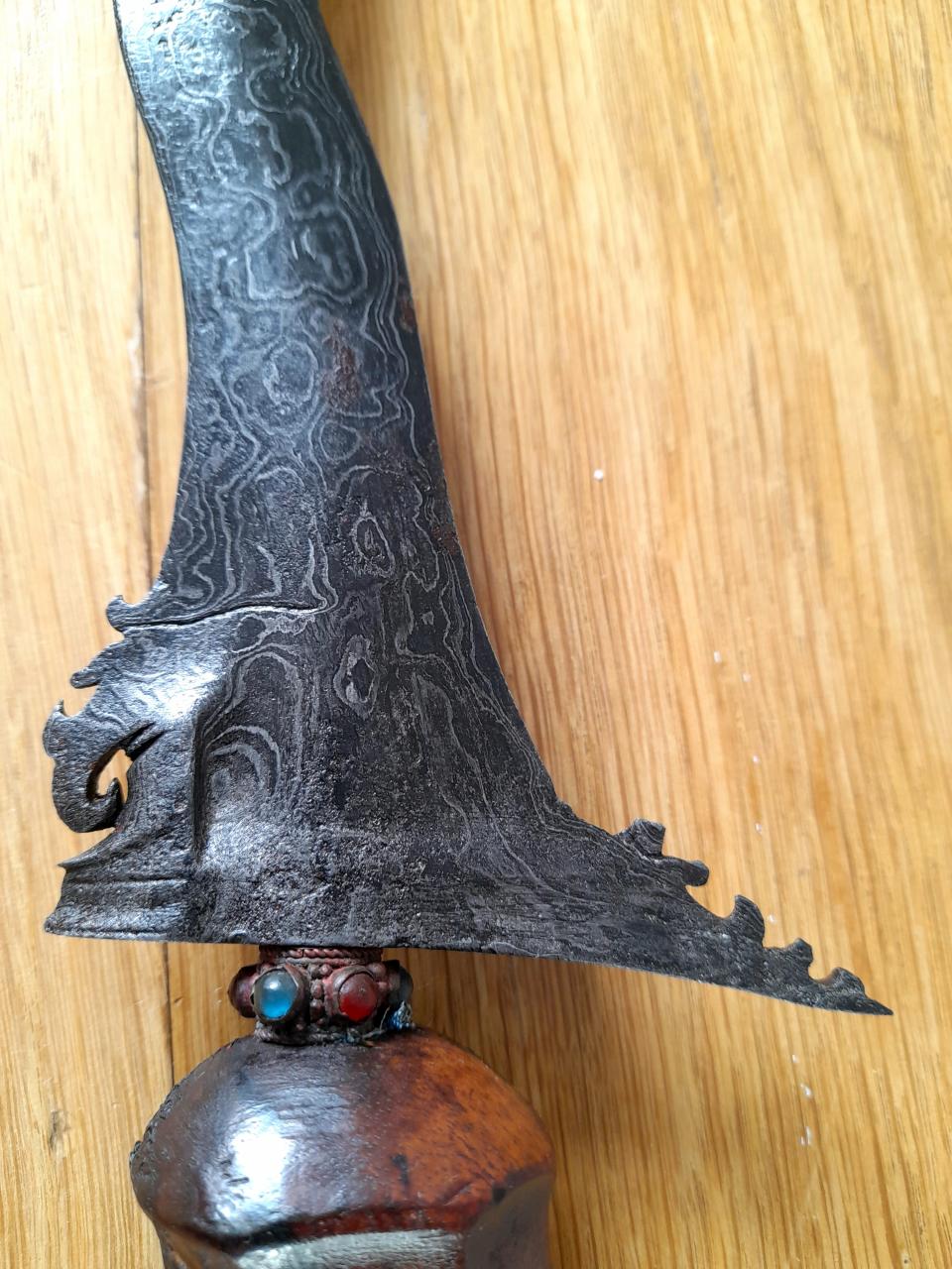

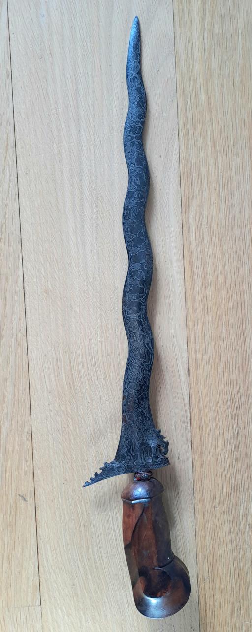

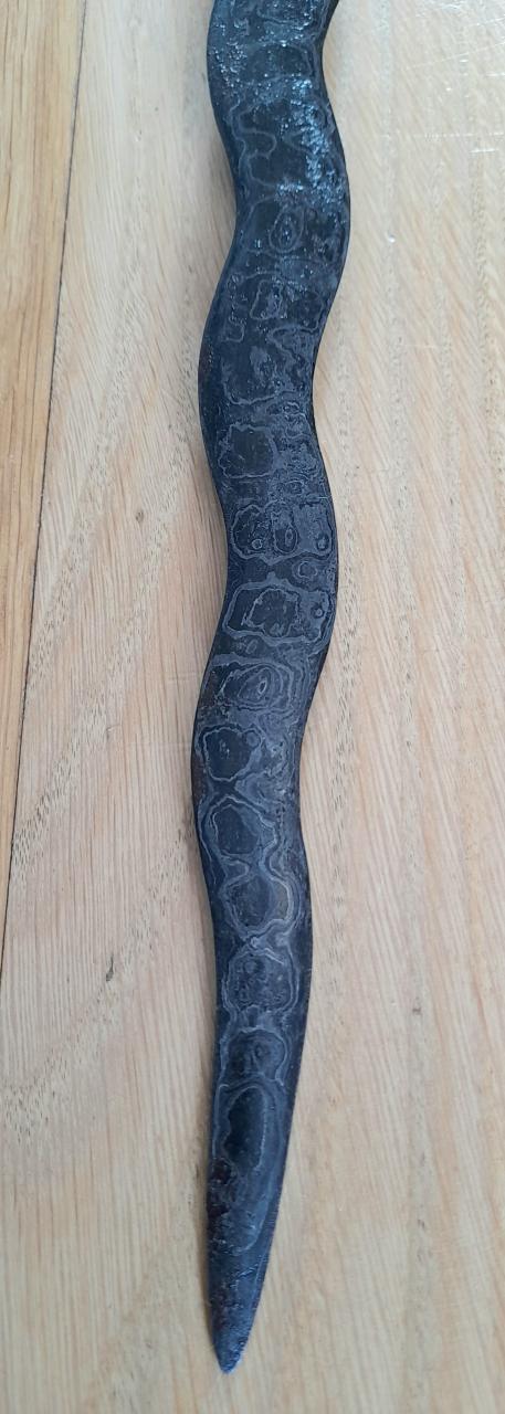

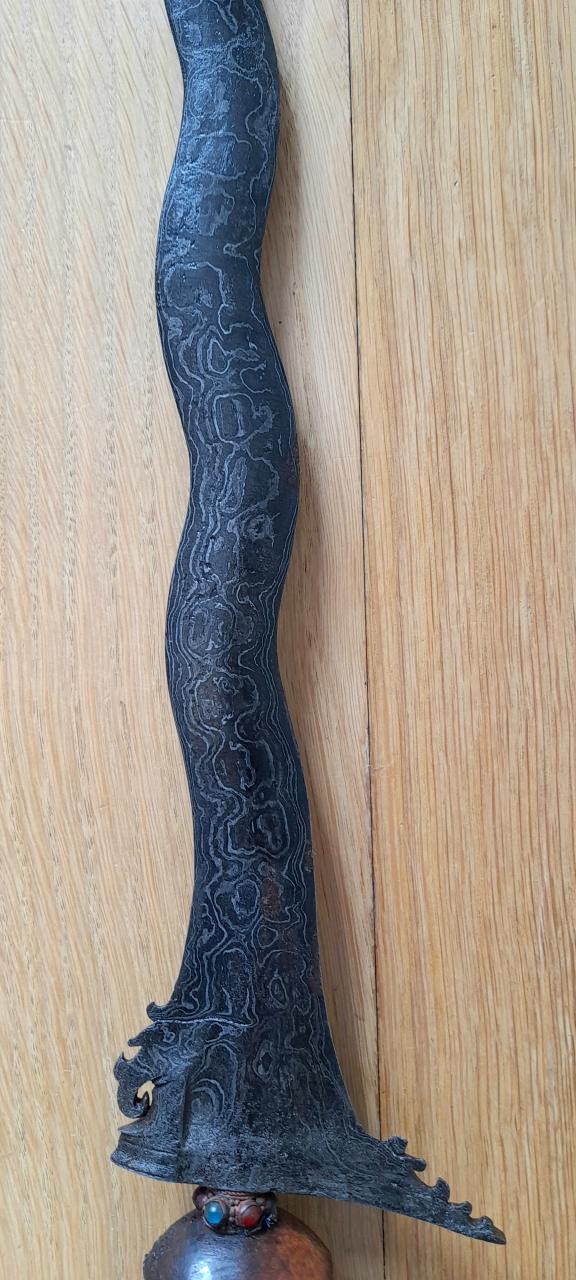

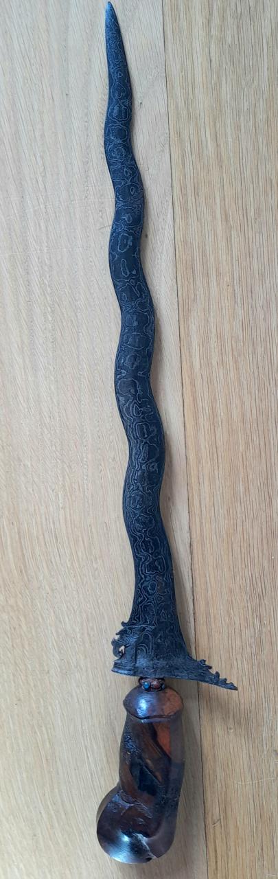

Hi
Further to my previous post, I would be grateful for your views on the likely age and merits of this Bali gonjo iras 9 luk keris. I restained the blade as there were areas of rust. The horizontal line above the trunk is interesting. Is the pamor uler lulu or bendo sagodo? Blade is 40.5cm. Thanks

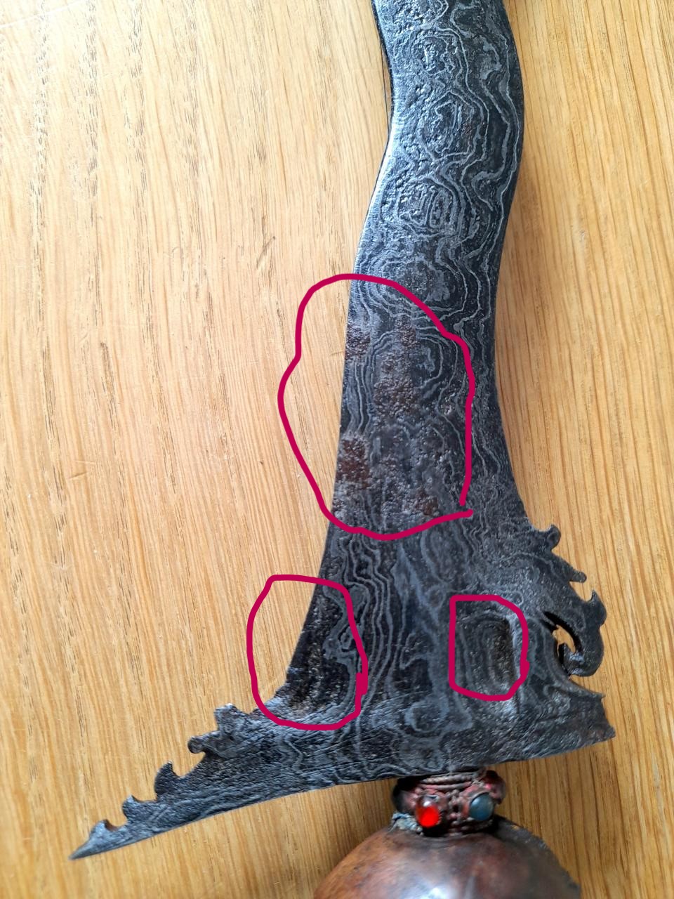

Hello Sid,
Good result of the staining! But you should redo it but first make sure that you have removed all rust, I still see a lot of rust, see pic.

Hi Detlef
Yes I got impatient and wanted to see if I could bring out the panoramic. I will work on loosening the remaining rust.

Sid, the reason that I have not commented is that if I cannot say something positive I try not to say anything at all.
Going ahead with a stain job in the absence of the essential blade clean beforehand is really not a good thing to do, it simply makes the job longer & harder.
You did ask three direct questions:-
1) age of the keris, I take that as blade only, it is probably 19th century, possibly earlier, not later, additionally it is probably Lombok/Bali, not Island of Bali.
2) comment on merits, I can see nothing in particular that would set it apart from the average run of older Balinese keris, except of course the lack of a separate gonjo, there is some loss of detail in the carving, which is the reason I opted for the "possibly earlier" comment in 1).
3) is the pamor motif bendo sagodo or uler lulut? I would give it as bendo sagodo, but in Bali it would most likely be given as pamor santa, both bendo sagodo (bendha sagada) & uler lulut are Javanese names.
A. G. Maisey is online now   Reply With Quote
