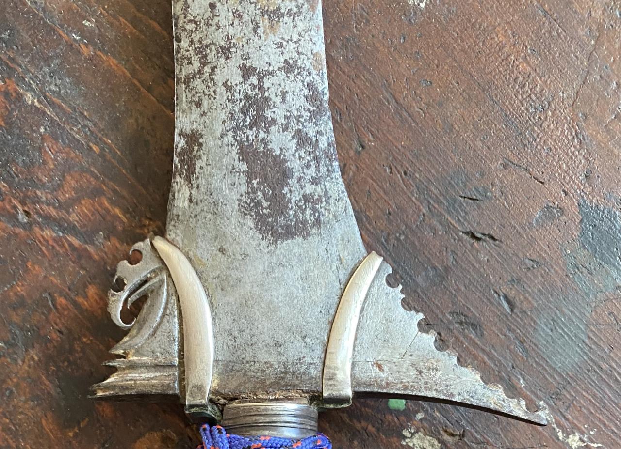

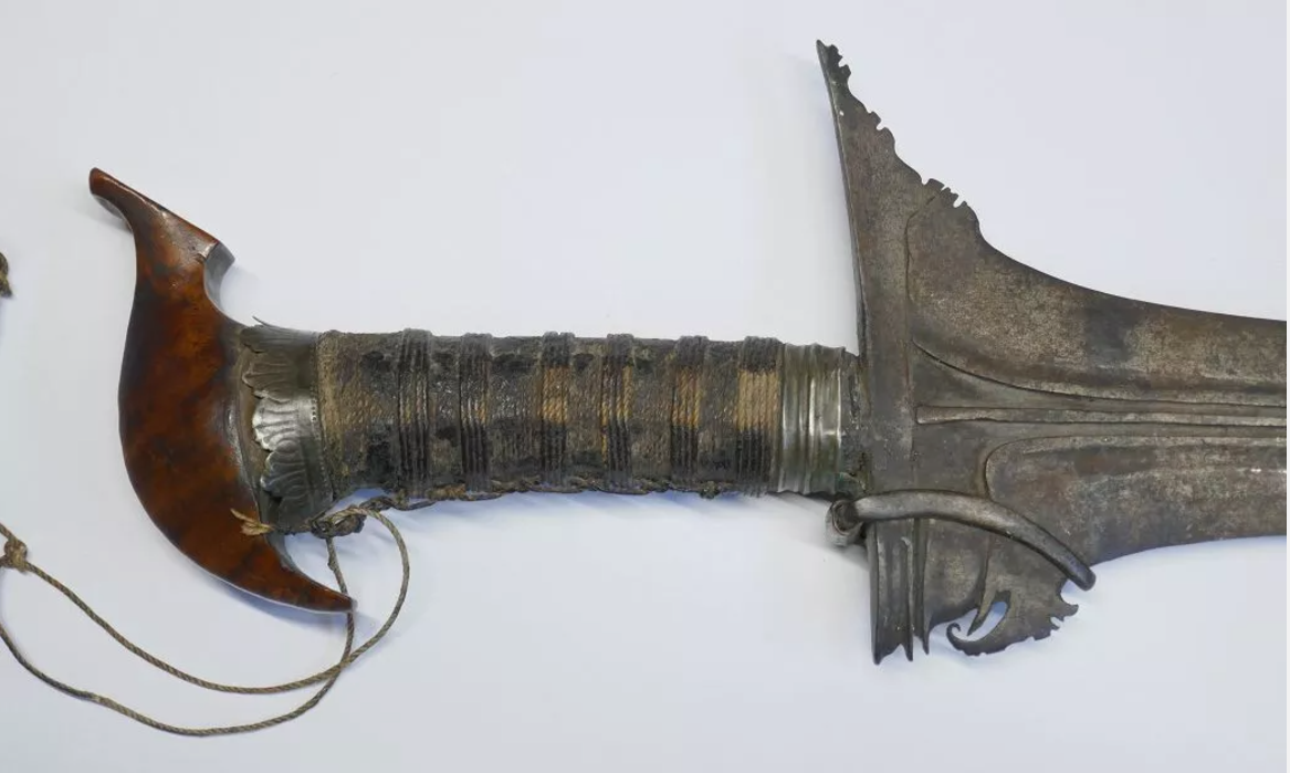

Hullo IP! Thanks for reading my article (and thanks for the referral as well Ian!)
As you may have noticed in my article, the samples were from a particular era (late 1800s-early 1900s), as those were the kalis and kris that I've been most exposed to, and had the privilege of studying. I believe all the samples you presented in this post fall under that era.
I look at all the details at the base of the blade, particularly the elephant trunk and the 'katik' or notched guard. Then there are secondary considerations... for example, Sulu kalis usually have slightly smaller blades than their Mindanao counterparts; Maguindanao blades have an outline at the elephant's "mouth," Maguindanao and Maranao battle blades have raised spines at the middle, etc.
If I were to label your sample-blades from left to right as A, B, C.
A is a bit blurry, so I can't give an ID. Meanwhile, B is likely Maranao. C is likely Maguindanao.
The dress of A is Sulu; the scabbard, kakatua and proportions to the hilt, the way the asang-asang are attached to the hilt, the ferrule- all Sulu in my eyes. I believe the dress is as old as the blade, or at least belongs to the same era.
The dress of B is also Maranao- but if what I'm guessing is correct (that the material used is aluminum), then it's of WW2 or postwar make.
The dress of C is Maguindanao. I believe the hilt wrap may have been "upgraded" at a later time. The hilt wrap looks like brass wire-wrap with interspersed brass bands. The asang-asang is also brass, possibly upgraded the same time as the hilt.
