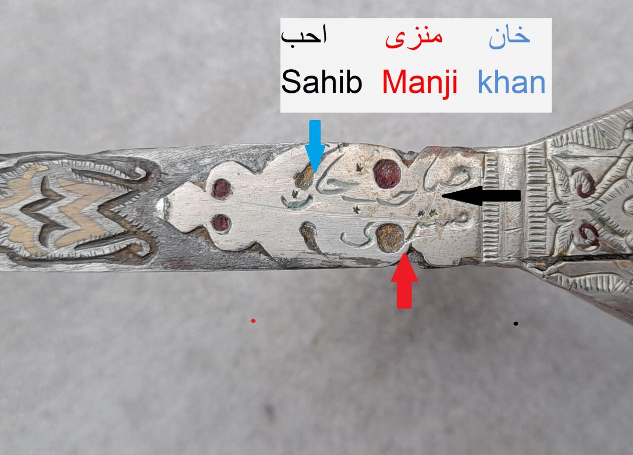

Hi all,
I posted pics of a choora on the thread " Show us your choora" in which the difficulty of dating such knives is discussed.
On my blade, there are some inscriptions in Arabic or Persian that I can't read.
Can anyone tell me if it's a date, a place or a maker's mark?
Any comments will be greatly appreciated.
Regards.

Hello. The inscription is most likely the name of the owner:
"صاحب منزى خان" (Sahib Khaan Manji)
Hi Turkoman.khan
Thanks for translating the inscription.
I'm wondering about "SAHIB". Is it a "given name" like John or Bill ?
I read it was used in the past to give respect to someone you talk to, as a polite manner to adress or as a title.
Can then be deduct this knife was a gift or a present to a "KHAN" a leader or a chieftain named MANJI ?

Originally Posted by Hagard View Post
Hi Turkoman.khan
Hello, Hagard
I think your version is correct.

Hi Turkoman.khan,
I was just hazarding a guess ... nothing certain of course.
May I ask you f the colours of the translated words are correct?
Hi Turkoman.khan,
I found another choora on the site with "similar" writing on the blade but sadly the pics are unclear. I'll try to contact the owner to get some close-ups.
Hello, my friend. Yes this is correct
