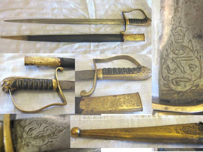

What do you think this is?Turkish or Arabian with European blade? Military?What can be the reason for it to carry western looking royal signs on its scabbard mountings then? Perhaps could be from kingdom period Egypt?Authentic or a later composition/decoration?

Eickhorn use to make a very similar sword. Probably European made and then locally decorated. Are there any manufacturing marks/military marks on this?

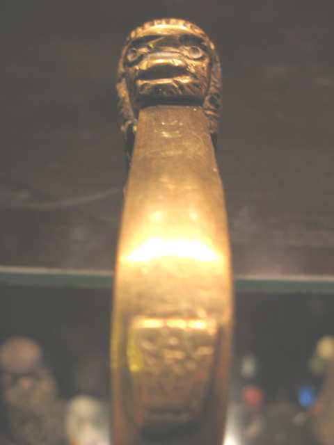

This one creates an uneasy feeling because it looks like a parade weapon, and parade and award weapons are usually of much better workmanship, especially when it comes to fittings. However, if it is authentic, one needs to ask the question which Middle Eastern Monarchy would use a lion as a symbol or on its crest. Perhaps this comes from Pahlavi Persia, as most other nations would have eagle hilted swords?
Old 8th July 2006, 08:22 AM   #4
Posts: 6,025
Strange mixed bag of styles and influences. The engraving is a little poor.

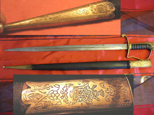

n2s,there is no maker's sign anywhere. TVV,the lion on crest doesnt give much clue, cause Ottomans who traditionally doesnt any lion symbol used the same lionhead too - on admirals' swords from late 19th c. to 20th c. -. Tim,I completely agree the engravings are quiet poor for such a military item.So poor that they don't add any to the sword's overall looking but takes from it.But,if they are all later to the sword,why did it not have any sign or stamp in the place of the engravings on the blade, and were its scabbard fittings original completely empty,with no decoration? The scabbard leather looks old and worn. (From the pictures.I havent seen it in real, just the pictures sent by a seller)
By the later half of the 19th century the sword makers knew that the military was no longer interested in their products. So they started marketing to the civilian market. This led to the production of a wide variety of society swords; which would have been used as part of the social/parade regalia, given away as trophies and awards, or presented to members of various services upon their separation. These were not military issue, they would have no unit or acceptance marks, and may not have even had a manufacturer's stamp. This was likely a privately purchased sword which somehow found its way to a bazar, and was decorated to spark tourist interest. I suspect the story they peddled with the sword would have been much better then the quality of decoration.

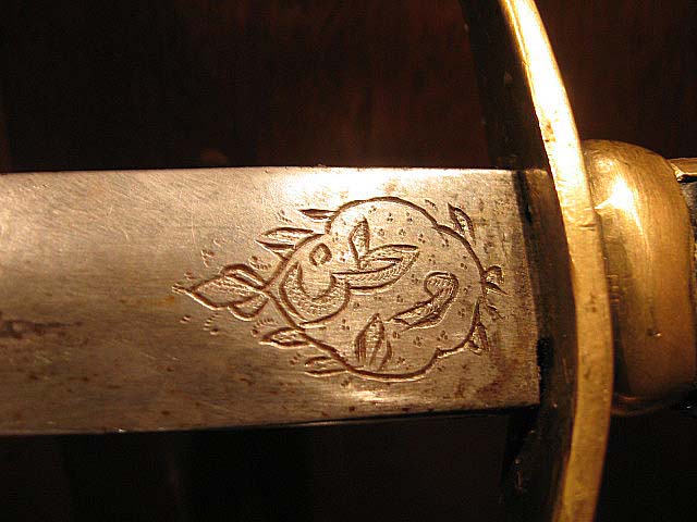

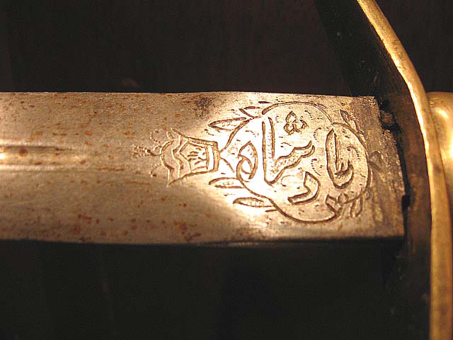

Just my two cents. I would vote Iranian for a number of reasons. The first is the crown emblem engraved on several parts of the sword resembles the Qajar and Pahlavi state crown. I've seen it in books but I don't know if anyone on the forum has pictures of it. I can't seem to locate mine
Interestingly enough, the words engraved on both sides of the blade is Arabic letters are 'Watan' which is Arabic for Nation or Land of Origin (denotes nationalist sentiments?) and Badshah or I think the Turkish equivalent is Padishah, which is a sultanate and imperial title I think.
