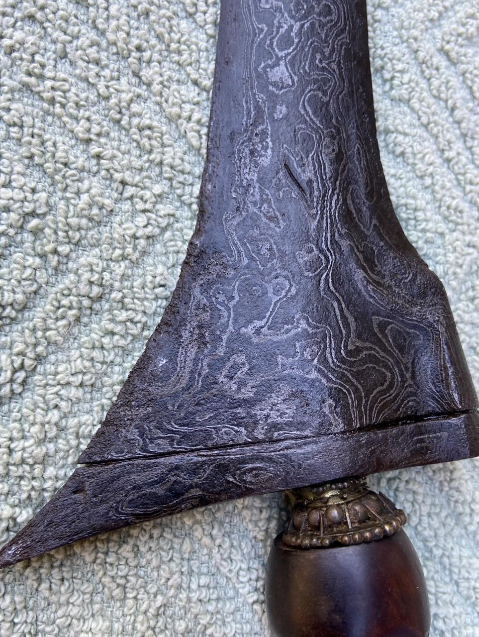

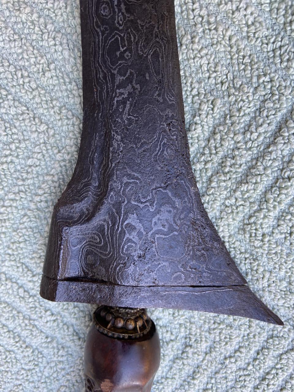

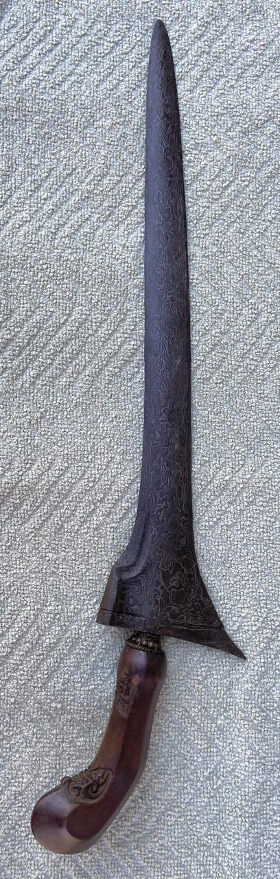

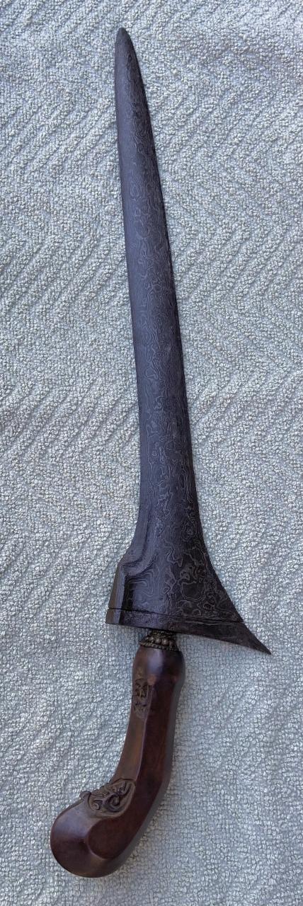

I found this Keris in a pawnshop in a little town in Southern California. I would love to know what you all think. Thank you in advance… This forum is invaluable!

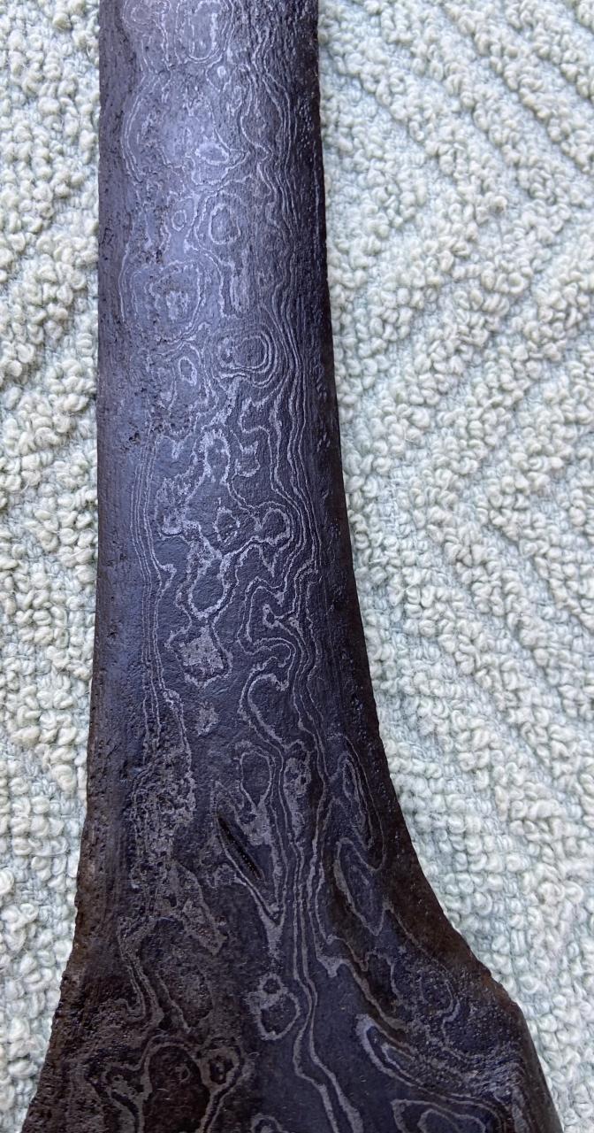

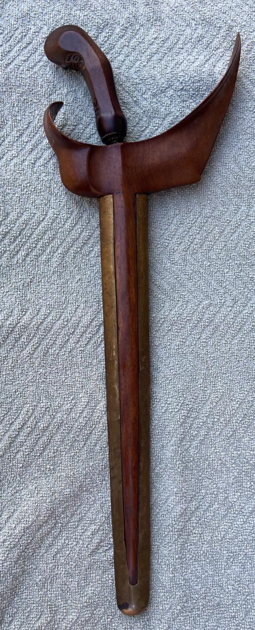

Seems like a pretty decent "everyman's keris". Nothing particularly fancy here, but it seems to be a well formed dhapur tilamupih (?) with good pamor. The sheath seems to be wrongko iras (all one piece of wood), which is always a nice find. Ladrang Capu? Does the blade fit the wrongko correctly. Seems to need a little TLC, but basically in good condition.
As a pawn shop buy i trust you got a good deal on it? I love when we find keris in unusual and unexpected places.

they had a few others in there, including one that has been sanded so badly that all the pamor was gone. (Sigh.) this one at least was in pretty fair condition. Thank you, Alan, for your no nonsense explanation on how to wash it with detergent and a toothbrush and give it some WD-40. Yes, the scabbard fits perfectly.

I think this keris is likely to tangguh Tuban. |

You should polish up the brass pendok (over sheath). Pamor is wos wutah. Regards, Detlef |
