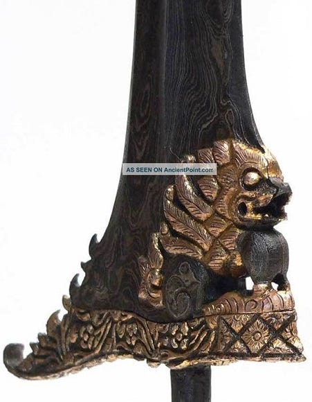

Hi! I am new to the forum. Thanks go out to the admin for letting me in.
I was lucky enough to find my first keri. But, I do not know anything about it. I am hoping that the group can help me better understand the piece.
It is a 16" blade, 21.5" total length.
Thank you in advance for any assistance.

Helllo Mariec,
This looks like an old (19th century?) balinese blade of good standard although it would benefit from being cleaned & treated for improving the pamor contrast. The winged animal at the base (naga?) looks original to the blade from the pics but it could be more recent.
The wooden hilt in togogan "demon child" style is recent and of common quality.
A good catch for a first keris, congrats!

I would have loved to have found this as my first keris. I agree with Jean pretty much based upon what i can see, though the winged figure seems more a Singo (lion) then a Naga (serpent). It's hard to be sure from your photos, but i agree that this figure appears to be original to this blade. I would say this could be more likely the earlier part of the 19th C than the latter. I would see how well you can clean this up with a bit of WD-40 and a good brushing with an old tooth brush.
It would be nice to see clearer, closer and better lit photos, especially of the figures at the base. I would like to get a better look at the smaller figure at the foot of the winged singo creature.

The lion on the blade might be a later addition, as Jean has noted, I'd need microscopic examination to know this or not. Later additions to blades are not necessarily a bad thing, they sometimes reflect the changes in custodianship of a keris.

Agree with the others, a very nice blade! To my eyes the singha looks original to the blade!

please compare the crispness of the details of figure and the state of remnants of Greneng.

Yes Gustav, that Singa does look a bit less worn than other parts of the keris, but when we understand the how, when, where & why of various symbols to a Balinese keris blade, this is not really something of great importance.
The only way I can form a definite opinion on whether a symbol such as this Singa is a addition to a blade is by examination of the blade under magnification.

Alan, a bit less worn in this case is an euphemism.

I do try to be gentle Gustav, especially when I'm looking at an image on a computer monitor. The photo that we're trying to see things in is simply not good enough to show the grain of the metal, to see that we need good light & something like about a 5X jeweler's loupe.
But then, even if we did find that the singa was indeed a later addition, we still would not know why it was an addition, & that is really the crux of the matter.

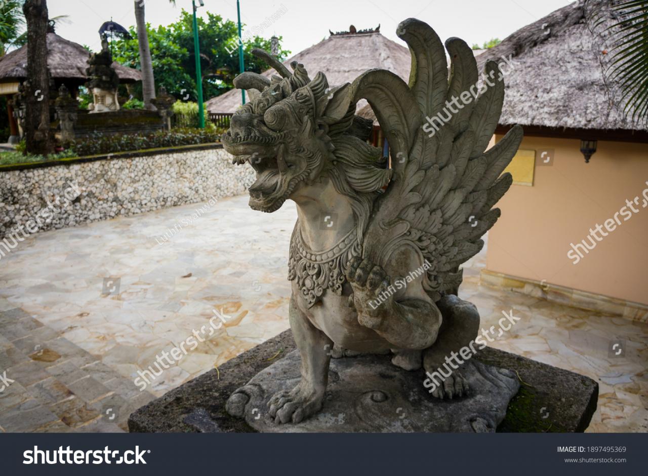

IMO the carved winged animal on the gandik does not depict a singa but Garuda, see what it is holding in its front legs (snake or turtle?) and compare with the attached image from the Tropenmuseum.

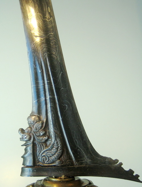

A depiction of turtle as a base of another figure is not uncommon at all on Gandhik of Balinese Keris, but I have yet to see an authentic Garuda depiction on an old Balinese Keris.

This is my opinion only but this carving does not look like a standard singa for the following reasons:
. Head: fangs, bulging eyes, ears, hair
. Wings
. Sitting position, no penis, unclear tail, animal under its front legs.
I don't remember to have ever seen such a carved animal on a balinese blade but would be curious to see a similar one. However I admit that it has no clear beak so that it may not depict Garuda.
