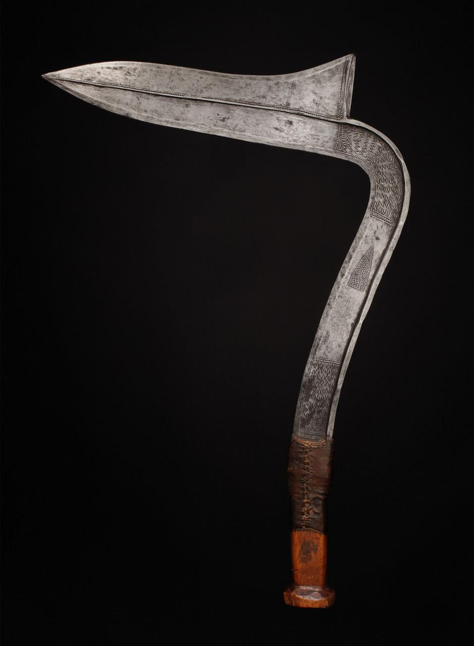

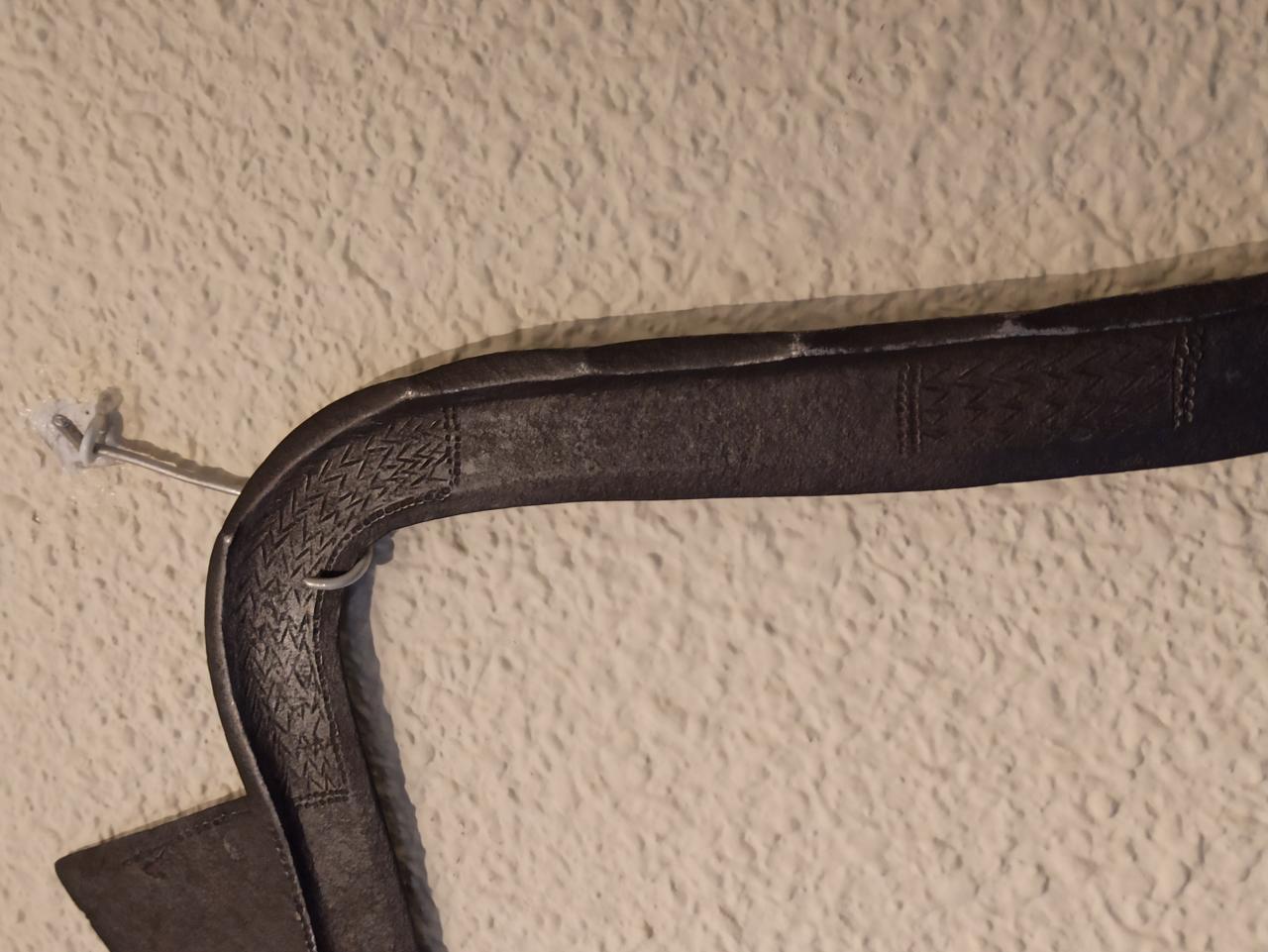

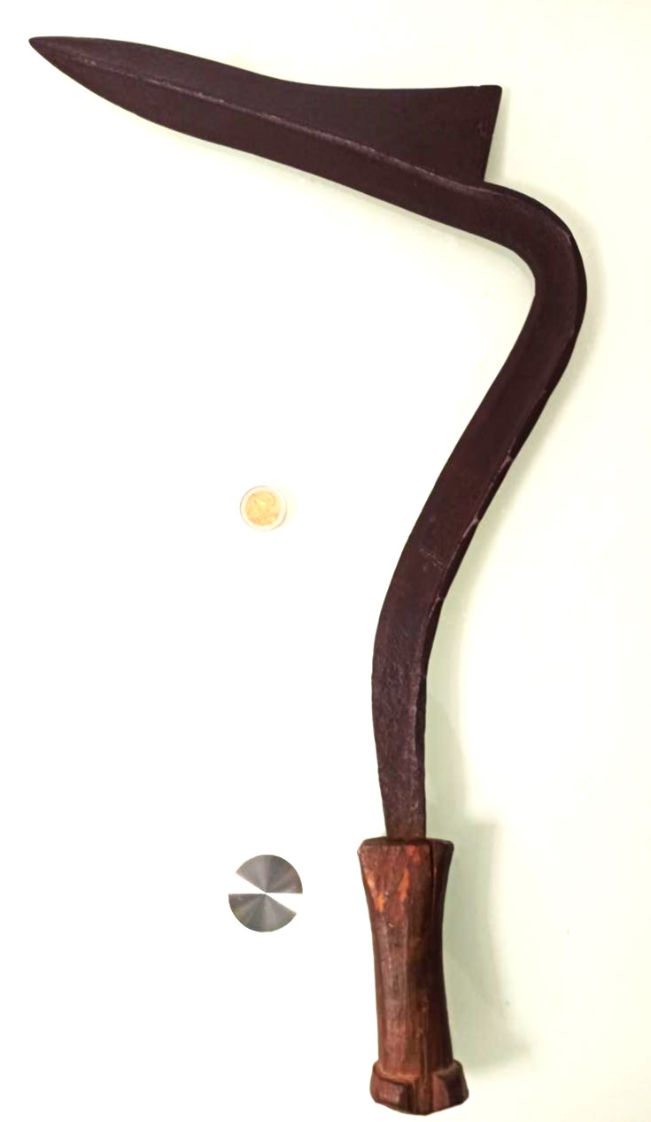

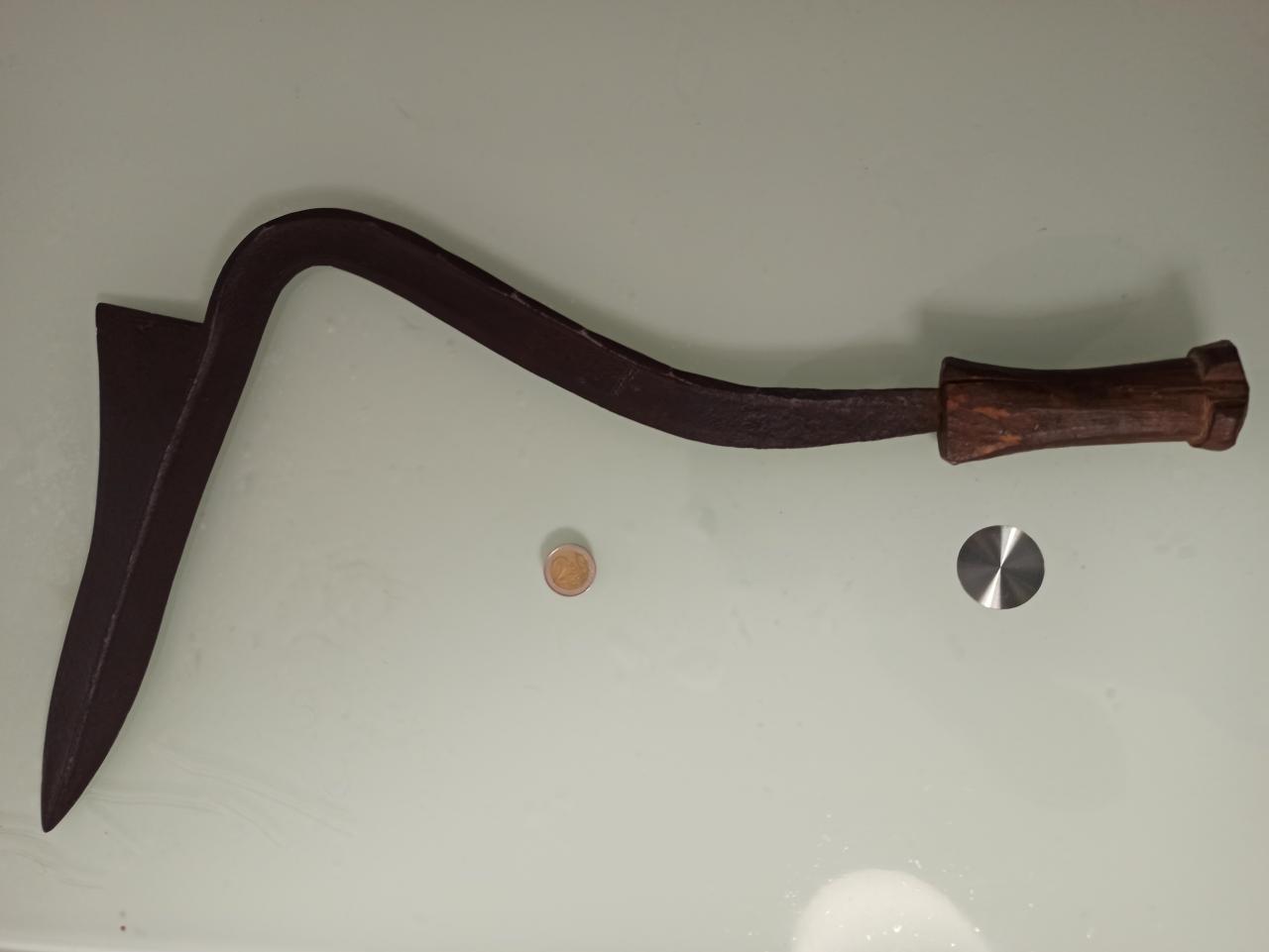

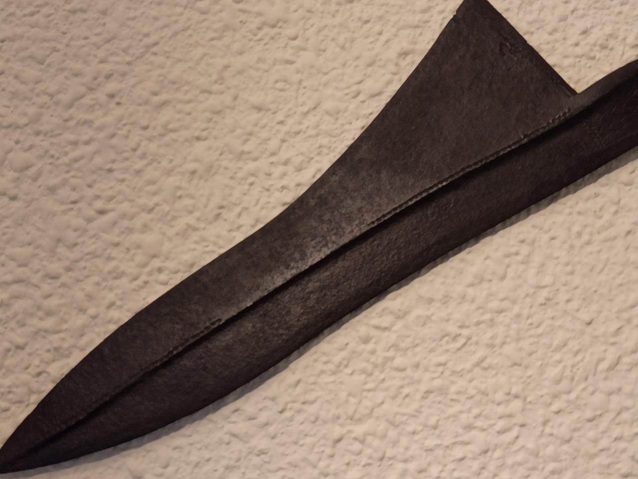

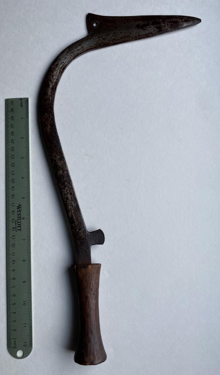

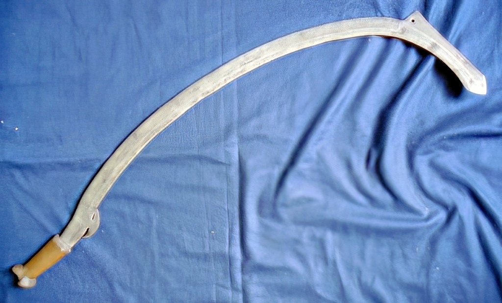

I have been fascinated for the last year of so by the great Central African sickle sword family. They are really diverse, but evidently related in some way, in the same way that European medieval straight swords until sideswords diverge from a common ancestor in the late Roman spatha.
Thus, it would be really interesting in my opinion to share the sickle swords in our collections, sources about them and generally have a discussion about them. I will start rolling the ball by presenting my Ngombe/Ngbandi béro. It is relatively nimble, but still has authority in the striking head. I'm in love with this piece. Also, it is almost identical in proportions and how it is decorated to the second one, taken from this link: https://ertribal.com/index.php/triba...o-sickle-blade I like to think that both come from the same "workshop" or at least produced by closely related smiths, in both a geographical and/or cultural way. No hard proof to demonstrate it, but taking into account the huge variety seen even only amongst béro, the resemblance is striking. Last edited by Changdao; 24th October 2023 at 06:31 PM. |

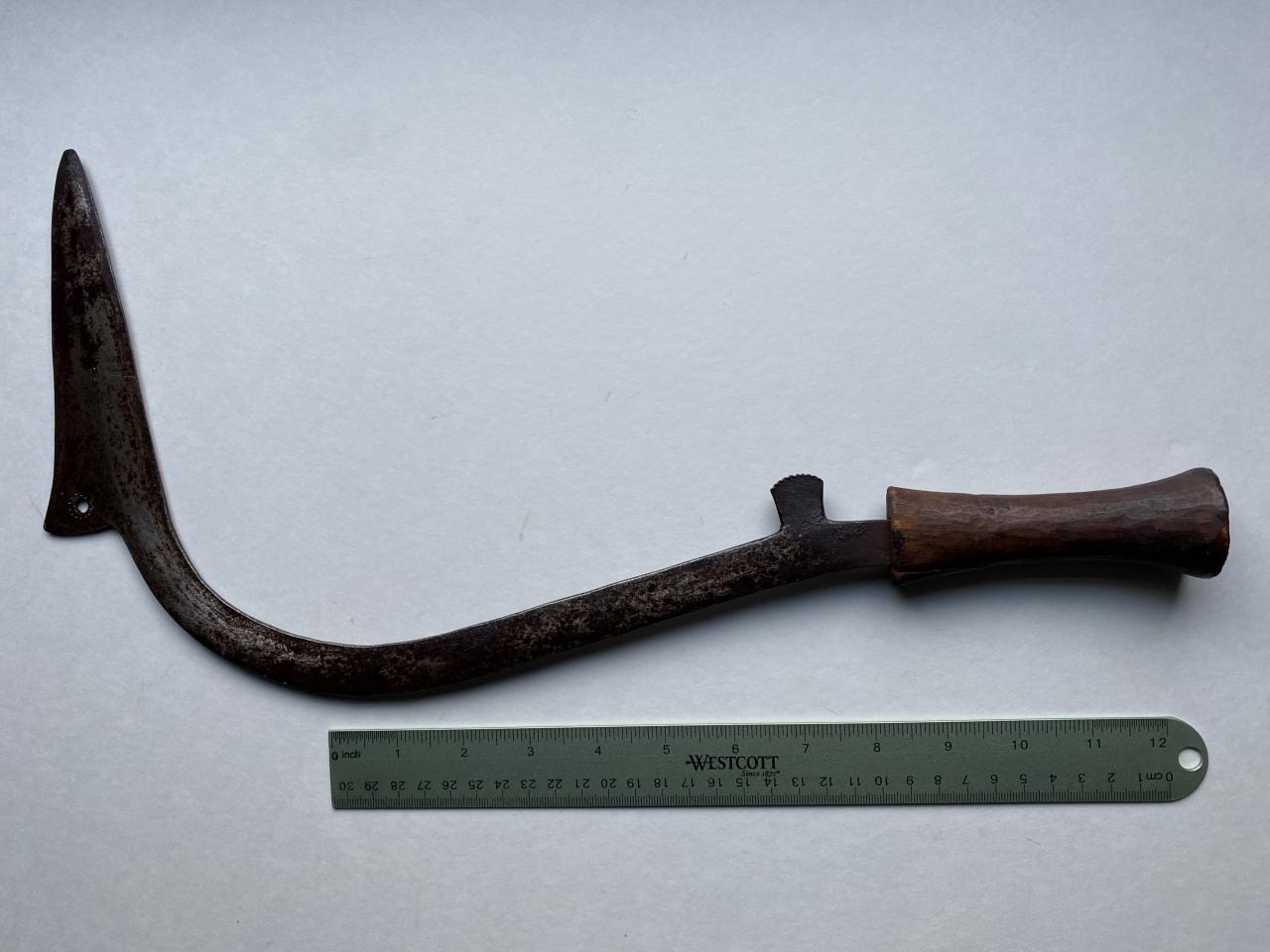

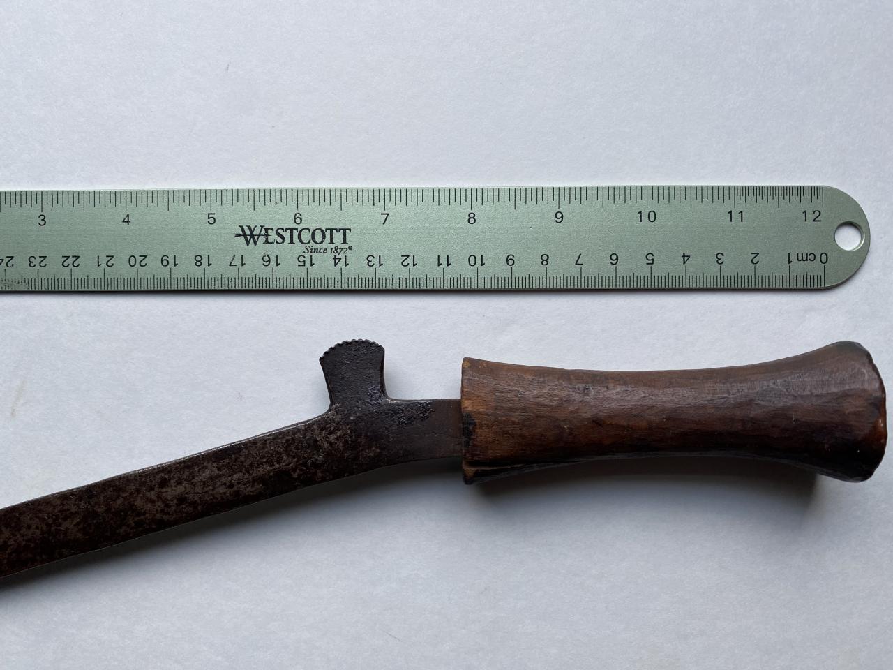

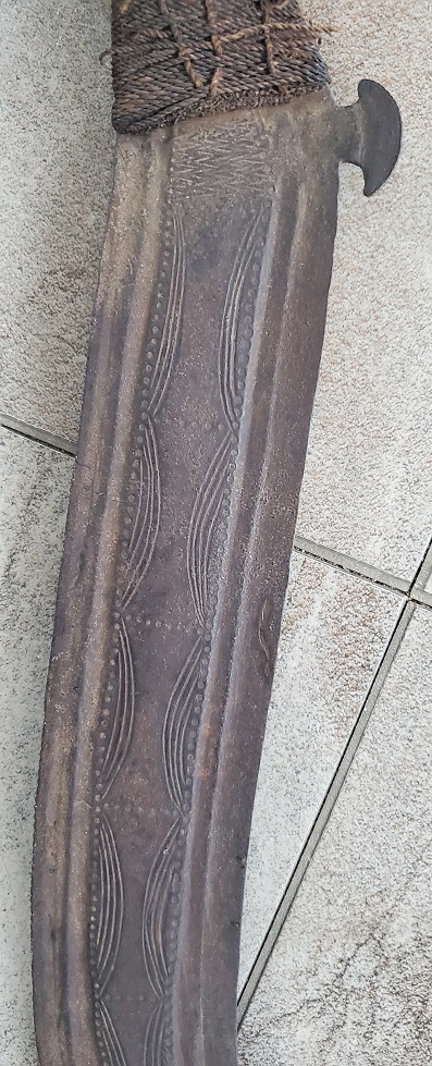

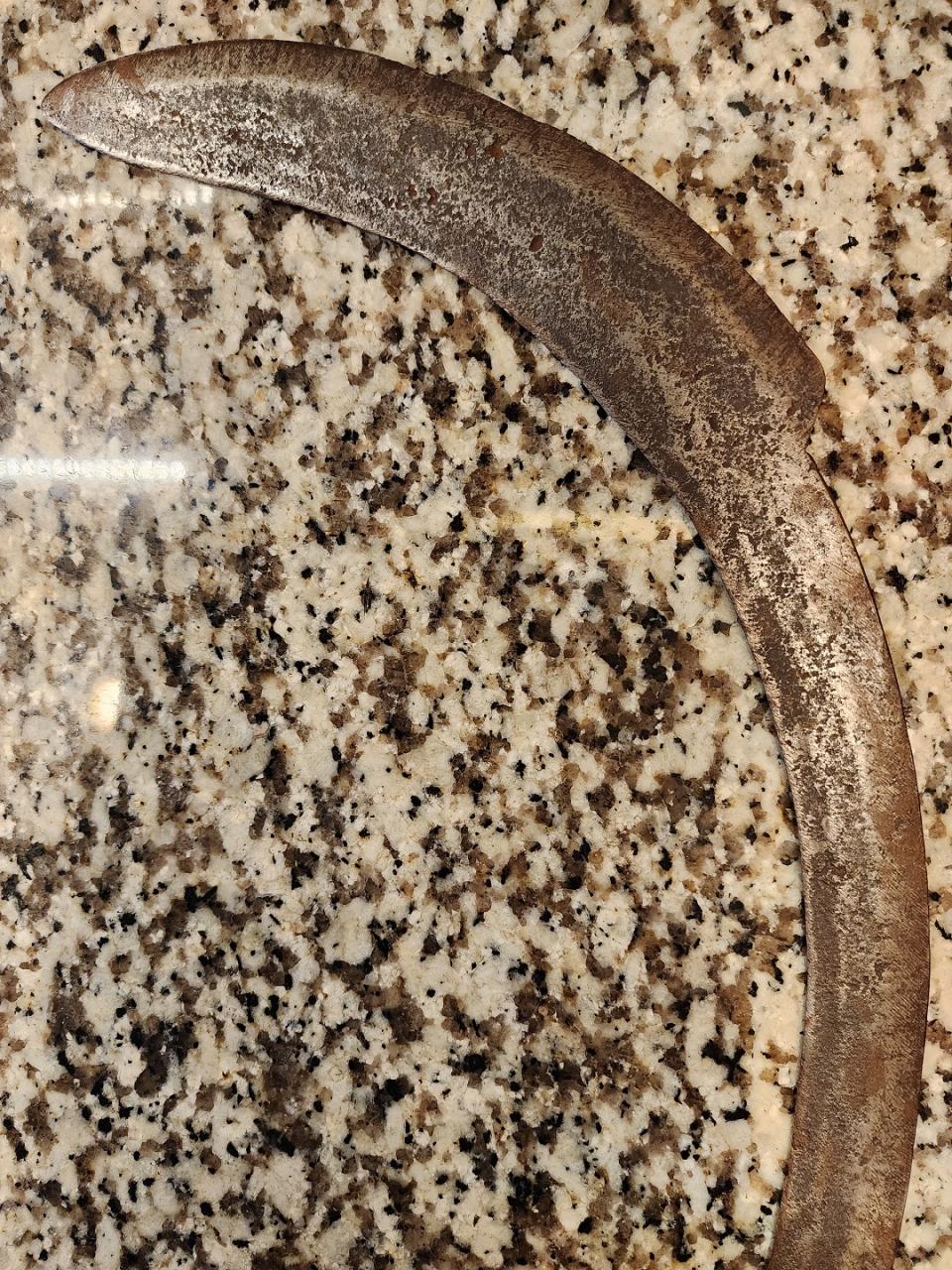

Here’s a sickle sword I added to my collection a couple weeks ago. Much plainer overall but it has some nice touches.

It has indeed some nice details. It is also probably of a more common type in the region, without the extreme 90º bend that mine presents.
I crossed a while ago in an Evans-Pritchard article a source in which these swords (well, the choppy Zande versions, that is) appear in action. "I have already quoted Schweinfurth's admiration of the Zande's skill in the use of his weapons. Another writer, Col. C. Chaillé Long, has described how in a fight with the Yanbari (? Nyangbara) he let loose his Azande (Adio or Makaraka Azande) on them : "I confess that I never saw a more perfect ideal of the warrior, not alone in muscular display, but in the bounding élan with which he flew rather than ran - the right hand grasping the huge knife, while with bouclier pressed closely to his side, he met the enemy. Covering his body with it with wonderful quickness from the deadly arrows, that his adversary in vain expended upon the broad shield, he threw himself upon him and cut and stabbed the defenceless 'Yanbari' to death." They burnt at least twenty villages and then ate enemy dead. The huge knife referred to is doubtless the scimitar the Azande of this region fought." It includes the customary (and ridiculous) literary convention that the Zande were cannibals, but the account itself is interesting. |

It's interesting that we see these blades in the Sudan, and it is indeed an evidence of the dynamism of the area during the XIX century. The Zande fought against the Khedivate, the Mahdists and the Belgians for a long time, so it isn't surprising that their weapons appear further North along the Sudan, either as loot or in use by Zande (and other peoples) in service of those powers (mercenaries, pressed into service, or both). I didn't notice them in The Four Feathers! Truth being told, I watched that movie many years before I knew anything about African weaponry. Regarding function, I think there are many years of weird discourse around them, and many weird judgements from the colonial period. Probably because of the lack of dedicated study integrated into a coherent Military History for Africa, especially Central Africa, it seems like up to date analysis of many sources from a military history lens isn't there yet. For example, the one in the OP is functionally a dagger-axe, in a way similar to a zaghnal minus the hammer bit and with extra hooking capabilities. In all sickle swords, from mine to the more choppy ones, the hooking makes sense, both for manipulating the enemy shield and just for reaching targets behind the shield. I haven't encountered any primary sources talking about it in relation to Central Africa, but they do exist regarding Ethiopia. Last edited by fernando; 28th October 2023 at 10:02 AM. Reason: Quotation size largely exceeded |

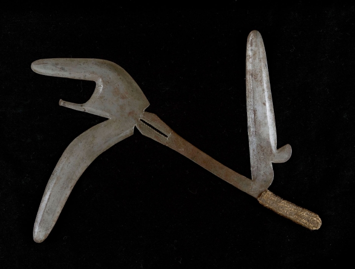

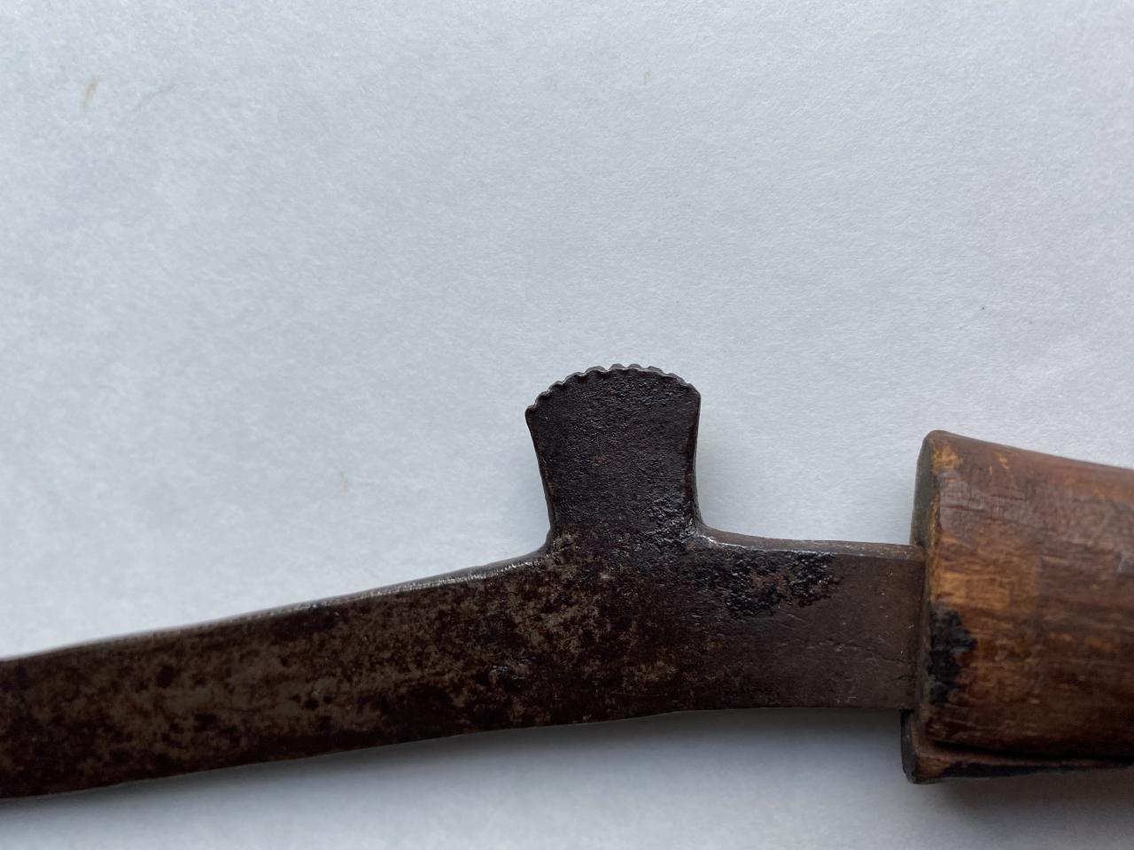

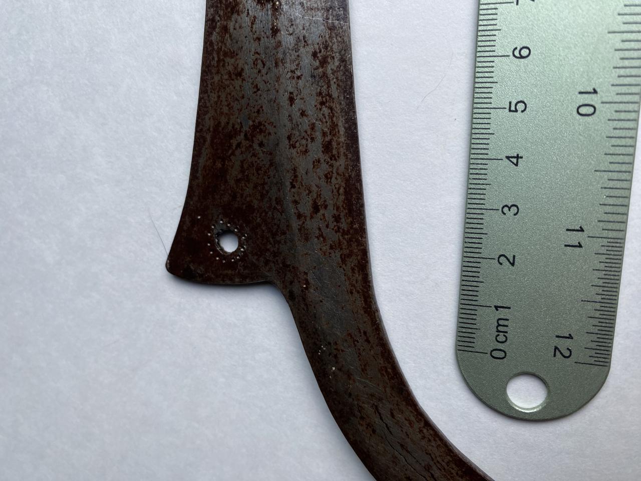

It seems in these various tribes of Congo regions the throwing knives, while following the same multi blade theme, are varied notably with terms being different in the same way. I have but one example of a sword of the Congo which has some relation to the 'sickle swords', note the half moon fixture at top of blade near hilt, which I understand is to attach a leather strap. The rounded shape of the blade seems to correspond to one of the blades on the 'kpinga' throwing knife. References have called this a 'war sickle' of Boa (Baboa) Nsakara and Yakoma tribes among others but it seems to be a form of the 'mambele' as yours. The attached image is from "The Four Feathers", starring Heath Ledger (2002), a truly phenomenal film. Note the raised Zande sword in the background. Last edited by Jim McDougall; 27th October 2023 at 04:21 AM. |

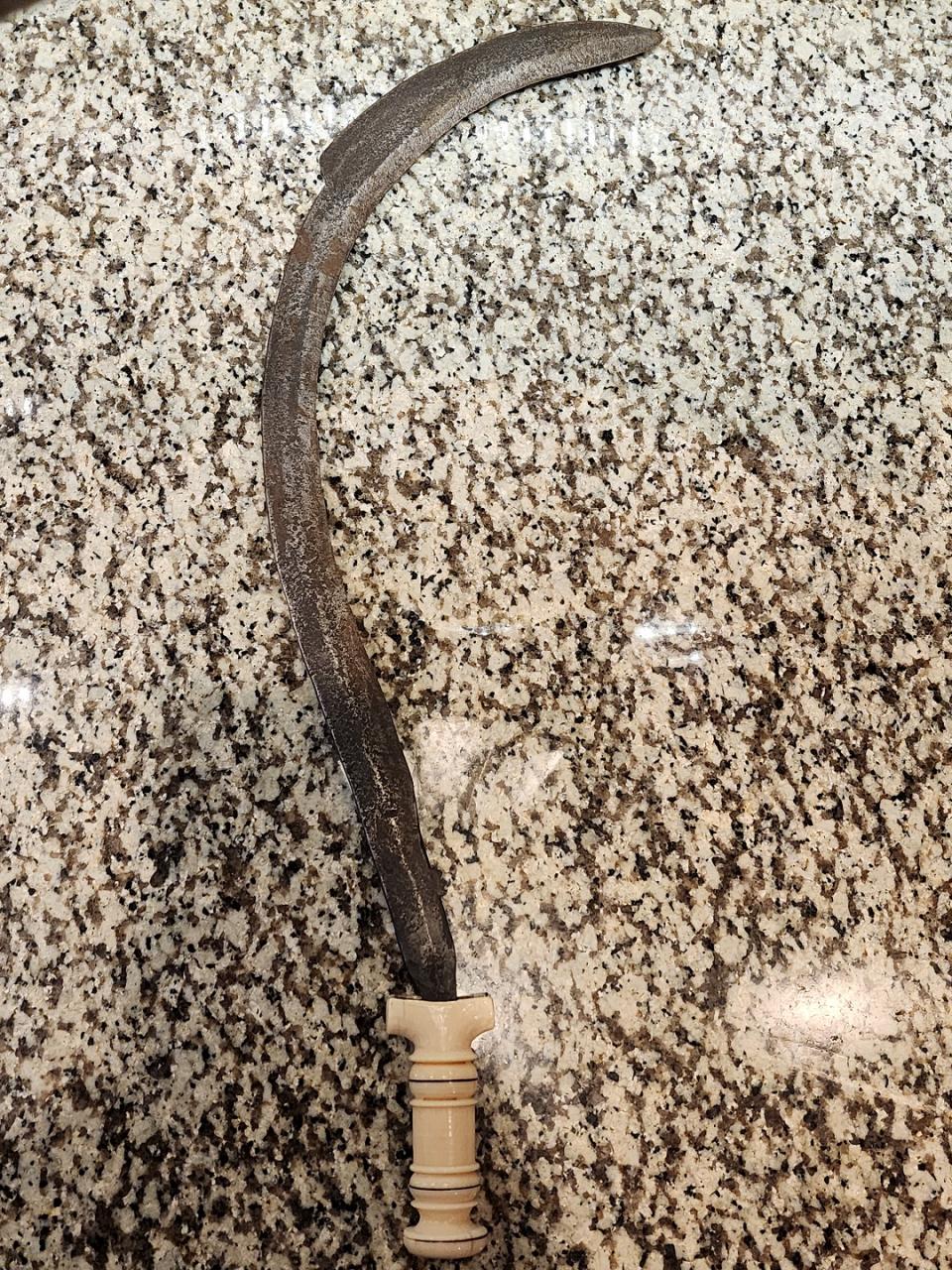

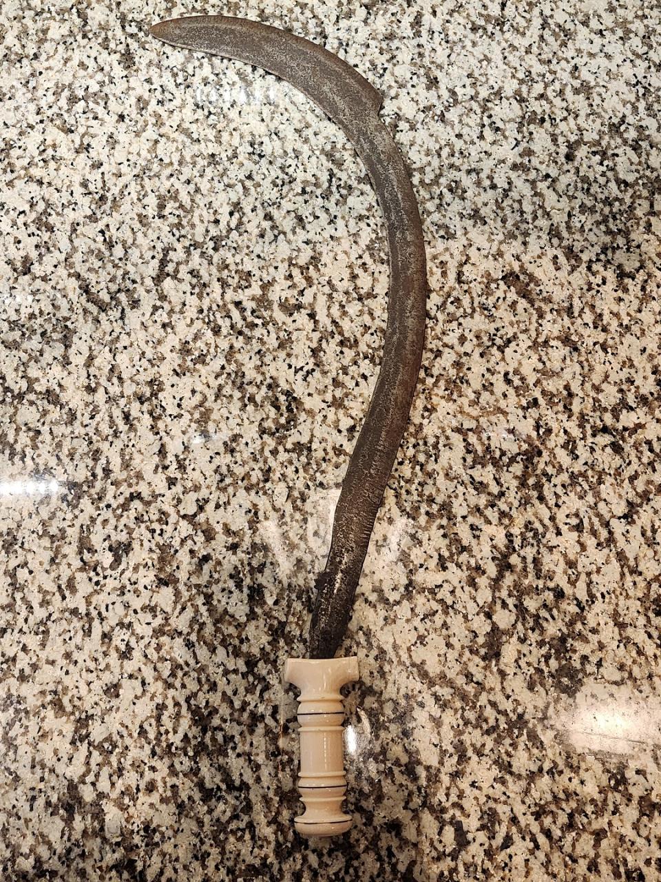

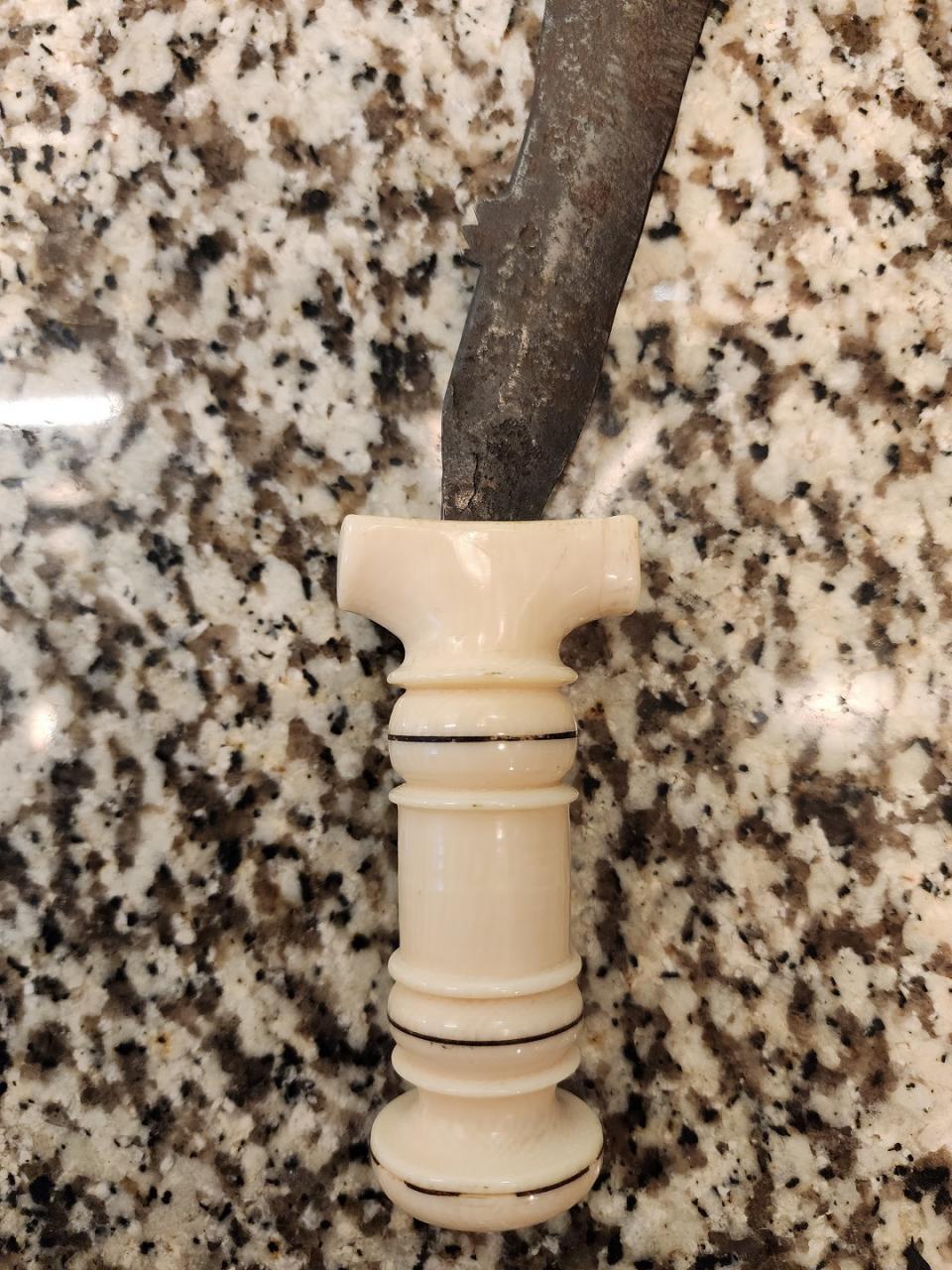

Here is an Azande prestige sickle sword. The hilt is carved elephant ivory with the typical black linear lines usually seen on Azande work, often on ivory arm daggers. The blade is forged with little decoration. Early 20th century , likely 1920 or 1930 whereabouts. Apologies for the dim lighting conditions, but the kitchen fluorescents are the brightest area on this gloomy fall day.
-Geoffrey |

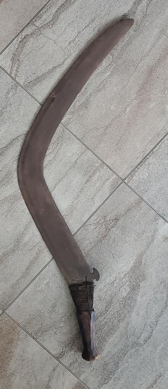

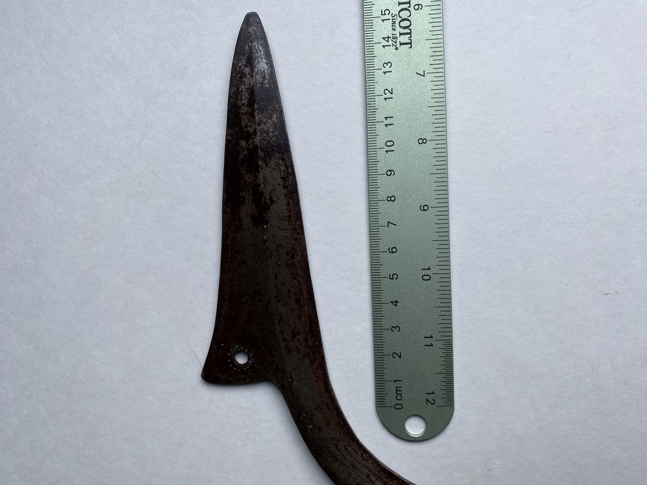

My Mambele sickle sword:

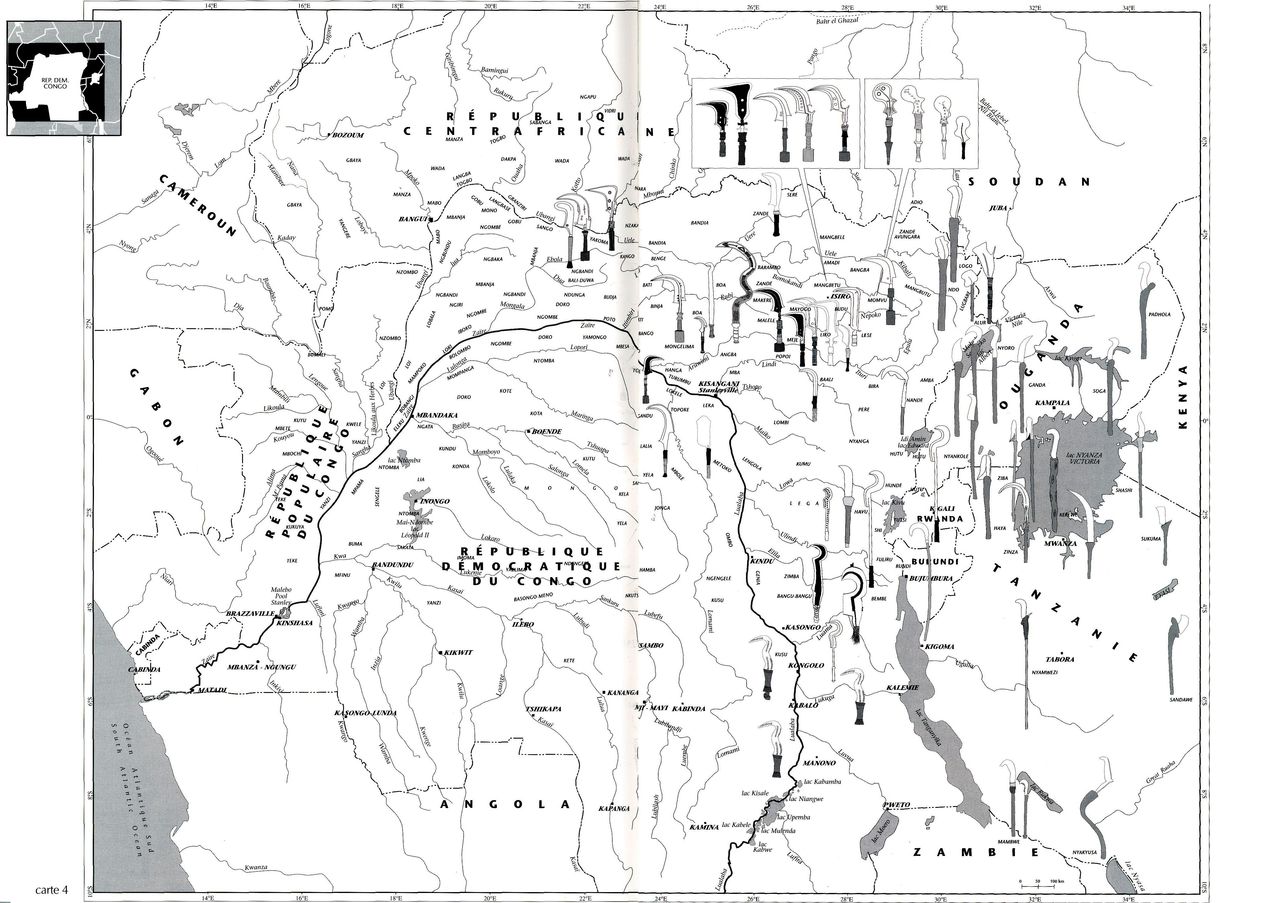

Here are three maps showing the different types of sickle swords and execution swords.
The maps are from the Tribal Arms monographs Vol.1 No.1-3 by Elsen (1,3) and Gosseau (2). These three volumes describe in detail the weapons depicted and their respective origins. |

Peter thank you for posting these! These are remarkable visual aids to geographically locate the variant styles and tribal associations key to them.
These tribal arms monographs are invaluable, and though there are the language barriers (I think they are in French?) the material is excellent through these kinds of visual presentation. |

These books are a must have for African weapons collectors, they are four languages in the books : English, French, German and Dutch. Best regards Marc |
