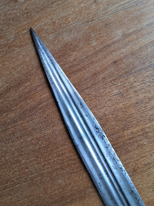

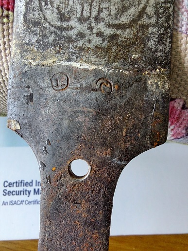

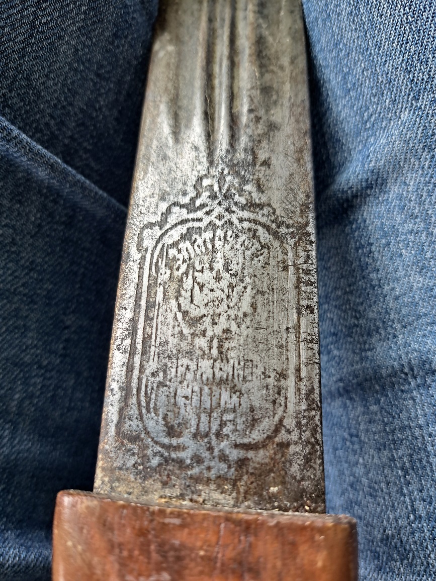

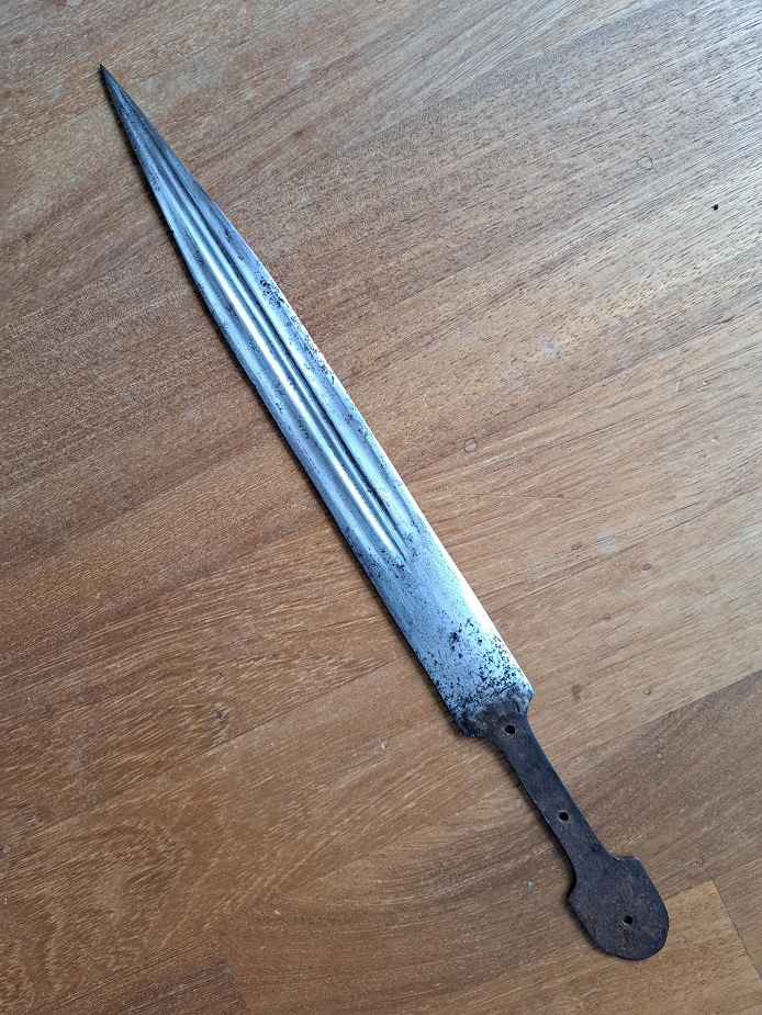

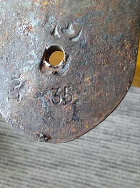

Dear members, just received this kindjal blade which has a worn etching near the base. Maybe someone is able to recognize the entire stamp (which is probably not unique) or the top word in the cartouche? Seems like "Znat...." Some stamps and number 35 are clearly visible. Any info on origin or age is highly appreciated!
total length is 46 cm
Kind regards,
Eric.

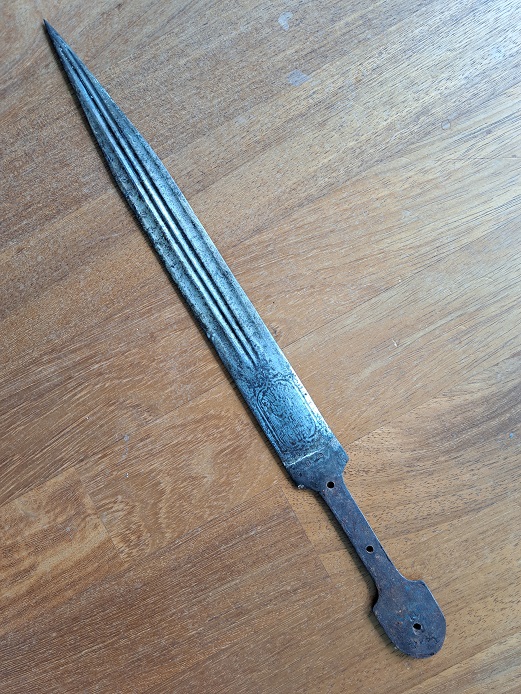

The mark on kindjal is of Zlatoust arms factory, but not the commonly seen one, in addition the tip with position of the grooves looks strange, as if the blade were shortened. Of course there are forgeries of Zlatoust weapons made - I am not able to say if this is the real thing or not.
Is there a mark on the other side of blade?
You can search for Zlatoust on forum.

After some time I would say your example likely is the real thing.
The date could be 1880ties or 1890ties

This is a Cossack dagger produced by the Zlatoust Arms Factory (ЗЛАТОУСТЪ/Златоуст. Оружейная Фабрика). The blade is shortened, the shape is changed. I agree with Gustav on dating 1880-1890.
Daggers similar in shape were made at the beginning of the 20th century by order of the Cossack troops. On one side they have the abbreviation ЗОФ, on the other ККВ or ТКВ. It would be helpful to identify if you could show a photo of the back of your dagger.

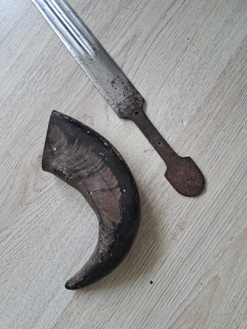

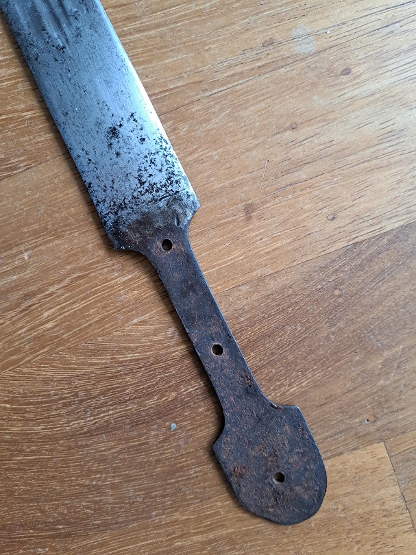

dear gents, thanks so much for the info. The combined knowledge here is great! I already suspected the tip was changed as the grooves are "running straight off" the blade instead of following the shape to the point. On the backside there is no etching or stamps at all. If there ever was etching I'd expect to see at least some remnants like on the front. There was a makeshift wooden handle all around the tang, i was pleased to discover a complete original tangshape underneath. Kind regards, Eric

Most logical reason for the reshaping I think is that the tip was bent by (ab)use and at bending back it broke. Earlier in it's lifetime.
I know Japanese swords were shortened at the tang but I don't see why anyone would shorten a kindjal point this way without a very good reason.

Those letters in circles could be the Zlatoust proof markings P and S. See below link.
https://www.warrelics.eu/forum/imper...atoust+kindjal
There are good examples of Zlatoust kindjals everywhere. Good luck with your hilt reconstruction.

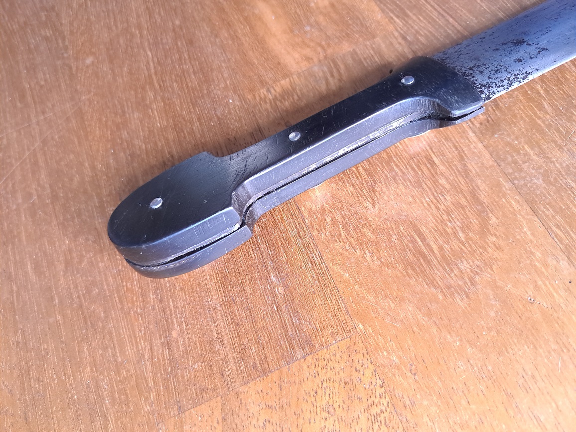

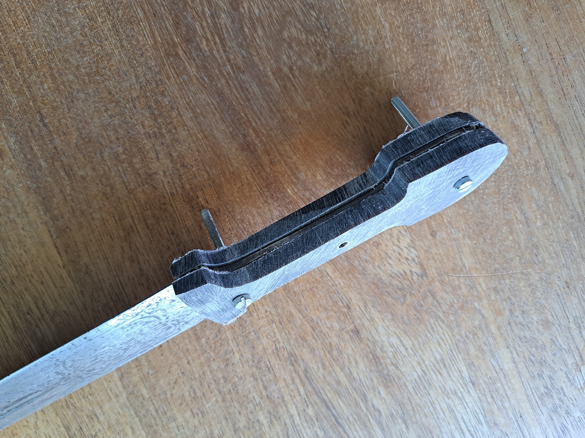

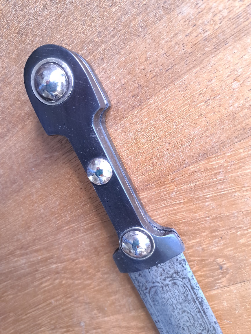

Well, as promised there it is. From the raw waterbuffalo horn to end product. The shaping done with saw and mainly a finetoothed rasp. Based on several examples and having some scrap alpaca (Berlin silver) sheet I changed my mind from Iron studs to this setup. After making the domes I soldered the heads of m4 bolts into them with generous amounts of lead to create the rivets. No glue or resin in the process, just some hammering. Chose the placing so that the stamps are visble, I must say I'm very pleased with the result. Maybe in the distant future a scabbard....

zugabe: it would of course be possible to remove every last toolmark and polish to a mirrorgloss but In my mind that wouldn't suit the blade, age and original production level.

Posts: 973
Really good job !
Congratulations !
This kindjal looks really great like that !!!

Faster then expected!
Nice craftsmenship. It looks really good.

Very nice work Klop. Your kindjal looks terrific.

thanks gents most examples I saw online have a band around the bottom of the handle but that introduces some problems: decoration in cern and matching scabbard metalwork... So just a dome on a circular plate better matches my abilities and provides a stepping stone towards a more forgiving scabbard mouth.
