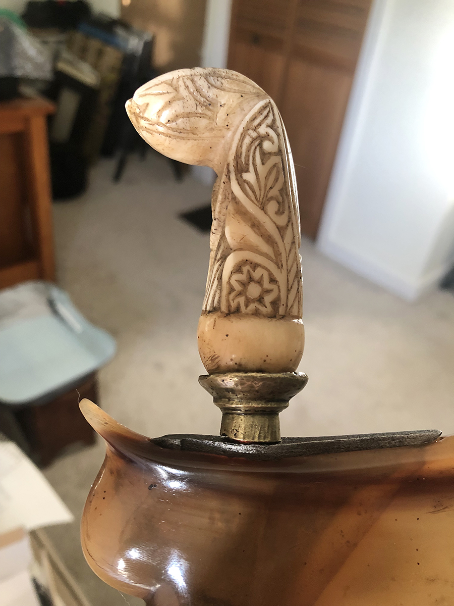

Hello
Here is one of my new Kriss (My First with a Yogyakarta hilt).
The blade measures 37cm long (9.5cm wide for the Gonjo).
Unfortunately there is no scabbard.
The brass mendak/selut? is of very unusual shape and with very poor finishes.
This is very strange as it looks old, but its quality is worse than the blade and handle.

Nice keris but the mendak (selut) is wrong.... better to change it

I agree. I frankly couldn't tell you what this is for, but i don't think it is at all correct for this keris.

This mendak is very badly proportioned for this Keris, but since it seemed a bit old I preferred to ask before changing.

I'd say even worse than the problem of proportion is that it does not seem to be culturally Javanese. I am not sure what area of keris culture it actually originates from, but i don't think it is Javanese.

Looks a bit like a small brass drawwer handle that has been trimmed down and had a few decorations bashed into it.

After 2 days of effort (1 to remove the handle and the "selut" securely attached by mastic and "resin"? and 1 to re-drill the handle partially obstructed by glue / resin). Here is the Keris with a more correct mendak.
It's an old copper mendak with traces of silver plating. I had a brand new silver-plated mendak but the diameter of the Pesi was too wide....

Personally, I find the parijoto copper mendak to look very pleasing on the ensemble.

Yes, it definitely looks better now. The pamor is more striking in this new photo. I like this keris.

It does look much better.
Something I am noticing: the 13 waves are very well executed, in the sense that they are strongly curving. I don't recall that I have read anything yet about strongly curving versus weakly curving luks. Or I might just have missed it...
Are there any norms about the extent of the curvatures? Or might we just simply need to say the empu was very expert in executing the waves?

Thank you everyone for your comment.
For the strong curves I can't comment because it is the only one of my Kriss with a blade like this one.
Old 17th July 2017, 09:46 AM   #14
Posts: 7,193
The form of a wave (luk) is dependent upon the classification of the keris:- long, slow waves point towards one classification, short, deep waves point towards a different classification.

However, the overall similarity and the selut seem to be pretty convincing. Things do get around...
Old 29th March 2023, 04:13 PM   #30
milandro
Join Date: Jan 2022
Location: Netherlands
Posts: 498
I am sure that, based on the majority rule, the latter mendak is more culturally appropriate... BUT the first selut may have been coming down to us, through time, since it was dressed for the first time, possibly unaltered, and YET we would be changing it to fit criteria that may or may nor have been shared by the first person dressing that kris.
Sometimes I feel that people who came after the events or the artefacts tend to be way more orthodox than the people who were there at the time that things happened or were made.
