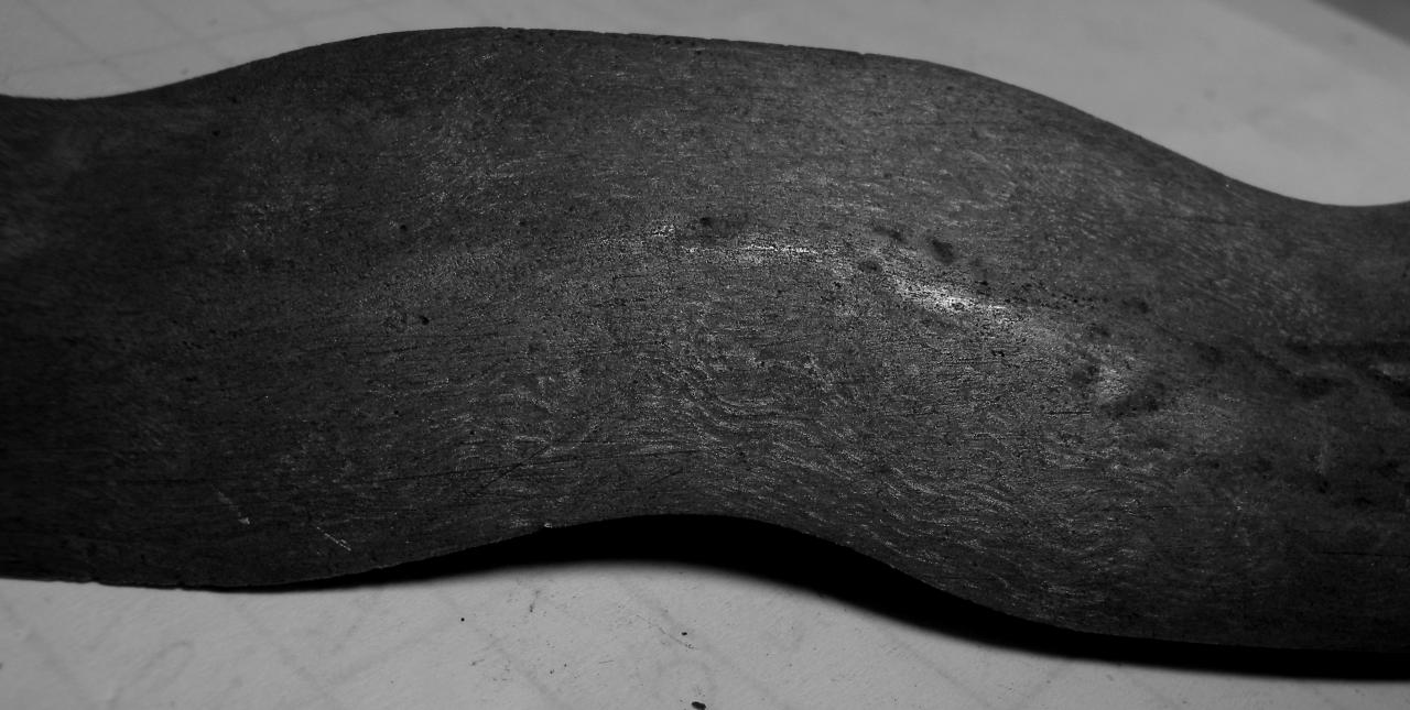

Hi Jaga,
Here's an example of a wootz keris. It is probably a 17th century Palembang keris. This keris was polished and lightly etched showing the wootz pattern. About 50% of the blade was once adorned with kinatah. Unfortunately this one is no longer mine.
I have another keris that is probably wootz. But this keris was a bit eroded with traditional cleaning it is rather rough and we cant see of it is really wootz. This one is probably Javanese. I don't have any photo of this keris at the moment.
I find that there are a number of examples of other weapons usually from Sumatra that was made from wootz.

Alan - thank you for the extra info. This has challenged my initial assumptions -(1) that wootz keris were of better quality; and (2) that is due to wootz being a more expensive imported product than local steel.
Rasdan - thank you for the reference image. Of the two wootz keris you refer, would you say they are of better-than-average quality and manufacture?

Hi Jaga,
It is rather difficult to say on quality as we need to match the quality level to the respective age and origin or tangguh of a keris.
Plus there is a problem on how a certain dhapur for certain keris origin/tangguh should ideally look like. Only people who have access to well preserved, high quality keris with known provenance will know this and there are a lot of pretenders out there.
Then there are varying qualities of wootz. I am sure the cost is going to be different. I think we cannot use wootz as an indicator of quality for keris.
Regarding the two keris I mentioned, in general, I think, I can say that both keris when they were new are of good quality. The Palembang is probably, probably the near top quality in Sumatera at the time it was made, but the Jawa one is probably just slightly above average, not top quality. It could be lower, but I have insufficient knowledge to say; I don't even know if it is really wootz because of the surface erosion.
