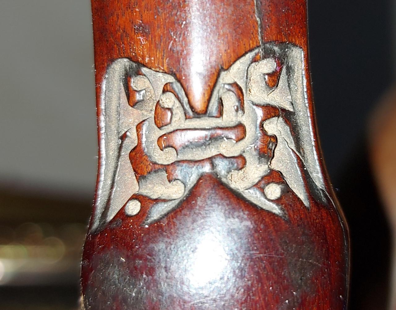

Hi Sid.
I am not a Javanese keris hilt connoisseur or specialist, but I must say, the hilt looks quite nice. Probably you can share the straight on photo of the cecakan (the stylised face carving) too?
Usually good handles will have a dudukan i.e the recessed base of the hilt for the mendak but this one does not have it. (Good Solo handles most of the time will have a recessed base, but not all hilt with recessed base are good handles - this is my impression at the current time) Probably somebody flatten it off to fit in a different mendak.
In fact, the entire setup of this keris is quite good if part of the warangka was not broken off. Somebody probably loved this keris very much at some point of its existence.

Thanks Sid. It is a very nice hilt IMHO. If the carvings are symmetric, this is not not something we encounter too often. Most hilts are village quality. I think this one is not.

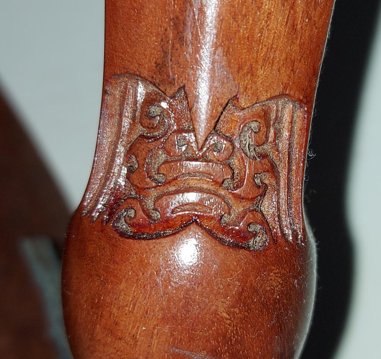

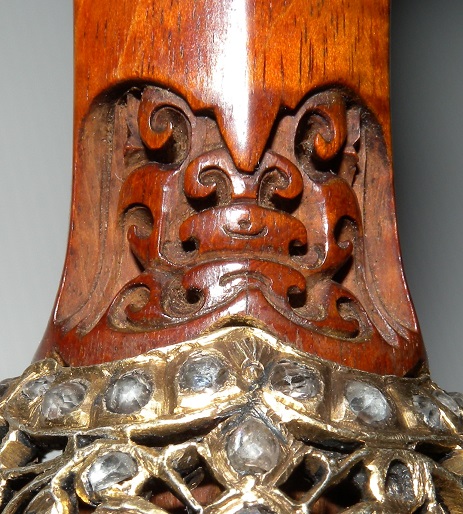

Hi Sid, It depends on the level of symmetry, the flow of the curves and the cleanliness of the carving. The photo you provide does not give that view, but I think it is nice enough to be above average.
Now I don't know what real high level kraton carving should like, this is my impression what is nice. Below are 3 cecekan. 1 is new, common and OK and one is village quality, the one with selut is a nicer one - to my eyes. Of course we need to see the hilt as a whole too, but this is just regarding the cecekan carving.
