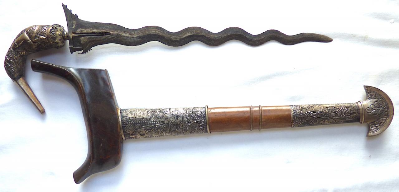

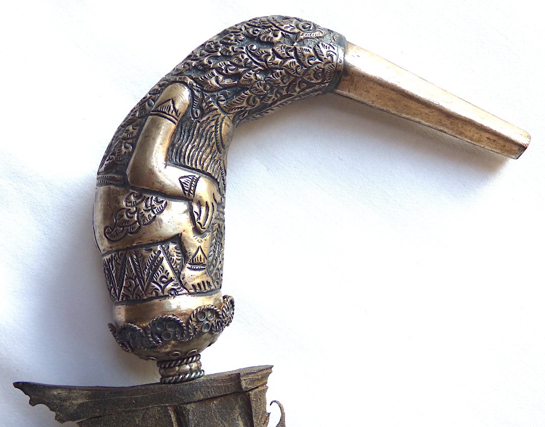

Keris are definitely not my forte. I would appreciate some thoughts about this old one that I was gifted by a colleague when I was doing some consulting work in Sumatra in the 1970s. It's at least 50 years old, and looked pretty old and worn when I received it. He said it had been in his family for "some time."

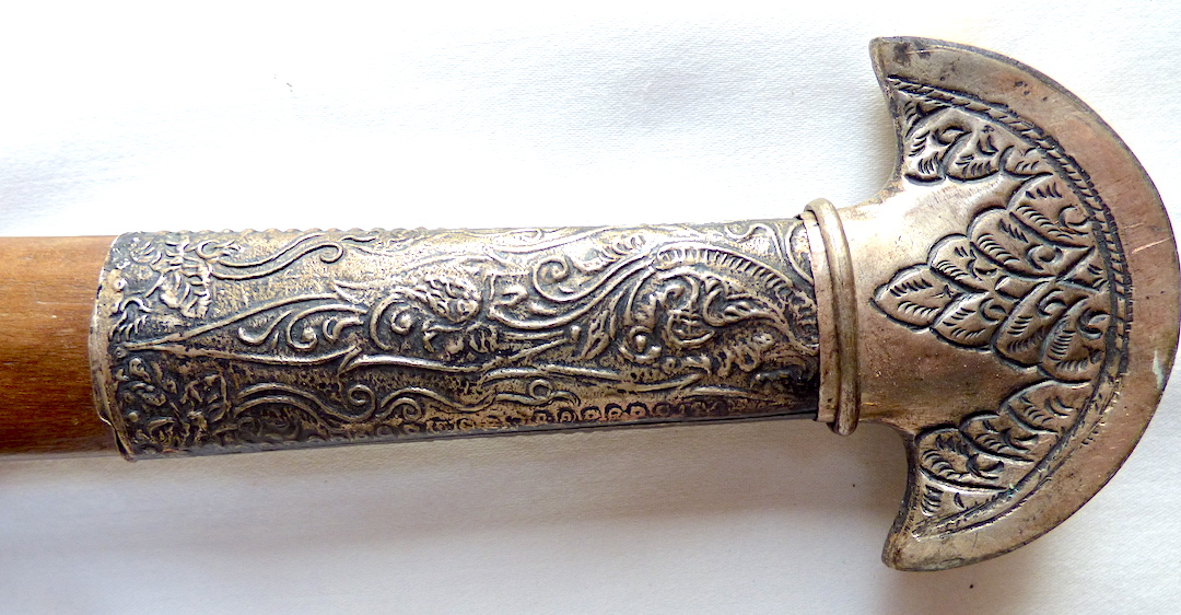

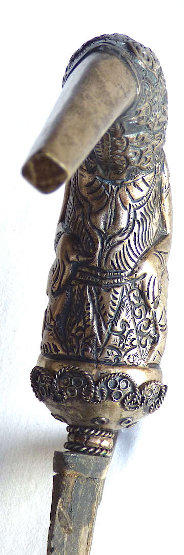

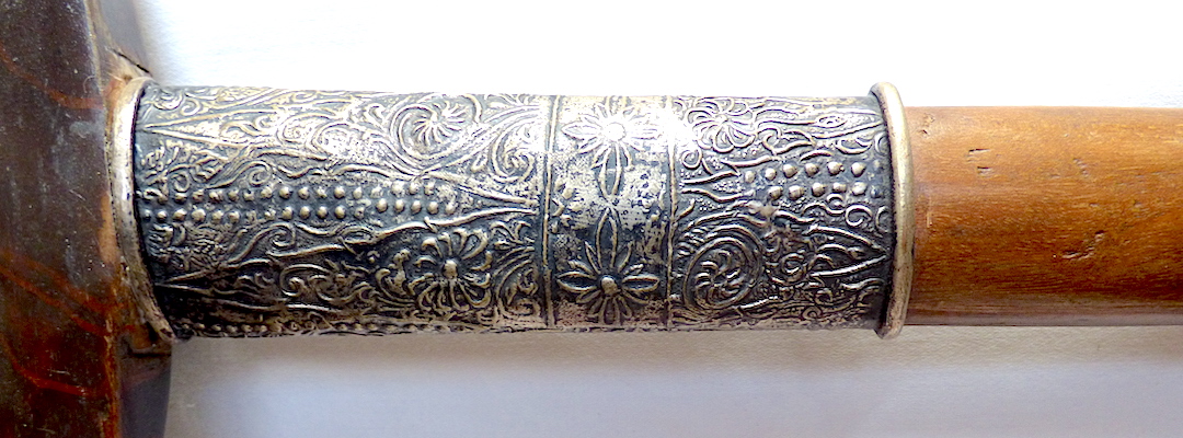

The hilt seems to be brass, but it appears to have had a silver finish originally that has rubbed back on the flat areas to the yellow brass. Similarly, the decorated metalwork on the scabbard has a siiver look but the bands are definitely brass.
The blade seems very ordinary and could do with re-etching. When I received it the blade had been treated with sandalwood oil and smelled lovely. Fifty-plus years later it still smells good.
I'm interested in your thoughts about the daemon hilt and what it represents. Also, possible age and the area of its origin. I will not be offended if you tell me it's just a tourist piece and not a great keris. I don't expect it to be. Just interested in your thoughts.

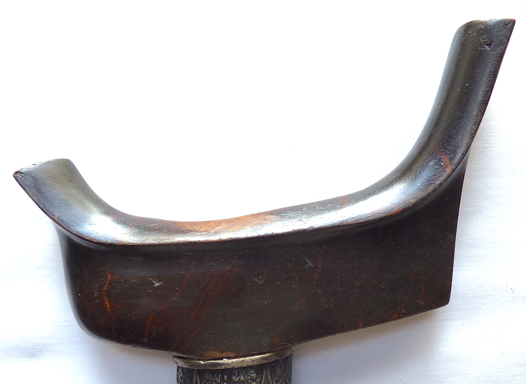

Hi Ian. Your keris is dressed in Lampung form, the southern end of Sumatra, and the hilt form is usually described as one of the burung (bird) forms, though this long-nosed variety seems to be specific to Lampung.
I would probably place this one in the first half of the 20th century. Unlike Rasdan, i am fairly convinced that keris making did indeed end somewhere around the start of WWII and did not really start again until Dietrich Drescher kickstarted it up again in the mid 70s.
Now, i am not convinced that means that there was not a single keris made anywhere in Indonesia post WWII until that moment in 1974 when Drescher commissioned that first blade, but for all intents and purposes the art was dead.
This does not, however, mean that no one was production of keris dress in that time. I would imagine that there were still people who valued their personal keris from 1940-1974 who would still need to maintain the dress on their keris so they probably did find craftspeople to do that work for them during that period in time. But as far as i know there is absolutely no evidence of any regular keris blade production during that time. I do recall that Alan once made mention of a fellow he knew about who may have been making a small amount of keris prior to 1974, but it was not a common occurrence.
I would say this dress is not particularly high end for sure, but neither is it the bottom of the barrel. And it surely looked much better when new and the fittings were bright and fresh. I suppose there is a possibility this dress could be post WWII, given the time frame you mention, but i believe the blade must be from before that time, before the war itself.

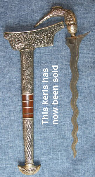

I hav also posted a photo of a similar keris to yours that was deemed to be from the first half of the 20th century.
I see no reason to consider your keris as a "tourist" item even if it is not a high quality item and the dress appears a to have an "exotic nature".

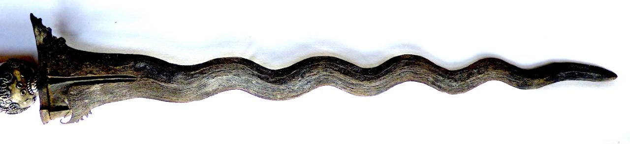

The blade of this keris appears to have some age, it is somewhere between very difficult & impossible to be able to be certain about many keris characteristics when all we have is a photo on a screen, but my guess at age for this keris would be second half, 19th century.
The overall impression of this blade is old Madura, but there are conflicting indicators, the principal deviation from a Madura keris being the shape of the blumbangan:-

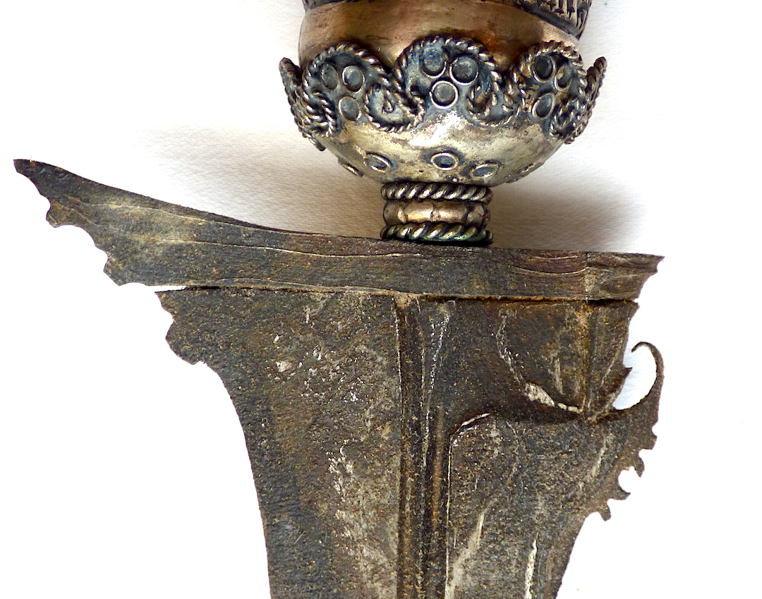

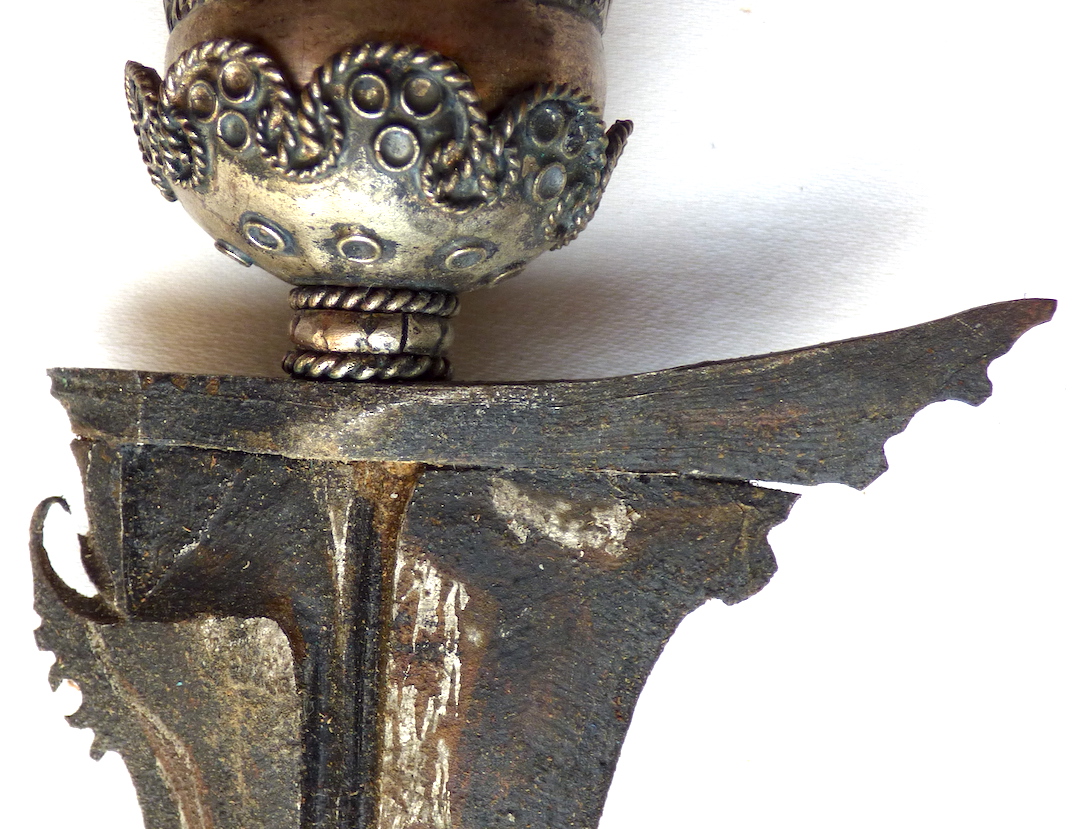

Ian, could you please provide a close up of the blade base with the camera at 90 degrees directly above it?

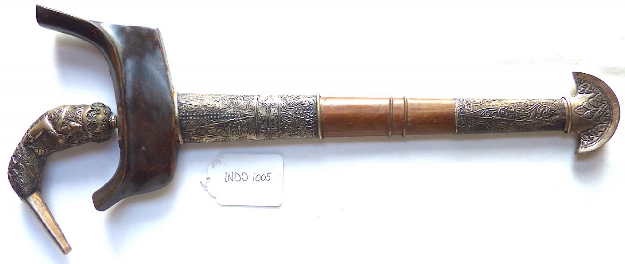

The dress was probably made in or around Surabaya.
In Surabaya there is a large general market named Pasar Turi. You can buy anything at this market, food, clothing, kitchen utensils, tools --- anything one might need, including keris.
It is a very old market, but some years back it was rebuilt, it now consists of a couple of very large, two story concrete buildings, the keris section is in the back building, upstairs, at the very end.
In my opinion this keris is a Pasar Turi product.
I have not visited the Pasar Turi keris section for perhaps 25 years, it is full of second rate garbage, if anything decent comes on the scene the prices for an outsider are New York gallery prices. From my perspective, it is simply a waste of time for anybody who is looking for decent quality to visit, but as I have said, its a long time since I have been there, maybe it has improved. But according to what I hear it is the same as it was in the past.
This keris that you have Ian, screams "Pasar Turi". I have seen baskets & boxes full of the metal components of this keris, especially the mendak/selut fitting. I have seen keris of all different styles, that originated in Pasar Turi, in markets all over Jawa & Bali.
I would be inclined to put a date of 1960's -- 1970's on the dress. I'm basing that guess on the metal work. I first started to see this mendak/selut style -- flower cup with twisted wire -- in Australia in the 1960's.

In summary, my opinion is that this keris was produced in Pasar Turi, Surabaya and exported to another location in Indonesia for sale. The retail sale location was most likely Jakarta. The blade is not a 20th century production, it pre-dates 1900.

The quality of workmanship on the scabbard reminded me of similar work on 20th C. Burmese "Temple Dha." These are decorative items, mainly worn by grooms at weddings, and often end up as wall hangers.
Interestingly, I had a friend over for dinner last night. He teaches at a local vocational college that happens to include electroplating in its curriculum. It was his considered opinion that the metal on the scabbard of my keris was likely electroplated nickel silver (EPNS) on top of brass. The roughness to the surface is apparently characteristic. (The smooth surface on EPNS cutlery etc. is after polishing.) He judged the quality of work as about average for one of his students (so not very well done).
Alan, I've added pics of the area you asked about.

Thanks Ian.
There are a couple of different shaped blumbangans:- boto adeg, boto rubuh = standing brick, brick laying down. Then there is the square blumbangan and extreme examples of the two brick types.
The form of the blumbangan is primary indicator.
This keris has some indicators that point to Madura, but I would expect a squarish blumbangan in a Madura keris, this blumbangan tends to the lazy brick, laying down, having a rest. That in turn suggests West Jawa.
I cannot recall ever having seen an older Maduro keris with a brick laying down blumbangan. This doesn't mean that there could not be one, it just means I cannot recall having seen one.
In any case, whether the blade was made somewhere in West Jawa, ie, Sunda, or whether it was made in Maduro for sale in West Jawa, I do not feel inclined to guess. But I will guess that this blade is not 20th century.

Thanks for your input Alan. I know exactly what you mean by the Madurese indicators and was going to mention that, but unlike you i was unable to say what the same time it did not seem quite right for Madura. You explanation was very helpful for me to understand why i chose to keep my mouth shut. LOL!
Thanks also, Ian, for the close-ups. It's alway difficult to date any keris blade solely from photographs (and even in hand), so the more detailed images we can provide is always helpful in any assessment.
