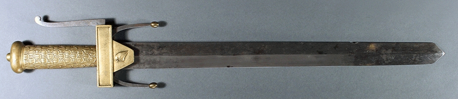

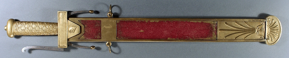

Please see https://tresors.nice.fr/oeuvre/glaiv...l'attester. [/B] from which I QUOTE." The students of the Ecole de Mars are equipped with a uniform and an antique saber inspired by short, straight Roman swords. An iron and brass weapon that is more decorative than functional, its design is sometimes attributed to Jacques-Louis David, although none is known to attest to this. If the name of the artist has been put forward, it is probably because of the costume projects he produced in 1794 at the request of the Committee of Public Safety, thus fulfilling a wish of the Popular and Republican Society of the Arts in clothing material. David's proposal for the military dress will be copied to provide the uniform for the students of the School of Mars. The weapon consists of a straight two-edged blade and a brass handle, molded and chiselled with ribbed scales, which ends in a dome. Three curved iron quillons stand out from a rectangular crosspiece under which appears a Phrygian cap in relief. The scabbard, consisting of two wooden splints, is covered with red cloth. It ends with a rectangular brass leaf trim decorated with seven-stranded palmettes and a wider, rounded dart decorated with a ribbed palm. The iconography of the sword is scarce, it appears at the earliest in an Academy of a pupil of the School of Mars, painted around 1796 by an anonymous artist from the group known as the "Primitives". In the 19th century, the Pre-Raphaelite painter John Everett Millais (1829-1896), represented him in a painting entitled The Romans leaving Britain exhibited at the Royal Academy in 18653. The subject of the work, inspired by Raphael Holinshead's Chronicles of the History of England (1577) has as its theme the departure of the Roman legions at the end of the period of occupation of the British Isles. Authentic, reconstructed or adapted for other uses, several swords are known in museums, such as the one in the old collections of the Château de Malmaison which was worn by the actor François-Joseph Talma (1763-1826). Work restored in 2007 by the Olivier Morel workshop".UNQUOTE.

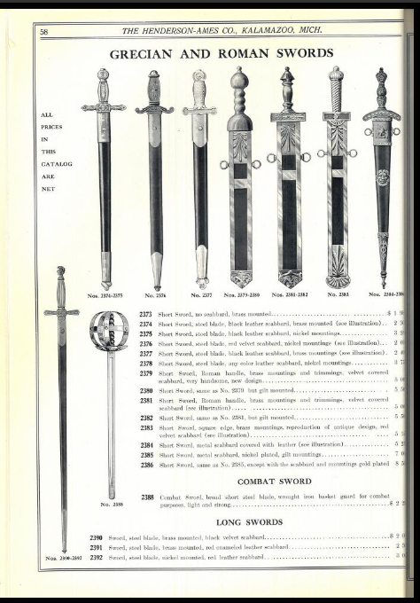

CORRADO26, if you rely on your experience and intuition (based on seeing your input here over time, I am certain you are savvy collector), does the sword look "period"? The scabbard is not interesting, but if the sword is authentic, it's a good historical find.
Obviously you are aware that this type of hilt has been many times duplicated, and used for theatrical and societal purposes.
For instance, I've attached a scan of a page from the early 20th c. Henderson-Ames Company catalogue of masonic implements, namely for the IOOF (International Order of Odd Fellows). While not an exact sibling of the Ecole De Mars sword, it's nevertheless a blood relative.

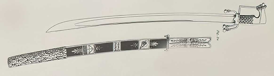

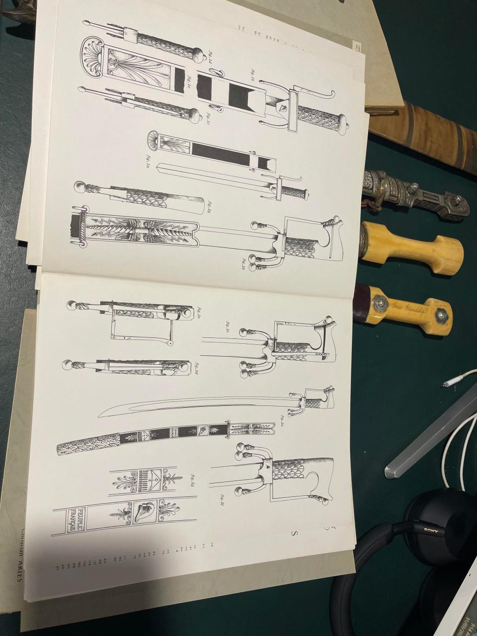

I looked through every page of Christian Aries work on the subject of swords and only a single entry was noted for the anything similar, a type already presented.
What I didn't know which was interesting, is the extra quillons seen on the Ecole de Mars sword was actually based on the Moroccan Nimcha/Saif... and that they made a model with the same hilt too... one I have never seen in the market...
