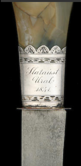

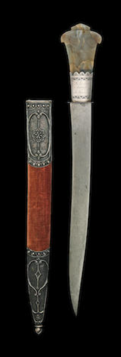

Now i am curios. Is there a picture of the yatagan Anosov sent to Faraday?
Drabant1701 is offline
Old 26th November 2022, 08:58 AM   #234
Yes.
I have a detailed series of those pics, but I signed a nondisclosure agreement with the source that is valid till I have a written permission to reproduce them in my slowly written paper:-(
However, there are pics of a dagger gifted by Anosov to a British geologist Roderick Murchison sold by Bonhams in 2008 for $56,017 ( premium included, $73,234 inflation corrected). By far the best example of Anosov's wootz structure.
