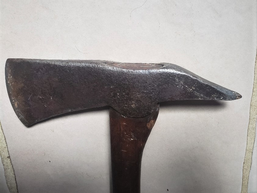

Hi everyone, I just picked this up today, won it at a local auction, I think it could be as old as 18c, i think it may be called a belt axe or a hammer pole axe, I cant find any markings on the rusted axe head, it has also been painted at one point, a green almost blue color, quick search into the possibility of the color being significant turned out to be interesting. I acquired it in PEI Canada.
anybody with knowledge on the subject to share? thanks

Looks like a common carpenter's hammer poll hatchet & nail-puller notched blade, painted with whatever paint the owner had on hand at the time. Probably many million of these rusting away in tool boxes around North America and beyond.

A "Rodger's Rangers" tomahawk replica, it would have looked more like this:

I'm afraid Wayne is correct. This is a common shingling ax. Although some of these tool types certainly date back to the Revolution, this specimen would probably date at latest to mid-19th. It is a cast piece with a notch for pulling nails. Sometimes, these notches were wide and used as a beaver trap chain pull, but this example has the more common nail slot.
Rogers' Rangers would have most likely carried a spiked ax/tomahawk type, but it should be noted that the so called hammer pole axes were also popular with the 'mountain men'. Contrary to popular belief, these early hammer pole axes were not used to hammer nails! The 'hammer' end was to balance the blade when swinging it.

Sorry to agree. It is a carpenters framing hatchet. I've owned a few. It is a much more common tool than the much more effective carpenters shaping hatchet which had a chisel type bevel on the blade and a symmetrically shaped head so that it could be flipped for a right or left hander. Both relics of time before power tools were common. I used both a lot working in areas without power before battery tools and very light portable generators. If you work much on old houses, you can see the marks of these on the framing members where material was "hogged out," removed rapidly and coarsely to make things fit.
I am going to slightly disagree, maybe more clarify MELEY's statement on this particular poll. It is a hammer head and a very effective one. The blade serves as a poll and really drives a nail. If you are in attentive you can lose your fingers. With this shape poll I would bet on pre-1950 manufacture. Look on old tool forums and you can find more info. There is proball a stamp on the side of the head under all the gunk.

hi thanks everyone for your comments and interest so far.
to clarify it was sold as an antique hatchet, no attribute to rogers rangers, this is only my fantasy,.
I did think this axe could possibly be old enough, I have come across many old old tools locally.
apparently this form of axe was popular circa 1760
how does one tell if it was cast or forged?
the hammer poll on my axe is cylindrical not octagonal like many I see.
is there any difference in the 19c vs 18c ones?
I found this YouTube video very informative
https://www.youtube.com/watch?v=uHyZhRFWsUs
at 10:10 he talks about my form hatchet.
also I think its likely there was a wide variety in the styles of hatchet the rangers carried, and possibly they had carried this form. he had members from all backgrounds,
I thought this hatchet could possibly date to the fur trade and been used by a "coureur de bois".

Old style roofing/shake hammer/hatchet.
If I may clarify, for trimming and nailing cedar shakes.

Prior to the last quarter of the 19th century nails were made by hand using hand tools and were of square cross section. Mass produced nails came along around 1880 with machines designed for that purpose. Nails then became round in cross section.
A 'vee' shaped nail puller is not suitable for square nails.
Up until the 1850/60s axes were made of iron with a small amount of steel to form the hard edge forge welded to the end of the blade. Steel was much more expensive and hard to come by. Unfortunately it is hard to tell the difference between the two without specialist equipment or a grinding wheel (different sparks), so this is not a useful way to confirm a date.
Seam lines are often visible in very old axes not only at the edge but between the two halves where the iron has been folded over to form an eye and then hammer forged into one piece. However the best made axes will not show a seam
I agree with the other comments - your axe is modern and most likely made in a factory in the 20th century.

This is also known as "half hatchet". Industrially-made. probably early to mid
20th c.

thanks for some good info,
probably its not as old as I had hoped.
I realize the nail puller wasn't a good sign but I figured that feature could have been drilled in later, I read the possibility of this in a post on this forum..
Maybe I will clean the axe head and get a better look just for fun

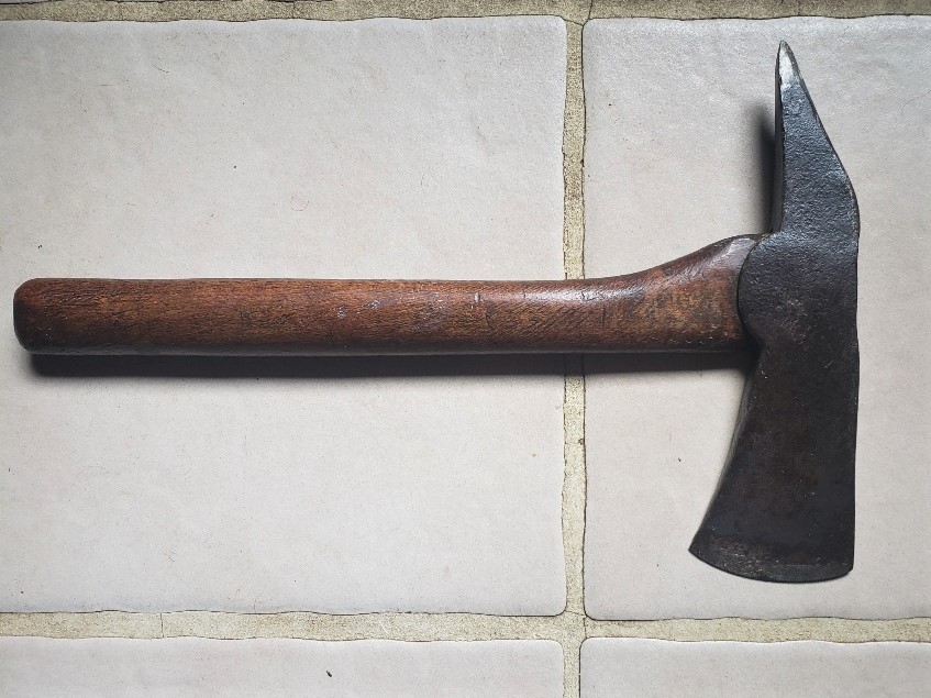

its a modern carpenters hatchet probably post ww2.. older once are more fancy and a more complex consturciton in the head ther eis for example on the old handforged ones some style to the bevelling of the surfaces .. especially unde rthe beard of the axe. older ones have larger cheeks on the eye that extend down somewhat below the socket

Cool stuff folks, Nice axe David, and thanks also to the moderators, I am learning quite a bit,
What a coincidence I just found something else very interesting.
at the garage sale I was told it was a black smiths tool for removing scale.
I am not so Shure.., the seller is not a blacksmith,
If it is something of interest, I could bring it to work to have better quality photos taken.

It certainly roughly resembles a modern welder's hammer, used for chipping the slag off after a weld, so could well be an older blacksmith tool.
Although concentrated on N. America this site is very good for photographs, information and how to spot fakes and is well worth a look. It shows axes going back to the 1700's. There are pipe tomahawks as well but the trade axe pages are very good.
https://www.furtradetomahawks.com
David R. I remember the previous thread on your axe - amazing that you still used it and it took an edge after a century or two! I guess that confirms the steel bit insert with the rest iron. Is it just the photograph or does the darker colour at the blade edge indicate the steel section?
Axes are often faked using modern ones as a base. There are lots of fire axes out there masquerading as naval boarding axes! That's why I think the post 1900 catalogues that Interested Party posted are useful and Fernando was right to allow them.

thanks cutlass collector now that I search for chipping hammer I find similar examples, seems its more for welding then blacksmithing.
thanks to everyone for helping satisfy my curiosity on these pieces.
