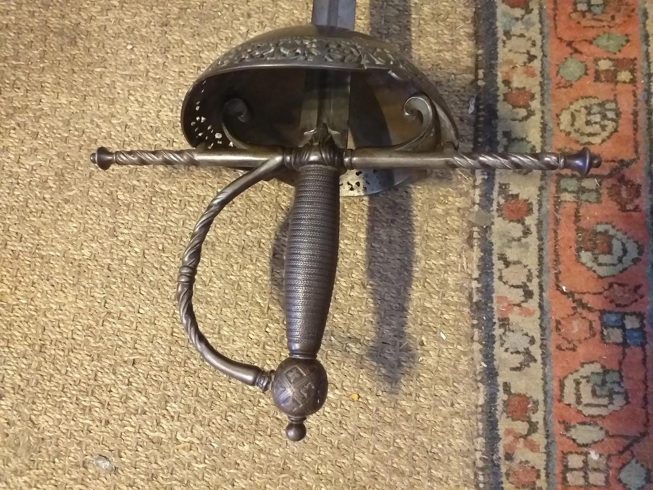

Default Spanish Rapier/Broadsword
Opinions age and origin please

No inscriptions on the blade; no makers marks on the ricasso behind the cup guard ?
Strange; if this is genuine, must be an early example, judging by the pierced hilt and twisted quillons and knuckle guard.

This is a very nice cup hilt in style. Most of these of course date in the 1640-70 period with obvious variations outside that general period. As Fernando well notes, there would be markings on the blade, especially on a rapier..which is what this is, having nothing to do with broadswords.

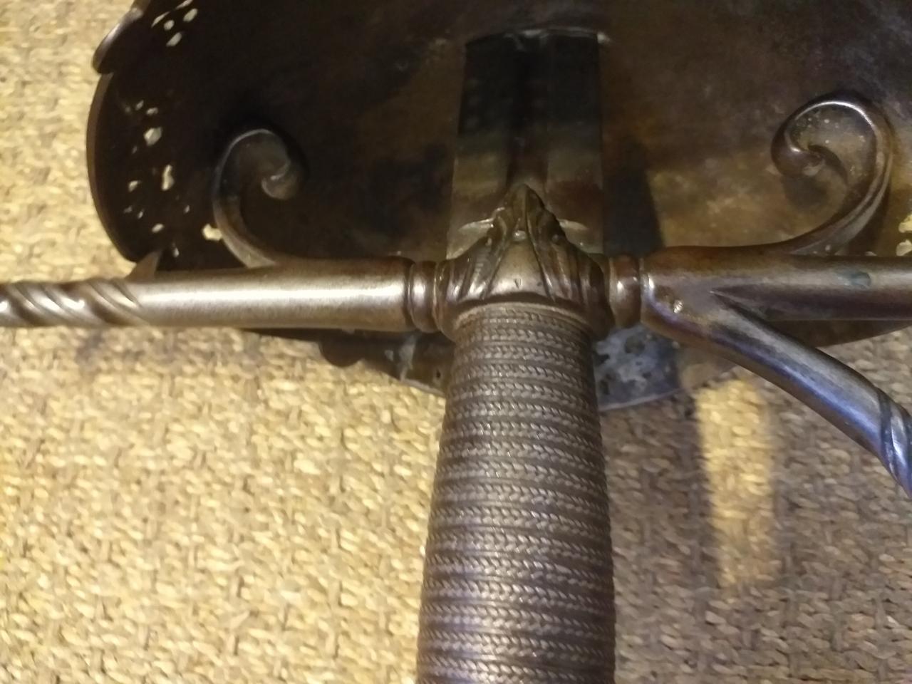

Spanish rapiers however typically have oblate pommels, this with tall capstan looks English. The writhen work on quillons and knuckle guard are consistent with many of these hilts into 1660s, but vary widely, while the style of the terminals looks like on Spanish examples.

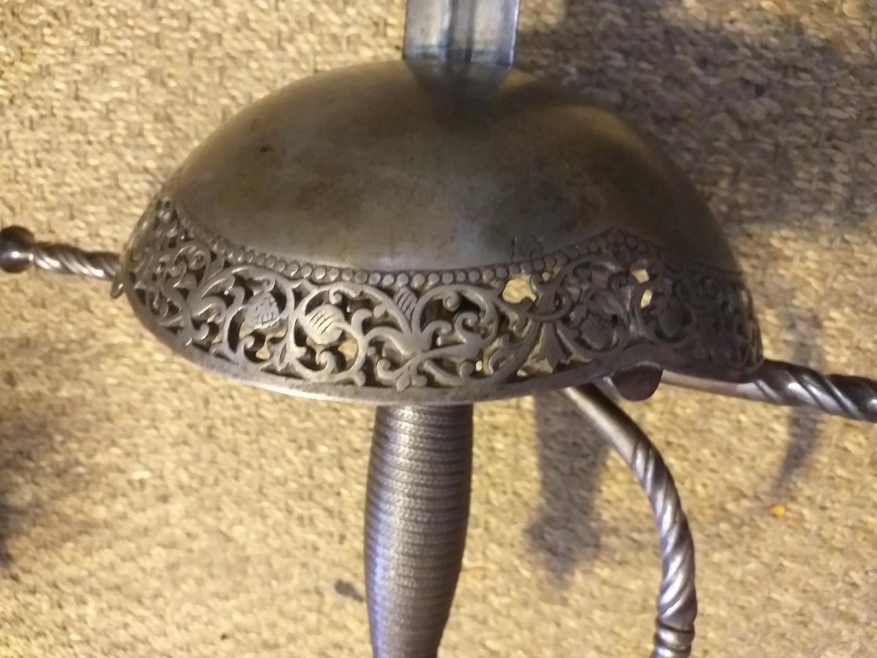

The cup is most unusual with this pierced band around the upper part, it seems in most cases the cup is typically either fully pierced, or engraved or solid, and there would be a rompepuntas (folded over rim). The arms inside the cup are also unusual being voluted, and I cannot see a guardopolvo.
With this kind of wire wrap on the grip, in style, there should be Turks heads.

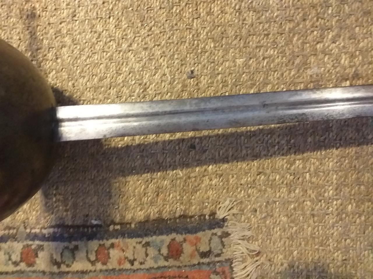

Am I wrong in noting there is no ricasso on this blade? Jim, is that why you called it a rapier/broadsword? Fingering this blade could be uncomfortable

I second the previous comments; dimensions are needed, there should be turks heads on both ends of the grip wire, and the ricasso is wrong.
Also, I'm unsure over how the cup guard is attached to the crossguard. Normally we would expect to see screws or similar used to attach it to the annelets.
Finally, the knuckle bow shape looks off, either squashed or made in the wrong shape and it appears to have been attached to the pommel?

You're not wrong, and that's just plain weird looking. Or maybe it's just some style I'm unfamiliar with. I hope it's unsharpened down there or you'd cut your finger off! Maybe a blade attached to a new hilt in a slightly awkward way?
Actually I was referring to the title, which terms this a Spanish rapier/broadsword......as I noted, this has nothing to do with broadswords...however as you note.......that key feature of a rapier is not present either.
Could it be a remounted transition blade? I know that the long risacco came along later in the progression from cut and thrust to thrusting swords.

The 'wire wrap' pattern looks like it is cut or cast into the surface of the grip, not actually wrapped with wire...
Could this be a Victorian made wall decorator for some nouveau riche lordling's mock castle mansion?

Age: circa 1870
Origin : France judging by the type of blade

The arch shaped 'patillas' that hold the quillons down to the cup guard are so (much) worked up that we don't see the usual screws that should fix them to the cup. The cup bowl is pierced in a so crude manner, in that its reverse (interior) looks so unfinished. The lack of ricasso definitely doesn't make sense, be it either short or long; unless as already approached the blade was (again so) shortened. The pommel looks bizarre, probably only to my eyes. The quillons being twisted, as well as the knuckle guard, would put this sword in a early period ... but they look so pristine. Also as approached, the grip wire wrapping ... doesn't look like a wrapping.

well seems to have caused a stir,i used the term broadsword because the blade would not look out of place on a scottish basket hilt,i dont own the sword and am trying to make sense of it,no markings on blade or ricasso as observed,condition is good perhaps to good,i will get dimensions next time i visit ,it has no history i know of, was bought by an aquaintence of mine with a view to resell , the reasons for my posting it are to help decide .thank you all for your imput

I have a main gauche, possibly by this same workshop of which I am very suspicious of being XIXth century. Too perfect in the measurements and thicknesses.
The pommel with the crosses remembers me of British Victorian neogothic and horror vacui.
