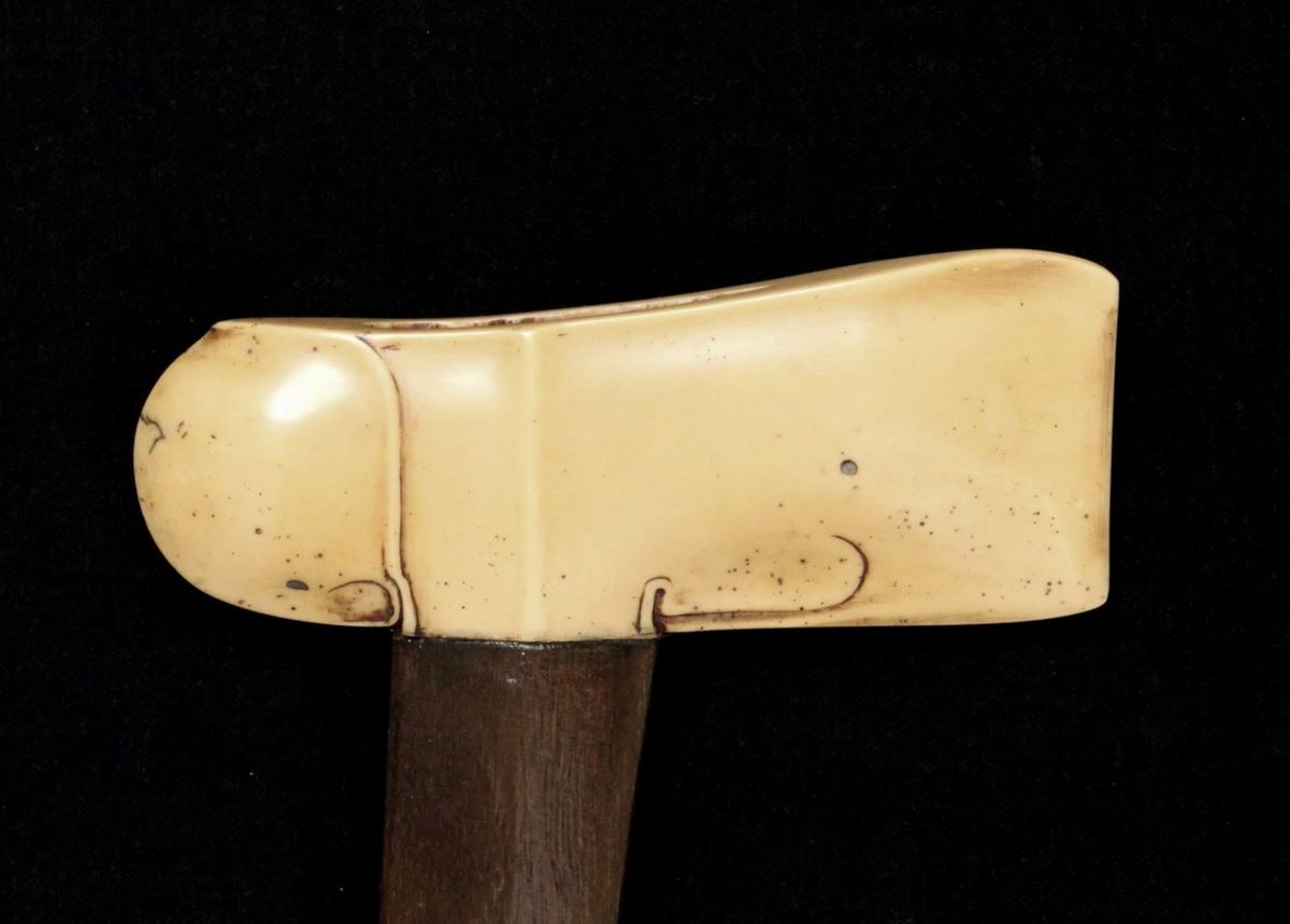

Sure, it can occasionally look like close to the real thing (usually mimicking ivory), and it is far too often presented as the real thing, which is criminal IMHO. But i see no reason that it is necessary as an alternative. For new dress i would rather have bone or antler for an ivory substitute than molded resin. I don't see it as a wood substitute either and though some woods have indeed become rare i doubt that resin can serve as a reasonable look-alike for those materials.

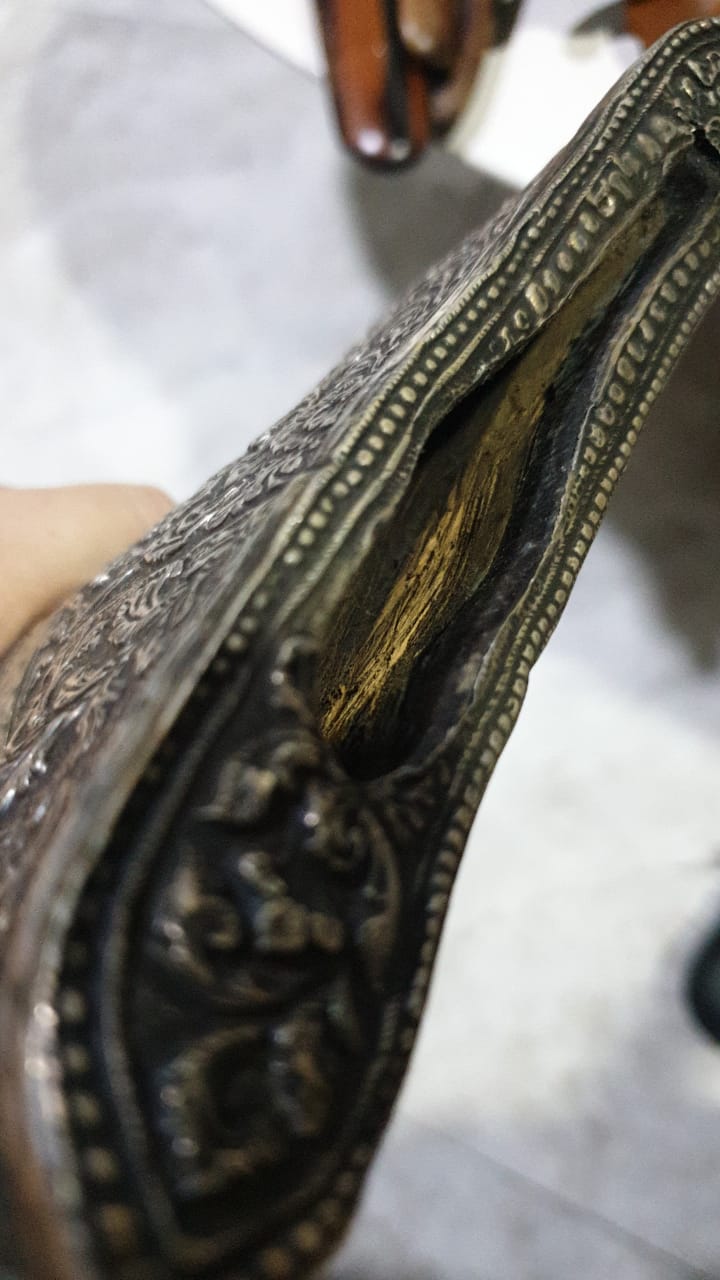

Full Silver warangka. Note the wood as its core.

The wood used in the core of a metal covered wrongko is never expensive wood, moreover, it is never seen, it does not matter in even the smallest degree if the oil penetrates the wood. In fact, it is perhaps desirable that the oil does get into the wood, as it will form a barrier between the cellulose of the wood and the ferric material of the blade.
Where oil stains do matter is where an expensive, sometimes irreplaceable timber has been used in an expensive, irreplaceable wrongko. If you cannot see the wood, and that wood is low grade wood in any case, it doesn't matter.
What does matter always is preservation of the blade.

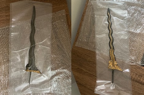

here are my Keris, the wilah is separated from handle and wrongko, oiled and vaccum-sealed. They're tucked away in a wooden box along with their sheaths.
Hello Shadejoy,
And do you keep them in a safe at the bank?
Personally I prefer my way and to be able to enjoy my krisses whenever I like and without having to perform any maintenance of the blade after the initial treatment with WD40, just checking the condition from time to time. However I live in a dry environment.

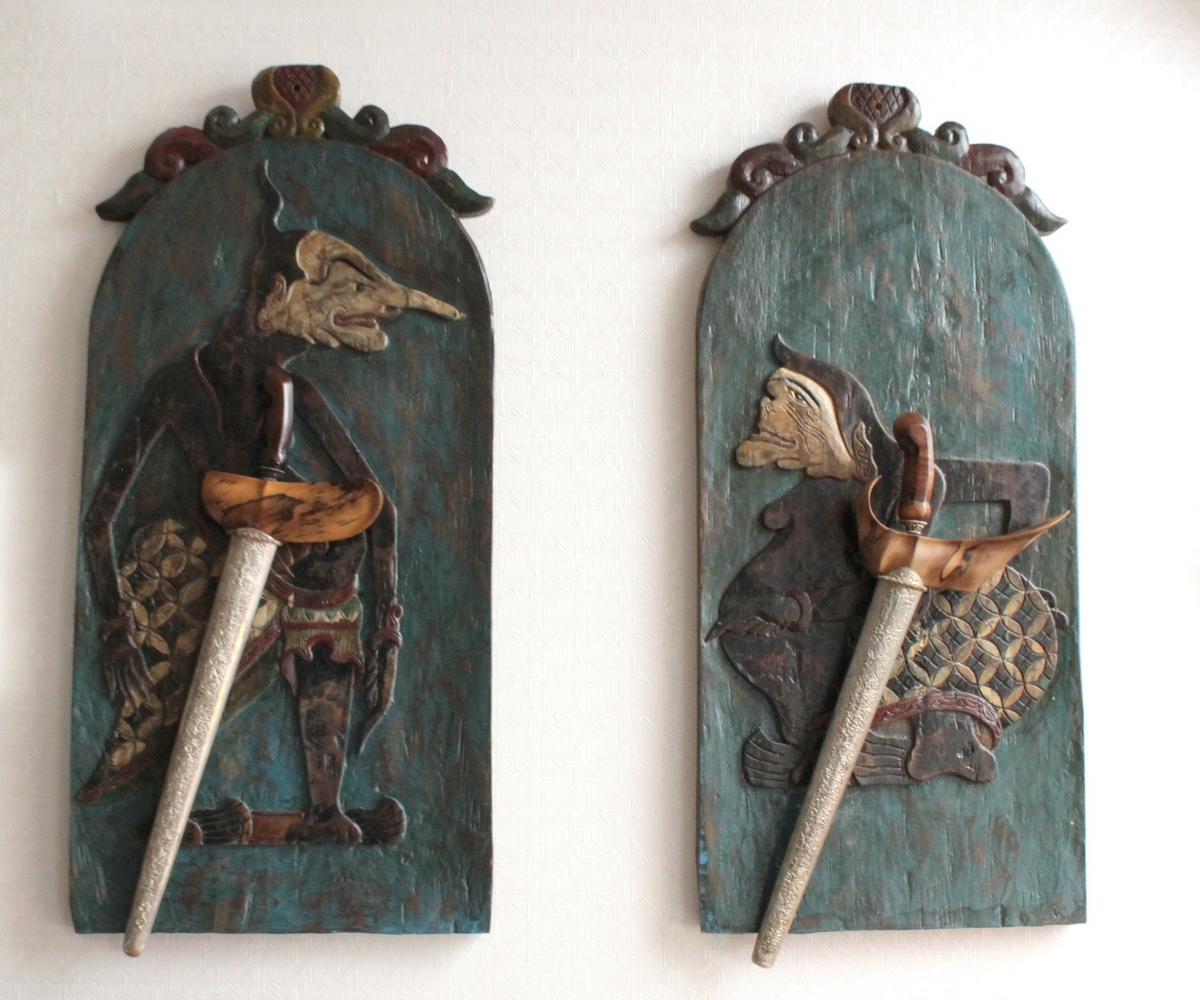

Originally Posted by Jean View Post
Hello Shadejoy,
Haha.. no, not in a safe. I think it comes down to lifestyle and personal preference. Don't get me wrong, I love my Keris, they are magnificent and valuable to me. My daily life isn't that hectic but between work and family, there is always something to do and places to go. There was one time I neglected my Keris for over a year in its scabbard untouched and noticed a small speck of discoloration on its wilah. It was thankfully gone after applying gun oil. So this time I thought I should do something differently.
Very nice pair of Panakawan blawong!!
