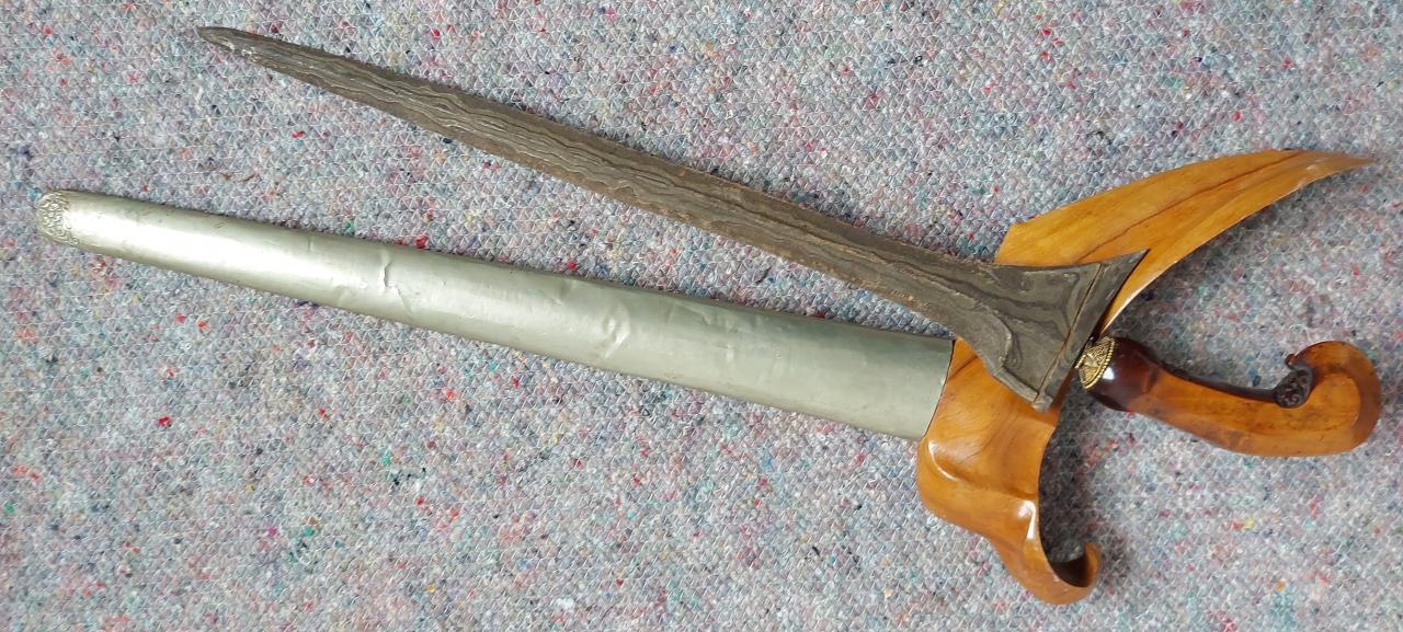

Would you please recommend a cleaning method for the blade in order to better uncover pamor on this Javanese keris.

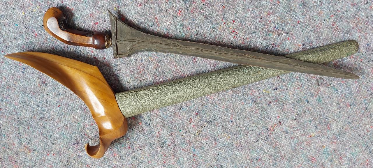

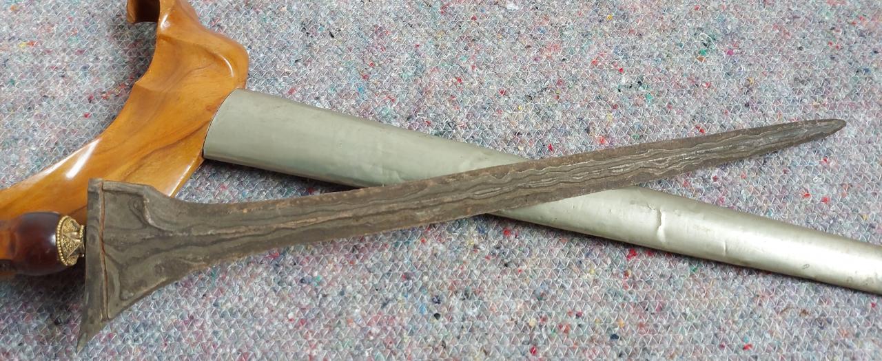

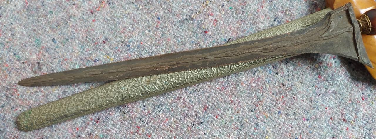

So I'm going to make a couple of recommendations that are intended to apply to the keris of which you have posted some pics.
Firstly, this keris is already in pretty fair stain, I would avoid a complete clean & stain, it is not necessary.
What I would try first with this keris is to take it into the kitchen with a hard toothbrush and give it a good scrub with ordinary dishwash liquid, use hot water, rinse thoroughly, dry with a lint free cloth & then a hairdryer.
You might find that this is all that is needed, but if there is still visible rust, buy a couple of tahitian limes, squeeze the juice, strain it, with a hard toothbrush scrub the rusted areas well with the strained juice, rinse well, dry and inspect. You might find you need to do this a few times, but light rust such as is on this blade will usually disappear under lime juice & scrubbing.
When you have it satisfactorily clean, thoroughly rinse & scrub with the dishwash liquid, dry again as before, then drench with WD40, allow to dry & finish with light oil --- as you will find mentioned several thousand times in the previous threads here.
For me, "satisfactorily clean" is not 100% absolutely free of all blemishes, sometimes a little bit of rust can remain in the open pores of the metal, sometimes there might be a bit of old, inactive rust somewhere. These things I normally leave alone on the first attempt but might --- or might not --- try to remove at a later time. The important thing is to preserve the blade and to be able to read the pamor, if you can achieve these two objectives without a harsh in depth clean & stain, you are doing all you need to do.
