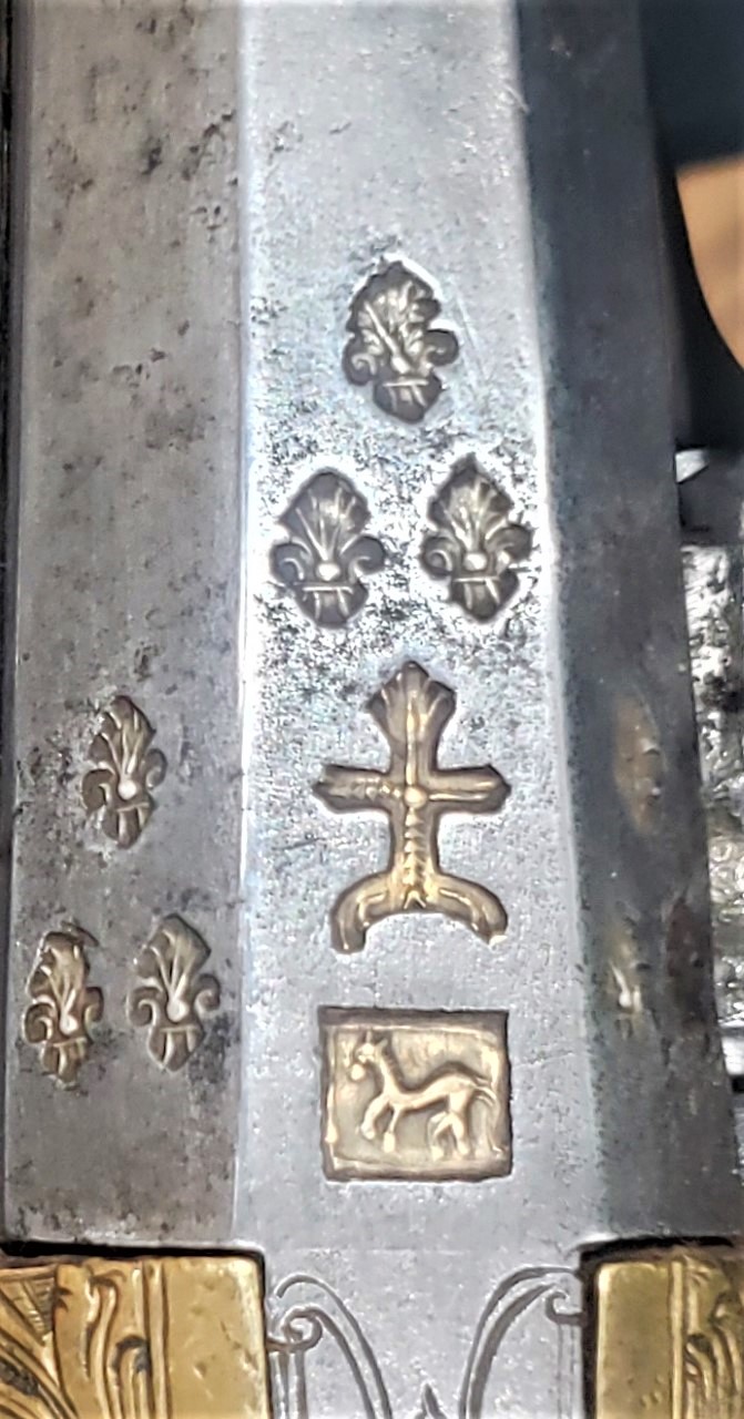

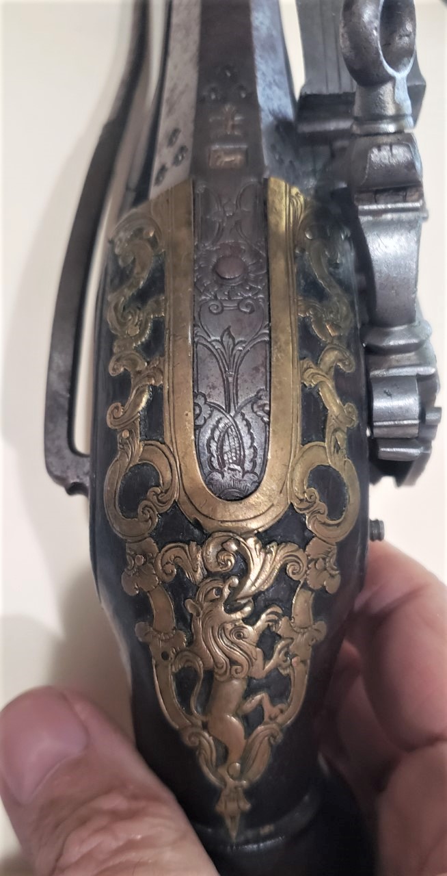

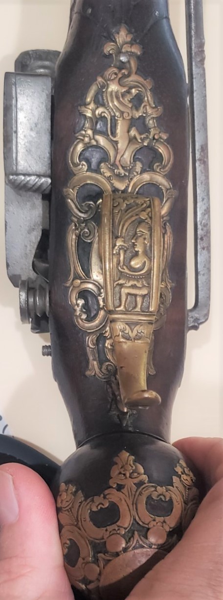

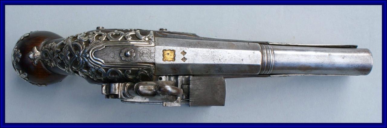

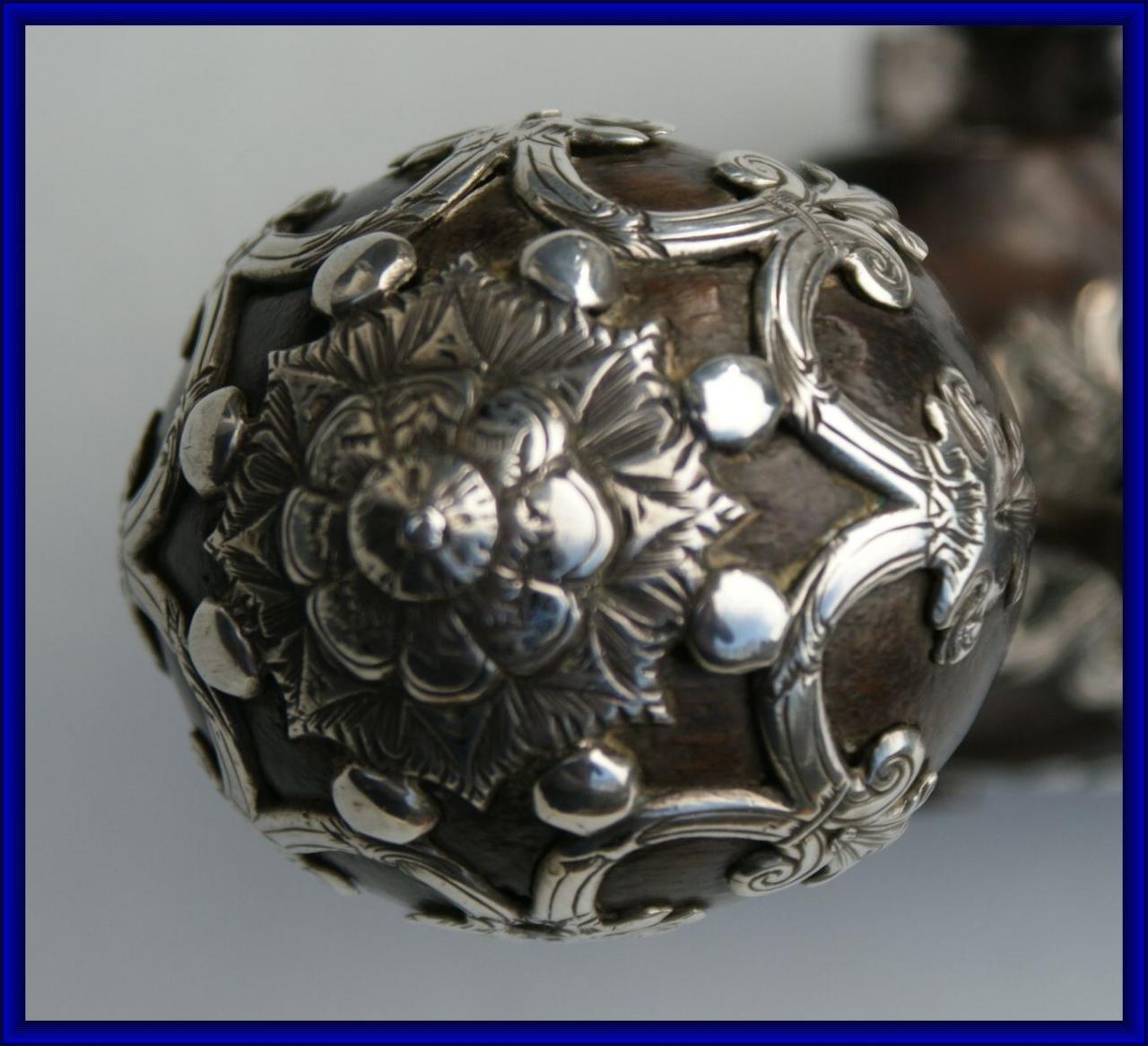

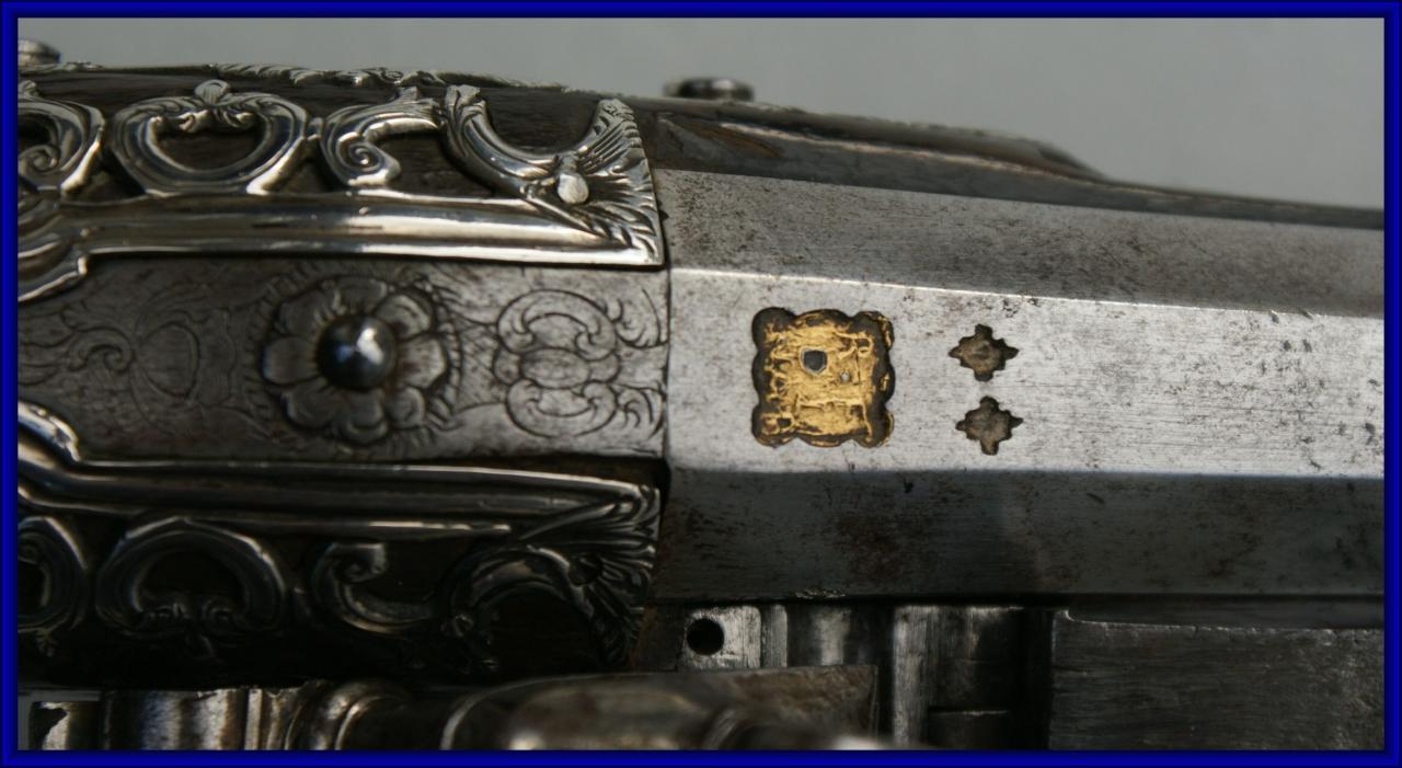

This pistol just came to light, wanted to share it with the forum.
Larger than most I've seen at 33 cm long. Approximately 80 cal.
The engraving is fine, and the motifs are very unusual. Dated 1798 on the lockplate. Ramrod appears to be replaced.
Interested in thoughts about what inspired the decoration of the mounts? I will reserve my own opinions pending member responses.

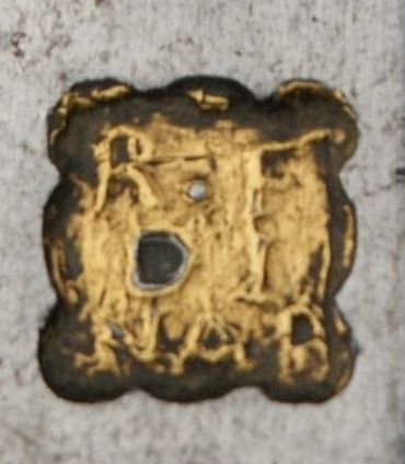

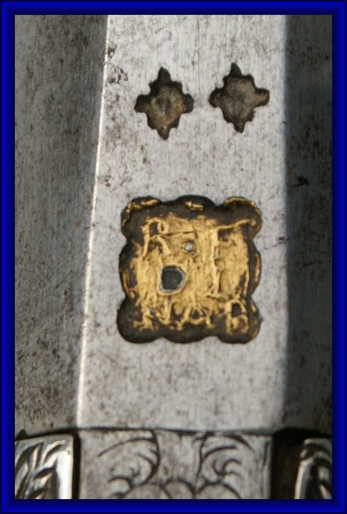

The marks are inlaid silver and brass

Peter Andeweg
Peter Andeweg's Avatar
Join Date: Feb 2020
Location: Vlissingen, Netherlands
Posts: 71
A very interesting piece. I was thinking of Spain with the typical Miquelet lock. The decoration reminds me of the Spanish colonies, such as native inhabitants from the Americas.
Similar figures can be seen on Tobacco jars from this period and before. The rocaille decoration relates to the fashion of the mid to late 18th century.

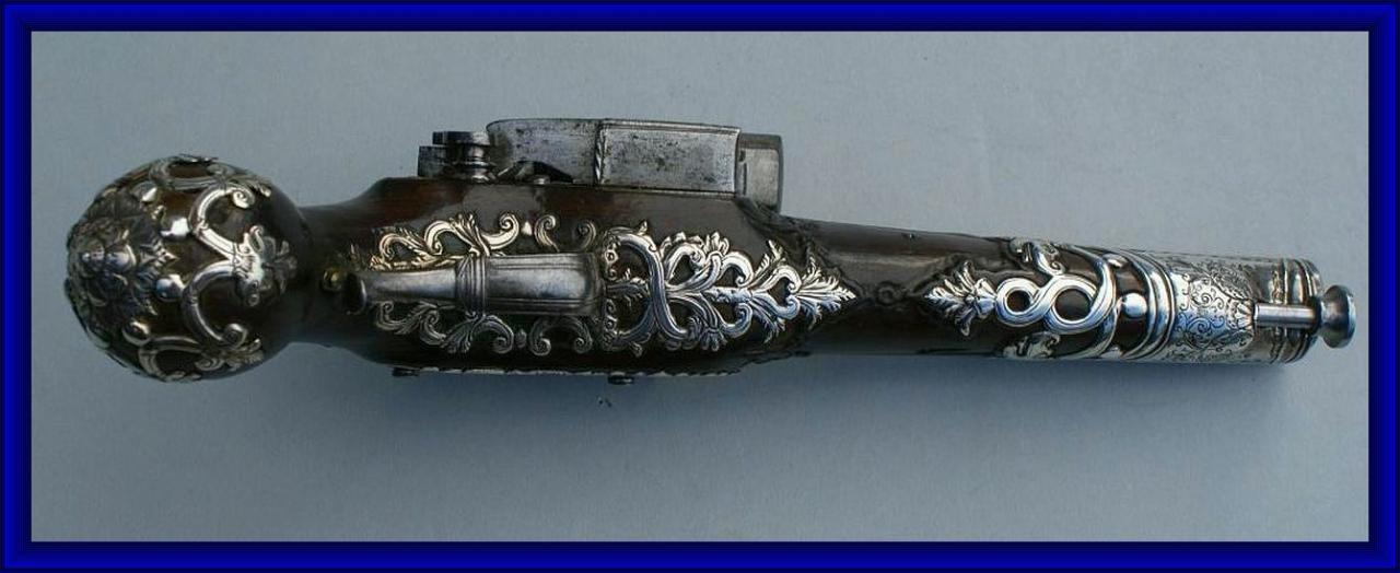

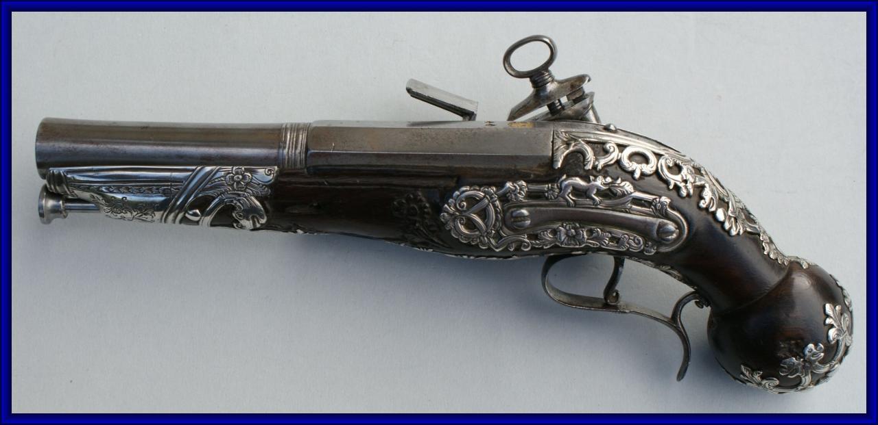

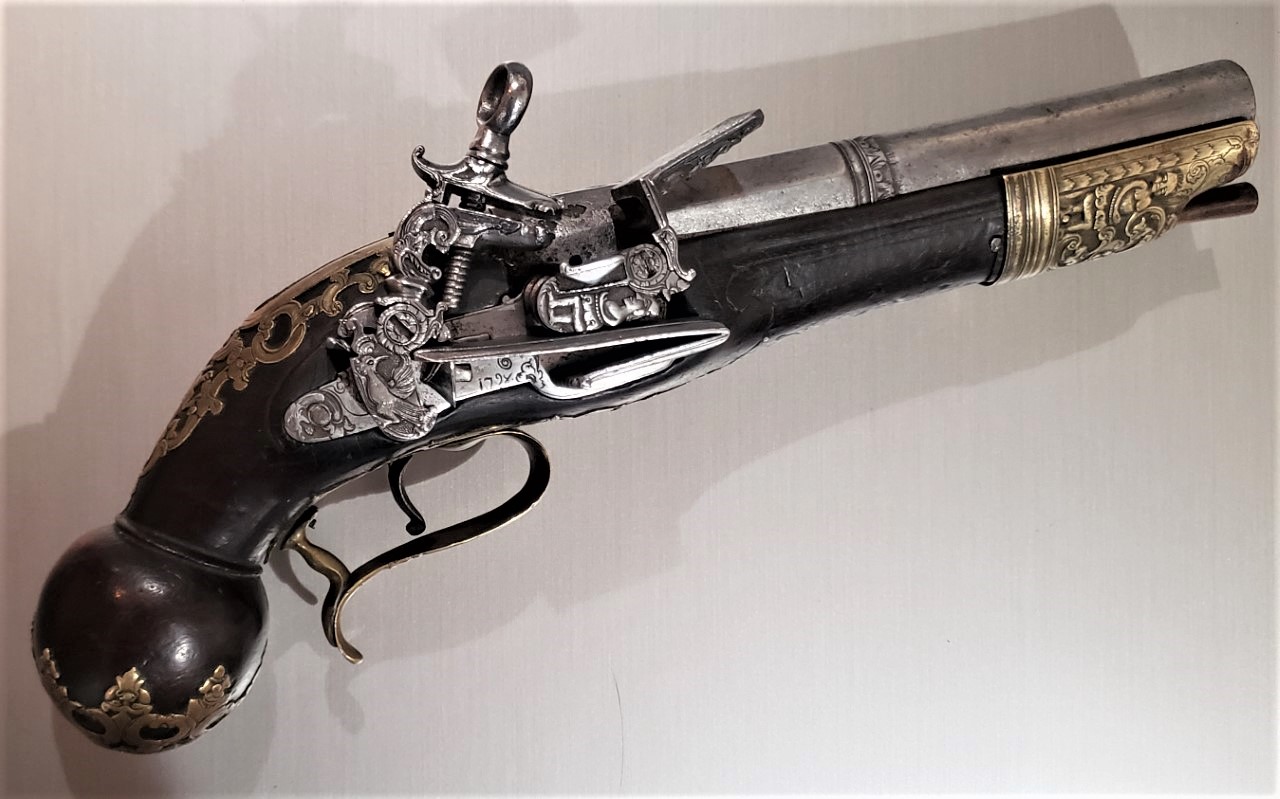

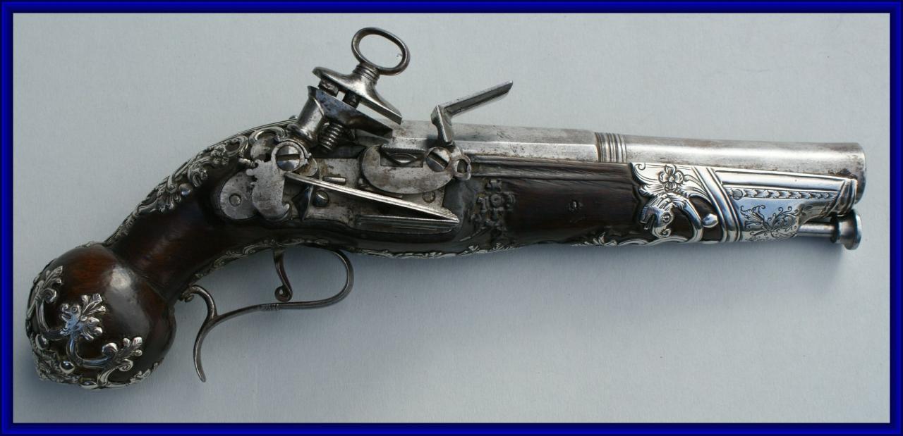

As a help to compare here are photos of a genuine Naples made pistol from the Real Fabbrica di Napoli. I think the pistol in question was made either in Spain or in America

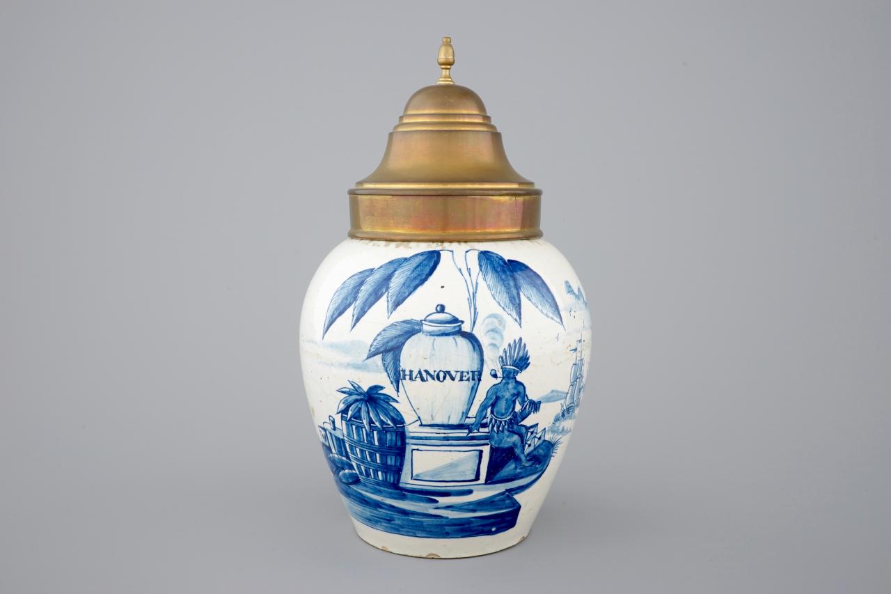

Here is a tobacco jar made in Delft, 18th century, with decoration inspired from the colonies, note the 'Indian' , original inhabitant of the Americas, and the VOC monogram on the right of the jar.
photo courtesy, Rob Michiels auctions - 2016

Thanks, Fernando K, Udo and Peter.
I have been unable to find other metal work
with such motifs. What could be the connection
between the two, European heraldic and
New World indigenes?

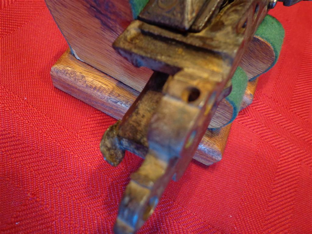

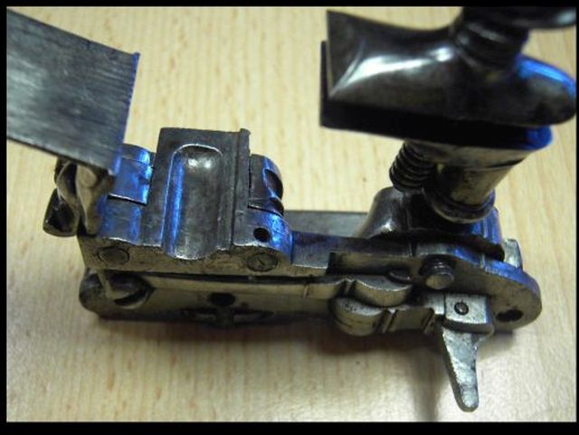

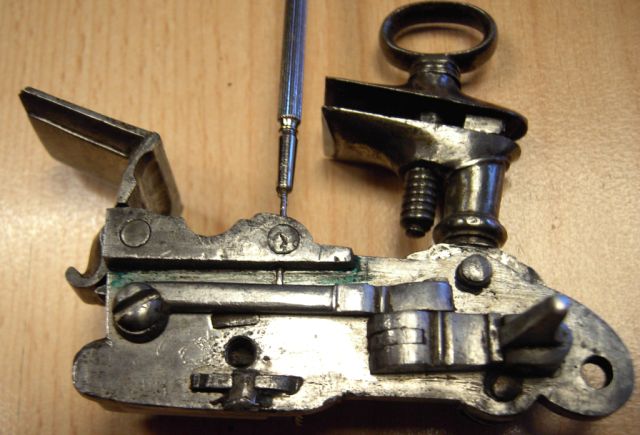

I do not understand what you mean with a "Faithful". I added photos which show the hole in which I stuck a screwdriver to show that the hole is going through. I do not know for which purpose this has been made and can see no sense in it, sorry.

Hello, Corrado
The "faithful" was a method used by the Spanish to fix cylindrical pieces, instead of proceeding to thread them, particularly with the frizen screw, so that it would not move, turn or come out. LAVIN mentions them in his work
Thanks for the photo and for replying.

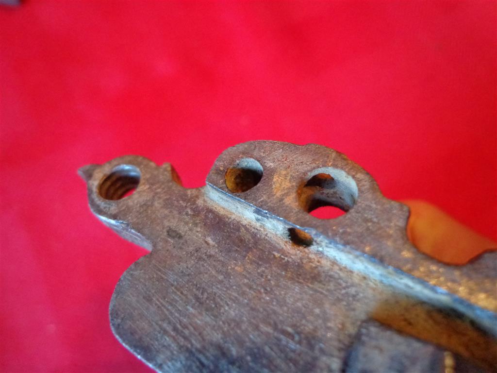

I attach a photograph. The Ottoman keys continued to use this method. Here you can see that the piece that acts as a screw has been removed from the frizzen and the faithful one, slightly conical, has also been removed so that it sits and does not move.
affectionately

Oh, what is described in the thread as a "faithful" is what is known in Spanish as a fiel which is a pin drilled transversely through a screw and its threaded hold to keep it from backing out or loosening with use. James D Lavin in his A History of Spanish Firearms pp 164-65 explains this quite well, it was a common feature of early locks (before the mid-17th cent) probably because screw-threading techniques were in that era not as precise as later on. By the 1640s, only the frizzen and cock pivot screws still used them. According to sources cited by Dr Lavin, the frizzen pivot screw was the last application for the fiel and this feature generally disappeared by the 18th century.
I have handled numerous examples of miquelet locks in my collection and restoration practice and find all this to be the case.

The fact that the appendix of the rake flange has a retaining pin is because the appendix is a cylindrical piece, which cannot be threaded, because the whole assembly cannot be rotated, because it interfered when rotating with the bowl (priming pan) The method of a round appendage is one of those used to fix the flange of the bowl to the platen, and that must be introduced transversally to its surface. Thus, the rake flange is fixed, in addition to the rake screw, by the cylindrical piece that is inserted into the plate and is fixed by the retaining pin.

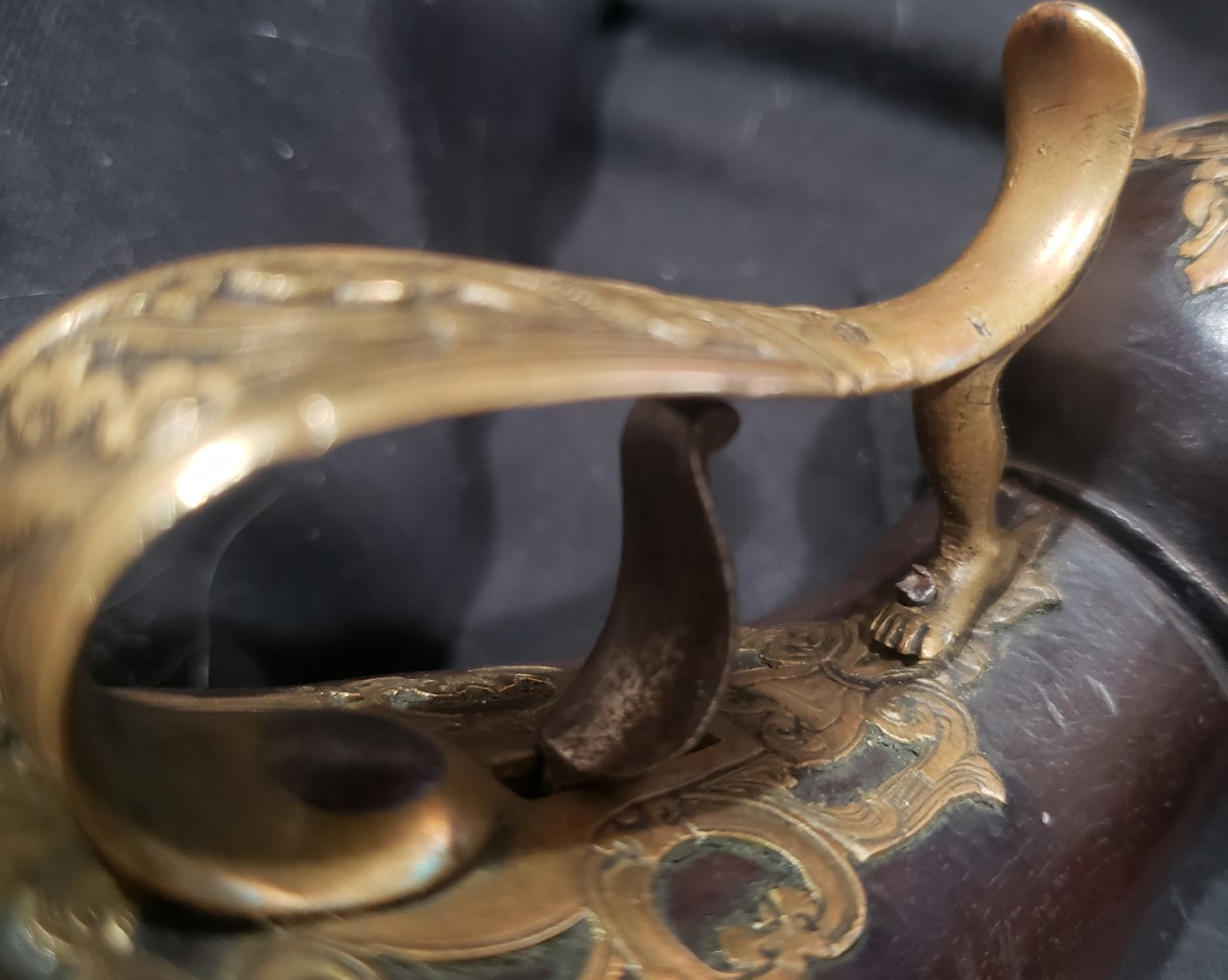

I do not find any relationship with the figures A lion appears, an unknown animal in America. The human figure is idealized (is it a man, a woman, an Indian?) They are only decorative figures. Besides, there are few copies produced in America

Lions may not be part of the native fauna of the Americas, but would have certainly been known to the human inhabitants of these continents after the arrival of Europeans via trans-Atlantic cultural influences -- such as art, literary references, and Biblical imagery.

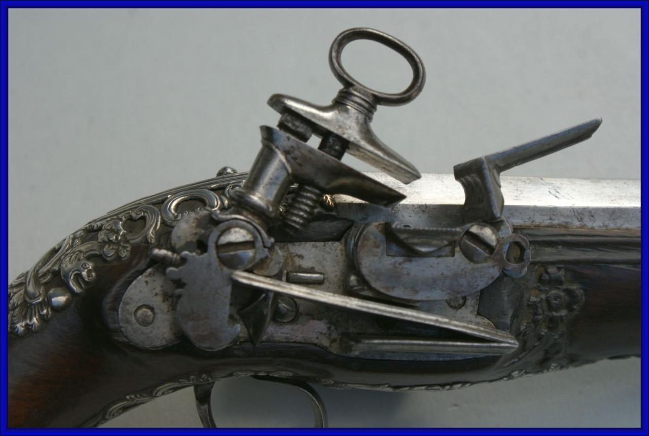

This hole looks like it held a crosspin that retains the tenon that projects from the rear portion of the priming pan cover plate / bridle. This tenon fits into a corresponding hole or mortise in the lockplate, and the perpendicular crosspin helps anchor it. As Fernando correctly points out, this tenon cannot be a threaded bolt because there is no way that the plate/bridle can be rotated into place under the pan.
Whether this pin, for this particular application, can be regarded as a fiel in light of the rather precise definition of same in old texts is a subject for another post. However, at this point we can be clear that the mounting of the priming pan bridle / cover plate is a separate issue from the frizzen pivot (mounted just ahead of the pan).

This has inspired me to look through the miquelets in my collection to see how the frizzen pivots and the means of securing the pivot in place. It turns out that on all these (European, not Oriental manufacture) locks, the frizzen pivots on a screw. All of them employ threaded screws on which the frizzen rotates.
1. Very early patilla lock of somewhat primitive design, Brescia, first half 17th cent.: It has a long bridge-like bridle connecting pan and cock pivot (as on Ottoman/Balkan locks of later date), neither pivot screws are held by fieles.
2. Early Ripoll pistol ca. 1645, ex-Lavin, publ in his book, figs 115A and 117A, the frizzen screw is held by a fiel.
3. Patilla lock made by an Austrian or German smith (for a remounted war-trophy Ottoman damascus barrel, late 17th cent.) no fiel retaining either cock or frizzen screw.
4. Neapolitan lock by Scarpati of the Fab Reale di N, same remarks as 3
5. Shotgun by court gunsmith de Zegarra, 1770s, same remarks as 3
6. ditto, by Fernando Murúa of Eibar, ca 1790-1810, same remarks as 3
7. Eibar lock on pistol by José Aguirre, beginning 19th cent., same remarks as 3

To me, this looks like a Spanish colonial piece rather than made in Spain or Italy, the decorative work is just that little bit crude or naive.
Spain's colonies were very widespread, including North Africa as well as the Americas, the Philippines and even in some parts of Asia.
I am discounting the Spanish Netherlands here because they had their own style, and no lack of extremely skilled craftsmen.
