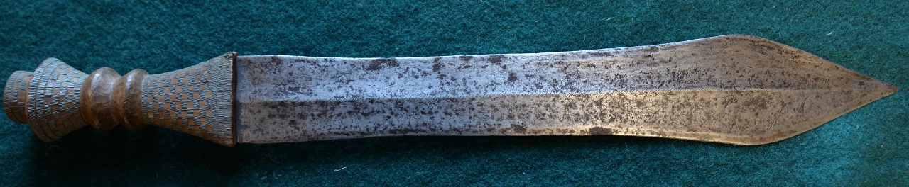

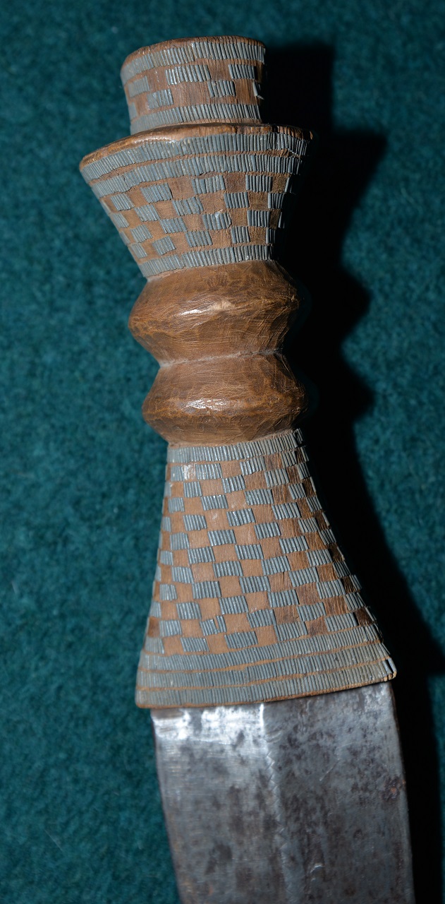

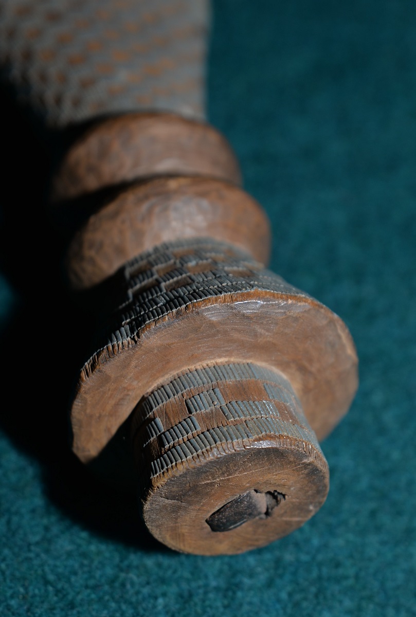

Hi folks
Recently I have been expanding my horizons a bit into the Congo - a whole new world of wonderful forms But also mysteries. Here is one of mine. I wonder what opinion about the origins of this sword is?
It was sold to me as a Songye sword, and I can see that the blade shape is very like Songye swords. However, I cannot pin it down and I don't think the hilt and grip decoration suggest Songye. Here are some possibilities I considered:
Songye (claimed) . I found online pictures with no refs of similar swords but the hilts do not match. Blade form similar to three shown on WoDiMi's site. Also here for similar blade shape (different form) and similarities of grip - but different decoration.
Luba - Bastide identifies one example of this shape blade to Luba, but no central ridge. This example is very similar
Kuba - grip style and decoration very similar to Kuba Ikul swords. An example from WoDiMi's site: A Kuba Bambala Goribi sword with grip decoration and general grip form like this one. Blade different.
As far as I can deduce from my available literature, blades of this form do not seem to be Kuba (or just not in the books). The attached picture with copper blade is another Kuba Ikul from the collection of Dieter Schaffner (which I just bought and will hopefully be with me soon). The hilt similarities are strong.
On balance a hilt of this type seems to point to Kuba - but the blade form is a problem. So I wonder are there Kuba examples of swords of this form, or is it more likely a Kuba influenced people (who, Bena Lulua?). Or perhaps there other strong contenders I did not consider?
I'm sure some of the Congo experts here can steer me onto the right path.
Chris

Hi Chris
The handle is Kuba, i'm not shure about the blade.
Blades often travel great distances as steel/ iron was very valuable.
Often traded without a handle, the new owner puts on a handle according to his tribal traditions.
My guess is Bena lulua, tschokwe or yaka, i'm not an expert just a humble collector.
Best regards

Hi Chris
Nice old sword, I believe it to be a Kuba sword please have a look at the website www.memoire-africaine.com. If you look under the SMS section and at the Glaives you will find a photo of a Kuba sword similar to yours. It is dated around 1900.
Miguel

Thank you Marc and Miguel
So I am getting the feeling that the decoration on the hilt is what marks this out as Kuba, but I could see some more of the pictures of the Songye swords on the site that Miguel linked to with similar hilt and blade, but not the decoration. So perhaps pointing to overlap between Songye and Kuba, which probably brings it back to Luluwa.
That website is really useful, thanks for linking to to it Miguel!
Mefidk is offline   Reply With Quote

Hi Chris
glad you find the site interesting Find it one of the best for Congolese weapons, it was linked tome some time ago by a forum member.
I think you are right in your thoughts concerning the hilt decoration and still believe that your sword is Kuba but handle decoration apart I can see where you and the other forum members of the forum are coming from in thinking it is Bena Luala due to the form of the blade which is not the common form of the Kuba blades.
Miguel

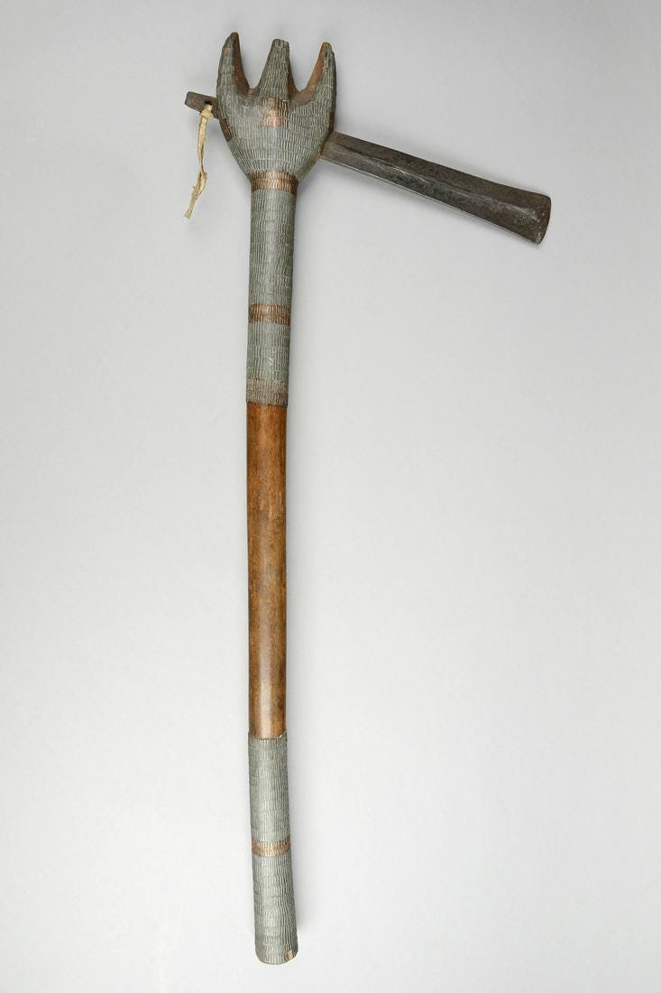

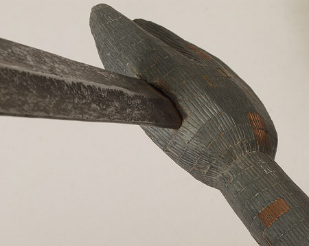

With regard to Kuba swords and knives ... the inlaid metal decorations to the wooden hilt are very finely done, usually in a greyish colour metal (sometimes in copper) ... I have wondered what type of metal it is - lead or zinc ??
Another observation - very similar work is to be found on some Acholi (Uganda) axes (images attached), but the Acholi are a long way from the Kuba. I wonder if this is just coincidence or is there another reason ?

That does indeed look like the same process, and even really closely similar styles and materials. Is this known from other areas too, or just these two?
I don't recall seeing it on other examples not attributed to Kuba, but clearly there are some.

Chris, looking through the book "Panga na Visu" by Zirngible & Kubetz ... the only other tribes that seem to utilise this particular type of metal decoration on their weapon hilts, seem to be the Wongo and the Lele peoples. I believe they are both related to the Kuba and to be found in the same geographical area of the Congo ?

Hi Colin, that makes sense. Both Wongo and Lele are from Luluwa west, between Kuba and Pende, which fits well with the ideas on the sword which started this thread.
The closest other I found is Fishcher and Zirngibl fig 262, which Tchokwe, but the style is quite different even if the technique is similar. Nowhere near as close as the axe you showed. Also similar technique but quite different patterns from Luba, e.g. Waffen aus central Afrika fig 151.
So I suppose its possible that the axe pattern and Kuba patterns arrived independently. At least the technique for attaching these small metal strips seems quite widespread in central and south-east Congo (if not the style). So maybe it travelled or evolved elsewhere, even Uganda.
Panga na visu is really a nice book. My library on Congo includes this and Waffen above; Fischer; all of the Tribal arms monographs volumes I & II; Bastide's 3 books; Fatal Beauty; Rare African short weapons by Zirngibl; Standing on Ceremony; & The Cutting Edge. But I feel there must be more out there of use (sorry Luc I do not yet have your book if you are looking ). Do you know others you'd recommend?
Most of my collection is axes, for which I have not found any specialised book, but it would be nice if there is one I don't know of!

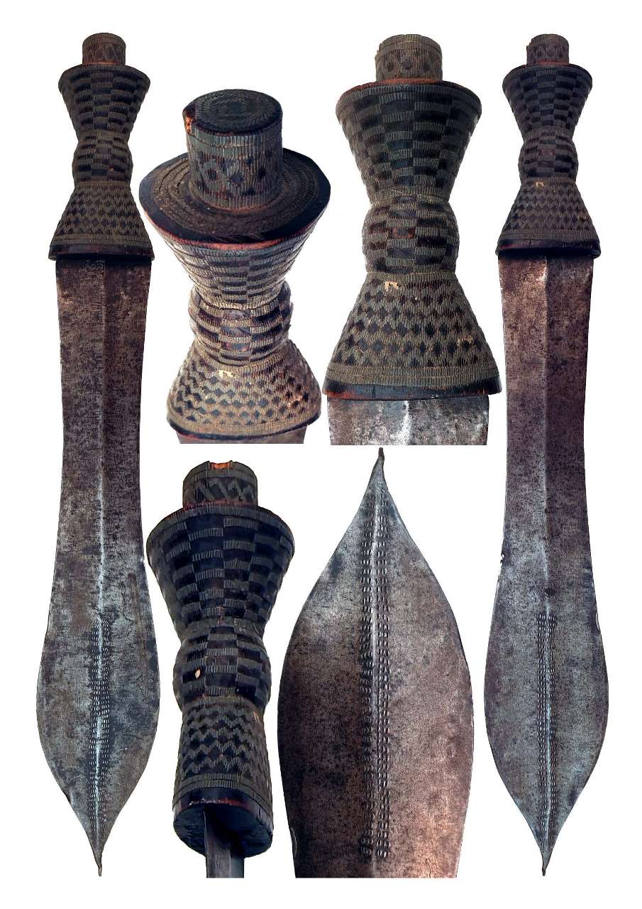

I did post this seperately but thought I might post it here as well. This short sword is almost identifcal to the one at the beginning of this post.
It is 18 ¼” (46.4 cm) long over all with a 13 ½” (34.4 cm) blade which is 2 ¾” (7 cm) wide at the swollen end. I had thought it might be a Songye, but I couldn’t find anything quite like it in Stones Glossary and African weapons are not my strong point.
The blade is very distinctive and based on this alone having looked at all of the examples on http://www.memoire-africaine.com/armes2.html and http://www.africanarms.com/gallery?9...-sword-49-3-cm, I still have the following list of what it might be:
Songye-Eki-Nsapo / Congo 1900-1920
Sword NGALA-Bangala
BENA-LULUA LUBA DRC
Glaive Tchokwé-Lunda 1900 Angola / Zaire
Songye short sword
Songye prestige sword
I am hoping someone might be able to narrow it down for me.

More likely lead. It tends to get darker and duller with oxidation. Whereas Zinc gets dustier and whiter and can even get a light grey to white powder oxide deposit wherever there is a seam between it and wood for long enough. Zinc is also rather brittle by itself. Zinc also tends to be found as an oxide or sulfide in ores, mixed in with a lot of other stuff. Usually a good amount of smelting is required to extract relatively elementally pure zinc. Whereas lead can be frequently found in what is sometimes called native form. Appearing as highly homogeneous nuggets that can be cold forged as found very easily into a wide variety of shapes (working with lead is almost like working with play-dough in how it behaves). Lead likes to spread out when you hammer it so it would work really well for inlay. Zinc you'd have to cast and cut and can't really do much in the way of hammer shaping without crumbling it.
Another option for a dull grey malleable is pewter. Which is basically the opposite of bronze (high tin with a little bit of copper and other things as apposed to high copper with a little bit of tin and other things). But pewter can be really expensive and difficult to come by depending on where you are. Because tin is a rare earth metal. You really only see prolific use of it in native cultures where there are high deposits of tin as well as antimony and bismuth. Or where they could trade for it with areas that had it and had a high affinity for the stuff.

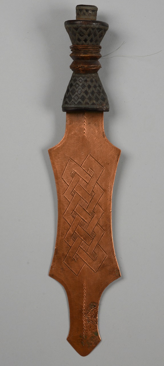

Hi,
As for the "inlaid metal decoration", it can also be found on the handles of Hausa daggers (Nigerian Sahel). I believe that Hausa daggers decorated in this way have appeared on the Internet (e.g. eBay) during the last few years (I don't want to speculate if it's old original element or innovation ...). We can see the example in the picture of the gallery http://www.memoire-africaine.com/armes2.html where (in my opinion) it is incorrectly marked as Kuba (the shape of the handle, the blade, the engraving on the blade and the scabbard are typical for Hausa).
Martin
