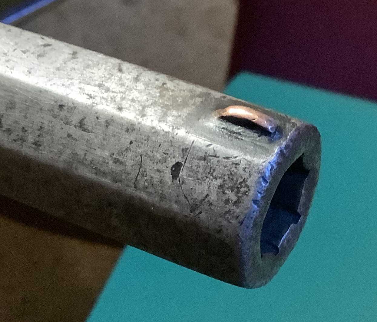

The jezail weighs in at a touch under 6 kilograms! With the centre of gravity being about 76 cm out from your shoulder, quite impractical for unsupported shooting. This must be thought of as a kind of bench-rest rifle.
However, the Khyber Pass being somewhat bare of proper benches, consider it a "rock-rest rifle". Maybe I'll get around to making one of those spindly bipods that are sometimes shown in old prints and photos?
Btw, I am still cleaning it. I had expected to find rust in the barrel. Instead, the grooves seem to contain a residue of pitch-like gunge. So far it has resisted all reasonable solvents (Ballistol, Ed's Red, paint thinner, even acetone and oven cleaner) and so I am stuck with shoot...clean...shoot...clean.
It will thus be a while before it reaches its full accuracy potential.

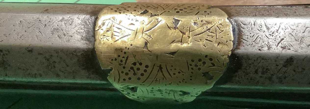

Default Tar-like residue
Whatever it is, it's resistant to everything that I dare to put down the barrel!
I think the barrel might be some kind of damast, which is why I would not like to use aggressive chemicals.
Photos now inserted. Unfortunately the software limitation means that I cannot post the picture of the barrel with adequate resolution to show up the wavy patterning. Just use your imagination!

Are you sure its not just old hardened black powder residue?? Try scrubbing with boiling water. We always used that to remove (most of) black powder residue. Then used black powder solvent to finish off.

"Are you sure its not just old hardened black powder residue?? Try scrubbing with boiling water. "
Could well be rock-hard BP residue. About a century old!
I'll give hot water a try. But since I can't remove the barrel from the stock, I need to make an effective plug for the touch hole.
BTW, everything is glued together with what appears to be a kind of pitch. Has anyone got a clue as to what the Afghans actually used? Pine pitch?

Well the barrel is evidently damask aka twist, and a very nice piece indeed. I would suggest that whatever is in there is "better out than in" ...and it's your jezail and we are just onlookers. Not surprised by the quality of the barrel, these guys were happy to pay the price for their gear, blade or barrel.

Don't worry about the touch hole, just leave it as it is. A bit of water on the woodwork won't matter, but if you want to, use a match stick/s to fill the hole. If it breaks off it can easily be removed by pushing thru into the bore and it will drop out.

"A bit of water on the woodwork won't matter, ..."
My worry would rather be about getting water between the barrel and the stock. Where it would start to rust and be inaccessible.
"...but if you want to, use a match stick/s to fill the hole. If it breaks off it can easily be removed by pushing thru into the bore and it will drop out."
Thanks Stu, that is an excellent suggestion!
