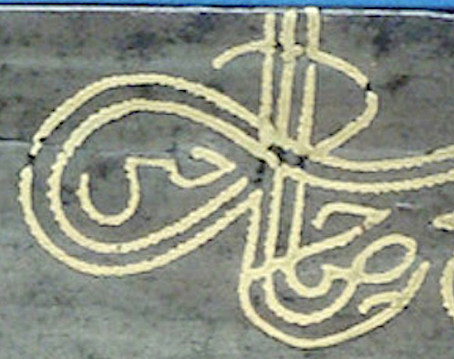

Since this thread i've tried and tried to compare the tughra with the Ottoman Sultan tughras and am stumped. A couple of possibilities but nothing firm.
Is there anyone who can translate the bottom half (or take an educated guess) of the tughra? This is supposed to be where the name of the sultan should be. The sultan's name would help narrow down the age of this yataghan.

Is there anyone who can translate this?
I think I answered this before but perhaps it wasn’t clear. This isn’t a royal tughra, it’s an owner’s inscription in tughra form, which is quite common
صاحب حسین
“The owner, Husayn”
There is an extra letter ح in there, it might possibly also be
صاحب حسن [ابن] حسین
“The owner, Hasan [son of] Husayn”
On reflection, another possibility for the extra word might be
صاحب حاجی حسین
“The owner Haci Husayn”
It’s not clear however and the extra letter may just be a feature of the design so I would leave it as “The owner, Husayn”

Kwiatek, thank you. I didn't know that there were owner's tughras. I thought tughras had to be royal ones.
I learned.
