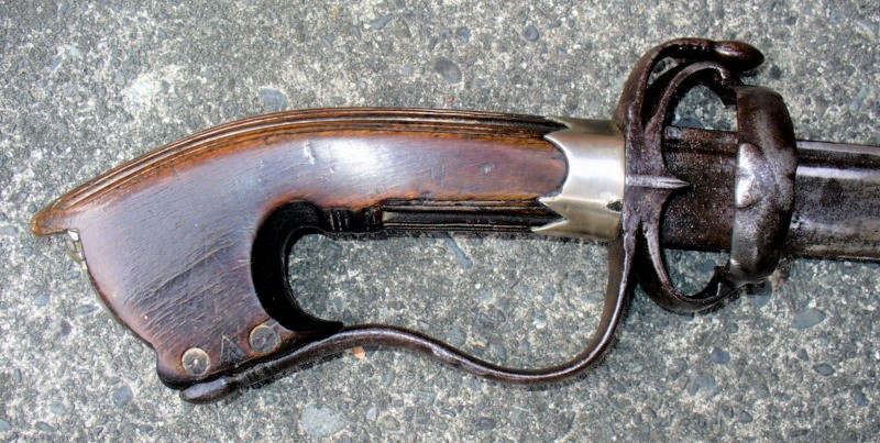

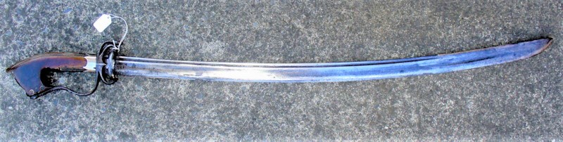

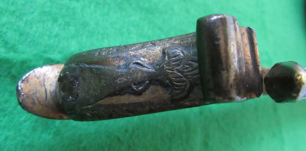

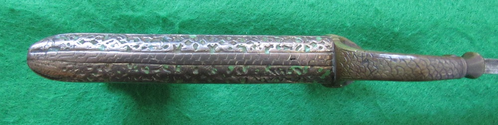

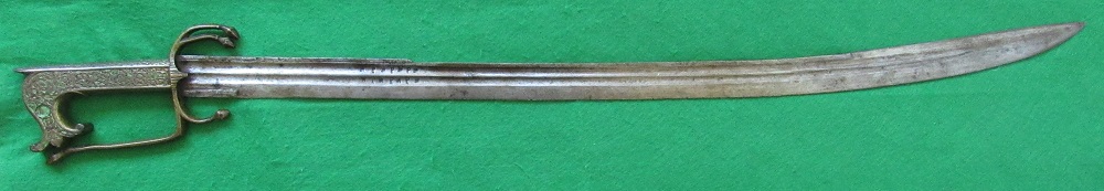

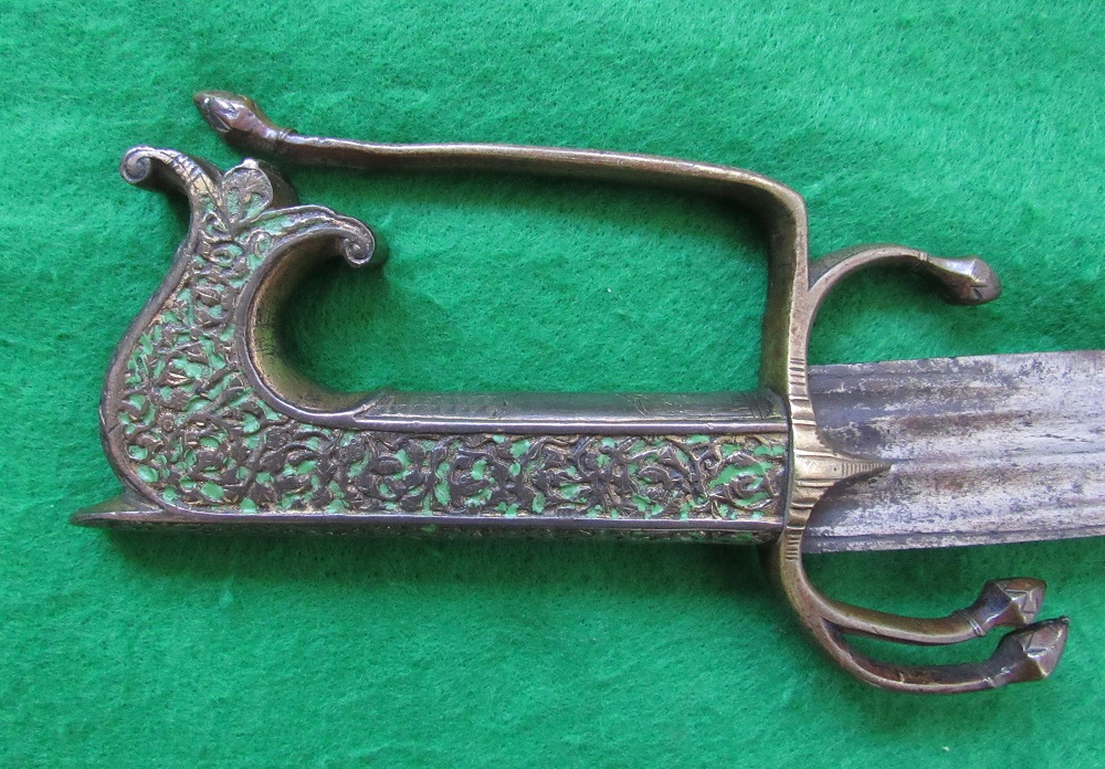

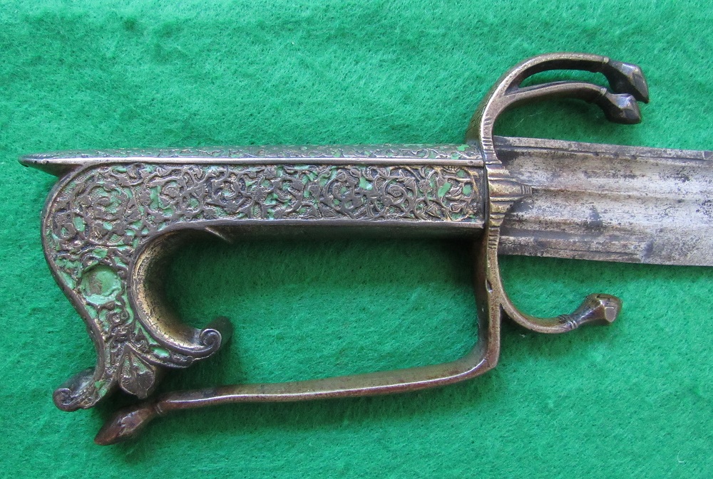

I have always wanted an older nimcha and I believe this one is 18th century or earlier. Buttin shows a similar one as #991 in his catalogue and dates it to the 14th/15th century, but with all due respect to Buttin I feel such dating is off by a few centuries. I am not aware of any evidence of nimchas existing as a form prior to the 16th century.

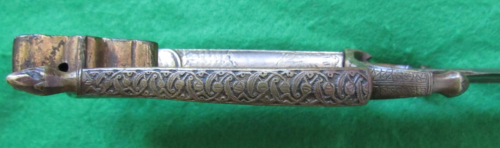

The grip is entirely encased in brass, which has traces of gilding. There is also green paint or enamel in the recesses. A stone must have once been set on the pommel on the site which faces outward when the sword is worn on the left hip, but it has been lost. The guard is also brass with engraved decoration.
Claude would classify this as an Algerian nimcha, which seems justified based on decoration and some provenanced examples. However, Claude seems to classify any nimcha with an older blade with a pronounced yelman as Algerian regardless of some having Moroccan hilts. Such attribution creates two major assumptions - first, that prior to the 19th century, the nimcha was not used in Morocco and second, that during the 19th century it fell out of use in Algeria. It is plausible that the nimcha did indeed go out of fashion in Algeria and the rest of the nominally Ottoman controlled parts of North Africa, replaced by Ottoman weapons such as palas, kilidjes and shamshirs. But is it also plausible that the nimcha hilt was not used in Morocco until the late 18th century?

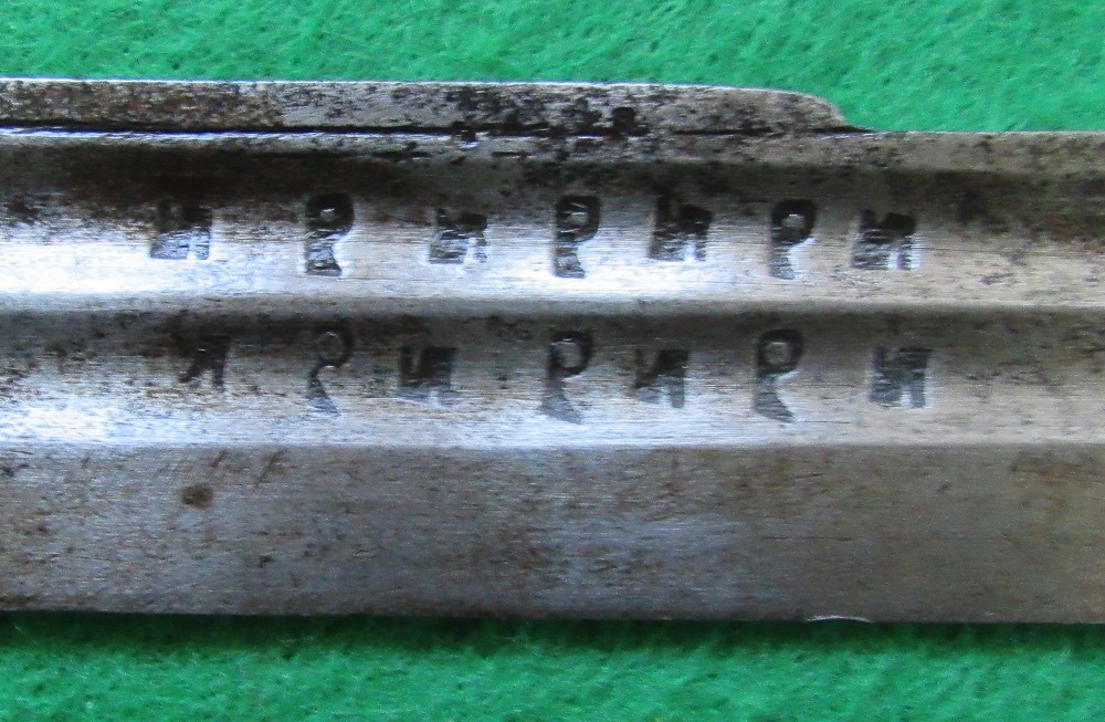

The blade is fairly typical of what we see on earlier (or Algerian, if you like that classification) nimchas, with two fullers and a blade which narrows between the ricasso and the yelman. It could be European made, and it has markings on one side, which seem like an attempt at a signature imitation, perhaps by an illiterate smith.
It is interesting to observe the "peaks" on the pommel, similar to peaks on Omani and Eastern African nimchas. The hilts from two opposite sites of Africa are too similar to have been developed independently. Buttin proposes an eastern origin of the nimcha, with the hilt a stylized dragon inspired by weapons such as the Sinhalese kastane. I personally find North's argument for an origin from the Italian storta more convincing, given that certain elements of the quillon block and the entire guard itself were probably directly taken from stortas. That being said, it seems that the nimcha hilt made it to Southern Arabia and the Swahili coastline almost at the same time it appeared in the Mediterranean. This actually makes quite a bit of sense when one considers that the Ottoman expeditions in the Indian Ocean coincided with the height of the Ottoman Naval Power in the Mediterranean during the 16th century - the period the nimcha appears as a form.
Anyway, enough rambling, here are the pictures.

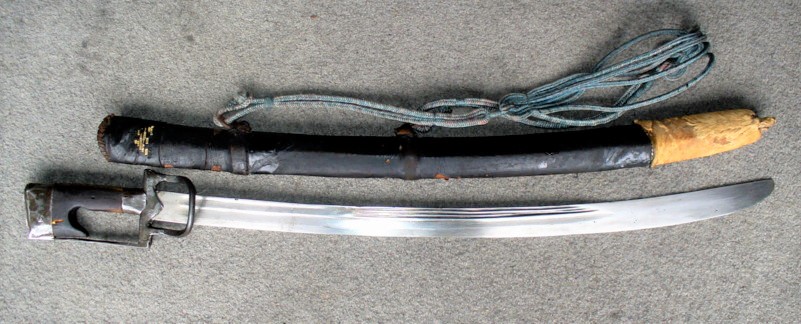

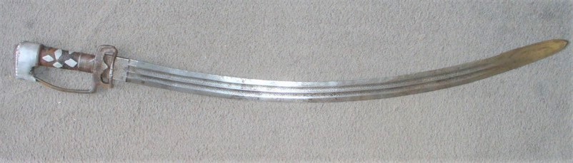

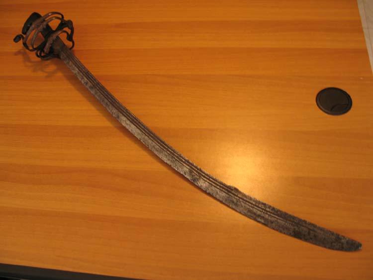

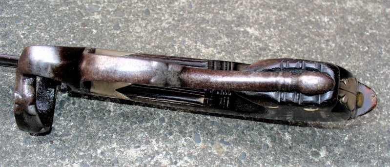

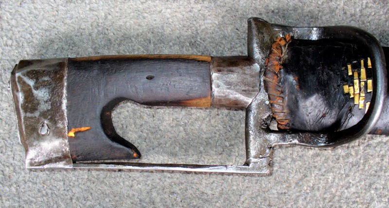

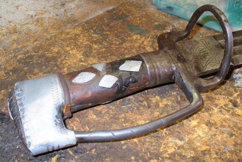

To add some discussion points to your thread, here are some pics of other Nimcha and tribally made??? copies mounted to various blades.
The typical D guard so called Zanzibar Nimcha is shown together with tribal copies also using the D ring guard.
Stu

Thank you Stu, I find the connections between the Zanzibari nimchas (Zanzibari used here to refer to all nimchas from Southern Arabia and the Eastern coastline of Africa) and the Maghrebi ones fascinating. The D-ring feature is found on nimchas from both areas, but it is rarely found on Maghrebi examples and only on really early ones. At the same time, it is prevalent on Zanzibari nimchas. This seems to suggest that the form made it over to the Arab Sea and Indian Ocean quite early (assuming West to East distribution).
Here are some hilts in my collection, which we can use to make some observations. To the left of my new Algerian nimcha are two Moroccan ones - a typical one to the far left and an interesting variation with the two inner quillons perpendicular instead of parallel to the blade. Note also that the outside quillon which is curved towards the blade does not end with the typical Moroccan style ball, but is much flatter, like the quillon on Zanzibari nimchas. It is tempting to categorize this type of guard as a transitional one between D-ring guards and guards without a D-ring. It is rarer than the usual Moroccan nimcha guard, and in the few instances I have seen such guards they tend to be mounted on older blades (mine is on a mid 18th century English hanger with a fox mark, the one in Claude's book has an older blade as well). It appears therefore that this type of guard is slightly earlier than the more widespread later form with quillons all parallel to the blade, probably dating back to the late 18th, early 19th century, which would support the hypothesis that this is indeed a transitional type.
To the right are two typical Zanzibari nimcha guards - the one right next to the Algerian nimcha has a steel plate with cut out decorations inside the D-ring, while the next one does not. It is possible that the plate was added to strengthen the D-ring, which as you can see on the other nimcha has been broken. The Zanzibari nimcha next to the Algerian one is also the higher quality example of the two, with a slightly larger hilt and more decoration, so the plate might have been something reserved for better quality examples.
The next sword to the right is another Zanzibari nimcha, but with a simpler, brass guard and no D-ring.
Finally on the far right is a saif from Southern Yemen. It lacks the nimcha guard with its knuckleguard, replaced with a crossguard instead(and a chain from the quillon to the pommel which is missing on mine), but the grip and pommel are undoubtedly of the same form as on nimchas, except that the pommel is tilted at a 90 degree angle to the hilt, more so than on Zanzibari nimcha pommels which are tilted at a smaller angle.
This is of course only a partial snapshot of the many variations that exist on nimcha hilts, so hopefully other members would share some of their nimchas here, along with their own thoughts.
Teodor

With the example posted here in the opening of the thread, that blade looks distinctly Italian, and those markings reflect characteristics of Italian lettered marks in parallel, and quite possibly 17th c. The unusual raised section on the blade back nearest hilt seems like Italian blades I have seen.
