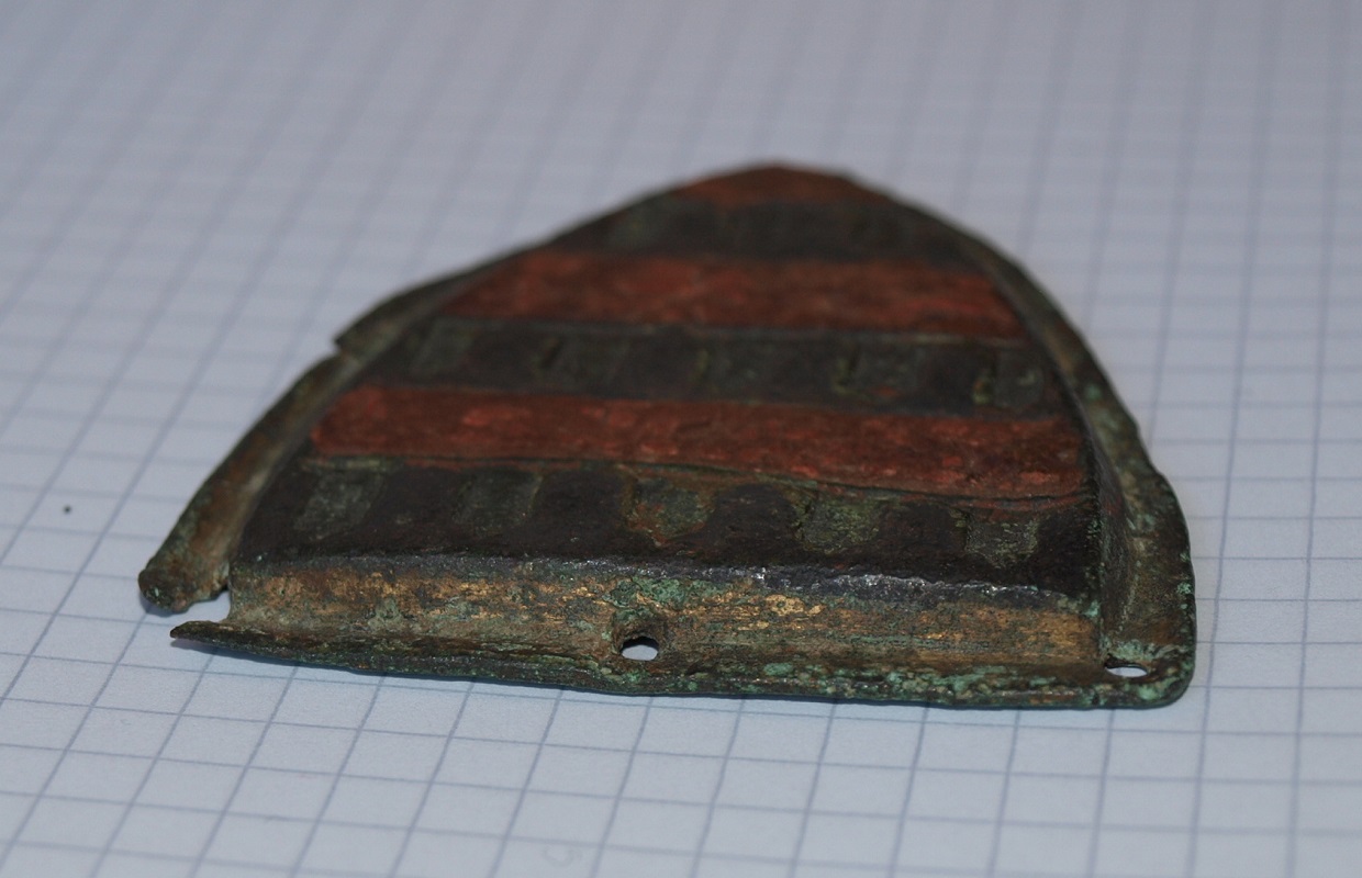

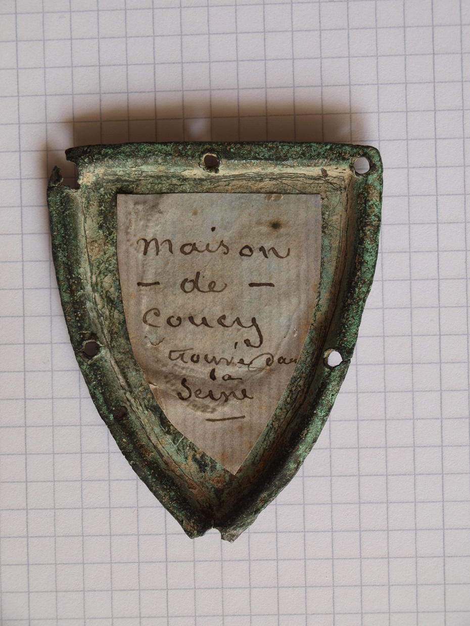

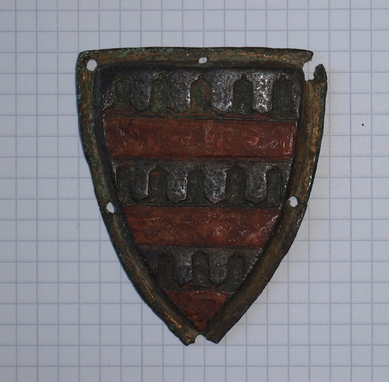

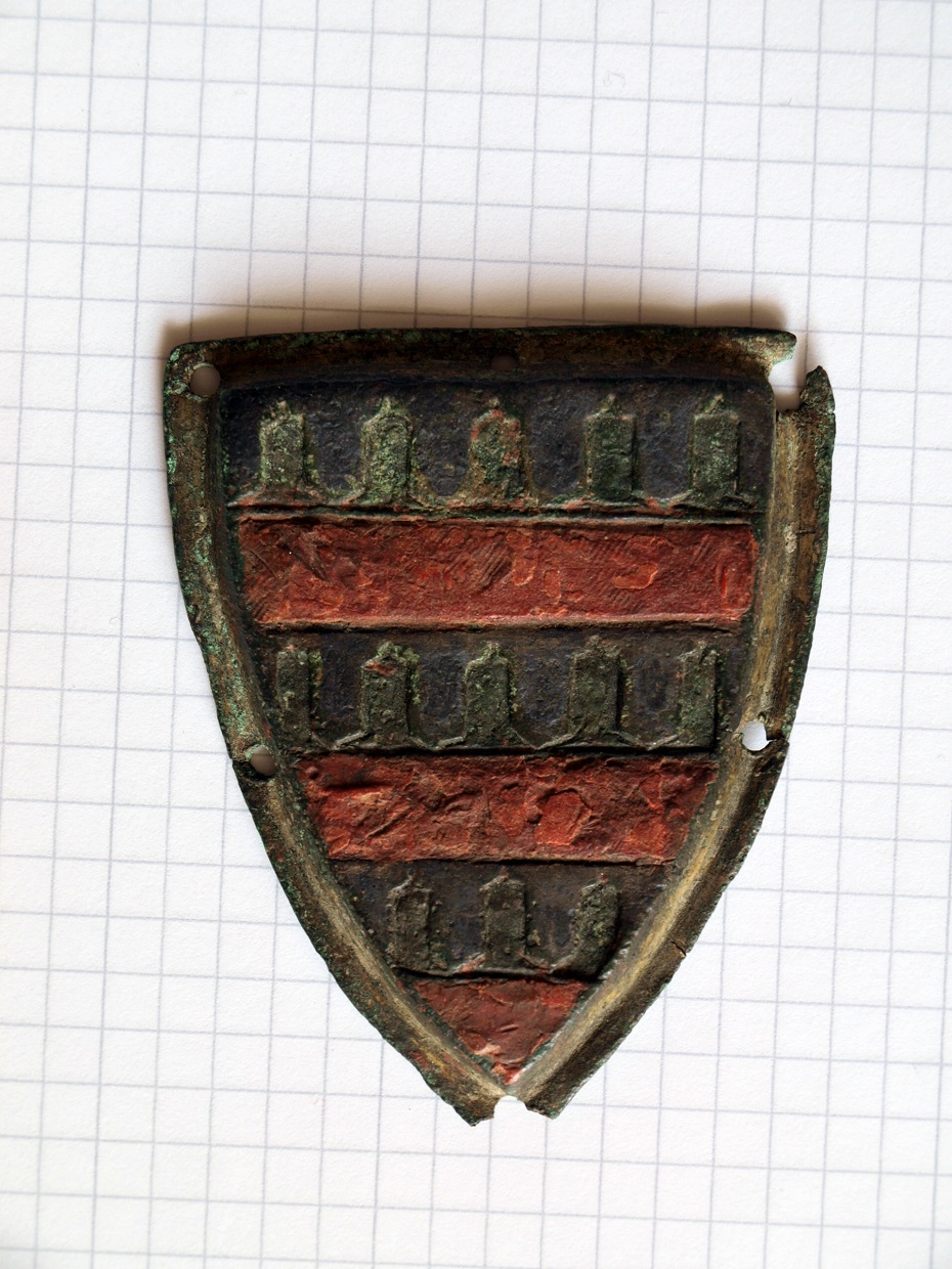

Hi there,

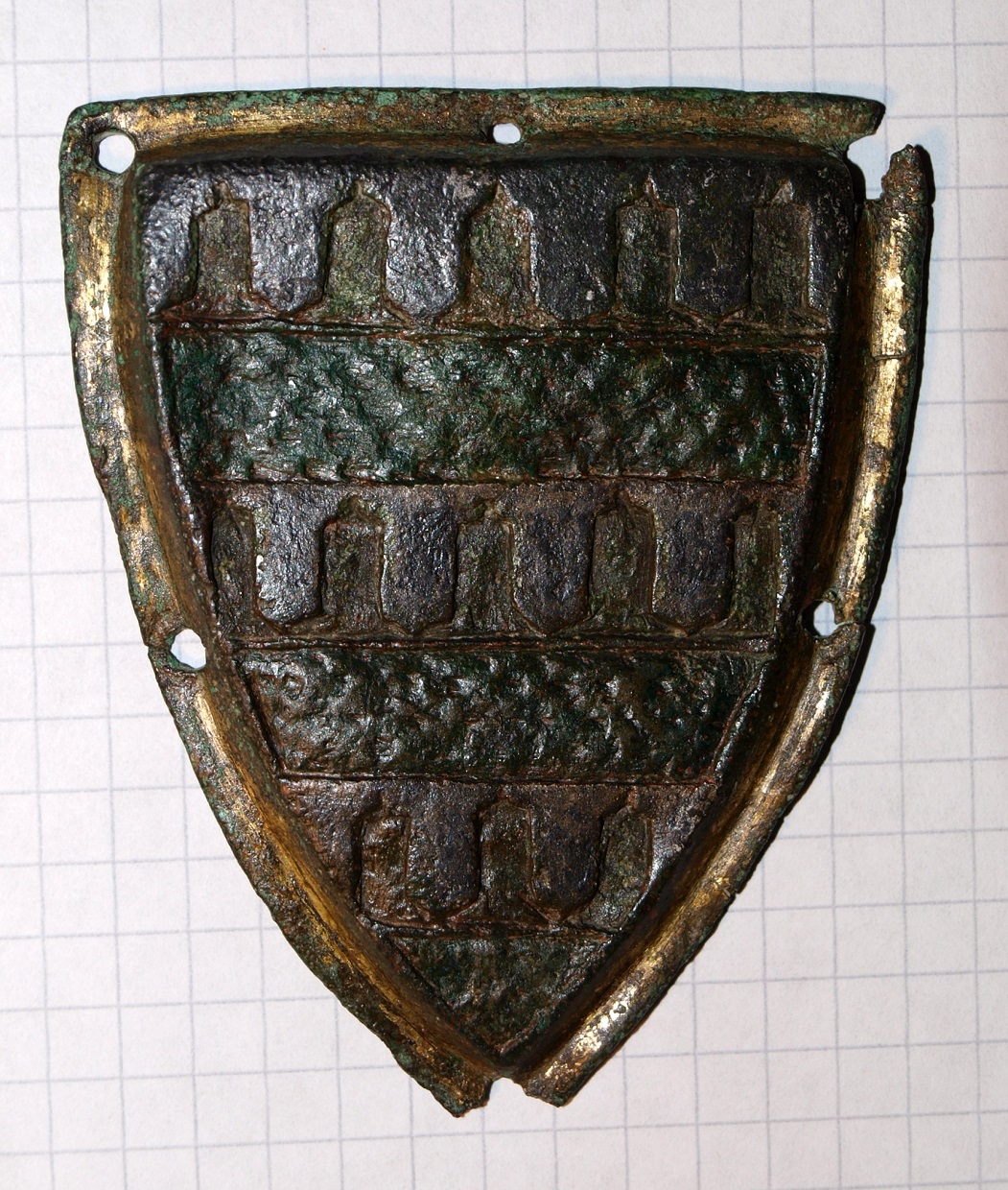

although it is not an arm or armour but a coat of arms, I hope someone can help here. I recently got this coat of arms. It measures 7.5 x 6cm and weights 35 g. The shield itselfs seems to be made from bronze or copper with an attached layer of silver or another "white" metal (see also 3rd image). According the paper note on the backside it was found in the river of Seine. The CoA is the one of the Maison de Coucy: https://fr.wikipedia.org/wiki/Maison_de_Coucy It seems that the potentially blue parts are already gone. I canīt tell from what material the red areas are made. The white metal represents the white areas of the blason. Is it possible that this shield is a messengers badge? I found some examples here (which of course are larger and from much better quality): https://www.metmuseum.org/search-results#!/search?q=messenger%20badge What do you think about its possible age? Looking forward to your comments! Best regards Andreas |

No ideas?
The shape of the shield indicates 13th century. At this time the Coucies have been one of the most powerful families in france. I wonder if this blazon could really be from that period. |

#5 |
This appears to be a very old object.
I hope someone can throw some light into this interesting item's history. Angles to take into account: It is quite a long way from Coucy to the river Seine; wonder how it got there ... and gor how long it stood in the bottom of the river. We may assume that, the paper tag on its back must have been placed right after it was found ... by someone fishing ? |

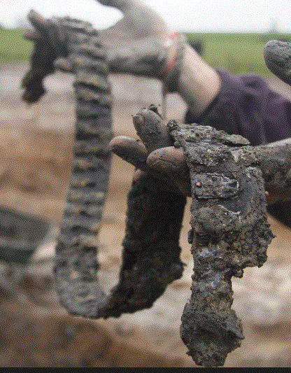

I guess many reasons could originate its falling off. If in fact it was an implement adorning any part of a knight's personal ot horse's gear, it could have been ripped out while in combat. On the other hand, we can't exclude the possibility that, wherever it was riveted, belt, harness, box, armor, uniform, someone took it off ... and temporarily keep it as a trophy. |

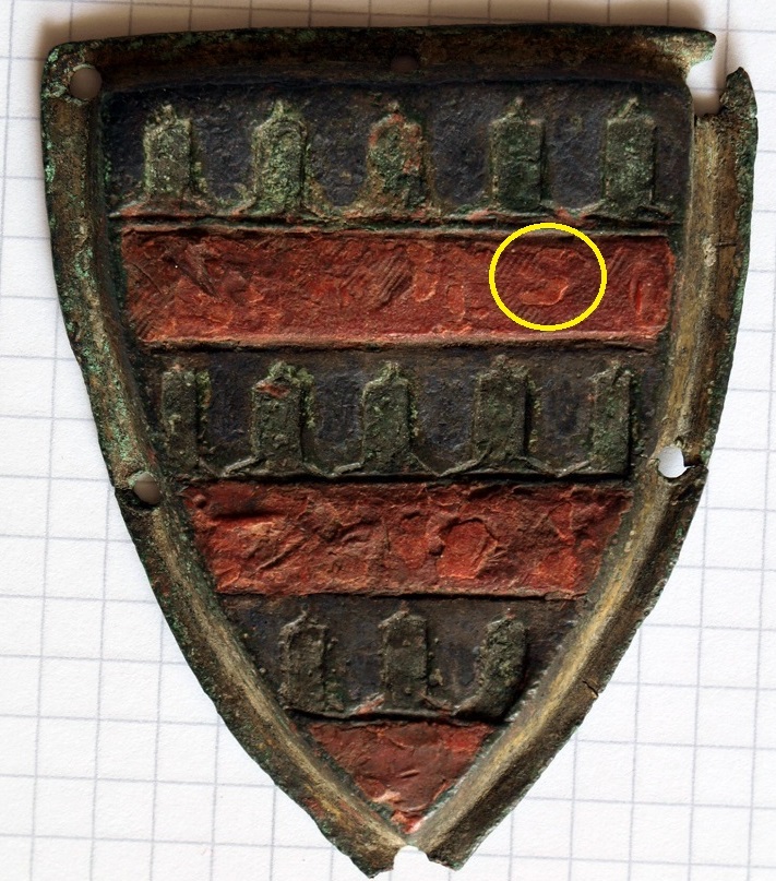

Are theses letters ... or is it only my imagination ?
#14 | |
Join Date: May 2014
Location: Rhineland
Posts: 386
But on the examples Iīve found so far the shields were made from textile / embroided. Which makes more practical sense in my eyes than stitching a metal shield on it as you also mentioned. Iīve found some examples of very huge horse harness pendants (eg: https://www.metmuseum.org/art/collec...70010723?img=0 ) but it is still a pendant, not an applique. What you interpret as letters, Fernando, is just irregularities in the material. Actually I think that this red material is maybe a later replacement to lost enamel and maybe seal lacquer or so Iīve also postet it in a forum specialized in archaeological medieval findings and there it was stated that it is an authentic piece from 13th century. So it likely could be linked to the period of Enguerrand IV - https://en.wikipedia.org/wiki/Enguerrand_IV_de_Coucy Appart from dating it there was also no clue about what it could have been exactly for Last edited by AHorsa; 23rd September 2020 at 03:41 PM. |

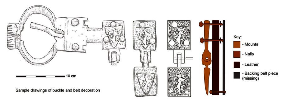

https://en.wikipedia.org/wiki/Trap_(carriage) Quote:
.Quote:
#16 |
Join Date: May 2014
Location: Rhineland
Posts: 386
Thanks for your comment Fernando and happy to hear that you also have no doubts on its age. A very nice example of an astonishing preserved medieval belt you show!

Actually, I don't think it was fixed with rivets somewhere. There is no space for the rivet heads so that they would cause damage to the rim. From the example shown by Fernando and other similar pieces, it seems that appliques have been fixed to leather by rivets. That makes me assume that it was fixed (likely on a textile round) using a thread or so |
#19 |
Excelent find Andreas, that picture of a messenger
.I had (if i should) doubts about what kind of attire they wore, whether hard (armour) or soft clothes. In this case as shown, your badge would not be in the adequate material, but instead a textile one. On the other hand, i would not agree that your example was fixed to wherever place by tying it with thread; besides being too soft to hold metal edges, the hole in the lower (V) corner would not be in the convenient position for thread binding. I would bet on it to be riveted (nailed) to a hard material; leather, wood (a chest), metal ... whatever. |

thanks for your remarks and the images! I think it will be hard to say if it belonged to a messenger and if so, where it was worn (except that it wasnīt worn on "light" clothing) unless we find a certainly defined / identified comparandum. One observation I want to add for the pieceīs history: Looking at the six holes, it seems that three of them has a bulge (not sure if this is the right phrase) from beeing drilled less professional than those three on the edges which also has those outbursts. This makes me assume that the piece was once took off forcefully, than three new wholes where drilled and it was attached again. Last edited by AHorsa; 26th September 2020 at 09:57 AM. |
#25 |
Ye, some holes would have been made with rudimentary (medieval) drills and the others perforated with a spike... by a less skilled author, so to say.
But what have been the use for the second episode; stick it back in the same place or give it a new home, having nothing to do withs its primary purpose ? |

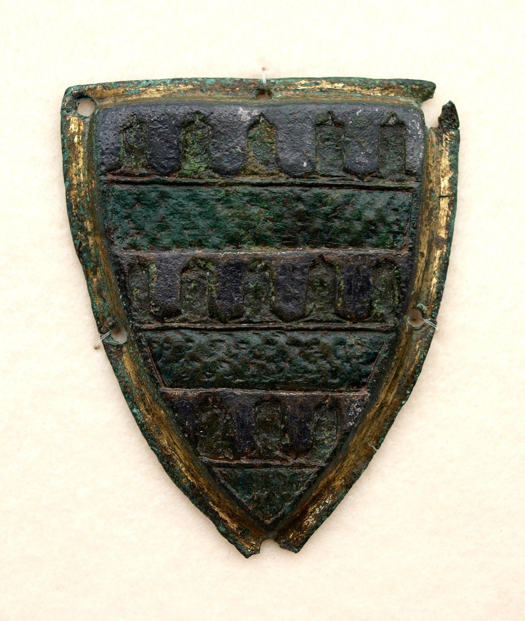

while the precise usage is still unclear, I figured out that the red material was wax (I think seal wax) and a later supplement as it layed over the green corrosion layer. So I removed it and gave the piece a slight cleaning. Here is what it does look like now. Best regards Andreas |
