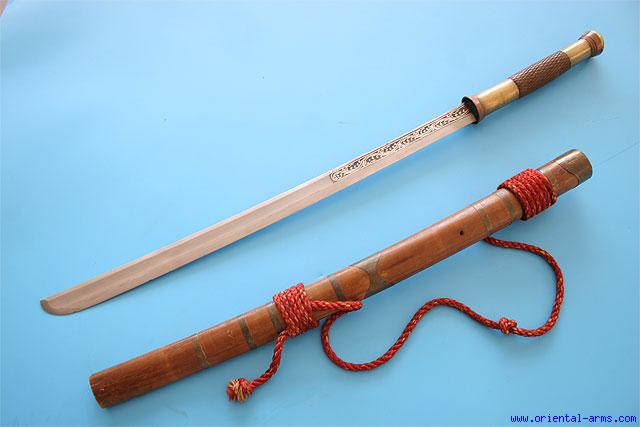

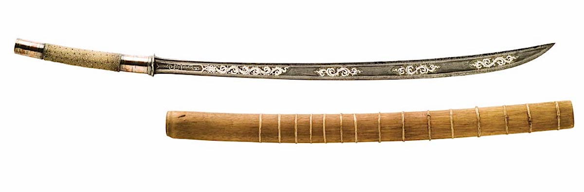

Hello. I'm revisiting this dha I bought from Artzi in 2008. This was the description on the sell page:
"This good Dah sword is coming from Burma, very early 20 C. Very fine blade 21 inches long with nicely shaped tip, inlaid with silver koftgari decoration. Wood handle with checkered grip and big brass / copper mounts. Wood scabbard bound with brass band. Total length 30 inches. Very good condition. This Dah sword comes with its original red baldric cord."
I've been trying to find early 20th century photos of Burmese people with dha so I can get an ethnographic sense of the original owner. From what I have picked up on this forum the style of the this sword, due to the koftgari, time period, and non-ethnic specific style, would likely be carried by a business man or government official rather for martial or day-to-day use. Early Burmese photos are thin on the ground and the few I've found searching the web with dha have been royalty, thaing related or of traditional Kachin. So the question is, how/when/why was this general class of Burmese dha carried? Where they costume for formal events, self defense, duels of honor, hang on the wall??
Also, while the koftgari, wide central fuller, and three part hilt are obviously common features I have not seen this blade tip shape anywhere else. I was wondering if anyone had thoughts on the significance of the style regarding use or cultural influence.

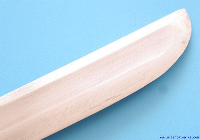

Perhaps the tip has been reshaped. The fuller seems to run into the edge bevel.

I think Rick is correct, in that the fuller is passing through a sharpened area at the end of the bklade, and this likely indicates a reshaped tip. Fullers do run through the end of some dha blades, but these usually have a blunt, squared-off end or a concave end (as shown in the attachment). Such blunt- or cancave-ended dha were especially used by the Kachin, and usually had a three-part hilt such as the one shown in your original post. While fullered blades were made by the Burmese, they were also made by the Achang people of Husa in Yunnan (who made excellent blades BTW). The blade in the OP may have started out as a Husa dha.
As for their use, the dha as a fighting weapon lost prominence in the second half of the 19th C when firearms became more prevalent. By the early 20th C, plain dha were still being used for working purposes (as "jungle knives") but otherwise higher quality examples were largely ceremonial in function, being worn as a sign of status, at weddings, on national holidays, festivals and other cultural events.

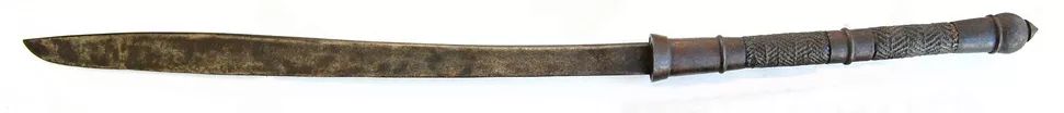

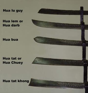

They also came in pointy.
Like mine below:
(see also the other point types chart)

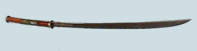

Just for interest - an earlier form, the Ayutthayan (Thai) Daab/Dha. The city was destroyed by the Burmese in 1787, so these types were earlier, from a time when they were actually used in battle. Unusual 'yelman' at the point. I have one like it. Very well-balanced and an excellent sturdy weapon. These are in a museum in Thailand.
The Dha's long grip is to balance the blade, they are a one handed weapon, tho a two handed coup-de-grace was occasionally used.

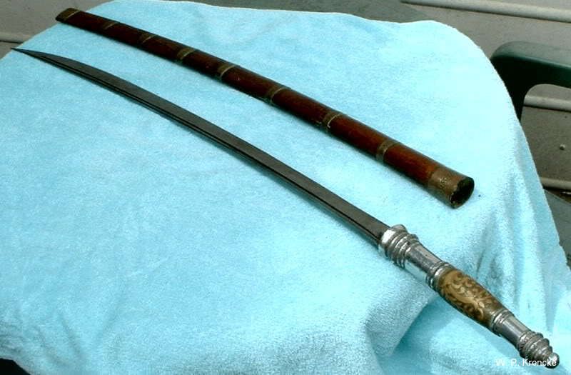

Old 7th September 2020, 10:32 AM   #7
kahnjar1
kahnjar1's Avatar
Posts: 2,832

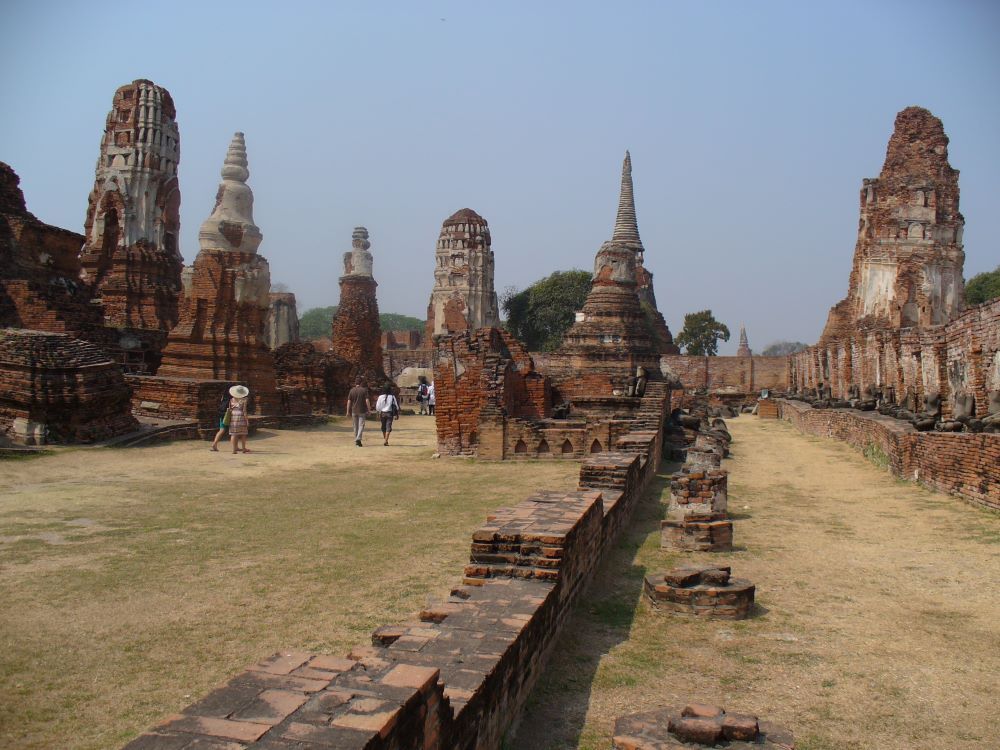

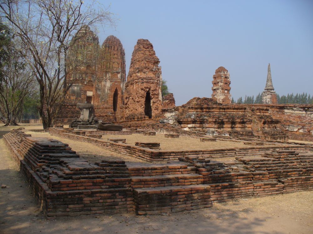

Kronckew mentions Ayutthaya. Here are a couple of pic of how the city looks today.
Stu
Old 7th September 2020, 12:13 PM   #8
It's what the newspaper real estate classifieds call 'a nice little fixer-upper'.

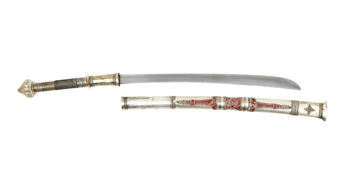

I agree that it is probably reshaped.

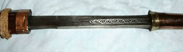

The Chinese Shan/Dai minority also made them with this profile from the get-go, but the rest of the dha is not typical Chinese Shan/Dai work. Such swords usually don't have a groove, for example, and their tips are thinner in thickness. But who knows, maybe someone from that minority purchased and altered the tip to their taste.
For comparison, here is an otherwise quite similar piece I had with a date on it. This was probably the original shape of yours, looking at the groove. I think yours is probably roughly from the same period.
https://mandarinmansion.com/item/burmese-dha-dated-1928
For reference I add a photo of a more typical Chinese Shan/Dai piece. Characteristic for this culture, spread over Burma and Yunnan, are the large garlic shaped pommel, the style of the silverwork, and the blade profile.

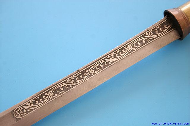

Now when looking at the nature of the koftgari, what strikes me is that on the Burmese dha the entire surface is crosshatched and the designs are then drawn with mostly silver wire after which the surface is blackened for contrast. Classic Indian work tends to only crosshatch that area which is to be covered with gold, not the larger surface.
The crosshatching of larger surfaces and then "drawing" with the wire was quite common on the cartouches on Ottoman swords, and they use the same blackening to make the design stand out. In the early 18th century, many Burmese port officials were in fact Armenian. (See for example "The Muslims of Burma" by Moshe Yegar, 1972.) So I wonder whether it may have come from that angle instead.
I agree most of the later ones are only a faint reflection of what they used to be in Yamethin's heydays. That 1928 dated dha I had however was still decently made and still had a pretty heavy "user" blade, showing the manufacture of serious dha for local consumption did carry on for decades into the 20th century.

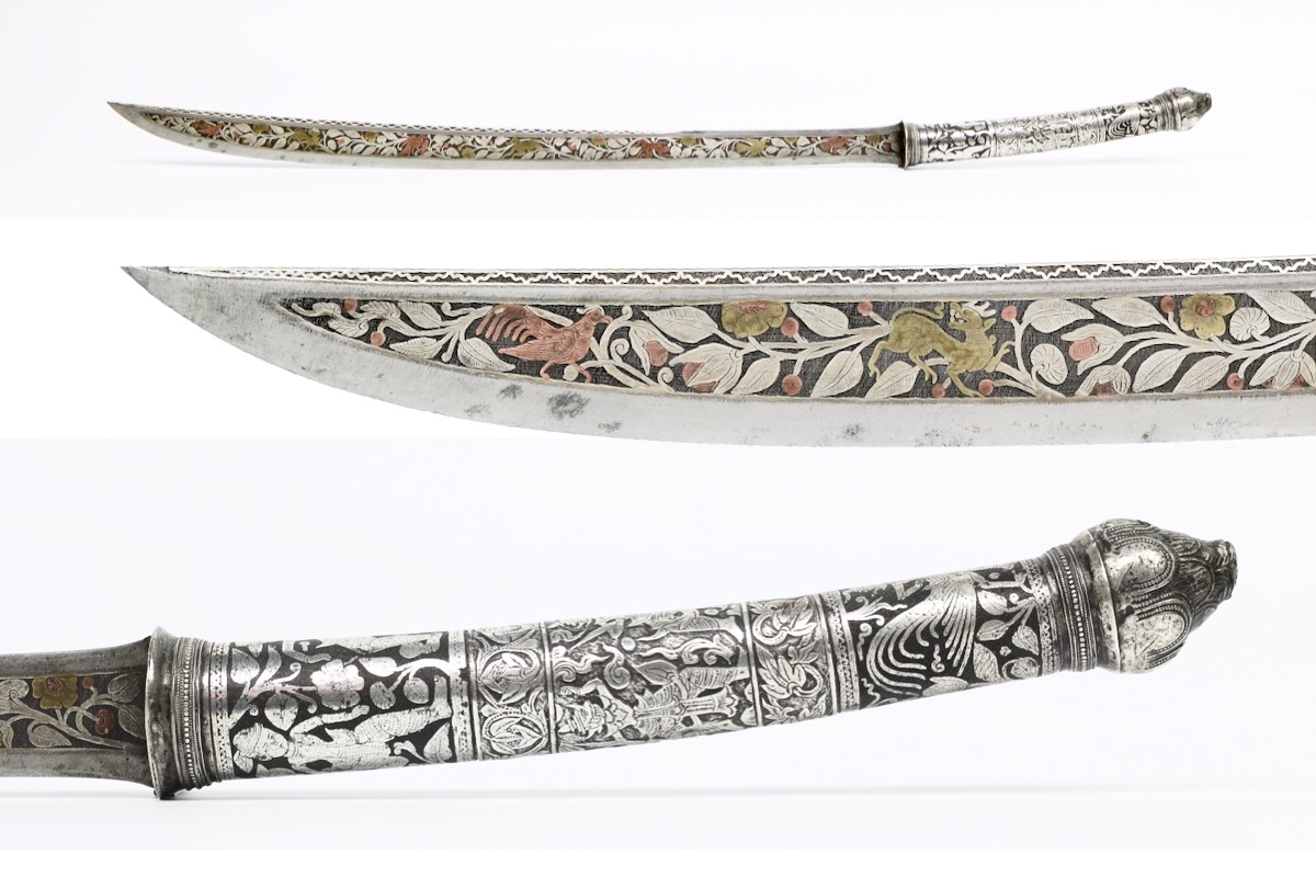

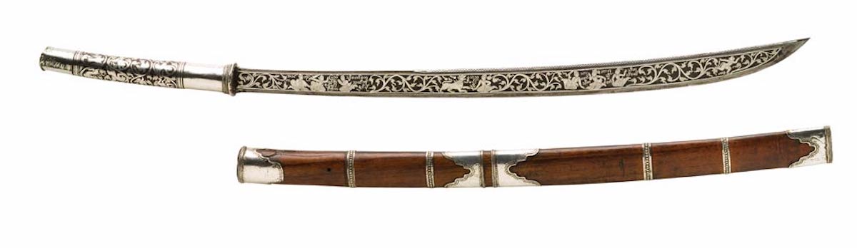

Forgot to add the dha pic!
Here goes.

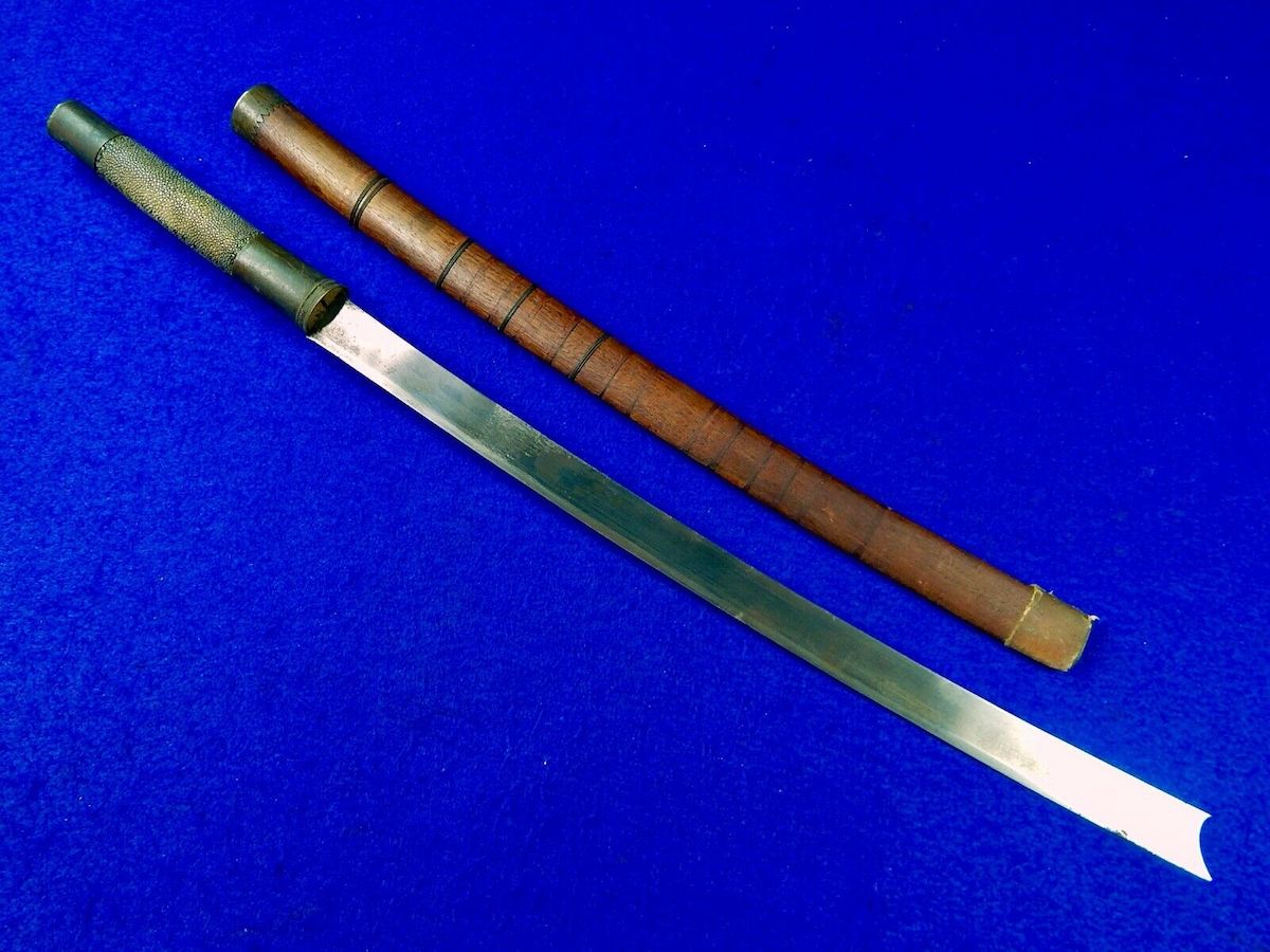

On a similar note, regarding the apparently shortened blade with the fuller to the tip - During WW2 the Japanese acquired swords locally either by capture of stocks, surrendered weapons, or purchase from local collaborators. The Dutch klewang for instance, they acquired a number of these from various sources and cut the already short blades down even shorter, modified the guards, and issued them to their sergeants and military police. We call them Hei-ho.
I've heard that in Burma similar acquisitions of Dhas were sometimes cut down and even hand handles shortened, so they could be hung from a belt vertically without it poking them in the armpit when walking. They did that to their own katanas that were not samurai heirlooms as well.
This dha of mine, with a bit of koftgari decor at the forte of the un-fullered blade like the OP's above, was liberated by a Chindit in Burma from a Japanese Officer who didn't need it any more due to lead poisoning. The grip appears to have been redone with a large diameter rimmed cartridge, around 25mm dia. and the scabbard was in poor condition & field repaired. I aquired it from the Chindit who was in London. He figured it should go to someone who appreciated it, as his family didn't want it.

Hi Peter,
That's a very beautiful example!
I'm not sure that the iron hilt necessarily reflects greater age. I believe the hilt has niello work on it, and that was often done over iron. The niello process was nasty and smelly work, involving melting sulfur, copper, silver, and lead to create the black components. The lead fumes in particular were highly toxic to niello workers.

I would beg to differ in terms of usability.
These well-decorated dha come in several different classes and by the late period, a thinner, not so good blade is very often seen. We're talking about the 1920s onwards, mostly. The silver overlay also tends to become indifferent in this period.
Back to these earlier silver overlaid dha, quite a few of them are no less utilitarian than the average "fighting dha", they just have a better finish. Steel construction is usually an outer casing of high-carbon steel, much like the kobuse construction among Japanese swords, and also like Japanese swords they may exhibit a fine hamon when polished although they were never finished to show this aspect off traditionally.
As for weight it is a matter of personal preference. 600-900 grams is pretty much the weight range you see for sabers of all cultures, from Europe to Japan, and you also see this weight range among practical dha.
The dha I posted with silver, copper and brass inlays is a fully-fledged fighting piece. Here some numbers:
Overall length 86.9 cm / 34.2 inch
Blade length 62.2 cm / 24.5 inch
Blade thickness; forte 7 mm, middle 5 mm, near tip 4 mm.
Blade width; forte 35 mm, middle 33 mm, widest 35 mm, near tip 25 mm.
Weight; 816 grams
Well-tempered, with a gentle hum going through the piece when tapping the pommel.

Hi,
That some Burman preferred a heavier style or a longer blade may simply be preference, but the Shan provided dha for many ethnic groups throughout Burma, including Burmans, Kachin, and Karens, as well as into northern Thailand and Laos, and even as far north as Assam and neighboring states in NE India.
It doesn't appear to be "some Burman", Burman swords are heavier by default and in that sense seem to be closer to the typical Indian talwar or Chinese dao or Japanese katana in weight, and in balance much like the latter two as well.
They tend to be heavier than Shan dha, but in the grand scheme of things, they are not the clumsy, overweight swords they are made out to be. Plus, edges are hard and often have a temperline when polished.
Another argument for them being fighting swords is that:
a.) Humble unadorned Burmese dha are found with the same weight and balance.
b.) Some of these fancy blades were mounted in humble mounts, you couldn't see the blade when sheathed.
c.) I've seen some, and currently own one, with some nicks and cuts in the softer side of the blade that seem clear edge damage.
d.) During the Anglo Burmese wars, many were confiscated after the defeat of Shumba Woonghee:
"The advanced posts of the army under Shumba Woonghee, had now appeared on the banks of the Rangoon River, seven miles from Rangoon."
"The carnage was very great, at least five hundred men being slain in the first stockade, and amongst them was Shumbah Woonghee."
"In this stockade was a battery of nine small guns, and ranged in a row behind, wore the Burman colours. They were made of red silk, swallow-tailed, and having the figure of a Braminy goose in the centre, and when furled, were bound round with green leaves instead of cases. A great many stand of arms were captured and destroyed, and many handsome spears, the shafts headed with chased silver, swords with gold and silver handles and scabbards silver caps..."
-Thomas Abercromby Trant, July 1824
This was not the storeroom of a palace that was raided. This stockade was temporarily set up by Shumba Woonghee moving army. He himself fell fighting in battle. And the amount of richly ornamented weapons was "a great many", which suggests much more than for his own personal use.
My personal preference would be a good Shan dha over one of the fancy Mandalay dha if I had to pick one to fight with. But then I know little about actual sword fighting.
It's all a matter of preference. I regularly do sword-sparring. My style is Chinese, with a wooden replica of my favorite antique jian, weighing at 840 grams it's about as heavy as a heftier Mindan dha. Pros of a relatively heavy piece: Easier to keep the center-line, harder for them to beat it aside due to the inertia of the piece. You hit harder. Cons: You fatigue more easily, and are a little bit slower so you need to carefully plan your actions.
Historically, for most cultures, the pros outweighed the cons since 800 grams is a perfectly normal weight for swords and sabers around the world.
*Strictly speaking, the Shan are Burmese since most of them live in the Shan States within the old Kingdom of Burma (now Myanmar).
Tell that to the Shan living in Thailand and China...
What about the "bearing swords" of Europe--those monsters that were carried in procession? Moro datus do a similar thing with large ornate kampilan. "Mine is bigger than yours" can play out in various settings as a display of wealth and superiority, just as lots of gold and silver finery can. Why not combine the two, and go big with lots of bling?
Well, that's the thing. These Burmese dha are mainly thicker than many Shan dha. If there is one dimension in which a sword on a parade does not give more of a bling factor, it must be the thickness.
Length, width, are seen from afar. Not thickness.
If you want to get into the numbers, I have detailed weights, measurements and p.o.b.'s of a good number of dha I've had pass through my hands for a comparative study between those of the same type that were, and were not, lavishly decorated. And from the top of my head, there really isn't much of a difference between the two blades structurally. As in, there appears no reason to assume the decorated ones perform any less in the field. If a Burmese soldier could afford one, he would get one, and then that was his trusty sword.
(Exceptions are the late ones, first decades of the 20th century. I also have examples of those that show overly thin blades in sometimes very good mounts.)
