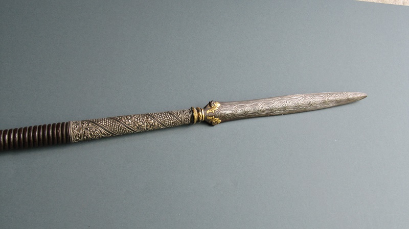

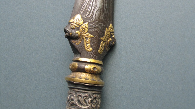

Pamor similar to Uler lulut(?), a few millimetres of the tip of the blade missing, exceptionally delicate gold Naga heads on each side of the base of the blade, with topong makhota (crown with ear pieces) and inlaid eyes, gold decoration on the metuk, including tumpal and diamond patterns, and four ovals with a setting for a stone in the centre of each (stones missing).
Dark brown/black wood shaft, a plain spiral carved the whole length.
184 cm, blade 24.5 cm, tang 17 cm, sleeve 15 cm.
Is this Sumatran (I have seen similar pamor on Sumatran keris blades) or Javanese, or...?

Hello Tim,
Very nice spear, indeed!
The methuk seems separate? I'd lean towards the Jawa/Bali nexus.

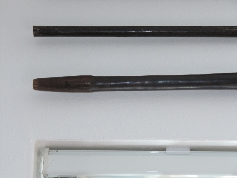

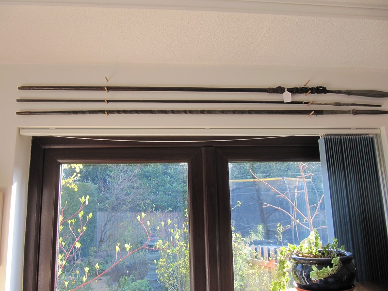

Tim, are you able to provide photos of both ends of the shaft so that we can see the form and detail of the ferrule and butt, and a full length photo of the tombak?

Alan, the attached new pictures are the best I can manage at the moment; I hope there will be just enough for people to see.

The metuk of this spear does seem to be Surakarta, the kinatah work appears to be of a quality that would permit a Surakarta origin, as does the pamor work, however, the the garap of the blade is not in my opinion able to be attributed to Surakarta, and the decorative motif is unlike any Surakarta work I have ever seen.
The landeyan is not in even the smallest degree similar to the style of landeyan used on a Surakarta tombak. It is usual for a Surakarta landeyan to swell in the middle and taper to each end, this landeyan does not. A Surakarta landeyan will normally have a brongsong or sopal (a wrapping or tube that functions as a ferrule), and a tunjung of metal (a tunjung is the butt cover). This landeyan does not have a metal tunjung, but the presence of the metal brongsong, which is of a style that would permit a Surakarta attribution, indicates that it should have a tunjung. My feeling is that this landeyan is a European made replacement.
I'm sorry, but I cannot attribute this spear to any origin with any certainty.

This landeyan has some rotan wrapping, so maybe it is not of European manufacture, but rather it is a landeyan from a different source that has been married to this brongsong and then fitted to the tombak.
The spiral landeyan is carved (rather than wrapped rattan) according to Tim. This is an unusual feature.
OTOH, I have seen several apparently genuine landeyan that exhibited the distinct swelling near the butt end (possibly covered by a tunjung originally?); maybe this feature could help to narrow down its origin?
Old 26th March 2020, 12:02 AM   #10
Posts: 7,255
I didn't pick that up Kai, but if it is carved that would in my opinion militate even more strongly against a Surakarta source. Bear in mind, I'm only saying what I believe it cannot be, I'm not floating an opinion with no foundation as to what it could be.
I've seen that swell at the butt of a spear shaft too, but never on a landeyan that I knew to originate in Central Jawa.
Normally when a tunjung is fitted to a Javanese shaft there is a very slight recess in the wood of the shaft to accomodate the thickness of the metal from which the tunjung is made, the tunjung does not stand proud of shaft.

Very nice curtain poles
