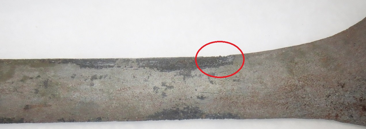

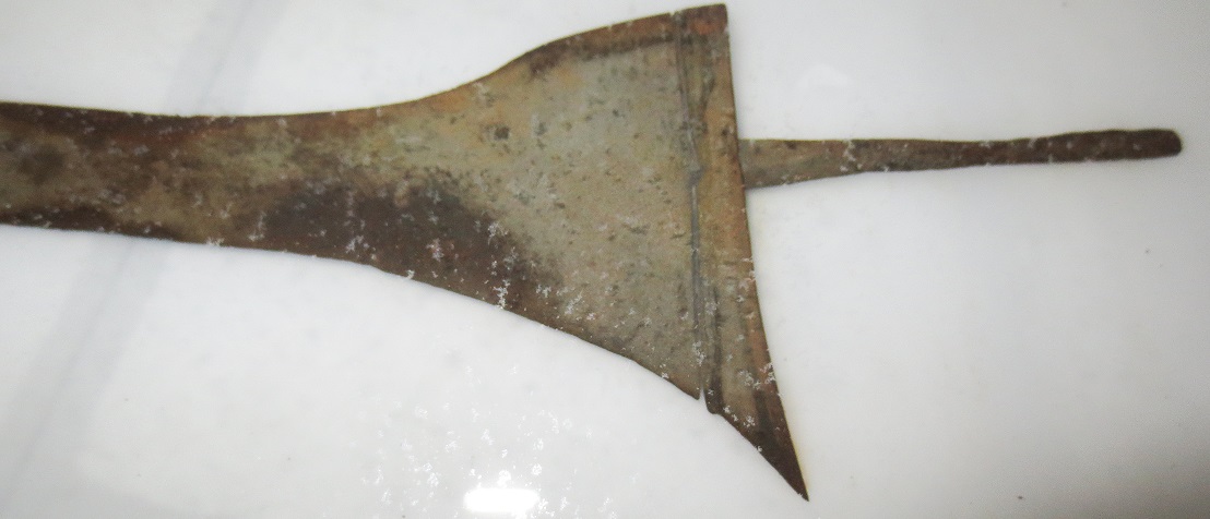

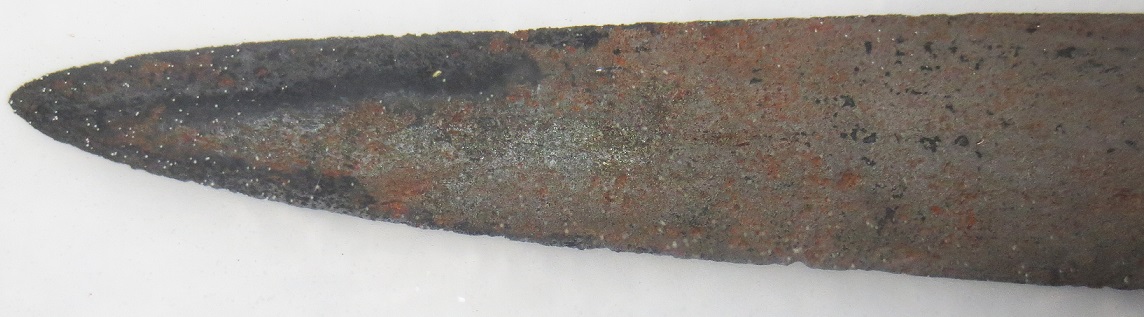

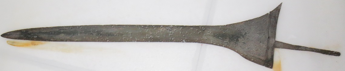

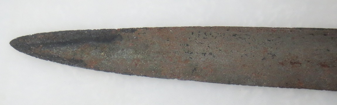

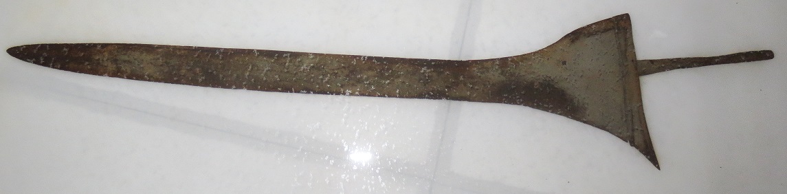

Default Black stain spreading on keris during vinegar cleaning

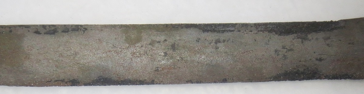

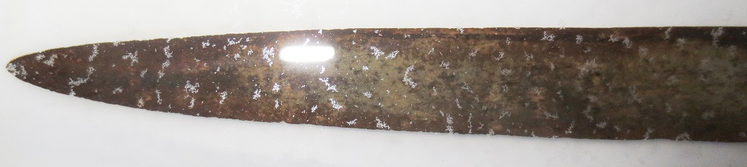

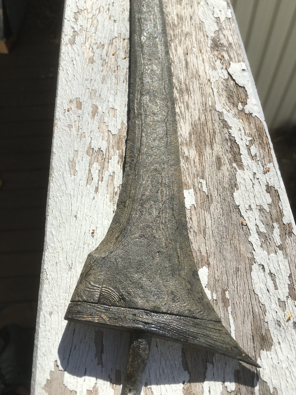

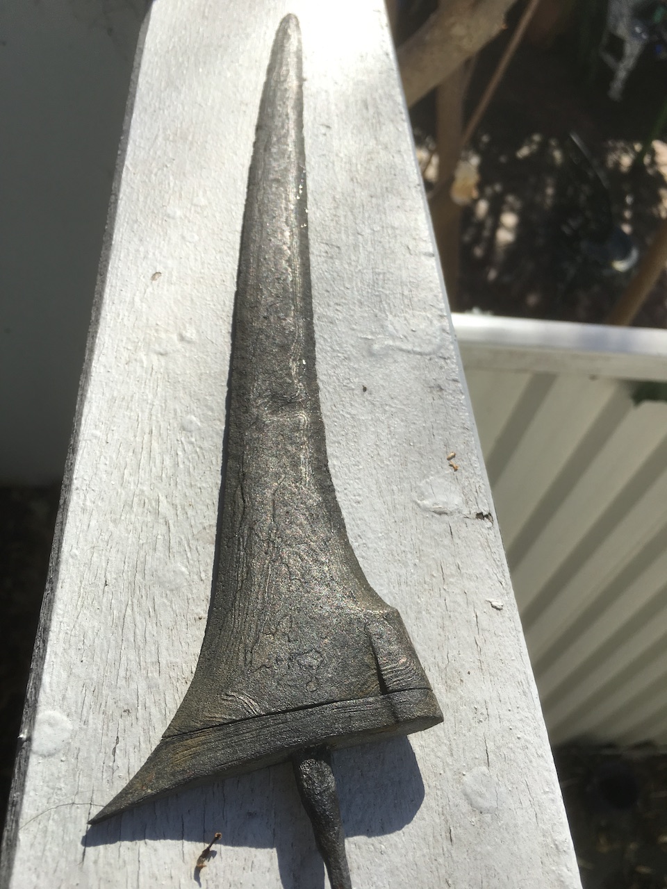

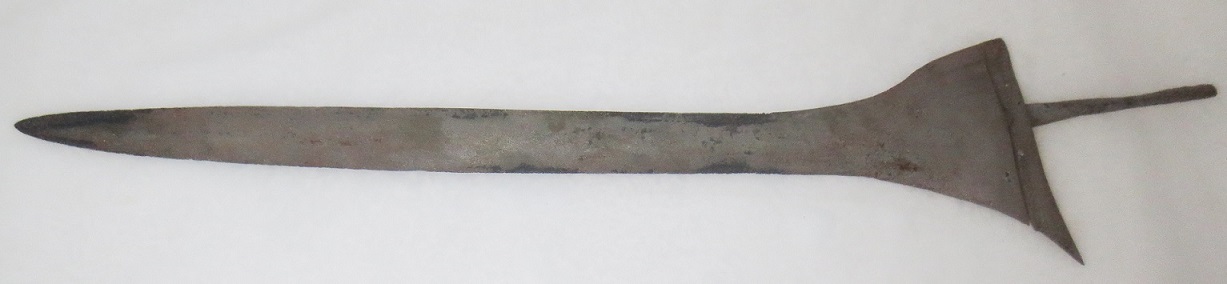

I have a really perplexing dilemma. I gave this keris I posted a long time ago a bath recently in diluted vinegar (originally 5% acidity), but I poured and mixed 2+ cups of water.
http://vikingsword.com/vb/showthread.php?t=21446
I let it sit in the bath for a couple days (taking it out to scrub rust off and rinse before resubmerging in the same bath, what happened is black stains began to form on parts of the keris.
The stain can not be scrubbed off. By scrubbing, it only stains the toothbrush and water a dark black like paint. To make things worse, the black stain emits a strong chemical oder I can only describe as similar to burning tires! It is a noxious fume that permeates the entire bathroom with a horrible stench
The exact same thing happened to a moro kris I attempted to clean with diluted vinegar, and it turned out to ruin that moro kris in the end.
Essentially with both the Indonesian keris and Moro kris developed the black stains. Furthermore, the blackened parts of both blades look like they are corroded the blade as though they were burnt in a fire.
Here are some photos of the black staining of the keris that is spreading. What could it be?

I have no real clues but just submit my personal comments and opinion:
. The blade cleaning is not complete (remaining rust spots) probably because the vinegar is too diluted. I am using undiluted vinegar at 8-10% and I cover the vertical container for avoiding evaporation of the volatile acetic acid. The cleaning procedure usually lasts 24 h only with 2 intermediate brushings.
. From the pics, the black spots look like exposed and corroded steel or iron. As said by Alan in the last thread, the blade has pamor sanak.
. Is the bad smell like rotten eggs? In this case it would be hydrogen sulphide caused by the presence of iron sulphide in the metal and attacked by the weak acid.

Apolaki, I believe that the black you can see is the steel core that has been hardened. The small specks in the body of the blade could be where the outside layers have worn, or, as Jean has suggested, maybe some steel is in the mix of the outside layers, but the big black areas at the point & edges are steel core.

Thanks all, so the steel core is reactive poorly to the vinegar. Is the damage irreparable?
I have now taken the keris out of the vinegar bath and placed it in a bicarbonate and water bath (or as we say in the States, baking soda and water).

Apolaki, the steel core is not reacting poorly, and it does not need any sort of repair:- it is reacting exactly as it is supposed to react and it is an indication that the blade has been heat treated.

The reason I thought the keris is now damaged is due to the edge. It used to be a straight edge throughout, but now the edges particularly where the black stain is has a serrated/corroded edge look as I have circled in red.
Also the black stain is not removable so it leaves a un-uniform look to the keris.
I am interested to learn more about heat-treated keris blades and how/why vinegar effects it in this manner. Is there any literature you can link me to?
Were the pamor keris I cleaned prior with vinegar all non-heat treated/ did they not have steel?
Also, what is the point of heat treating a keris?

Older keris very often have uneven edges, if it troubles you you can even up the edges by filing. Personally, I would not bother dressing the edges of an old blade unless the edges were very severely eroded and/or the blade was of very high quality. The little bit of erosion that you have drawn our attention to is nothing. It is normal, just accept it.
Apolaki, this is a keris. Everything I can see about this keris is totally normal for a keris of this age and quality. Yes, the edges are uneven, yes, the colour is uneven. This is exactly what we expect with a keris like this. There is nothing wrong with it, it is normal.
I cannot refer you to any published works that can explain why heat-treated steel goes black. I guess it is simply because the steel contains carbon, the iron does not, when the steel is heated and then suddenly cooled the carbon at the surface goes through some sort of change. An engineer can probably explain the reasons, I cannot.
As to why you did not see this change in colour in other keris you have cleaned, there could be a number of reasons. Maybe they had not been heat treated, or if they were old blades, maybe the blade had been annealed and the steel had become soft, maybe the blade did not have a steel edge or core, maybe it did have a steel core, but the core projected around the edge by only a small amount and any colour change would be difficult to see, maybe only the tip of the blade was heat treated. Lots of "maybes" and a different maybe can apply to different kerises.
If you do not like the look of the blade as it is, you could always repolish it and then use cold blue that is used for firearms repair to give it a deep blue colour.

A word to the wise:
A great regret of mine is opting to use citric acid as opposed to regular white cooking vinegar, on one of my old blades.
It was the first time for me cleaning any blade.
Firstly I put too much citric acid in and it flaked some of the steel off the blade.
It was already in quite a fragile state due to its purported age, and the concentration of citric acid was far too harsh.
For this reason I will always opt to use cooking vinegar and father time.
jagabuwana is offline   Reply With Quote
Old 18th March 2020, 02:56 AM   #28
Posts: 7,164
Jaga, I understand where you're coming from with this, and I'm of the same opinion, but only because I've used vinegar for years & years now and never had even the hint of any sort of negative result.
However, if I was new to the game I'd be looking at everything, including Coca-Cola and tomato juice. It is the nature of human kind that most people like to learn by their own mistakes.
That said, Marco used a very short term hands-on method with his citric acid. People in Solo have been using citric for years, and citric acid is what a lot of people in Solo use. Bi-carb used as a cleaner is great stuff to remove stains from tea cups and coffee cups. Bi-carb is really wonderful stuff for lots of things.
Lemon juice is in fact pretty high in citric acid to begin with. Used as a paste of bi-carb with a toothbrush I reckon it would be pretty effective. But even so, I'll stay with vinegar because of my experience with its impeccable record and because it is so easy and non-time consuming to use.
Actually, the acid in vinegar is acetic acid, and that is pretty strong stuff, but there is usually only about 5% or 6% in household white vinegar, the rest is water.
Personally, I would encourage all beginners to try everything that they can think of and to learn by their own mistakes:- there is nothing as sobering as destroying something that cost you money, by failing to learn from the mistakes of others.

The black stain has spread throughout the blade, it is like infected the blade.
apolaki is offline   Reply With Quote
Old 18th March 2020, 04:10 AM   #30
Posts: 7,164
Nothing is infected Apo, I'm looking at normal here.
Pick off the hard rust with a small, sharp tool.
Get some coarse steel wool and some powder sink cleaner, give it a good scrub under running water.
Dry it and put it back in the vinegar.
No fluid is magic, it is just a substance that helps you to get the job done. If I look at the pics of this blade I can still see a lot of what appears to be rust. I suggest you pick this off, scrub it off, as I have advised above.
When the thing is clean, dry it thoroughly and then either stain it or spray with WD40.
