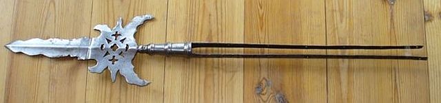

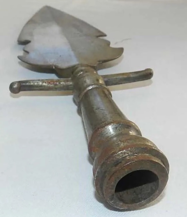

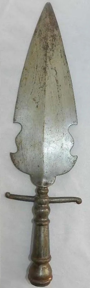

Hello again
I saw this type of spontoon listed some times as german, another as italian and even british, usually as sergeants or official spontoon of XVIII or XIX century.
Do you know something about it?
Thanks in advance

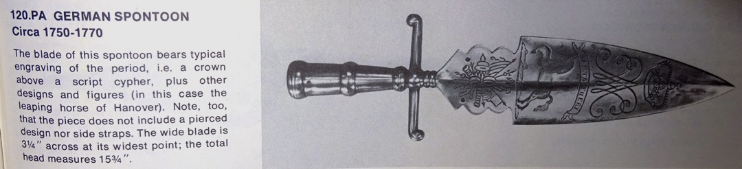

What about French, like this one in "Swords and Blades of the American Revolution", by Neumann ? .

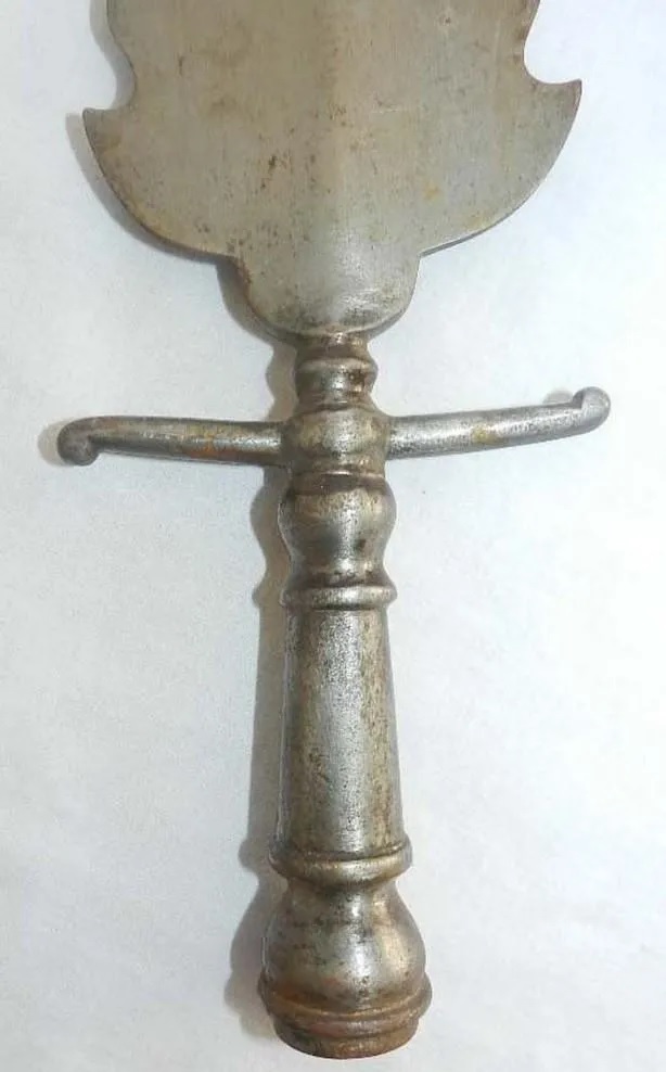

I think this is a piece of historism. Original blades can normally be unscrewed from the socket and at the socket there are missing the long feathers (?) to fix the socket at the pole. These have never been there as far as I can see

Spontoons are not battle weapons, Udo. Most of them don't have langets, but a little hole to fix them to the pole with a screw or a pin. And i suspect some don't even have such fixation, only a tight introduction; not sure.
You may have a look to Newmann's.

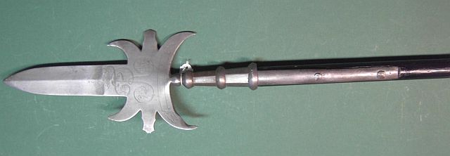

I cannot believe this. Look at the fotos of some German spontoons, all with langets and they have been primarily a rank sign of seargents and secondly made for battle - at least in Germany.

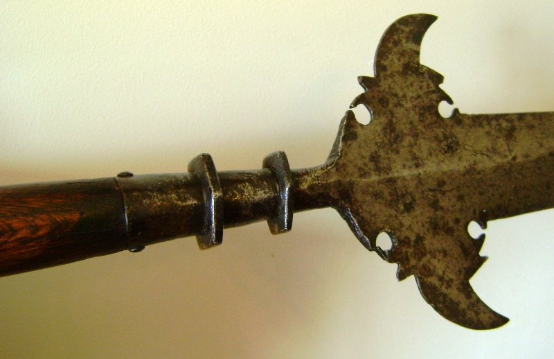

Posts: 1,268

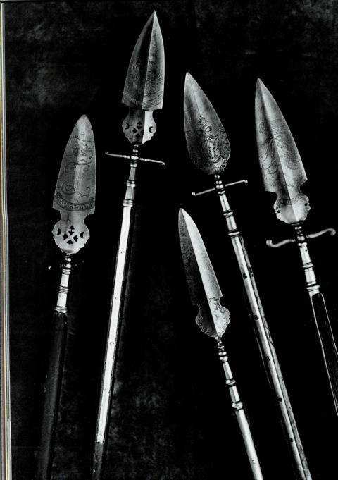

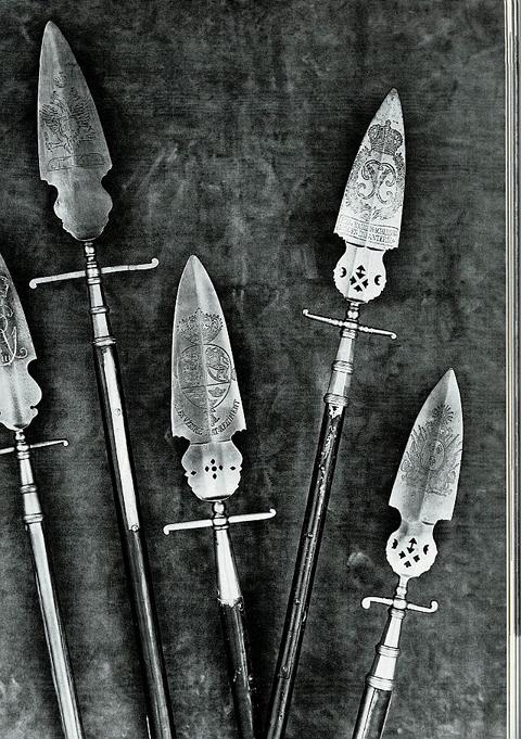

It is very nice that you think that I am much younger than you, but I'll get 76 years old this year and many years of this time I spent in a higher position in one of Germany's military museums. So I know lots of partisans and spontoons and all of them in our house had langets. They have been made for nothing else than battle. The ones without langets are mostly pieces made for representation purposes. As you can see from the two fotos attached, all spontoons except one have langets.
As the blade in question has no monogram or something else what could help to identify it , it was certainly not made for representation and over that and without langets certainly not made for battle. That was the reason why I said that I think it is a piece of historism. But I am not the pope of polearms and maybe I am completely wrong.....................

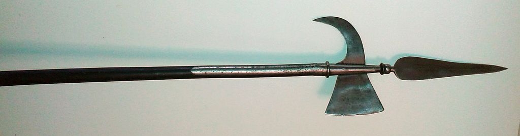

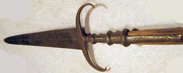

My 18c British Colour Sergeant's Halberd also has languets, and the spear point unscrews. And it's quite sharp too, axe, spear and inside the curve of the hook.
http://www.vikingsword.com/vb/showth...hlight=halberd
