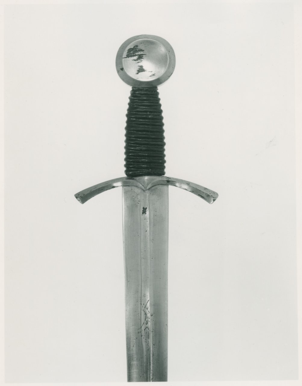

Here is an interesting example of the single millrind mark - on the same blade appears the "Passau wolf". The sword is suggested to be Italian, being exceptionally similar to one in a well known painting... So should we suppose this is an example of a contemporary faked Passau mark? Or perhaps the millrind is indeed not a personal maker's mark, as I think was suggested above...
https://www.metmuseum.org/art/collec...=80&pos=41
Reventlov is offline   Reply With Quote
Old 8th October 2019, 03:42 PM   #63
Posts: 10,872
Excellent example Reventlov! and the sword illustrated is of course compellingly similar to that in the painting.
I do not believe the 'mill rind' stamp is confined to any single maker, or it would appear just as with other marks (as the 'Passau wolf' noted) that it was to a particular center in any of the countries well known for blade and arms making.
I have often wondered if Italy ever used the Passau wolf, and in my perception it seems doubtful, however the use of the mill rind of course did occur in German context. It seems feasible that a German blade could have ended up in Italy as blades were typically sent to hilting locations there, and a blade from Passau may have easily been used just as the blades from Italian makers.
From reading some time ago (I believe in Wagner) it was said that Solingen often produced blades for Passau makers, and applied the wolf in accord with those 'contracts' (?). Such are the conundrums of specific classifications in these clearly diversified circumstances.

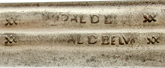

CIVIDAL DE BELUN is for cetainly a rare mark (Cividal is the roman name of city, sometimes used alone to indicate Belluno). And proves in my opionion the production of big stocks of blades made by many swordmakers together.

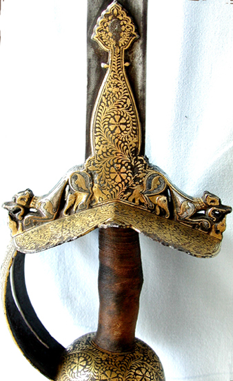

I dont collect European swords and daggers, but I do have a Firangi with a blade from Belluno.

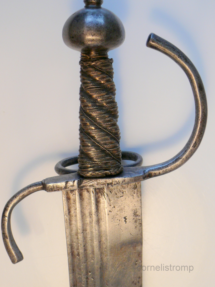

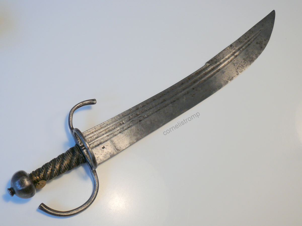

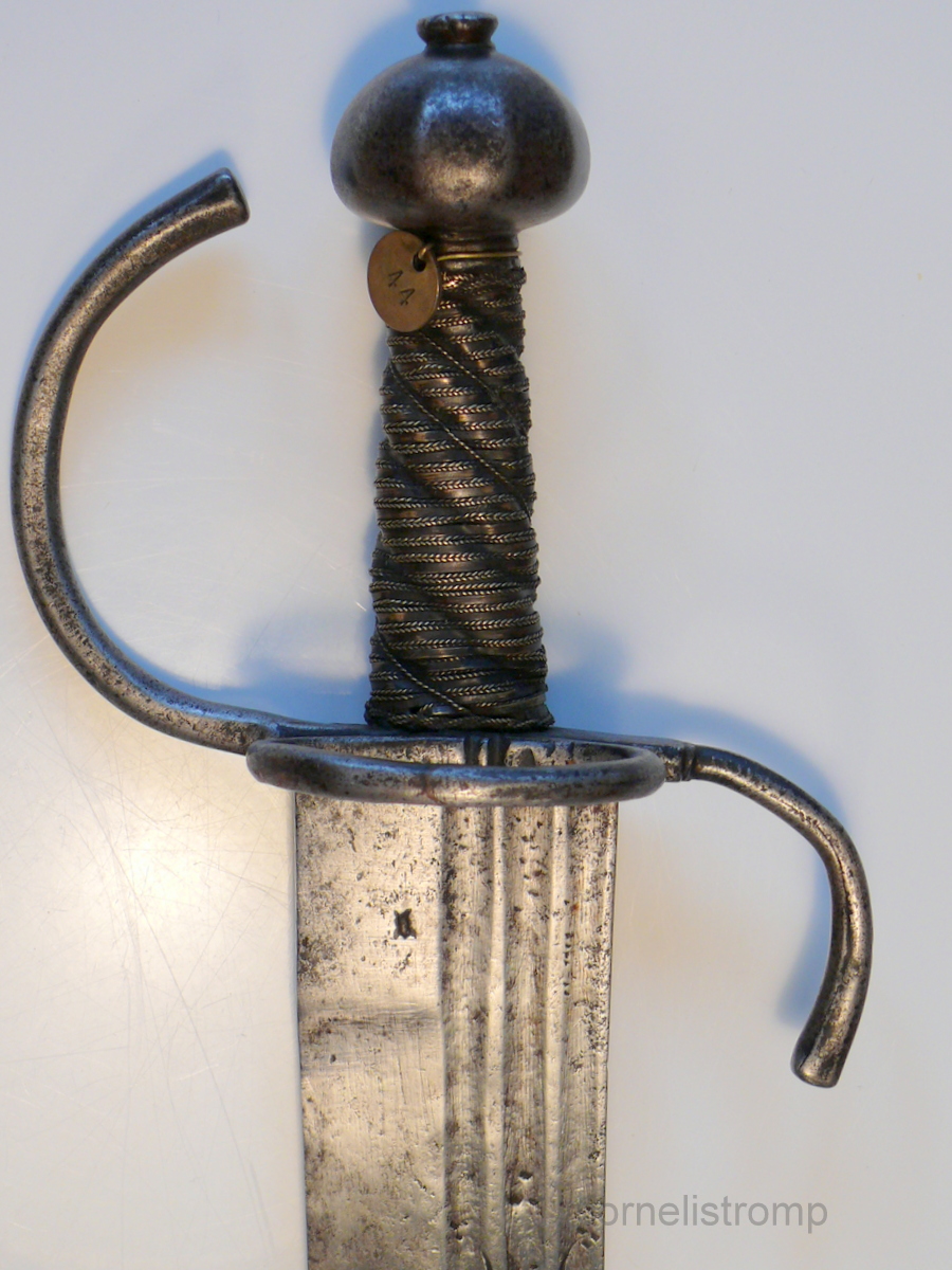

italian storta last quarter of of 16thc.
Old 11th January 2020, 09:13 AM   #69
Outstanding example ... of both sword and marks !

CIVIDAL DE BELUN is a mark that proves the sword has been made in Belluno.
Maybe part of a big stock for foreign countries.
In my personal opinion this mark is indicating the collaboration of many swordmakers to supply to that big require.

@cornelistromp beautiful example of storta! There is a very similar blade in Poldi Pezzoli collection in Milan. I will post the photo later.

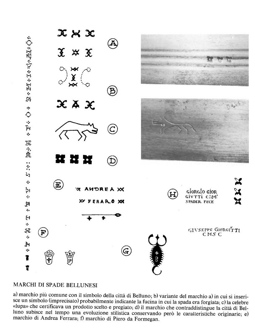

Some Belluno area marks!
Cheers
Giovanni
AndreaFeraro89 is offline   Reply With Quote
Old 22nd January 2020, 11:15 AM   #72
Most interesting info... and useful, Giovani.
Post copied to the EARLY " MAKERS TRADE MARKS" page, situated in the "Classic Threads" front page sticky.

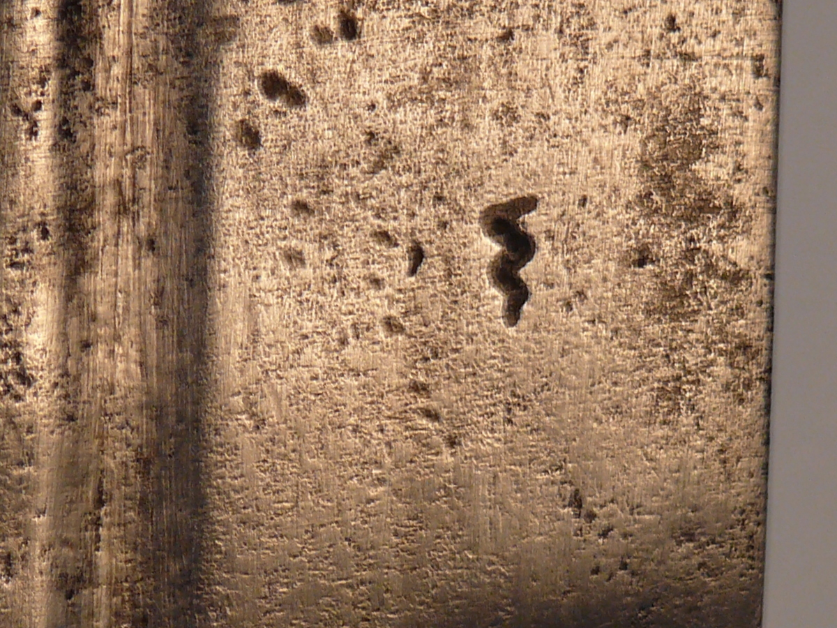

Thank you Giovani, this is most interesting. I too have a firangi blade with some of these stamps. The problem is, that the Indian smiths were very good at copying both blades and stamps.
Is there any indication of, how far down the blades there stamps would be - was there a standard measure from the hilt?
This could, maybe, help us to point out the copied blades/stamps.

One problem could be, that when the stamp got worn, the image on the blade would change. Maybe the Indian smiths did not take so much notice as they would in Italy?!!!

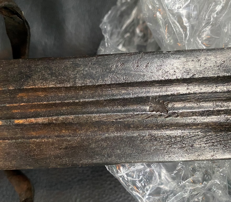

Dear colleagues,
Looking for your help with this mark on the schiavona's blade which looks similar, but not the same.

Old 29th January 2020, 03:34 PM   #80
Evgeny_K
Evgeny_K's Avatar
Join Date: Mar 2011
Posts: 217
It looks like this one:
Evgeny_K is offline   Reply With Quote

Old 30th January 2020, 08:15 PM   #83
AndreaFeraro89
Join Date: Jan 2020
Posts: 13
@Evgeny_K In my modest opinion seems to be from Belluno area like many others.
I agree with you about this one is particular because presents more edges than classical ones.
The big big problem about Venetian Republic swordsmiths has been that for many century they have been forgotten so you will find many old (and new) books that says Andrea Ferara was German, Scottish, Spanish... and many marks attributed to Solingen production or Toledo.
For example about baskethilts swords, many blades bears the name Andrea Ferara, many of them with incorrect spelling because they are imitating the original blades that comes in Scottish market in XVI century that are genuine Andrea Ferara blades.
So in Scotland they are still persuaded that this blade are made in germany, and they do not know nothing about the real story of the name.
So, about marks, it would be better to take carefully indication about provenance of some blades...
To finish, in my opinion is a Belunese blade (could we take a look to the rest of the sword?)
@Ibrahiim al Balooshi Thanks for details about his life, he has been a great scientist and engineer for sure!
@Jens Nordlunde. I have a restorer formation before than a blacksmith and I can adfirm that I find pretty hard that the indian smith were able to make an exact copy of a mark. Not only indian but every smith I know armound the world. Take a look to the fake Andrea Ferara blades for Scottish market
Cheers
Giovanni

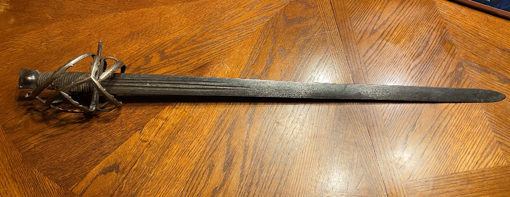

Old 31st January 2020, 06:26 PM   #84
Evgeny_K
Evgeny_K's Avatar
Join Date: Mar 2011
Posts: 217
Giovanni, thank you for your opinion!
Here is a photo of the whole item. I am not sure whether the blade was replaced or not, because there are signs of disassembling of the sword. It is also likely the blade slightly shortened.
BR,
Evgeny
Old 31st January 2020, 06:52 PM   #85
AndreaFeraro89
Join Date: Jan 2020
Posts: 13
Oh Mamma Mia! (sorry but others Italian sentences I have in my mind are not as kind as this).
I have made a goo choice to ask you photos!
This is an ancestral schiavona type, the blade is still large and the basket is not fully developed, is much more uncommon than later examples.
In my opinion we are around 1570-80 about datation and I am 99% sure is a Belunese model, not for sure German.
The blade belongs with hilt and pommel and the handle seems orginal too.
Beautiful piece, a joy for my soul.
Thank you for sharing
Giovanni
Old 31st January 2020, 07:18 PM   #86
CSinTX
CSinTX's Avatar
Join Date: Apr 2014
Posts: 237
She's a simple beauty! Looks like the hilt is engraved? Maybe start a thread on it with more detailed pictures?
