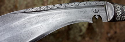

Greetings Folks,
Here is my newest kukri (thanks Rsword). It has a laminated steel blade with one large fuller and smaller ones up top. The hilt is chiseled steel i floral motif. I packed the recesses with lime (remnants of lime was already in the hilt).
Damascus bladed kukri's appear to be rare, and this one I suspect might be from the early to mid 1800s (or earlier according to Rick's informant).
Enjoy.

I was luck - it was already polished. Just had to use acetone to get off the old oils. then I etched the blade and limed the hilt.
Also I forgot that it could also be from the late 1700s during the Indian Mutiny.

Hi Jose,
Very nice piece! Blade is after my fancy too dark etched, or too strong, I would repolish the blade a little bit. Anyway, congrats!
Old 2nd September 2019, 06:28 PM   #8
mariusgmioc
mariusgmioc's Avatar
Join Date: Sep 2014
Location: Austria
Posts: 1,918
Very good and rare aquisition!
However, this is not a kris so the etching should be very discrete... if any.
I suspect it was over-etched to make the pattern discernable in the photos, and facilitate the sale.
So, I agree with Detlef and suggest you polish it a little. The pattern should be only visible in reflected light.

Thanks folks.
I will go back and repolish and re-etch the blade to where it won't be so dark and a little more subtle.
Also I'll also get back to you on the measurements as well.

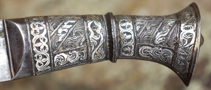

Here I have its cousin from the tin chirra branch of the family. The laminations are certainly visible in the right light, but I haven't brought it out through etching.
There are a few spots on the grip where there is a gray/white residue (you can see this in the close-up . . . next to the ring on the concave side of the grip).
Please educate me: What's the story behind liming the grip?

MacCaithan thanks so much for posting - you have now confirmed what kind of scabbard should I choose to make one for my kukri.
The "white" parts of your hilt appear to be silver plating over the steel. I figure that the lime packing is for visual effect, that it brings out the designs better (like that of some Moro scabbards).

Thanks, Battara. The silver bits in the design that contrast with the darkened steel areas constitute what I think could be classed as niello decoration, and they are, indeed, silver.
The residue that I mentioned is different; it looks a bit like old toothpaste in the small crevices (the deposits are not as easy to see in the image as I had hoped they would be). There are only a few places where these are visible, so they may not be residual decoration (perhaps they're just toothpaste).

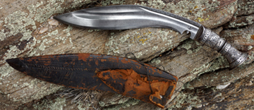

The scabbard struck me as being unusually plain for this well-executed kukri. I would have expected something a bit more flash. Even the chape has been given the darkened steel treatment, though, so I believe it is the original scabbard. Here's a better view of what the face of it looks like.
This kukri measures 15.75" straight from the tip to the farthest end of the pommel cap. The grip is among the smallest in my small collection at only 4" on center.

Yup that "toothpaste" is lime.
Also thank you for the scabbard picture.

Oh my re-etch is not in response to you, MacCathain, but to the feedback from others.
Not sure if I should polish even more, or re-etch even lighter.

Old 6th September 2019, 06:18 AM   #19
Posts: 7,397
Here is the final version. I just took 600 grit and gently took off the yellow and brown. The picture of the damascus is done at an angle.
Thank you for your advice and help folks.

Posts: 1,161
Properly speaking, I would say it's a laminated or watered steel blade rather than Damascus, a term normally reserved for Wootz or Pattern Welded blades. It is a very nice piece indeed, and I find the idea of "liming" the hilt to bring out the pattern very interesting.

Great piece for comparison Dave, thanks!
Yeah lime on kukris was new to me too, but steel doesn't produce that kind of oxidation, and it's not dirt either.
