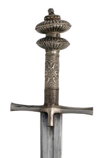

On the subject of silver hilted kaskara in published works, it is true that there is a scarcity of images. In Tirri's "Islamic and Native Weapons of Colonial Africa" in fig. 1-13 there are a couple of kaskara swords with what looks like some metal on the hilt, but nothing worth including here. In Spring there is one silver hilted kaskara in a black and white photo. North of course has the famous Ali Dinar sword from the V&A Museum.
However, there is one publication that contains a couple of very interesting silver hilted kaskaras - "Islamic and Oriental Arms & Armor, A Lifetime Passion" by Robert Hales on p.360. This book also has an image of the Sotheby's sword.
Teodor

Teodor,
Great catch. Thanks. I've found three other I'll post as soon as I can create good detailed images, hopefully today:
Victoria & Albert Museum M.47-1953 and Royal Armories Leeds XXVIS.165 & 166. #166 has a double pommel almost exactly like yours except for the very top and all three have star & comet covers as does yours. The more we dig the more family features we find.
Ed

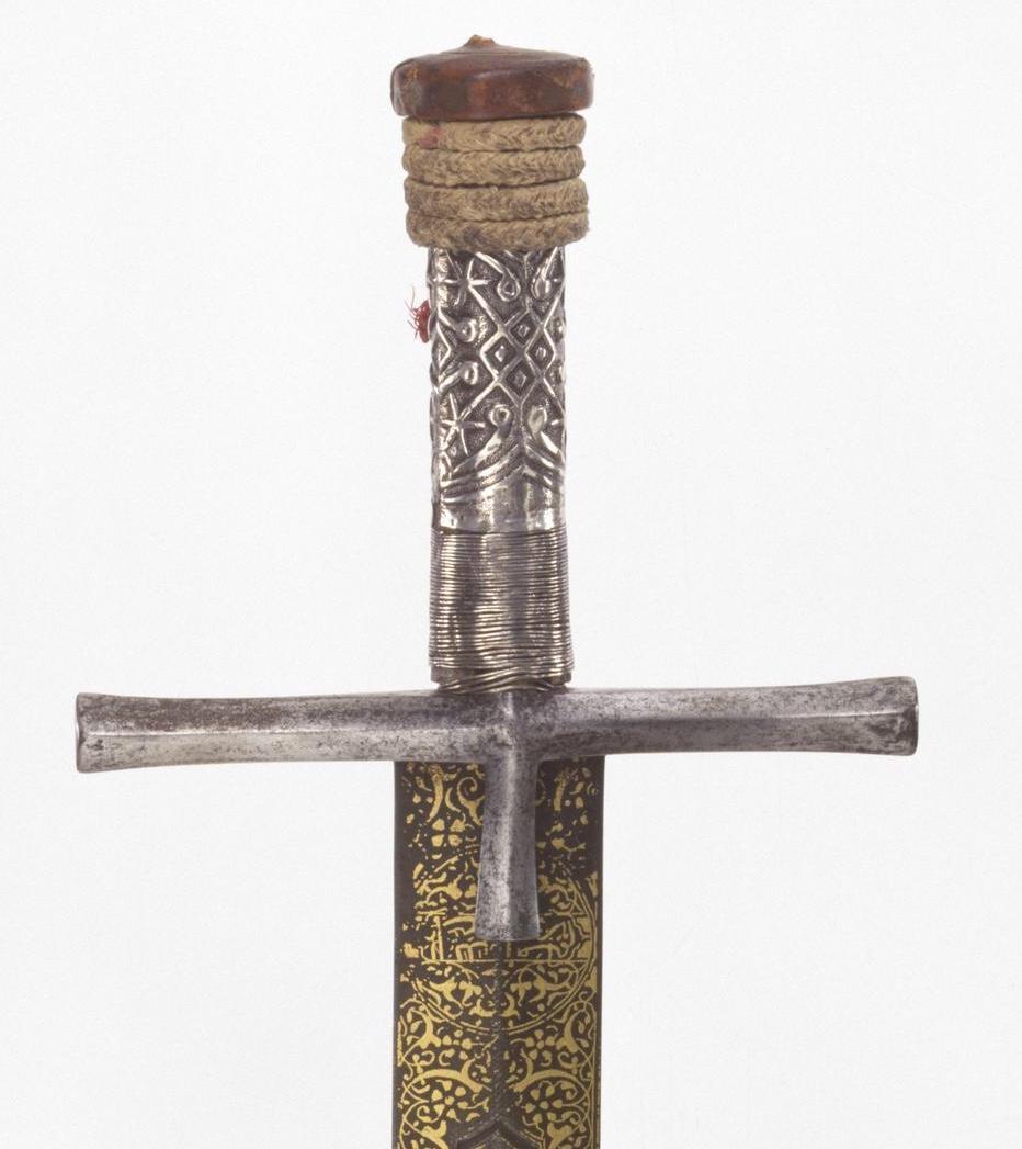

Here are three more Star & Comet covers. All in the same motif. They are not identical suggesting they were produced by different artisans.
1. Victoria and Albert Museum M.47-1953
2. Royal Armouries Collections, Leeds XXVIS.166. Note the double pommel. Its similar to the one posted above by Teodor.
3. Royal Armouries Collections, Leeds XXVIS.165. Wire wrapped at bottom just like #166.

Great images Ed, thank you for digging those up. I know the discussion is on the hilts, but the one you posted from the Victoria & Albert Museum has a really interesting blade, probably Persian and quite old.
Teodor

Here's the link to the V&A sword. The image will enlarge to give great detail. They say the blade is 17th Cent. and gives the maker's name. Its #M.47-1953 in case the link doesn't work.
http://collections.vam.ac.uk/item/O71642/sword/
Ed

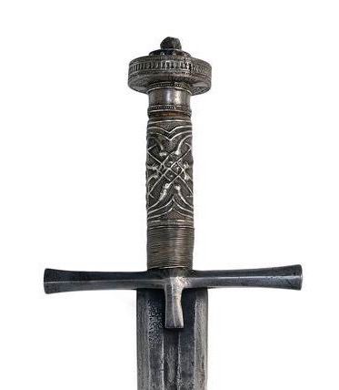

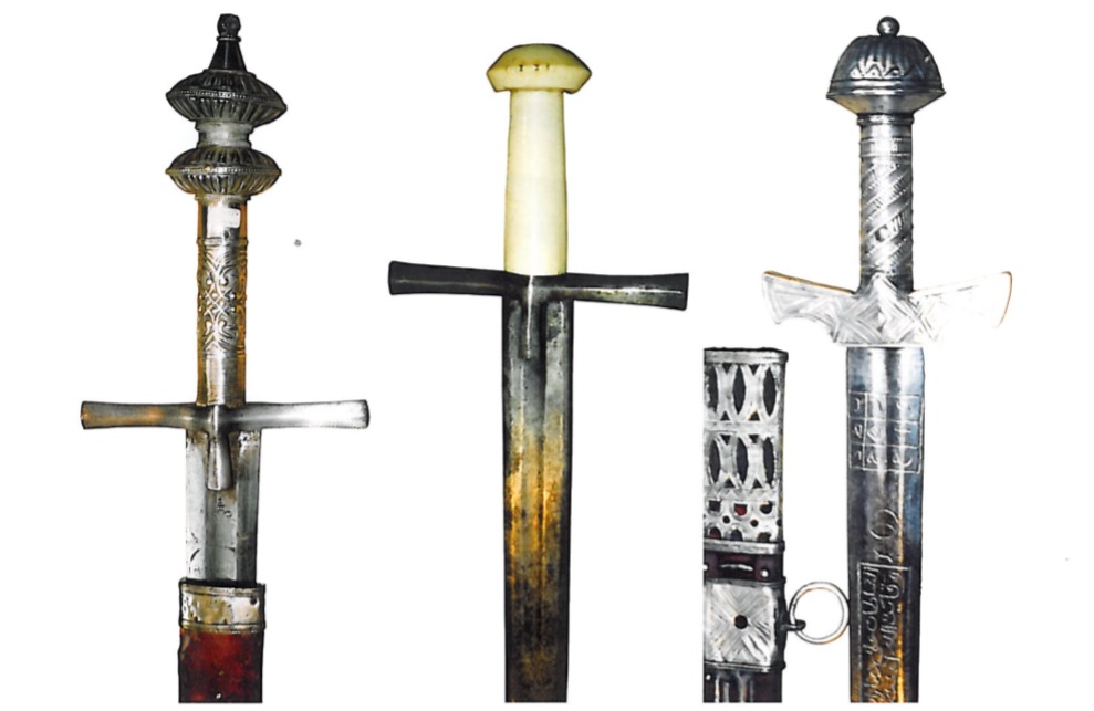

Teodor
I'm fascinated by the sword on the right in this image. Its almost takouba like in guard construction, including the scabbard fittings. Anyone know where it ended up or have more images?

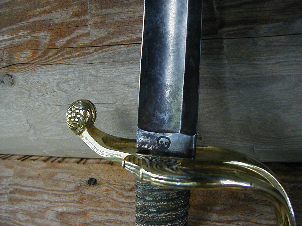

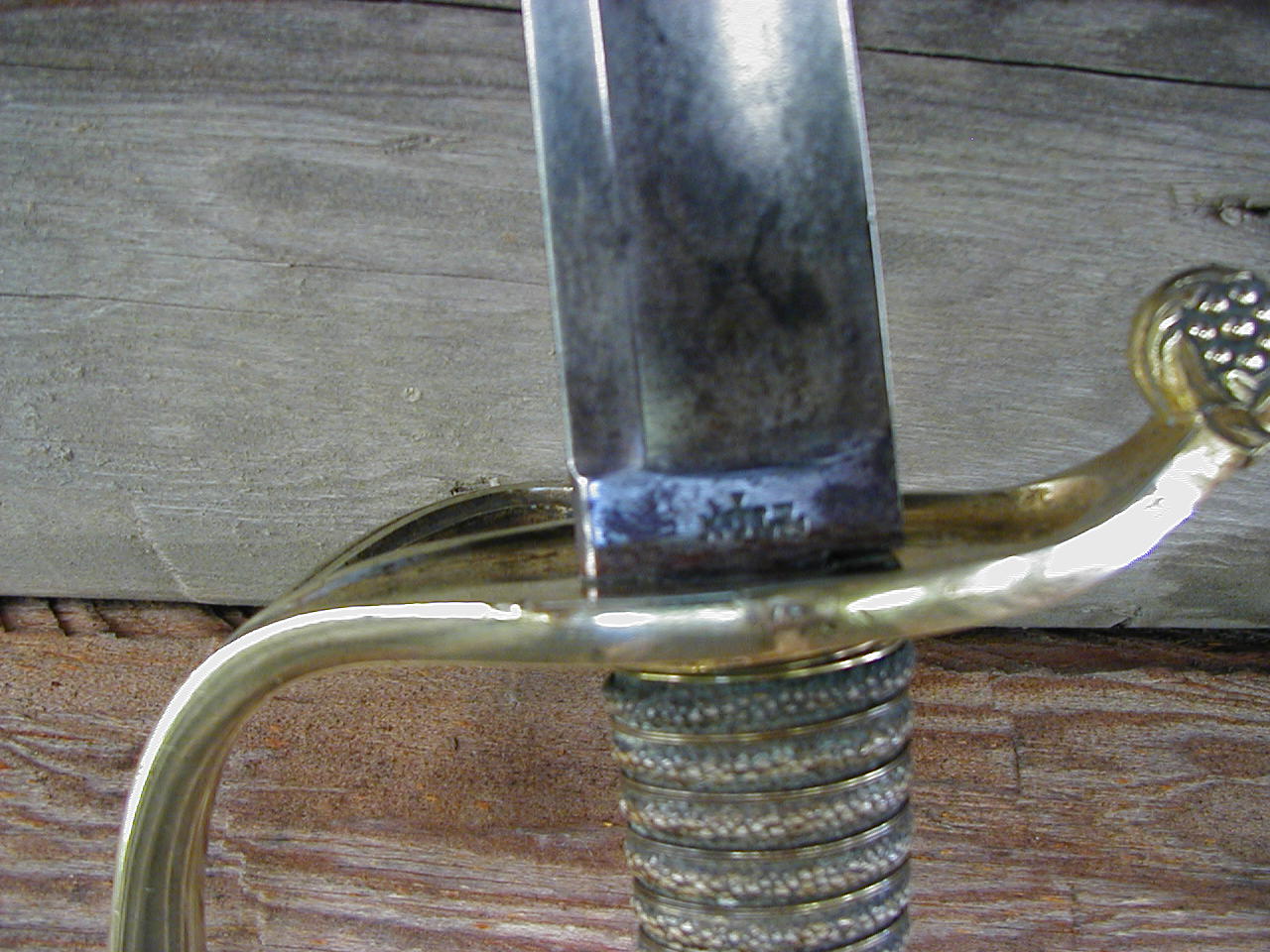

I used Pallme's "Travels..." extensively some years ago in one of my talks about the Kaskara to the Arms and Armour Society at the Tower of London.
"Knell" seems to be a typo. It should read "Kull" as on this Cavalry Sabre. Curiously, I have not yet found a Kaskara with a blade by this maker.
This thread from ten tears ago is worth a look.
http://www.vikingsword.com/vb/showthread.php?p=83072

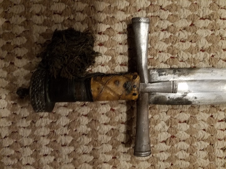

Next an Ali Dinar period kaskara I have, note the crocodile hide, also the unusual marking at forte which has been thought perhaps to be the Kull death head as interpreted.

Please comment on this? I should take some better images.
http://www.vikingsword.com/vb/showth...hlight=Kaskara

Bill M,
That's a very nice Kaskara. The blade has a Kar/Khor type fuller and was likely forged in the Tigre (Muslim) region of what is now Eritrea. My informants in Kassala in 1984 attributed the Kar's likely origin to Ethiopia, although that type of fuller was done in Sudan as well. Actually, the larger Beja peoples roamed over the area between Kassala, Suwakin, Mussawa, Red Sea Hills for several hundred years. Lots of spill over in these low lands. Kassaka itself is just a few miles from the Ethiopian border.
Stephen Woods information from Post # 36, collected in Eritrea in 1905-06, above describes this blade/fuller "species" as:
"2. But if the Kar is carved with a broad line up to the
point, it is of little value; and it is the sword of the high-
waymen only."
The Arabic script engraving, lines along edges of the fuller and the silver grip cover would put it as above the "highwaymen only" quality. Translation of the text would enhance our understanding of its origin and possible date.
The etchings on the blade are interesting, but don't really tell me any tales.
The silver grip cover isn't like the two known styles: diamonds and stars & Comets/dotted cross and would likely originate outside Sudan. The cross-guard looks kaskara style, but I don't know how far into Eritrea/Ethiopia the style penetrated. Some may argue that the style even originated there as similar versions have appeared on ancient Ethiopian wall paintings.
Hopefully others will add their interpretations.

The etching on the blade is consistent with a European trade blade, these were popular astral themes on European blades, the blade is very likely to be 18th century and I think the opposite of something for a highwayman. This is the problem with some of the native classifications, depending when they were compiled they may refer in some cases to locally made blades that were inferior but obviously don't cover very good imports like this one.
I appreciate your inputs, Iain and Edster. The blade, in hand, seems of good quality. Someone on another forum, thought it might have been a German import. There are some markings they thought relevant.
"Good quality" has to be relevant to the society as we know different techniques were made within the sociology/craftsmen of the makers.
A Tibetan sword "hairpin" pamor seems lesser quality to a Chinese sword, different than a Japanese sword, Moro kris, or Indonesian keris.
As noted with the date on the original post that it has been a time sense I have looked at it carefully. Please continue.

It's a very good one.
I think it's an imported blade with decoration done locally but not necessarily all at the same time. The Arabic script is very well done whereas some of the other motifs are scratched on, which I have come across before.

Stephen,
Local vs. foreign blade sources has often been a sticking point in kaskara attributions. Usually local smiths can produce a blade almost indistinguishable from munitions grade German work. I've wondered for a while if Blade Taper could be indicative of whether a kaskara type blade was forged locally or foreign. Bill M's blade has a slight taper throughout its length and then has a shallow "V" at the end and, as you say, would be indicative of foreign origin. I have four kaskara, locally made, that exhibit a steeper taper almost all the way to the end with a steeper point.
Both groups had files, etc. for final shaping of the blade. The difference may be related to the initial steel billet distributed to blade smiths before the forging process begins. European "put-out" systems would have had a more controlled system with more uniform billets that would yield uniform swords, made to contract specifications for length and width than what may have been available to Kassala smiths. Local forgers may have needed a more pronounced taper to achieve the target length with non-uniform billets.
Your thoughts?
