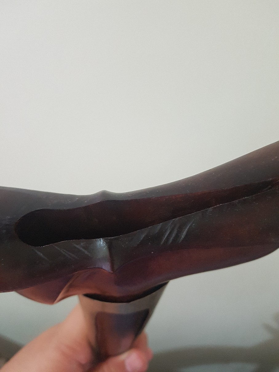

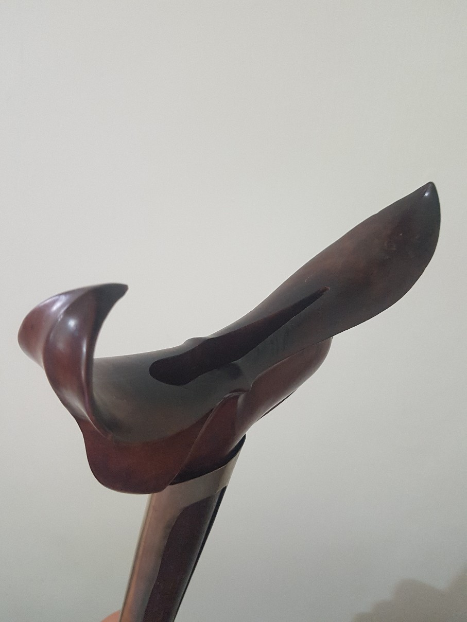

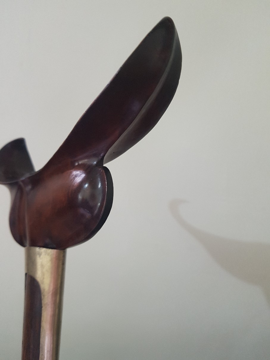

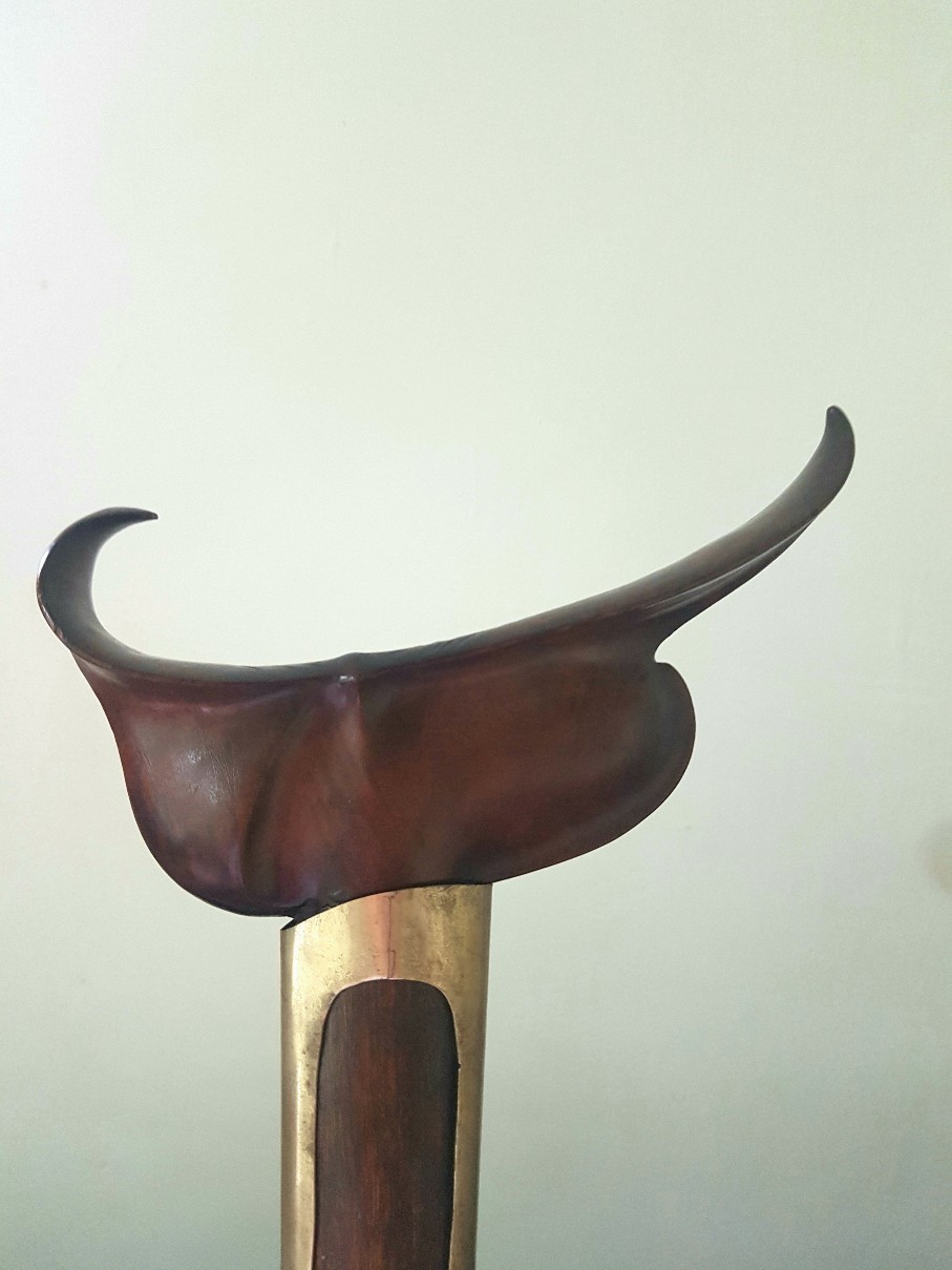

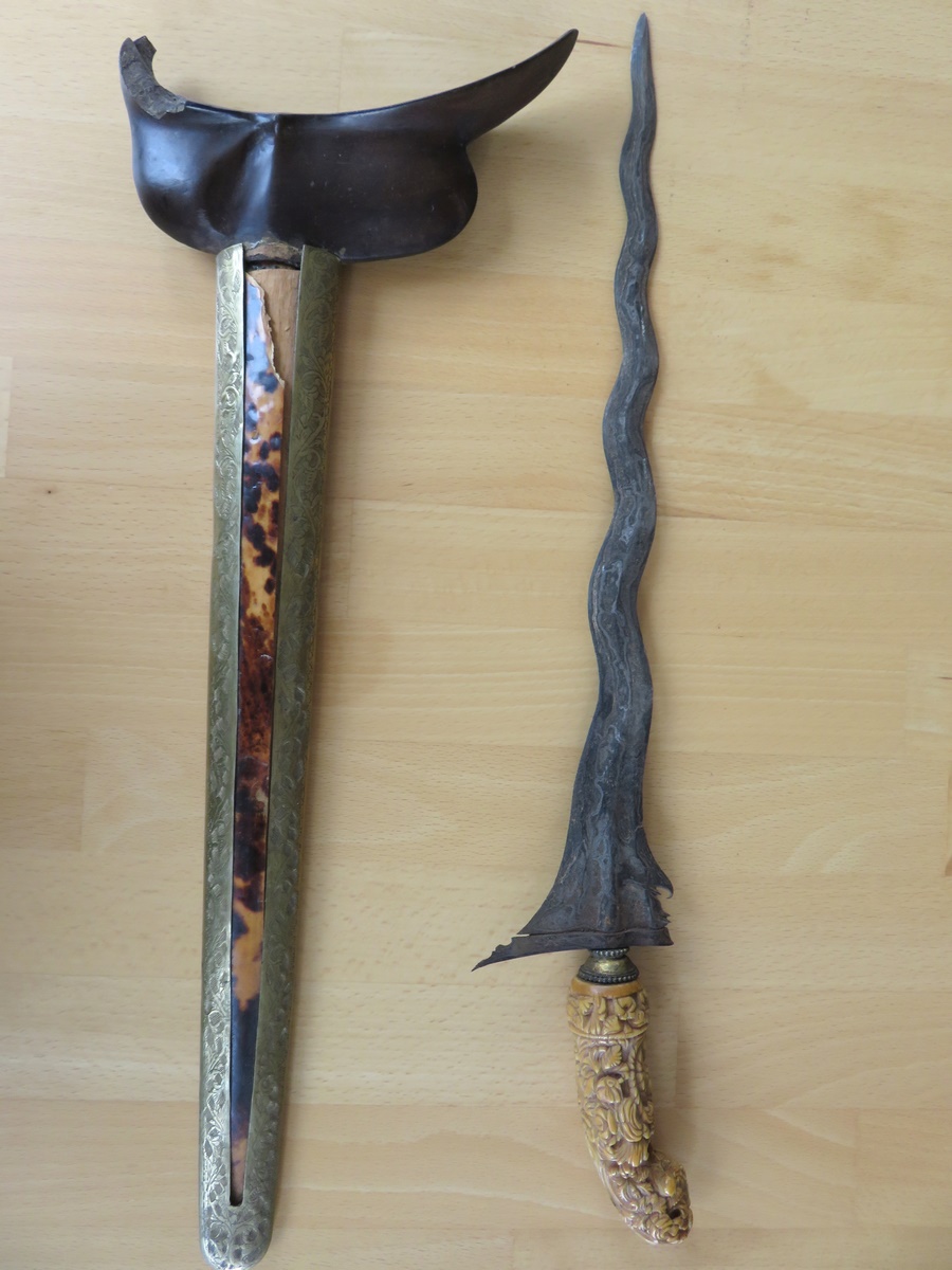

Here is another one for comment.

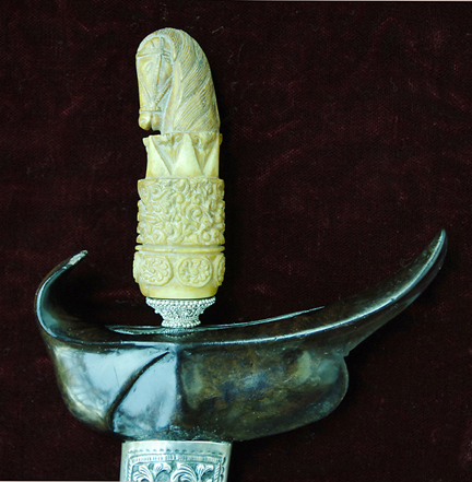

I believe i have seen this gana hilt before. A very nice one indeed. The wrongko appears to be a Madurese version of a ladrang (formal) sheath. Can we presume the entire ensemble is East Jawa?
It seems that most of the gana style hilts i've seen in the past have been of Sumatran origin and i can't say that i have seen any from Jawa proper. Do you know much about what areas these are likely to come from?
I have posted this hilt before which is on a Sumatran blade.
Old 2nd April 2019, 09:55 PM   #3
Posts: 6,436
That's a root burl isn't it Alan?
For a moment I thought it might have been Black coral.
I wonder if it was originally carved at the base to fit a cup-like mendak as David's example has.
I haven't seen that particular pendok motif before; it also is very nice.
The wrongko looks like it may have been re-carved a bit at some point.
The dress has some age to it, looks like.
Could you take a guess at the age of the keris?
Old 2nd April 2019, 10:45 PM   #4
Posts: 7,229
Yes Rick, it is wood, not black coral, and yes, it probably did have a selut at one time.
There's a lot of variation in old pendok motifs Rick, mostly they relate to motifs we find in other craft work, frequently in Batik. I'd need the pendok in my hand to give the motif a name, and I do not have time to look for the keris.
The wrongko probably was cleaned up around the edges, all ladrangs suffer damage with wear, so periodically they get cleaned up and repolished, the shellac on this wrongko is old, I've had the keris itself for over 50 years, so I'd guess that the last time it was re-polished was probably 1930's at least.
I do not remember what keris is in this dress, so I cannot guess the keris age, but the dress is certainly pre-WWII, most likely second half 19th century.
Yes David, I think most people would give this as Madura dress, but the pendok is not typical Madura, and this hilt form seems to crop up in many places, I've seen it mostly on Javanese keris, but also Bali, Madura, Sumatra.
I bought this keris in Australia, before I ever went to Indonesia, the dress is a mixture, but the I seem to recall that the keris is a good fit to the wrongko. I'd be inclined to place it as North Coast, probably Pekalongan and to the East, as a place of origin. Certainly not any kraton wear.
Old 3rd April 2019, 08:15 AM   #5
Question
Hello Alan,
Thanks for yet another instalment!
This begs the question: Why do you think so?
Only this specific ensemble, based on its possibly mixed origin? (From old quality examples I get the impression that courtly styles along the North coast and on Madura might have been less strictly controlled than in Jawa Tengah; it is possible that many local centres/ports and faster development of different styles throughout time is confounding this impression though.)
Or this wrongko style in general? (From what I've seen, this ladrang type often comes with very well selected wood of high quality; and excellent craftsmanship, too.)
Old 3rd April 2019, 09:32 AM   #6
Exclamation
Hello David,
this gana hilt
Just a minor quibble: I believe we should drop usage of this name since it is based on only a single source which (most likely) got misinterpreted in the West:
http://www.vikingsword.com/vb/showpo...&postcount=177
(the whole discussion is certainly worth a look and starts around post #130).
It's certainly unfortunate that we don't have any "genuine" name for these "naturally formed" hilts. However, continued use of an at best ambiguous name does not really help IMVHO.
Old 3rd April 2019, 01:22 PM   #7
Posts: 7,229
Kai, when you ask for me to explain the reasons for my use of the phrase "certainly not kraton wear" you are asking for a 5000 word paper, and I'm sorry, I'm not going to give you that, but I'll try to clarify my thoughts in somewhat fewer than 5000 words.
The idea that hierarchical indicators were not in use in kratons other than the Central Javanese ones is an interesting idea. Personally I find it peculiar, because the entire spectrum of Javanese society is structured along hierarchical lines, that the centers of power in some places may have watered down the observance of societal placement seems to me to fly in the face of logic. If stratified dress standards were not observed , does this mean that we could expect to see the Javanese language also reduced to a single level ?
If the language is unstratified, that seems to indicate that there was no concept of "kawula - gusti" in these places, and that in turn would mean that in the places where courtly dress standards were not observed, Javanese society itself had collapsed.
Interesting ideas, but in my opinion, unlikely ones. But then we do have the matter of Cirebon society to consider, along with Cirebon dialect, so possibly a very searching examination of the societal mores of Cirebon might indeed indicate that in this place the Javanese societal structure, as well as the Sundanese societal structure did indeed collapse.( Cirebon is on the border of The Land of Jawa, and The Land of Sunda, it grew out of a fishing village and in reality had only a very brief period of influence, its populace is comprised of people whose ancestors came from a great variety of backgrounds and locations)
What we might be able to hypothesise is that because the power and influence of the North Coast power centers had been eroded from an early date, the populace of these places along the North Coast felt no obligation to follow any lead given by the aristocracy. For instance, when Amangkurat II turned the control of Cirebon over to the Dutch in the second half of the 17th century, the old power center was split into four separate areas of control. I hesitate to name these as "kratons". Why? Because the word Kraton (Keraton, Karaton) comes from the word "Ratu", which means "Monarch". These North Coast entities were hardly under the control of any monarchs, they were under the control of the Dutch.
So, the common people, the merchants, craftsmen, clerks and bookkeepers probably did feel that they had a degree of freedom in their choice of not only their attire, but also in respect of the way in which they dressed their keris.
I find it quite difficult to identify any North Coast location that was home to a legitimate Kraton after the Dutch took control in the late 1600's. Even before that these North Coast rulers only existed at the whim of either Mataram or Banten.
So just where were the North Coast kratons located in the period following 1700?
Can we identify any local ruler who was entitled to be regarded as a Ratu or Monarch?
No Ratu?
Well, that means no Kraton.
If we consider Madura, there is a "kraton" in Sumenep, but this naming of what is essentially an istana as a kraton is colloquial rather than accurate. Currently it is the residence of a Bupati, as Sumenep is a kabupaten (regency) and it was originally built by an adipati (duke) towards the end of the 18th century.
So, if I say, "certainly not kraton wear", what I have in mind is the strict hierarchical dress code of a genuine Kraton, not the perhaps more relaxed dress codes of provincial administrative centers that do not house a monarch. But even in these administrative centers I would still expect to see some observance of dress codes.
In any case, the fact that the dress of this keris displays a variety of styles is in my opinion an indication that it was the keris of somebody who did not have the need to comply with any dress code. This of course raises the question of whether it could be a dealer's montage, and this is always possible where one has not actually bought a keris from a person who was wearing it at the time of sale. My personal opinion is that it is not something assembled by a dealer, but I could always be wrong.
Kai, I read my comments on the "gana" thing, and I think I know more now than I did when I wrote those comments, however, before making any further comment I would like to read all that went before the comments that I made, and your link does not provide access to the entire thread.

Old 5th April 2019, 04:53 PM   #16
Posts: 7,297

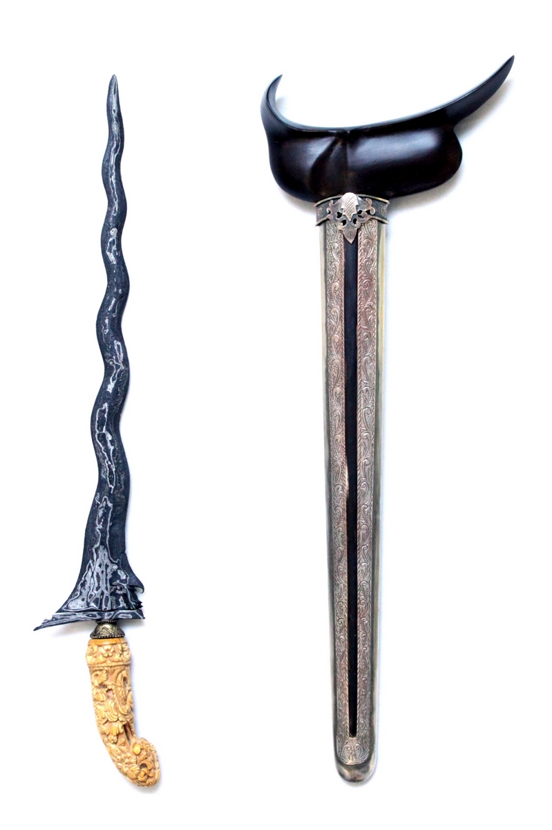

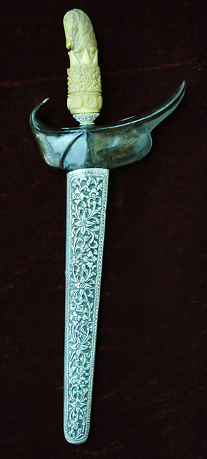

I will add one more example of this sheath form for view and possible discussion. This one holds a beautifully crafted patrem, which to my understanding is a contemporary blade, though i thought at the time of acquisition that i was also told that the wrongko was an old one. This also does not have any carved motif at the back like both Alan's and Jean's examples. Obviously the pendok is more contemporary though. My source is a forum member so if he remembers more about this he might have more to add. Given this discussion i wonder if this pendok would be considered in keeping with East Jawa form or not. Regardless, i do love this little gem.
Old 5th April 2019, 10:08 PM   #17
Posts: 7,229
I'd have no problem at all in accepting this pendok as suitable for East Jawa dress, however, even though Madura is a part of East Jawa, and even though a pendok of this type could be used on a Madura keris, it could not really be thought of as a Madura pendok, which means --- I think --- that if we came across this complete keris without knowledge of its provenance we would be in a similar position to the one that I'm in with the keris I put up for comment, and in all honesty, this is the reality of keris collecting and of keris wear, on the ground, in Indonesia.
In certain locations and situations people wear keris that have all elements of the dress correctly matched, but in other less elevated locations and situations people wear keris that are frequently comprised of conflicting elements of dress.
Real life is often very different to what we read in books.
