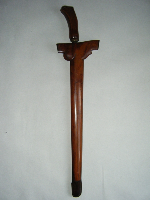

Yes, to me, these three wrongkos look to have the same form.
Alam Shah`s and Erik`s examples look to have Jogja style pendoks.
The pendok on mine could be interpreted as Madura, or could be interpreted as generic Javanese.
I don`t think there is any doubt that the carving on my example is Madurese, and this carving is fairly old. The wrongko itself was bought in Aeng Tong-Tong, and was very dirty when purchased.
Because of where it was purchased, the person from whom it was purchased, and the condition when purchased, along with the unmistakably Madurese carving, I have always been inclined to accept this as another variation in Madura style, however, in light of these other two examples, maybe it is not.
At this point, my inclination is pend the Madura attribution and begin looking at old examples of known origin and provenance, which means pieces in old European collections.
North Coast Jawa has been suggested.
In my (20th century) experience, there is considerable overlap between North Coast Jawa, East Jawa, and Madura---and again between East Jawa and West Bali.
I have in mind a North Coast type of wrongko that does in fact have a rather squarish profile. Perhaps a closer look at this type may suggest something.
This presentation of three examples has highlighted one of the problems of identifying origin of all parts which go to make a complete keris. As soon as we move away from the influence of a Kraton, it appears that what we often find is a mix and match situation, and this mixing and matching is not exclusive to dealers. I recently had the opportunity to provide an opinion on an old keris of known point of collection , and collected in the early 1940's.It had been the keris of a village headman. It was a mixture of Bugis, Palembang, home-made repairs and substitutions, and a wrongko atasan that could have been from any one of many places. It was collected in Sumatra.
With keris, things do not always follow textbook examples.

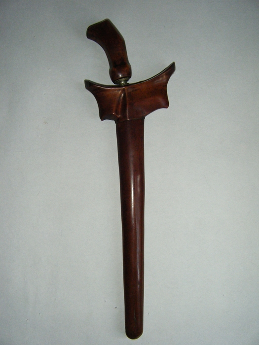

Here are a few more Madura wrongkos.

And a few more.

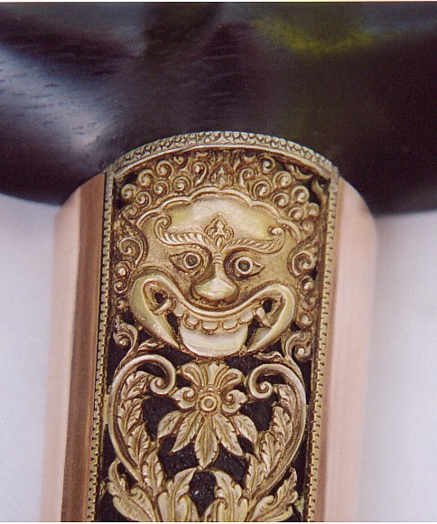

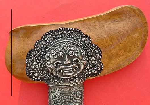

The variety and beauty of these pieces are truly a statement as to the artistic talent of the Madurese carvers, all of the Madura wrongko in this thread express superb quality. I personally thank you all for participating.
However, there is one style of wrongko that I have been waiting to appear, as I do not have an example of my own, I am attaching photos with references to the books from which they are "lifted". Sorry about the poor quality of the photos, but they reflect the poor quality of the photo in the books.
This style is quite often being mistook as being from Bali, and advertised as such. But there are indeed differences in the details of the carving. Some authors call it as being from East Jawa or Jawa Timur others strictly Maduran.
So what is it East Jawa, Madura or a combination?

Erik, this is exactly the same style as your topengan posted on 18 Sept.
Yes, the mask on the ones you have just posted is larger, but this is only due to the fact that your example is a more recent one, and consequently more refined. The copied photos you have just posted are older, the topengan was probably added to the wrongko later, and made to fit: your own example was constructed as an original entity.
In fact, I do have one similar to the ones you have just posted. I`ll photo it and post pics when I get a chance.Look at the wrongko itself:- it is exactly the same in your example, and in the ones you have just posted. The difference is only that in these older ones the topengan is not as neatly mated to the wrongko, but thrown together, almost as an after thought.
Have a look at the bright yellow wrongko with no pendok , in my first post of images. This is a good grass-roots example of this wrongko style. This is an old, old wrongko. It is one of the first keris I ever owned, and I have had it for about 50 years. When I bought it the atasan was in three pieces, the gandar had massive holes in it, and it was suffering from dry rot. What you see in the picture I posted is a total restoration.
As to where they originated.
In 1835 Cakra Adiningrat VIII of Madura gifted a very fine example of one of these keris to King William I of The Netherlands. I feel it is extremely unlikely that a Madurese ruler would present a Balinese keris to the sovereign who was effectively his overlord.
The Balinese style of dress that is found in Madura has a legend attached to it. Broadly, it is this:- a ruler from Bali set out invade Suminep. He reached the coast near Suminep with his troops, and began to march towards Suminep. The Suminep ruler heard of his coming, circled around behind him, smashed the boats, then encircled the Balinese invader.The ruler of Suminep gave the Balinese the option of swearing allegiance to him, and recieving land and a local woman as wife, or not swearing allegiance to him, and dying. The smart money took the oath and settled down as citizens of Suminep.These Balinese/Madurese retained their keris dress.
Over the years this dress has retained, or maybe developed very, very minor variations to the Balinese dress we see in Bali, generally it is very , very slightly more "compressed", and has a "fatter" appearance.
In fact, the keris presented to William I has a wrongko that is almost to Balinese proportions, but it is betrayed by the handle, which has the proportions of the Bali/Madura style, and it does not carry a pendok of Balinese style, manufacture, or proportion.
On all these Bali/Madura topengans I have yet to see a single one that has a pendok of Balinese proportions. All I have ever seen have pendoks with the proportions of a Jawa/Madura keris. However, I think it reasonable to assume that if people of Balinese origin used this style of keris dress in Madura, it probably had an original model back in Bali, where they came from.Be this as it may, I have yet to see a keris of this style with a Balinese pendok, or with a blade that is inarguably Balinese.
Based upon my personal observations, I am of the opinion that this form of dress is a style that was used by people of Balinese origin, living in Madura. I can find no reason to give it an East Javanese attribution, and although a similar style may have existed in Bali, I have yet to see this style of dress mated with gandar and blade of definite Balinese origin.

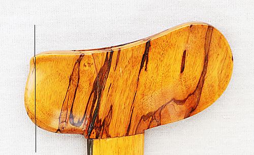

Granted, at first look they are exactly the same style as my post of Sept. 18th and Alan's on Sept. 17th.
Now, lets take off the topengan off all the wrongko's and imagine just the form of the wrongko, this is where I see a slight detail in the format to which they are carved, it may not have any importance at all, but look closely and you will find the left side of the wrongko when looked at from the front, appear to have less round appearance in the first three photos. And more round appearance in the last two photos.
I tried to illustrate this by drawing a straight line on the left in the photos, I may very well be wrong but I see a distinct difference in the form of the wrongko on the left side. It may be minute but then again the most insignificant difference in the world of Keris may have major implications.
Maybe they are just minor variations, or perhaps even optical illusions from being on a slight angle while being photographed, I just didn't want to ignore the difference.

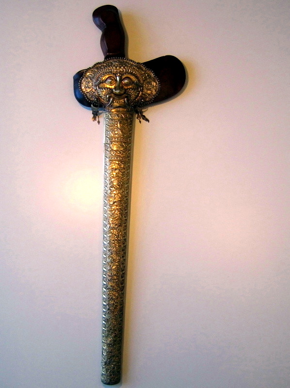

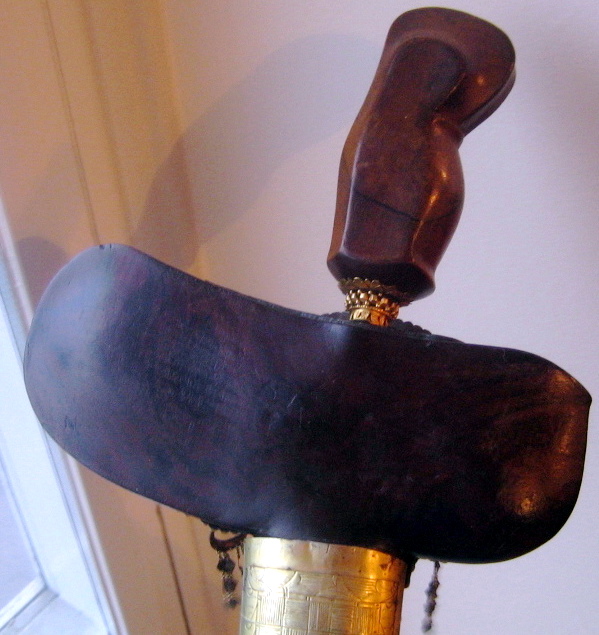

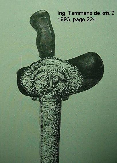

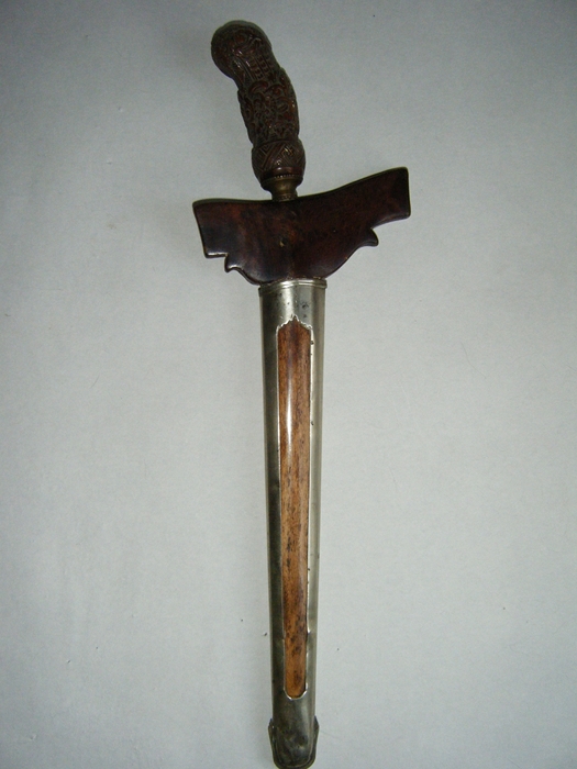

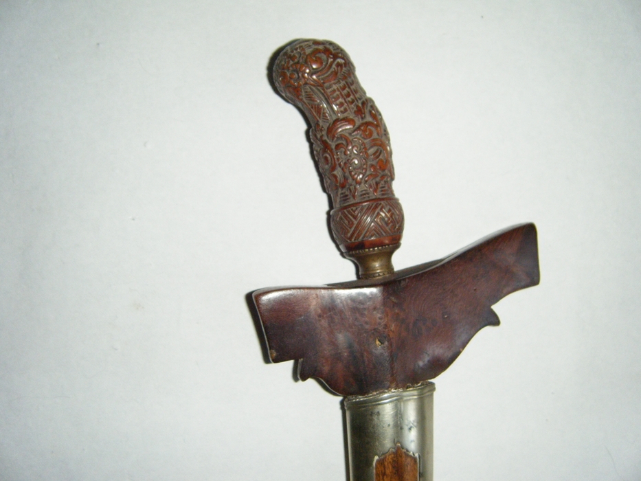

The "Tammens" Topengan is in my collection so I have enclosed two pictures of it, from the front and from the back. Additional pictures of it could be found in my gallery at
http://www.kampungnet.com.sg/modules...view_album.php
I am a bit surprised on Alan's statement that:
"Based upon my personal observations, I am of the opinion that this form of dress is a style that was used by people of Balinese origin, living in Madura. I can find no reason to give it an East Javanese attribution, and although a similar style may have existed in Bali, I have yet to see this style of dress mated with gandar and blade of definite Balinese origin."
This is very new to me, that's one of the reasons I enjoy this forum, and I would appreciate if Alan could develop this statement so I can understand it better?

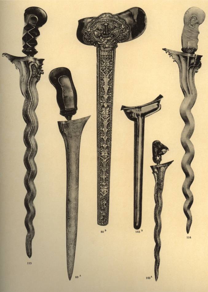

I enclose some other photos just for more confusion:

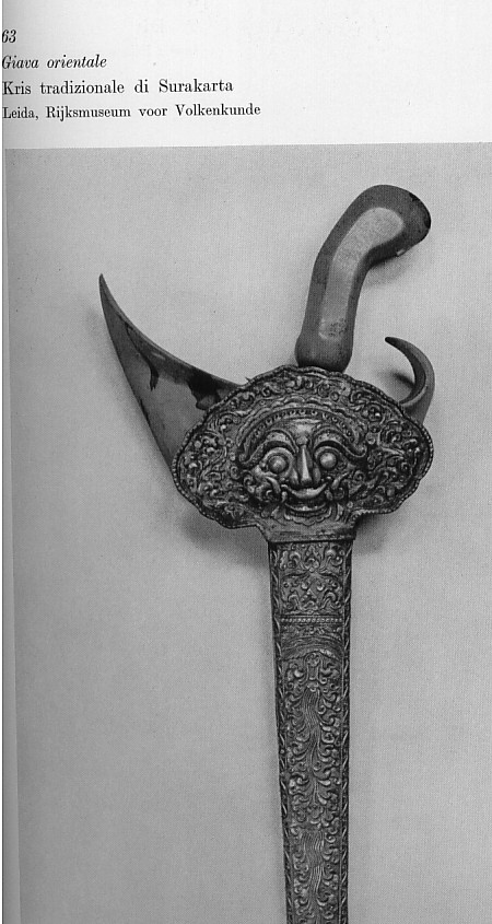

the first is from Bezemer book "platenatlas" : Bali
The second is from P. Holstein book tav. XLIII : Bali or Madura
The third is from G. Vianello book : Surakarta
The last is from my collection: Yogja

Firstly, VVV's Tammens keris.
If I were to see the handle of this keris in isolation, I would classify it as Bali/Madura. The form and proportions do not look to my eye like a Balinese handle.
The blade does not appear to be Balinese.
The pendok appears to have been formed on a sanglon.I have yet to see an old Balinese pendok that has been made as a tube; normally they are made like a blewah pendok, and the face of the gandar covered with a slorok, then the pendok and slorok are glued in place with shellac or damar.Additionally, the pendok has a lis (collar), which is a very common feature on a Madura pendok, and something I have not yet seen on an old Bali pendok.
The uwer is similar to a Balinese uwer, but has a stem, probably made necessary to allow the handle to clear the topengan; the upper plate on the stem was probably necessary to keep the whole thing together.
I do not know what Mr. Tammens classified this keris as, but to me, this is a Bali/Madura keris. It is not pure Bali.

Coming back to the Tammens keris, VVV has posed the question as to whether it is East Javanese or Madurese.
Madura is a part of East Jawa. In the present day it is administratively a part of East Jawa, historically it has links with mainland East Jawa, and in the past rulers from Madura counted parts of mainland East Jawa as parts of their realm.Certainly, Madura is an island, but this does not make it a separate entity to the mainland. Indonesians refer to Indonesia as "Tanah Air Kita":- Our Land and Water. Within the psyche of people from this part of the world there is no distinction between water and land as comprising their homeland.The water is just there to allow easy passage to the land.It is all one.
So, is the Tammens keris Madura or East Jawa?
Clearly, it is East Javanese, originating from Madura, specifically, the kabupaten of Suminep.
In my earlier post I should have been more precise in my use of language and written "---mainland East Jawa---", rather than just "---East Jawa---".
Where else in East Jawa is there a tradition of a group of Balinese people living divorced from their homeland?
Yes, there are Balinese people around Banyuwangi, but these people are still attached to Bali, which is just across the strait. An hour away.They are not a separate colony.
Where else in East Jawa can we place it?
Malang? Kediri? Jember?Blitar?
If we wish to place it in or near some other major population center, we will need to come up with a strong argument to do so. I do not yet have the knowledge that would allow me to construct such an argument, but possibly somebody else may have.
If we give an attribution of East Jawa, Central Jawa, West Jawa, that is sometimes adequate, but if we wish to be a little more accurate, we need to look at point of origin: Surakarta (in Jateng), Malang (in Jatim)----and so on.
To address the images provided by Marco.
The image from Bezemer:- I cannot see sufficient detail to decide on the indicators of this keris. The mendak is Madura, the pendok seems a little too tapered for Balinese, the handle seems to tend to the Bali/Madura form. But honestly, I just cannot see enough to know the things I need to know.
The image from Holstien:- the blade is not Balinese, the form of the wrongko atasan is classic Bali/Madura, as is the handle, I am not able to see sufficient to guess method of manufacture of the pendok.
The Vianello image:- sorry, a dealer's montage.
The detail of a pendok on a keris in Marco's collection:- yes, we can find this motif spread over keris, and other art work, from many places in Indonesia, most especially so in modern work.

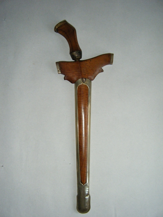

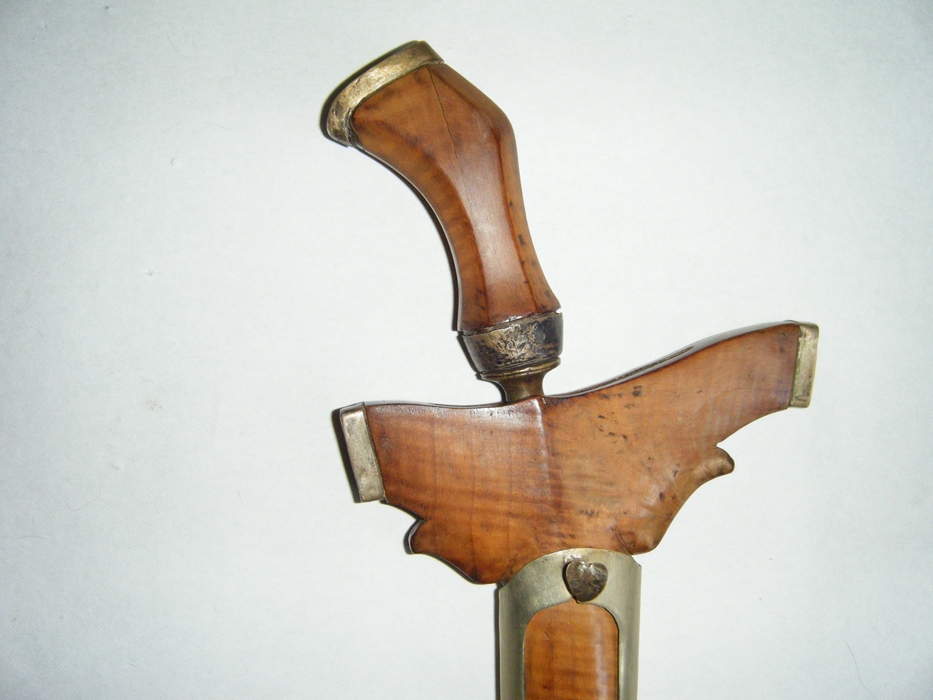

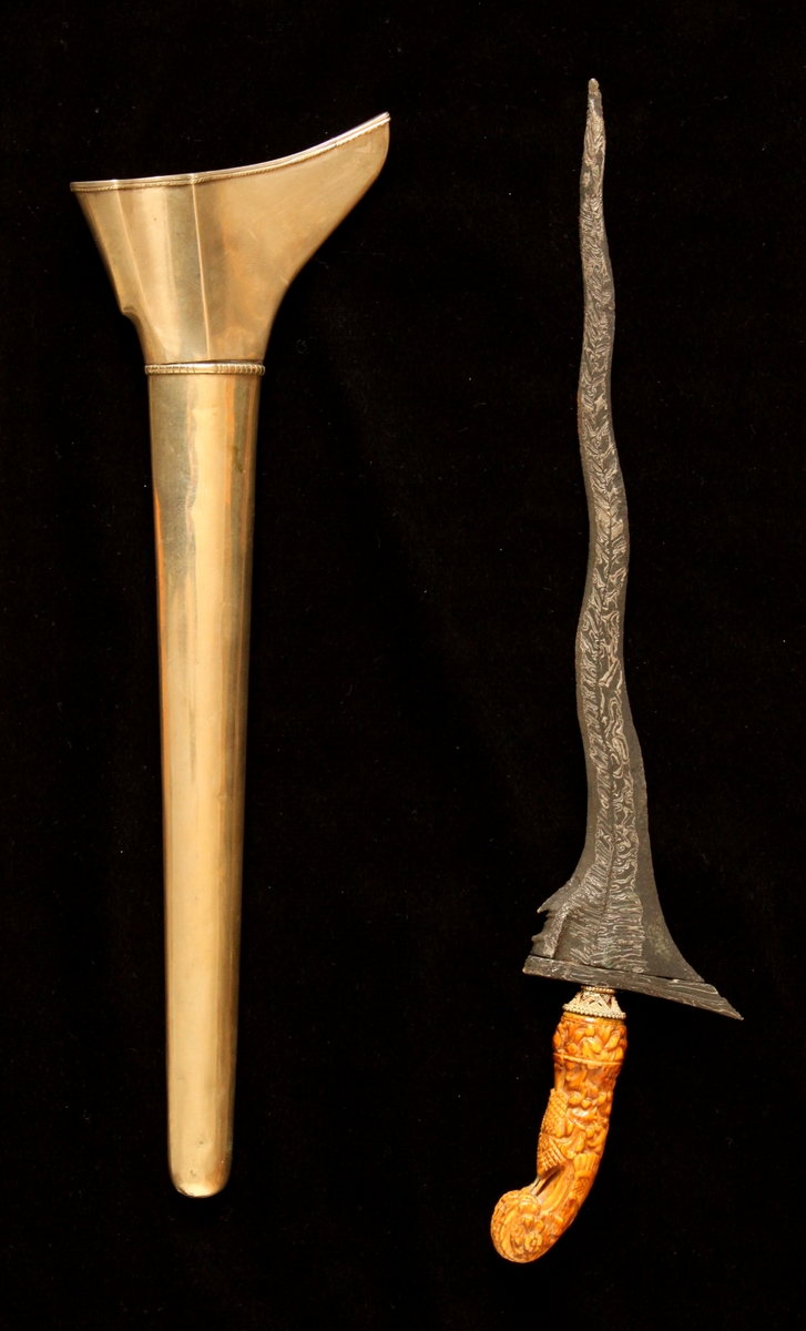

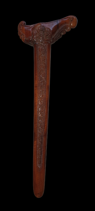

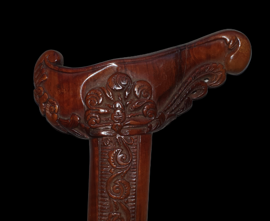

By searching through old threads I stumbled about this one and have to add some Madura sheaths.
Hello Sajen,
Nice pieces! According to M.M. Hidayat, the warangka of your last specimen is in a style locally called capil.

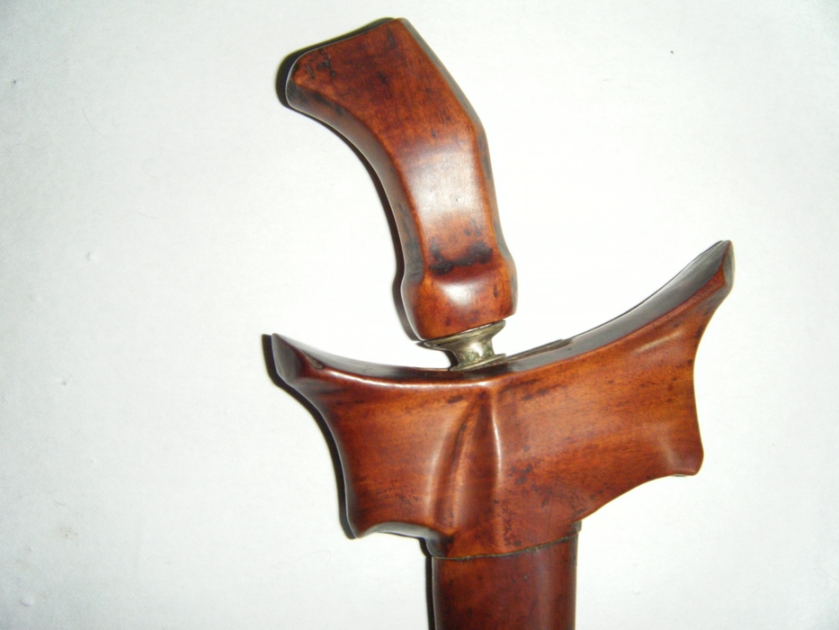

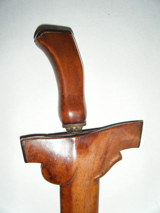

Any opinion if the attached style of sandang walikat warangka is from (continental) East Java or Madura?
Old 30th December 2012, 01:47 PM   #48
Originally Posted by Jean
Hello Sajen,

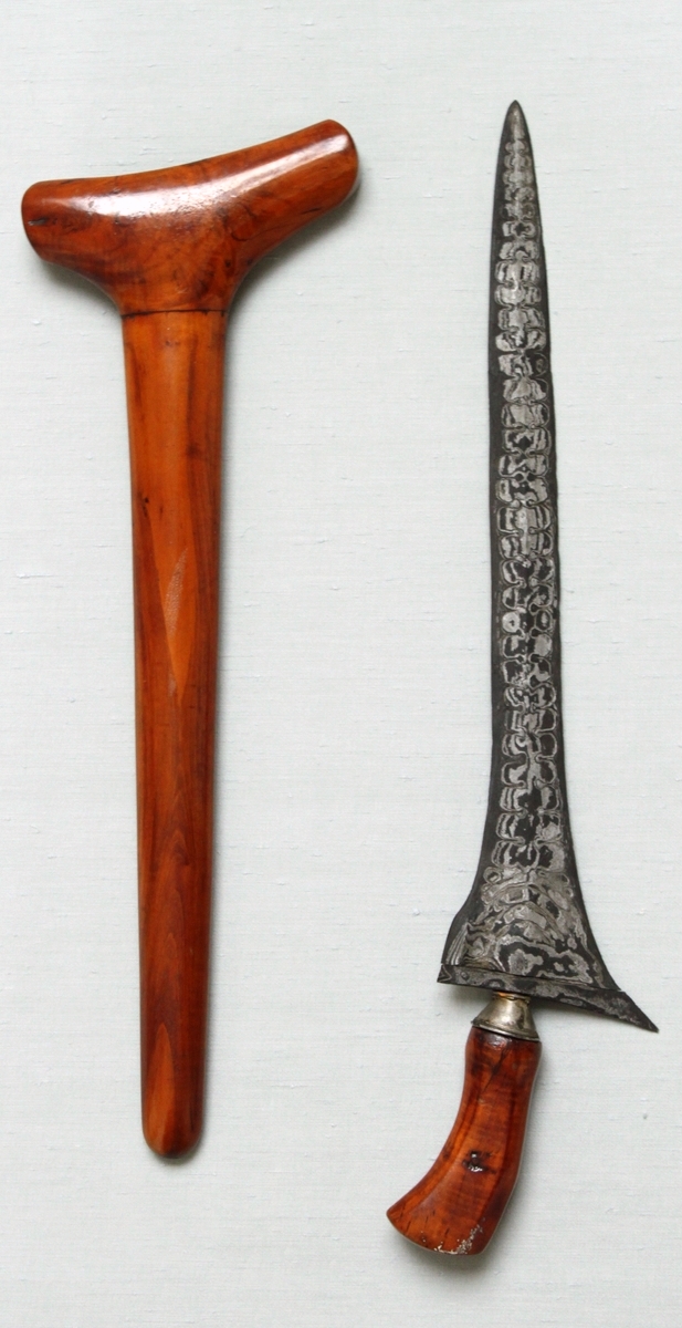

Hello Jean,
thank's! The capil sheathed keris is a patrem.
I think the sandang walikat style can be found in East Java as well in Madura.

Originally Posted by Jussi M.
Up!
Is this not a classic?
Thanks,
J.
Added !
Hello Jean,
Hello Sajen,
Thanks! Actually my 2 krisses have a rather short blade also (30 cm) and the one with the wooden sandang walikat sheath has a similar hilt to your patrem (village style?).
Old 30th December 2012, 03:37 PM   #51
Originally Posted by Rick
Added !
Thank's!
Old 30th December 2012, 03:42 PM   #52
Hello Sajen,
I think it's a very common planar hilt style from Madura, most of the time I have seen it with the three similar scabbards I have posted in the up (# 43).

Here is one of my long time favourites that escaped from captivity a couple of weeks back.
This form has a lot of variations, they were usually carved by the person who owned the keris, not kraton wear, but rural village use and a form of folk art.
The motif is a personal choice and is normally some sort of flower or leaf or vine type motif.
Old 28th November 2018, 03:21 AM   #56
Posts: 6,441
Exquisite masterful carving; I don't think I have ever seen a better example of this style of wrongko.
Old 28th November 2018, 04:37 AM   #57
Posts: 7,255
Thanks for your compliments Rick, but I do have a few more of these, and in my opinion the ones I still have are probably better than this one.
I like these wrongkos, some people think they were early examples of the dreaded "Kerisus Turisticus", but this is quite incorrect, they were and are a form of folk art.
Old 9th March 2023, 08:12 AM   #58
Yesterday I received this wrongko from Madura, I think it's worth to add to this thread.
Old 9th March 2023, 09:28 AM   #59
Another one which is worth for sharing.
Old 9th March 2023, 11:16 AM   #60
And a third one.
