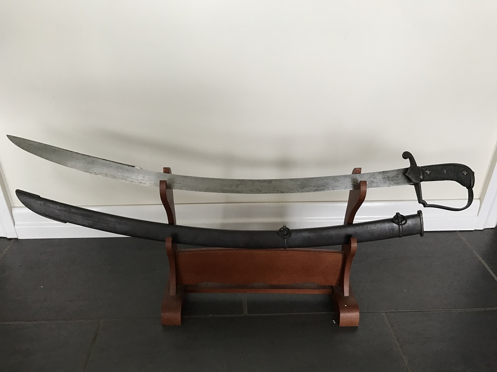

How can I test if it is wootz, without ruining the patina of the blade?
Hello Bryce,
first you should check every inch of the untouched blade with a magnifying glass and a small LED-flashlight for laminations or traces of wootz.
If you find nothing I would suggest to use a mild etchant like 4% Nital or 5% Seno 3207 without previous polishing. You can remove this staining without destroying the Patina (which is in my opinion just corrosion).
Another simple way is to hold the blade under running hot water (>50°C) and wait for a while. This would normally bring out laminations, if there are some, without touching the patina.
I think like the others, this is a high quality European copy of a Persian Shamshir or Kilij with a European hilt. These blades were extremely popular among cavalry officers during the Napoleonic campaigns.
