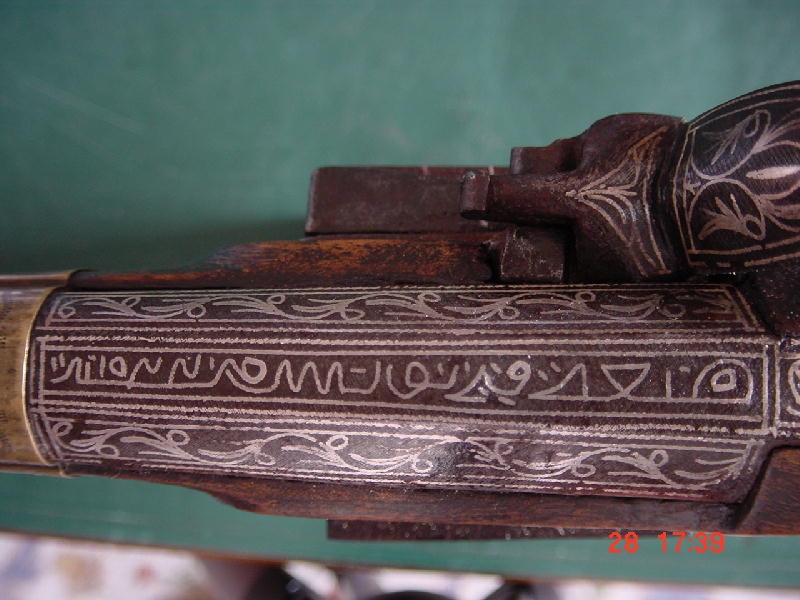

Hi gentlemen
I am trying to figure out the origin of a flintlock pistol i have acquired.
I am aware that this forum members cover a wide range of language
knowledgements.
Is there somebody familiar to this type of caligraphy, to coment on what could be written in this engraving on its barrel.
Thanks a lot.

Old 25th September 2005, 12:22 AM   #4
ham
Posts: 190
This is an Ottoman flintlock pistol dating after 1800, the inscription is in Arabic characters however it is very poorly written and the image is reversed 180 degrees.

Old 25th September 2005, 02:57 PM   #5
Thank you Ham, for the info on the arabic script and also on the model being Ottoman. I will follow your track, for further investigation.
Thank you Rick and T
I still insert the pistol pictures, Rick and Tim, which i had just taken. An ethno type of pistol, with the usual mix of pronenances, like the poorly fitted brass butt cap, saved from a western pistol, and the naive insertion of a crest, probably from the same origin. The large brass bands seem to be from the original mounting, as matching with the disposition of the barrel decorations, which i take as an added value in these pieces, although i favour the existance of the barrel inscription, and the whatever contents of its text.
I hope to get further with that.

Old 27th September 2005, 09:25 PM   #11
ham
Posts: 190
Hm. Looking at the image right way 'round, one can (very weakly) argue that at the far left, there are some squiggles which if pressed, could be read as a date, 1220, or about 1806 in the Muslim calendar-- however these are interspersed with another character which could be taken as a 5, though I think that is just a diacritical mark, perhaps a "sukuun." Gads, what a mess. This fellow's Arabic instructor would have rapped his knuckles bloody if he ever saw it.
The primary concern here however is that this piece does not likely date so early. Possibly the barrel and lock do, suggesting they were restocked in the latter 19th century. A feasible, if circuitous, path to the present.

Old 28th September 2005, 07:58 PM   #12
Thank you so much.
Could i infer that there is ( at least ) a third word in the midle of the inscription, like the whole text meanning: Made by "Abdulah" ( in the year ) 1220 ? This would already be encouraging!
Isn't Islamic year 1220 equivalent to Christian 1842 ?
This would reduce the span between the aparent oldness of the barrel and lock, and the newness of the stock. I stress this point, as the decoration on the barrel is not continuous, but divided in sections, with border lines perfectly aligned with the barrel bands angular format and position. This is only achieved with an intrinsecal first mounting ... very unlikely the restocking smith would achieve or care for such a precision, making invisible any marks of bands readjustment, or their matching with the engraving borders.
This to say that, to my non expert view, if the stock is newer than the rest, on wich i actually agree, we can not exclude that this was the first one that was fitted on the pistol, which is not so unusual in this type of weapons, often made with parts of various origins and generations.
Also peculiar to me is the counter lockplate, wich is made in thin brass sheet ( not shown in the pictures ), in the same material, with the same patina with precisely the same puncture decoration as the barrel bands ... so not a later repair.
On the other hand , the bass trigger guard seems to be from a different family, with a floral deep engraving.
Sorry to be so long, and probably so wrong.

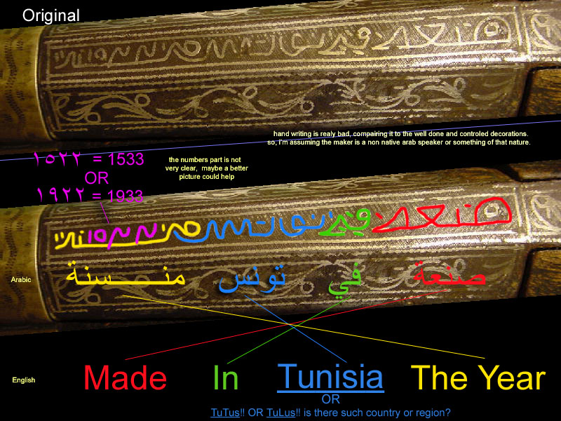

Hi Ham…
What do you think? Can you confirm any of this ?
any corrections? i'm sure Tunisia was not ment to be there!!
maybe a similar sounding Ottman region that you know of?!

Originally Posted by bj211
Hi Ham…
Salaam alaikum ya BJ,
Ahlan w'sahlan fil Sword Forum. Anta 'al ustadh al lughat al'arbiyya, ana talib faqat. Min 'aina anta ya akhi?
We are indeed fortunate to have such a colleague, welcome.
The 20th century date and poor calligraphy are consistent, not as an indication of manufacture, simply of the period of embellishment-- likely in the Tunis arms bazaar.
Ham

Old 28th March 2006, 06:16 AM   #17
bj211
Posts: 26
Wa Alaikum Al Salam ya Ham
Thank you very much for the kind and worm welcome. And for a student, your Arabic language knowledge is superb.
I’m from a small country in the Arab world, Kuwait. My passion for Arab & Islamic art comes from the fact that I belong to the “ society of the Dar Athar Alislamia “
Min 'aina anta ya sadeeqi?
bj211 is offline   Reply With Quote
Old 28th March 2006, 05:56 PM   #18
Thank you BJ and Ham
This is what i got after cleaning ( and varnishing ) the pistol.
The year digit apparently looks like an arabic 5 and not a 9, but what do i know?
Can you now have a more clear reading of the inscription, namely the "Tuinisia" word ?
Thanks
Old 28th March 2006, 06:28 PM   #19
ham
Posts: 190
Fernando,
Yes, MADE IN TUNIS is quite clear now, you've done a very nice job bringing out the silverwork. The second digit from the left is, strictly speaking, a "5"
but with the addition of a short tail on the right it would be a "9" much like our own. Now, seeing it clean and legible, I suspect the craftsman inlaid the numerals to reflect an earlier date, yet one which could still be read as the actual one contextually. These inscriptions are really a holistic process-- the sum of the whole truly is greater than its parts. Neither the use of the term "san'at" ("crafted") nor the phrase in which it appears, "Crafted In Tunis" are at all characteristic of period maker's inscriptions. This refelcts a great deal of Western influence, in my opinion (i.e. Made in Paris or Made in Rome.)
The pistol certainly is 19th century. As we have discussed, it is the silverwork which is more recent.

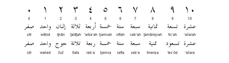

Old 1st April 2006, 01:03 PM   #21
What puzzles me is that the interpretation of the numbers seem to different from what was quoted here. BJ description of number 3 is seen in several sources as being number 2. I was recently visited by my Moroccan working coleagues, and they also say that the date in the inscription is 1522. Could it be that Kwait arabic variable has as a different graphism for the numbers ?Also to consider that in fact this type of digits is what Arabs call "indian numbers", as in fact they originate from Hindu numbers. In a more ortodox arabic they write numbers with wordings, not figures.
